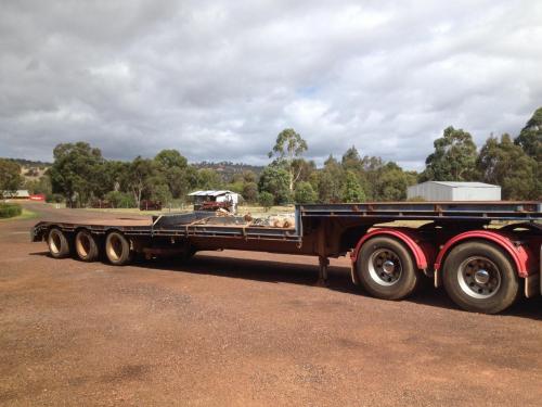

Project - drop deck trailer

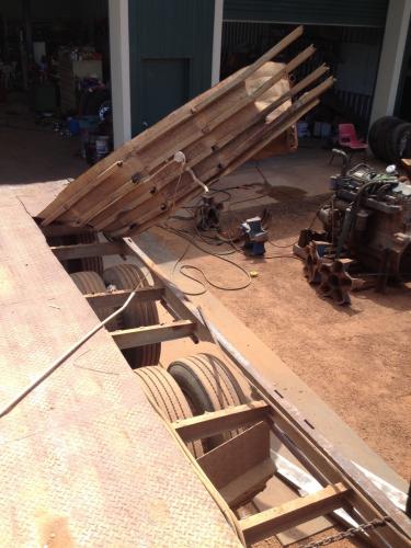

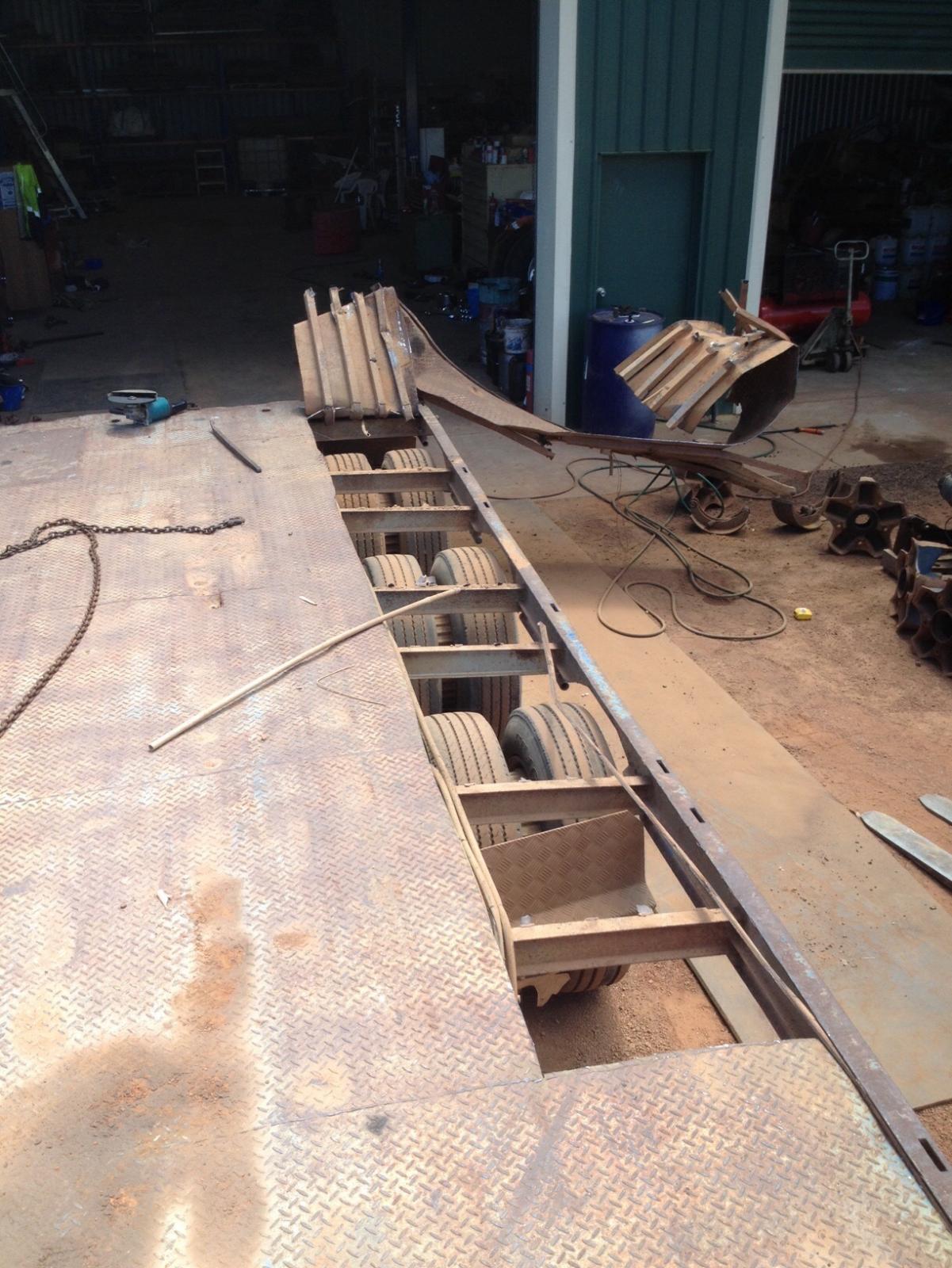

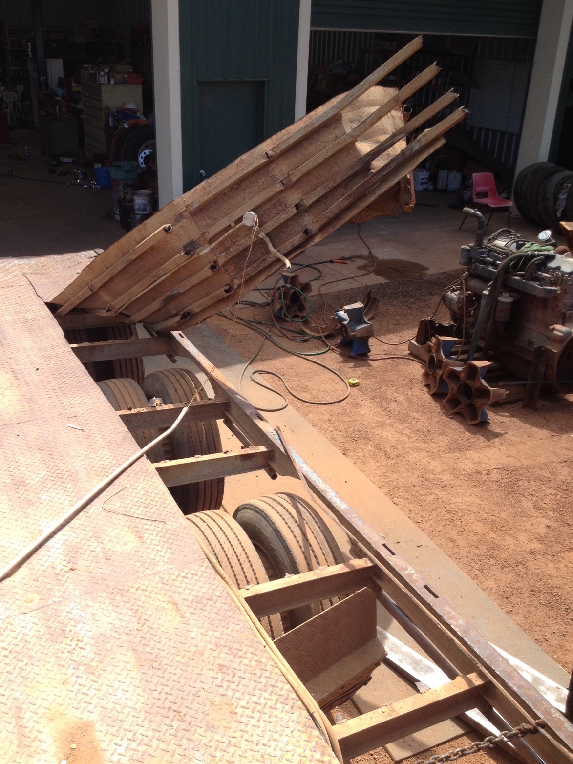

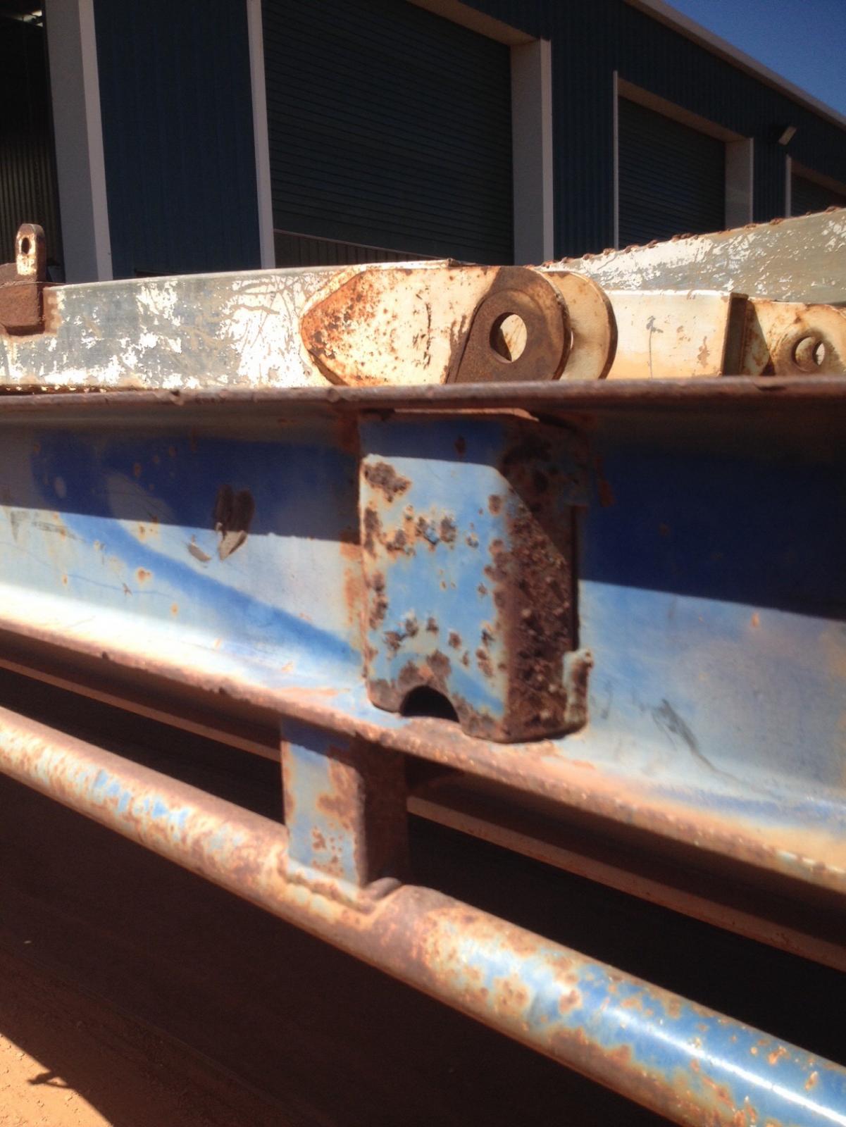

Started pulling it apart today. Using a grinder (wish I had an oxy set) and a forklift, I'm sure most blokes would cringe looking at the way I did it but it's coming apart.

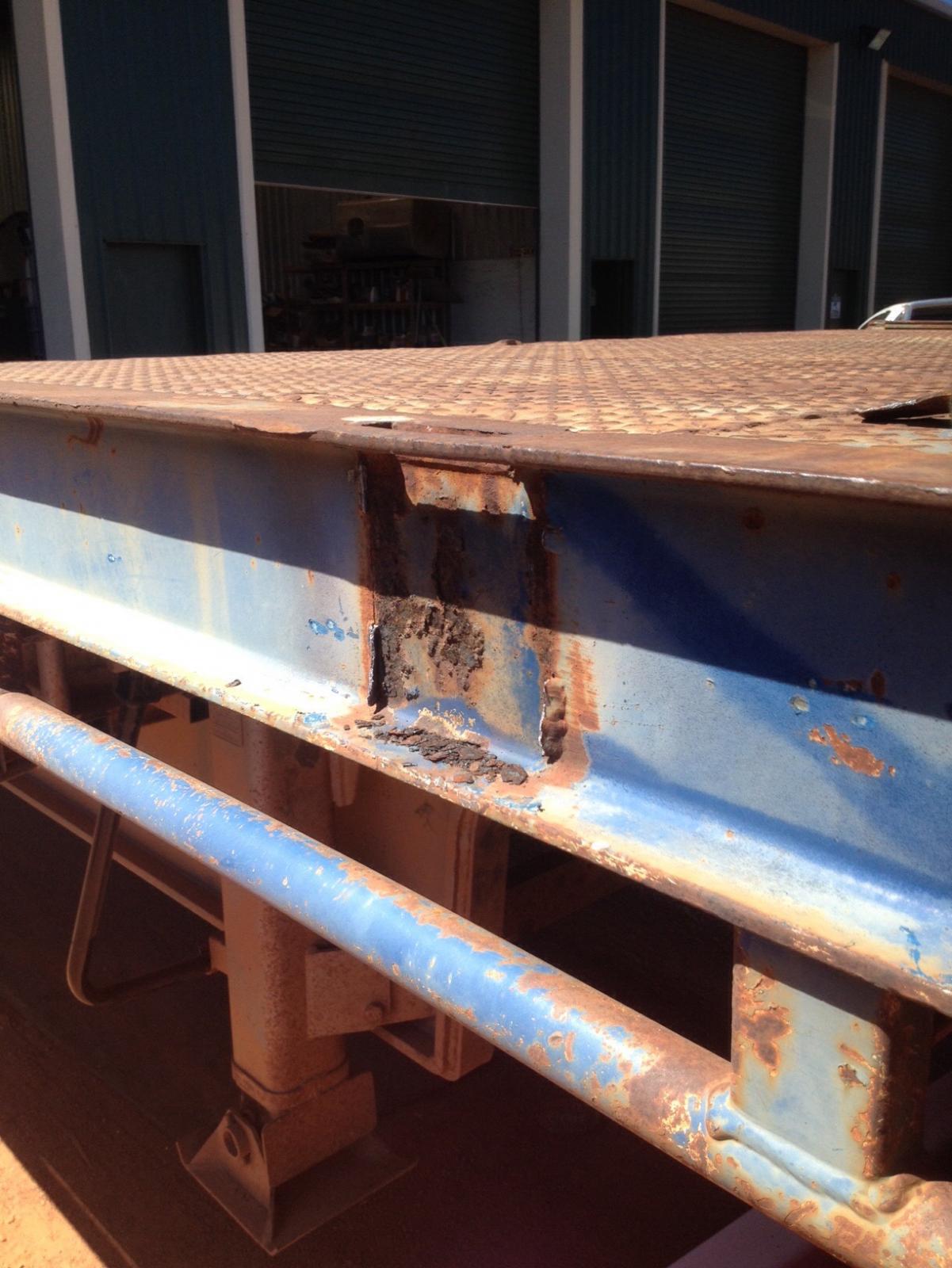

Gate pockets were rusted so they came off too.
So Tim are you gunna cut the whole section out or just use some steel beams and jacks to push it back it posistion ??? I have straighend some pretty bent things just using RSJ's jacks blocks of wood and chains the less you cut off the less it is going to cost to put back right and the quicker you get there
Looks like you have it well in hand though

Hi Paul, too be honest I'm not in my field of expertise. But I think your right, as much as I can fix/straighten the cheaper it will be. I'm going to try and pull the floor off the bottom deck and get some expert advice. I think I'll have to replace some runners, and I think some can be repaired.
Tim I wouldnt pull any more floor off
might even be able to cut one cross beam off at a time at the combing rail end only and just put a jack under it and a string across top and jack it up till straight and once there done cut the combing rail off and use a chain and jacks against the trailer chassis and slowly straighten it out just use your eye for it then weld it back on a few dabs with the paint brush and you will be good to go

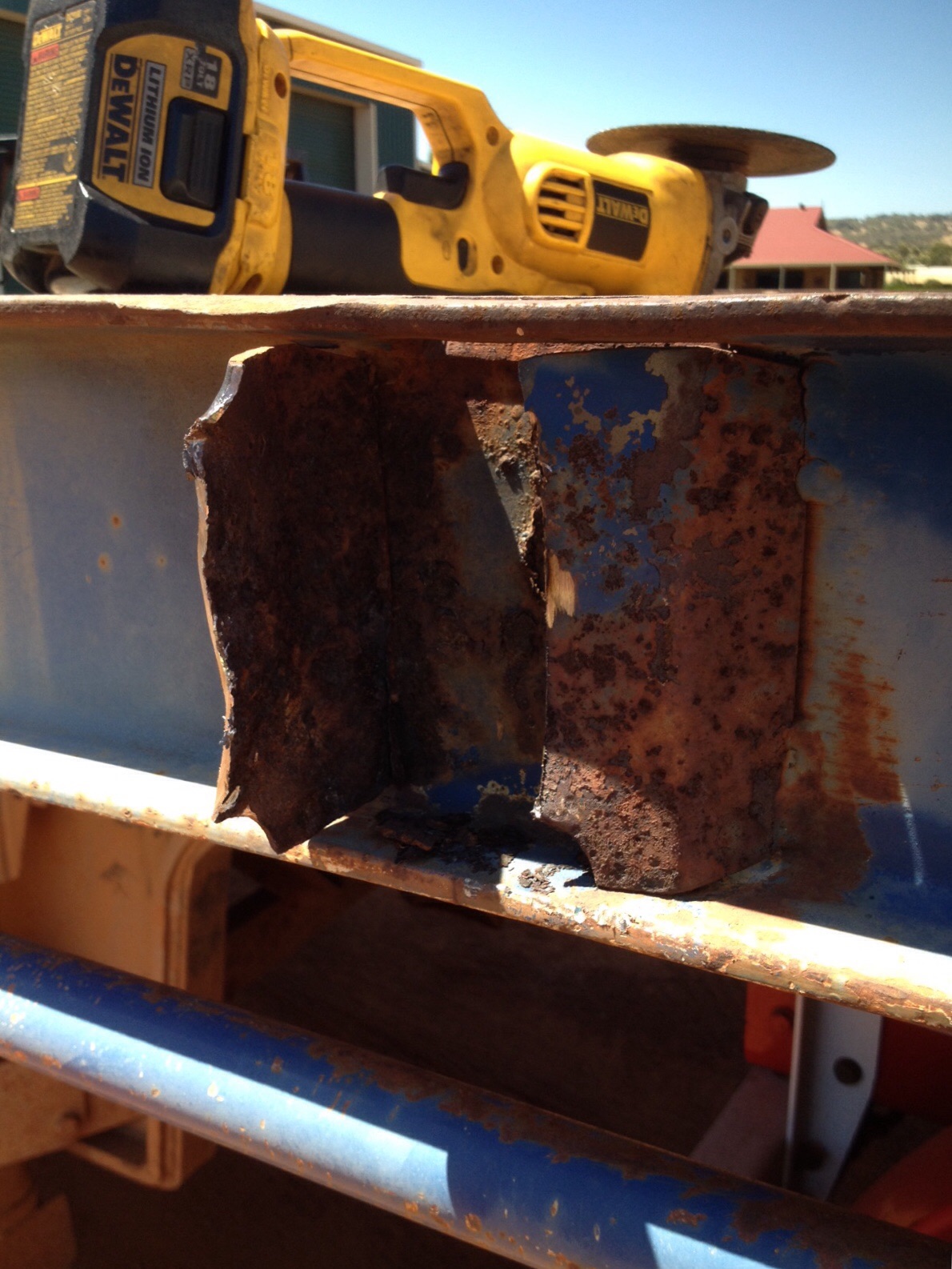

Just a little update.

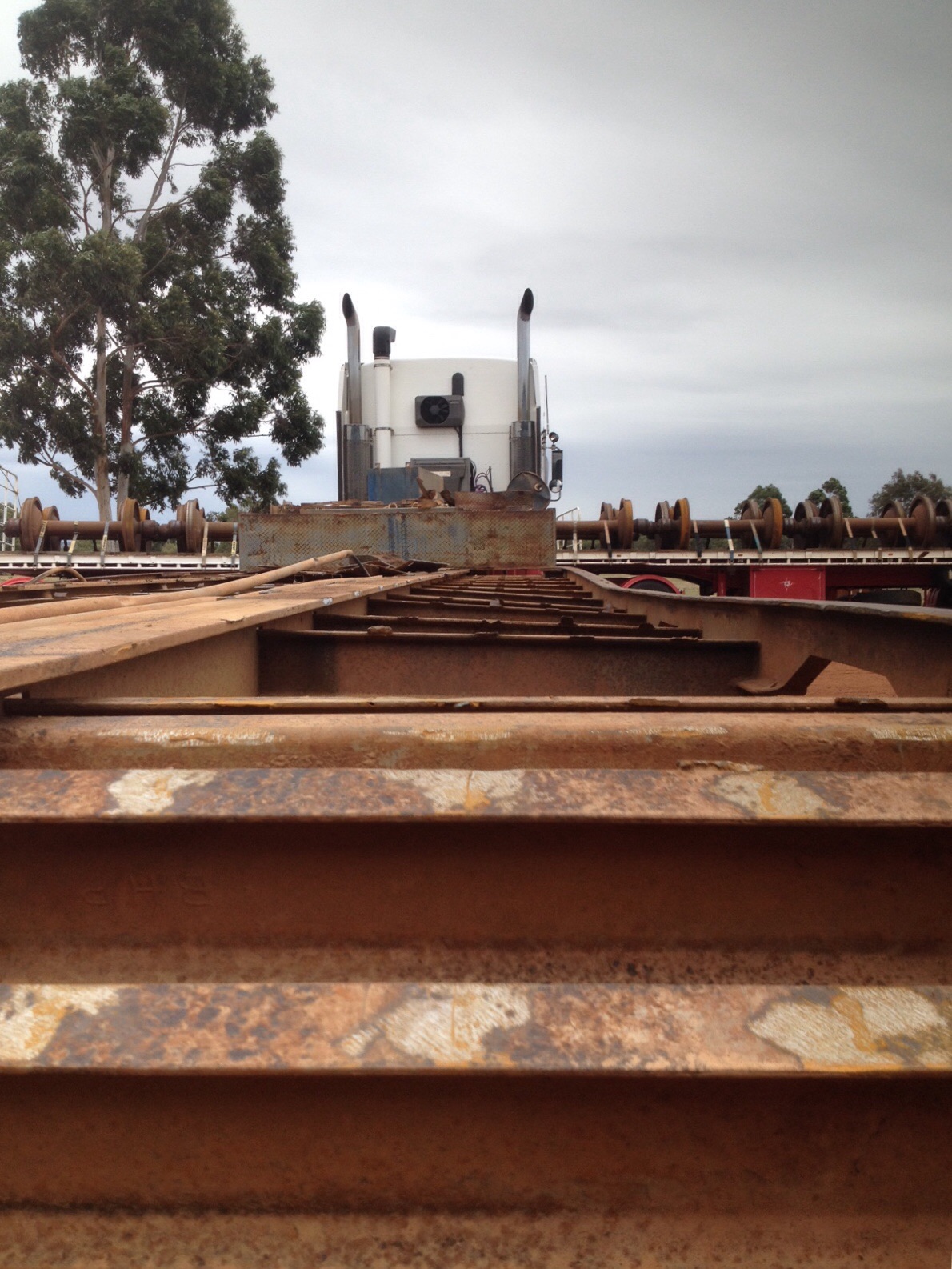

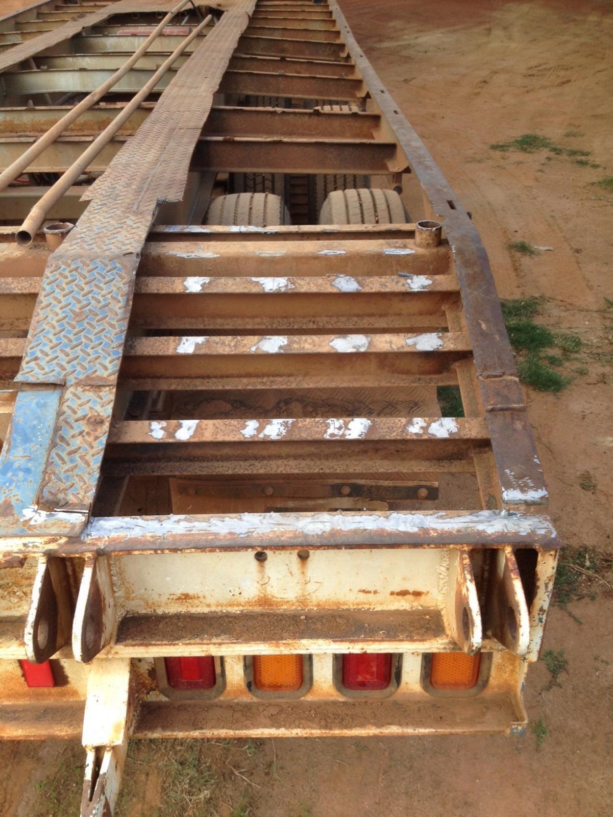

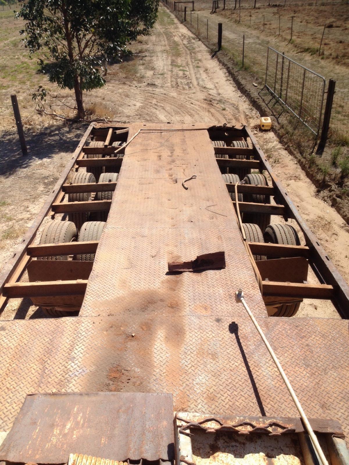

Have to bring all the bottom floor up. The square tubing was left open at the front to dirt and water, and was rusted through and squashed.
Also removed the checker plate from the beaver tail. That was hard work, as there was 4 crossmembers in the space of 600mm and floor was attached to each one.

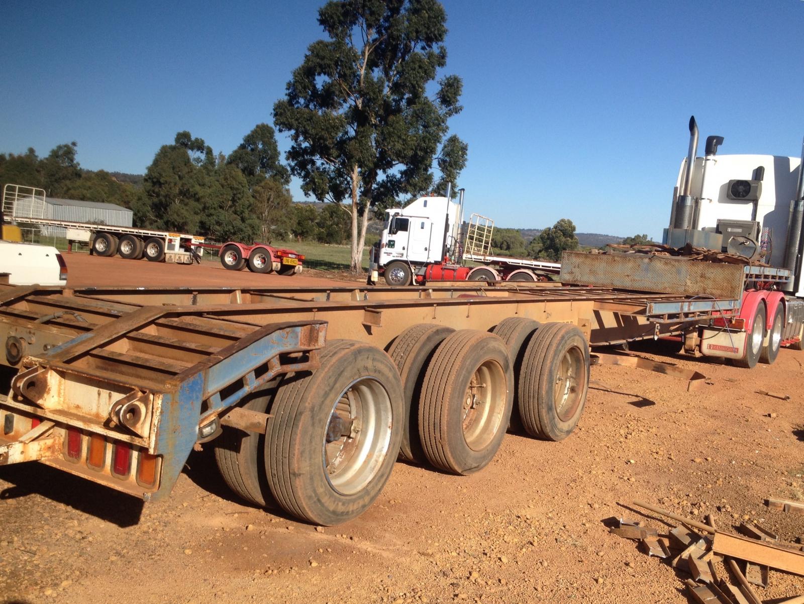

Yeah Paul, I am buying a 12m length of 5 inch i beam, for the coaming rail. And 6 of the cross beams need replacing. Actually, the top of the chassis is 10mm wider than the bottom, due the the weight stretching the cross beams.

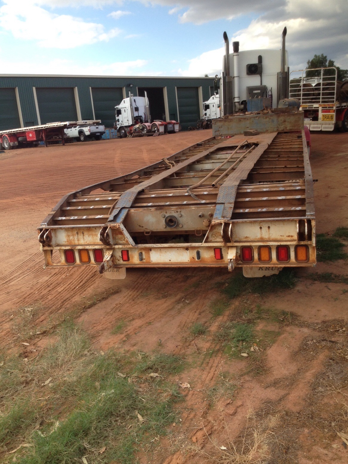

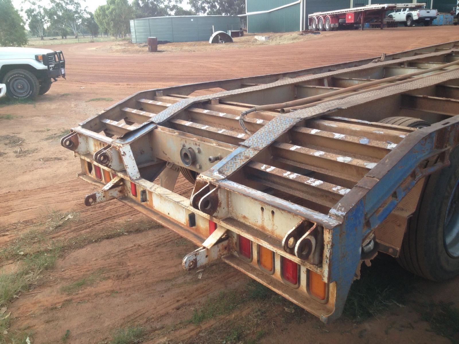

Plus the ramps and hydraulics. It's a decent size job, but a drop deck with ramps still attract a big price tag. Not that I'll be selling this one.

What are you going to do for ramps? Are they going to be hydraulic or spring?
