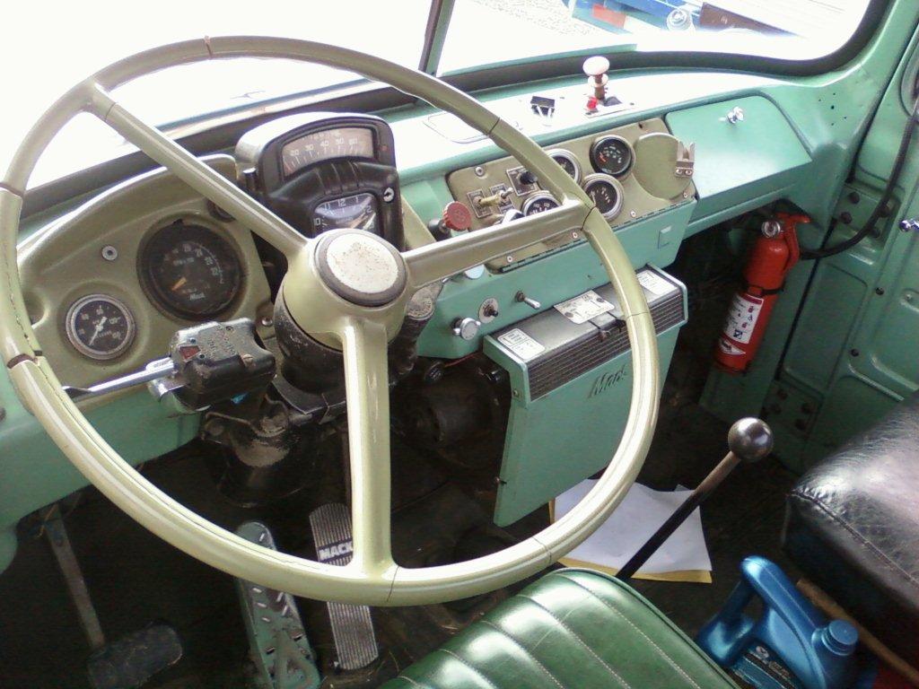

note of caution-DO NOT place thumb inside of steering wheel

I'm curious as to what circumstances specifically lead to what I assume is the wheel snapping around and trying to tear your thumbs off. Can someone fill me in before I become a victim?
Thanks
The R400 I ran had air assist steering. The air is not-NOT-steady.
as you turn the wheel, it gives a push at a certain point. Like stated, if you hit a small rock, and the wheel begins to turn, BAM the air gives a push.
that steering wheel will spin about 2800rpm.
and of course your thumb is inside the wheel and the spoke comes around and WHACK
most times, it happens when it wants to bend your thumb away from the hand
if you have one, try turning the wheel without moving. You will hear a pssh---pssh

Going to road test mine maybe this weekend. Going to find out what all this is about. I did put a flipper valve to shut it off going down the road. Hope that helps.
Yes, the torque valve senses the input in the draglink(either from the steering wheel Or the tires) and uses air to push the tie rod in said direction. Either for good or bad. I never though much about the tires giving input, but now that you mention it, it is entirely plausible. So being able to turn it off going down the road is even better.

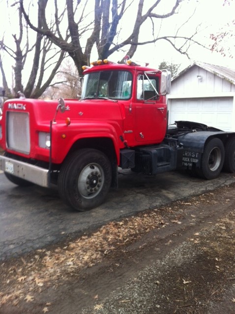

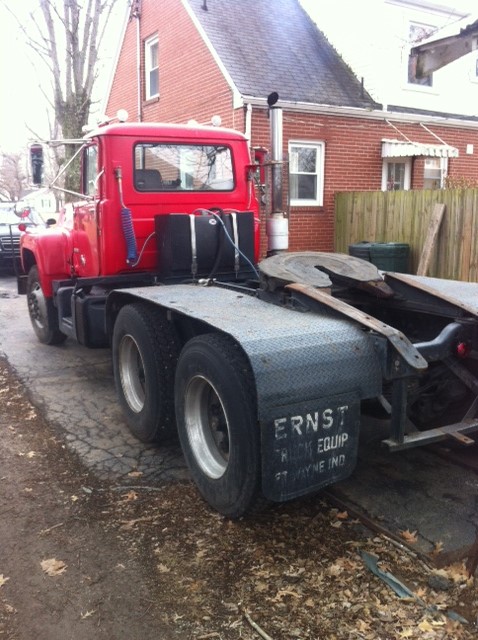

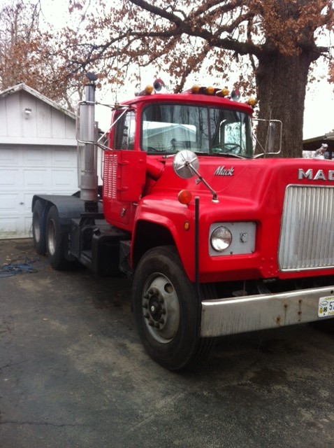

Thank you Superdog. Im definately proud to have it. It is really sound mechanicaly. ive got it in the shop, and going through it as time allows. i put all new cab lights on it, fixed the pigrail, and just finding all the little things that need attention. The engine has a small leak after its parked and shut off. it only drips a few drops though. I can live with that. Theres a few spots on the top of the cab, by the lip that is bubbled, but that wont be bad. Im having alot of fun tinkering with it. It will make life easier this spring, hauling hay, and all that. What does the switch on the far left side on top of dash do? its a two way toggle.
Yup. It turns down the front air pressure so to not slide the front tires on a wet road. Back in the earlier days, tandem drive trucks did not have front brakes. You had to have two axles with brakes, so they eliminated the front axle since it just slides with minimal weight on it.
