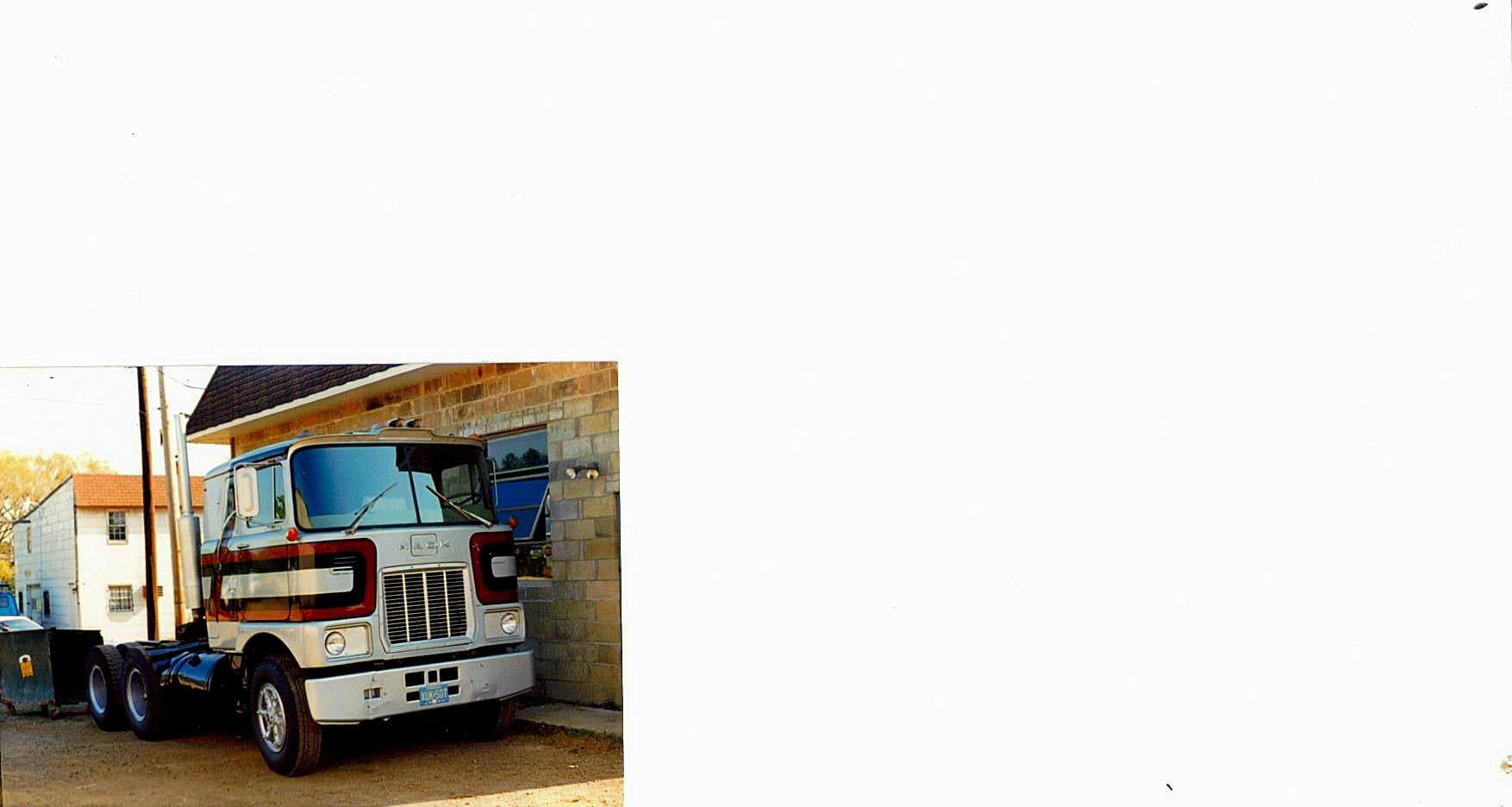

Here is a picture of an F model I found in Arkansas, I'm not sure what year it is,
its a FS700L it has a Mack 6 I think its a 300 and a 5speed trans. has something other than a Mack drive axle.
It is for sale, the guy told me it hasn't been run for about 8 years, and it is kind of rough. He said it ran good but had some electrical problems when he parked it. He wants $700-800 for it. He thinks he would get that much out of it from the local scrap yard. It only has a single drive axle.
I tried to up load a photo but I must have done something wrong, sorry guys maybe when I figure it out I'll be able to get on here, if you look where I joined there are a couple of pic's of it there.
