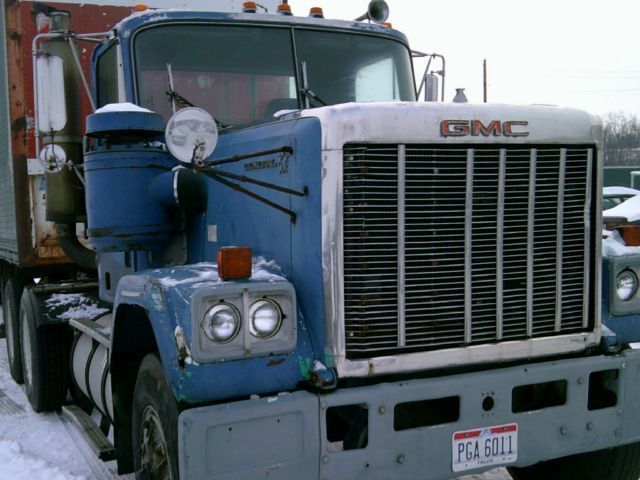

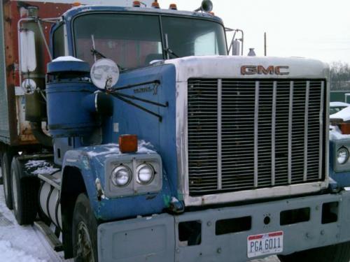

Sorry I am late to the General party. That looks like a pretty good rig your buddy found. I like the sleeper, I wish I had a 48"-60" on mine. The bodies are aluminum so they take the weather pretty decent. No worry about the rust worm. Silvers came out in the early 80's. Mine is an 84 with a Silver 8v92 in it. Fleet Truck Parts (Google it) has bumpers under $400 if you don't go nuts with style options or just click this: www.fleettruckparts.com/Truck-Bumpers/GMC-General-Bumpers.
