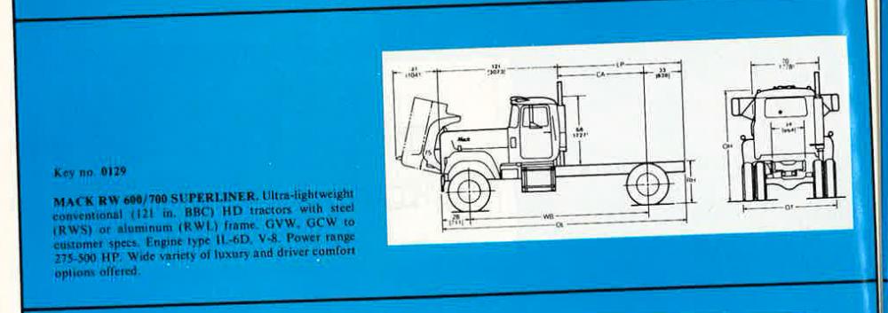

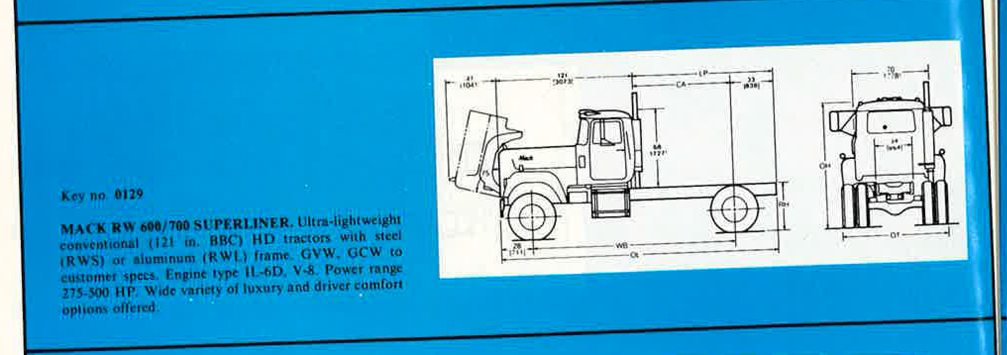

Does anyone have general dimensions of a Superliner?  Trying to ascertain basic height and width for storage purposes.  I realize some of these dimensions will vary slightly by model.  I used to get a blueprint-like image every year in new truck edition of Fleet Owner magazine back in the day.  I was able to find a scan of the RW blueprint but from Fleet Owner but, unfortunately, I can't make out any of the numbers.  Does anyone have a better image?  Or does anyone know the dimensions?

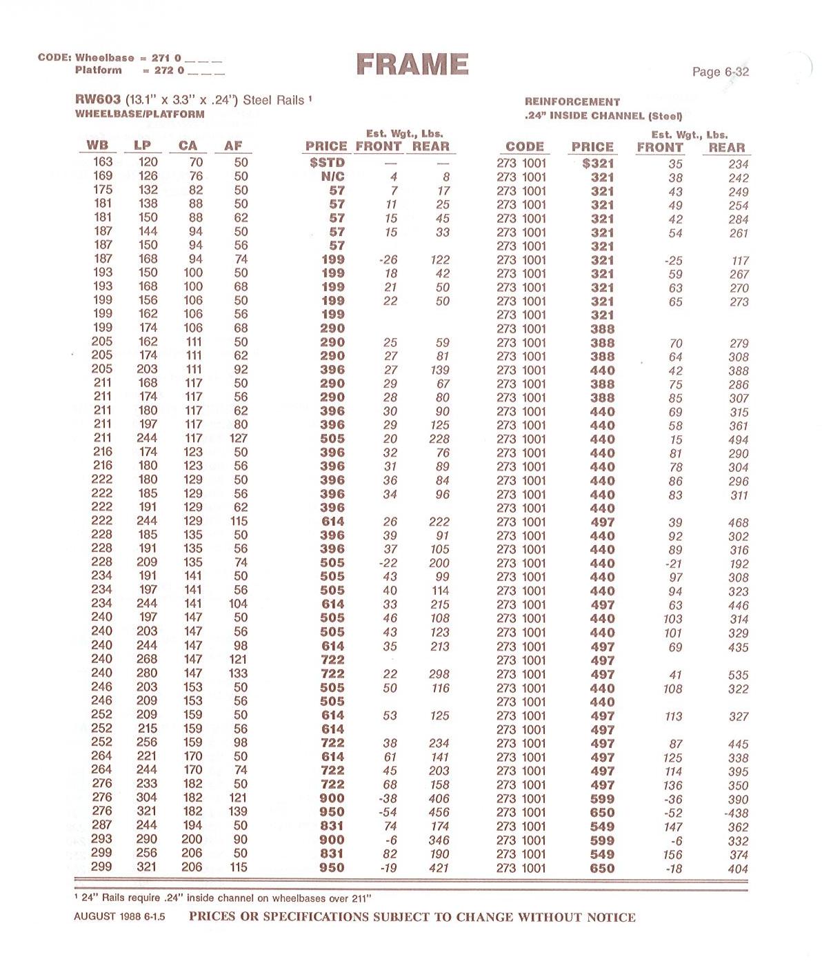

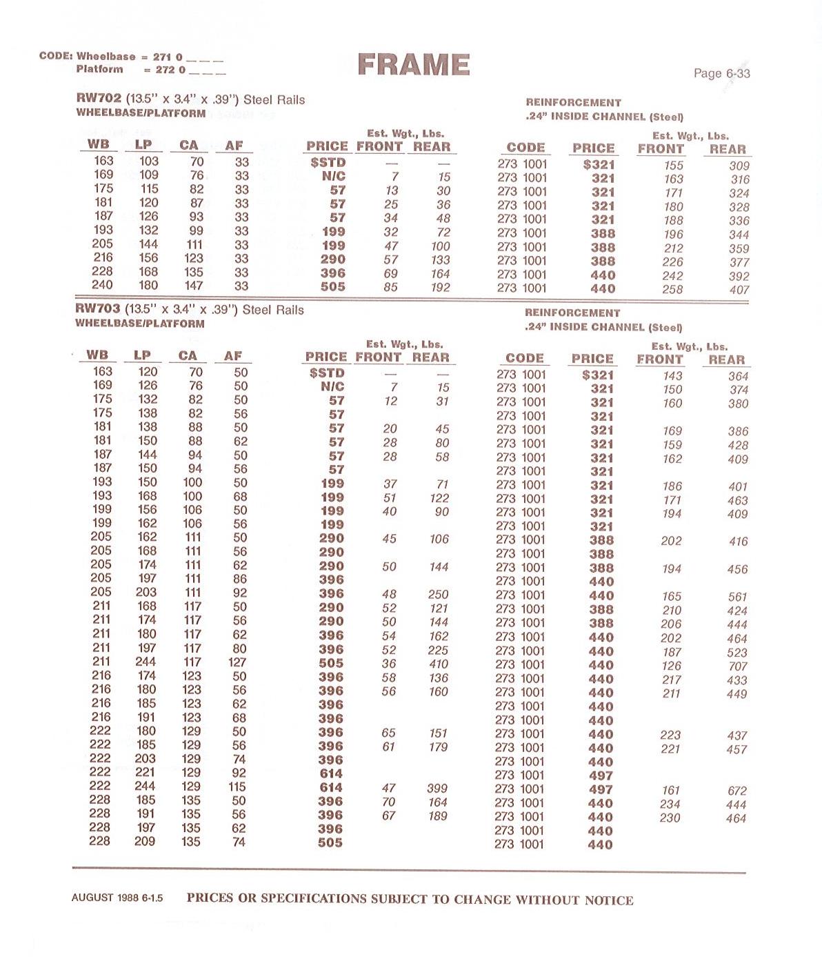

Ok, here's a question regarding wheelbase options on Superliners.  I guess Mack would build a truck about any which way you wanted it back in the 80s and 90s but surely there were "standard" wheelbase lengths.  Does anyone know what some of the common or standard wheelbase lengths were for Superliners?  I know 240" was popular for dump trucks with a pusher axle.  But how about tractors?  I presume there had to be a handful of common or popular wheelbase lengths, no?
But, by the same token, could you literally specify any wheelbase you wanted to the inch?  I'm guessing not.  Can anyone clarify the situation?

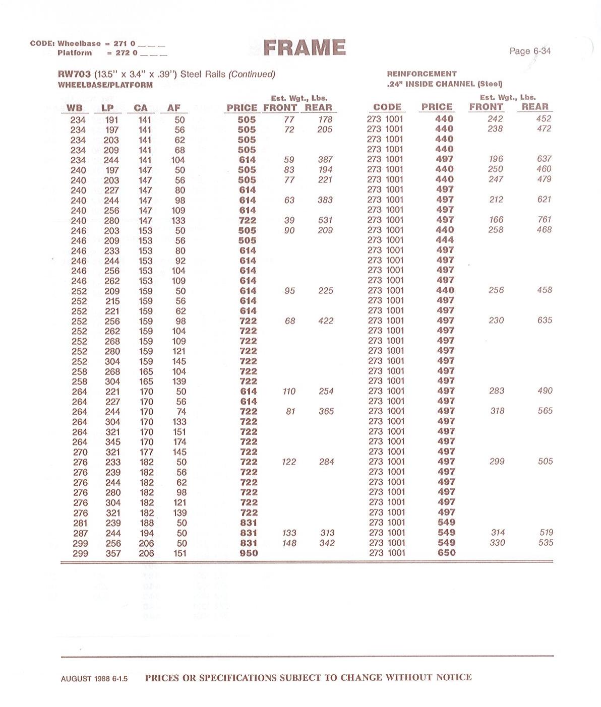

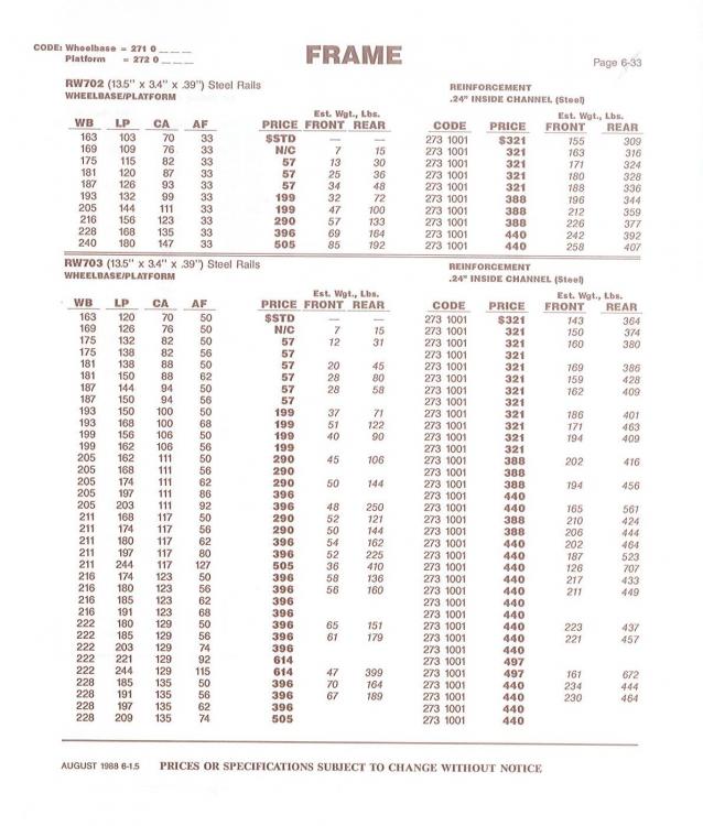

At the former Mack Trucks, we produced "custom-built" trucks. We never built "standard" trucks.
The "standard" wheelbase in the order book, for example, of a RW603 and RW703 was 163 inches. But 99.9% of the dealers/customers ordered longer.r
The RW603 was available in wheelbases up to 240 inches, and the RW703 up to 299 inches.
Thanks, kscarbel2!  Really interesting stuff.  Can someone remind me what some of those abbreviations are?  WB is obviously wheelbase.  I assume one of those other abbreviations represent placement of the rear axle and overhang of the frame past the axle(s) (AF = after frame?).  So looks like you couldn't quite specify right down to the inch but pretty close.  Looks like about 22 different wheelbases on the RW600.
Wow... can't hardly imagine a 299" Superliner.  Has anyone seen one that long (from the factory)?  Wonder what the application would've been for something like that.  Tractor or straight truck?  I'm guessing straight.  I wonder what the longest single axle configuration was?  You don't see to many single axle RWs... especially long ones.  At least I haven't.  I know Moxleys have one that's a flatbed.
