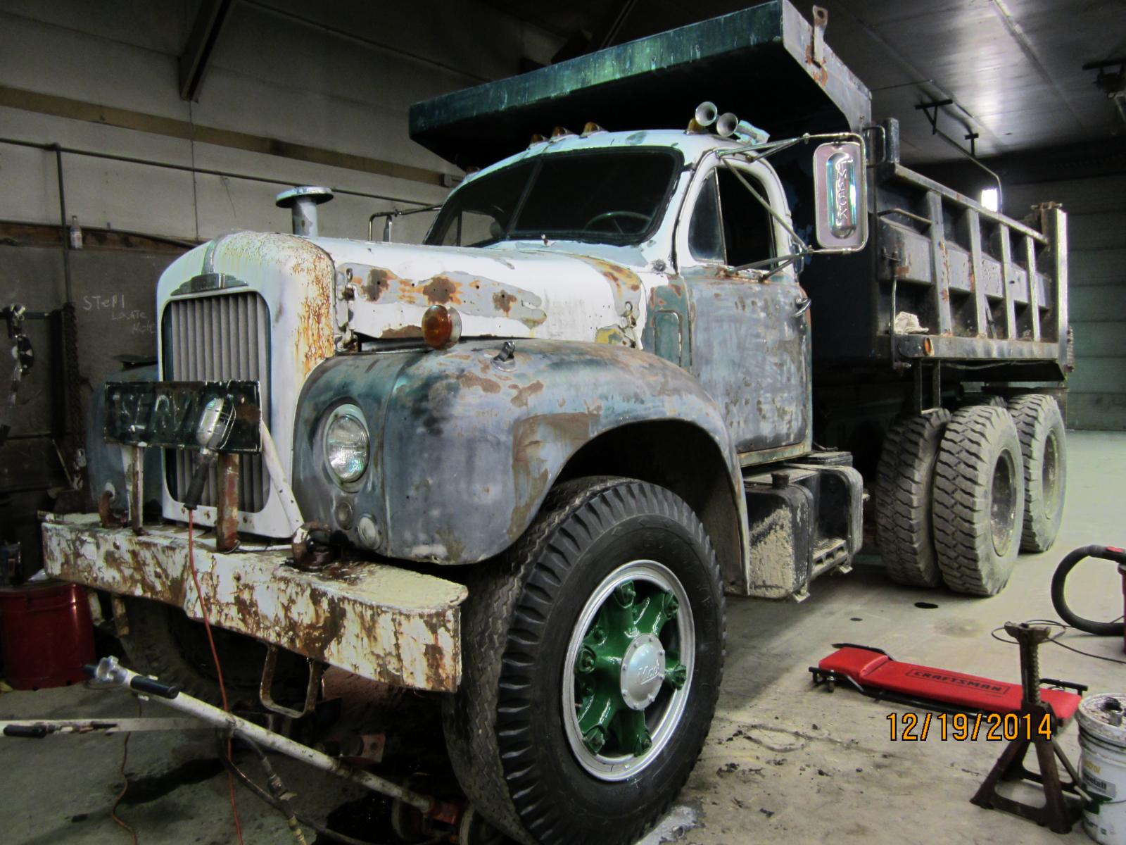

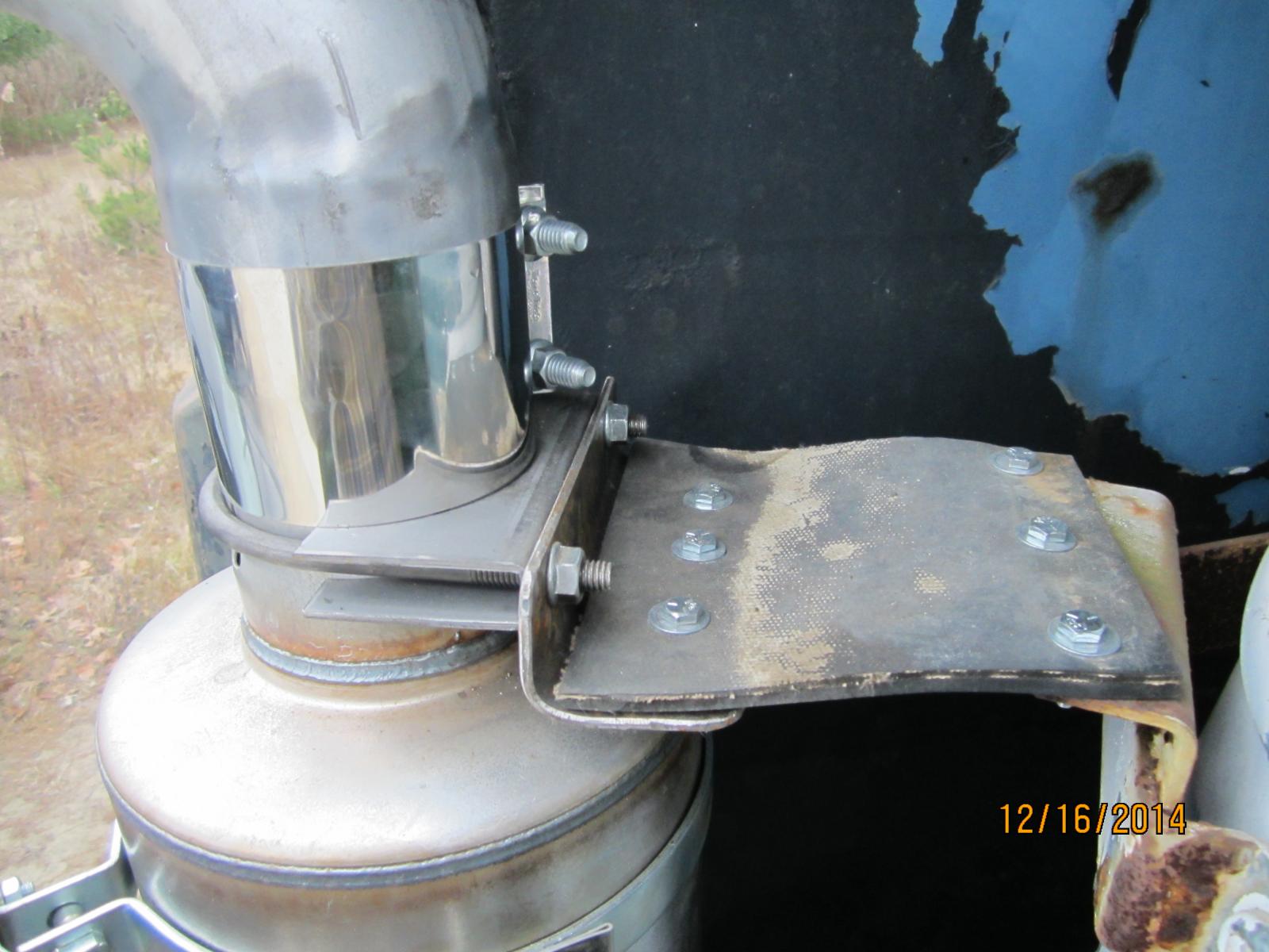

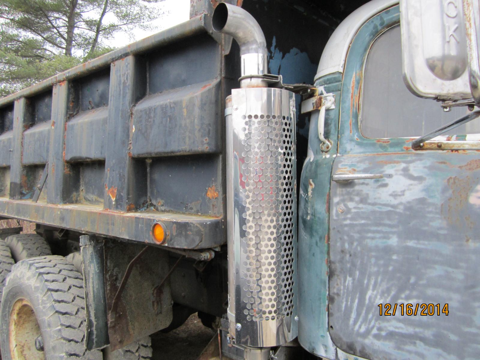

Today I swapped out the top exhaust clamp (that holds the 90 degree elbow tip above the muffler) for a band clamp. It's a cleaner look. Also, I finished the entire exhaust job by installing the top flex mount (where it mounts to the cab). I made it out of a piece of conveyor belt, which is about as rugged a material that I could find that was still somewhat flexible. I'll post close up pics of the exhaust tomorrow.
For the remainder of the day I helped my uncle on his B65. While he was finishing up some wiring and lights, I attacked the interior of the cab to clean it.
Believe it or not, the flap is almost square. The cab mount makes it look out of square. It's an optical illusion. Besides, I was working with a scrap piece of belt that was free. Any time I can get something at no cost, I happily accept it if it does the job. As you probably know, you can rack up expenses pretty quickly with projects like these. Sometimes I look at a product, part, or accessory longingly...only to put it back on the shelf or not hit "submit," LOL.

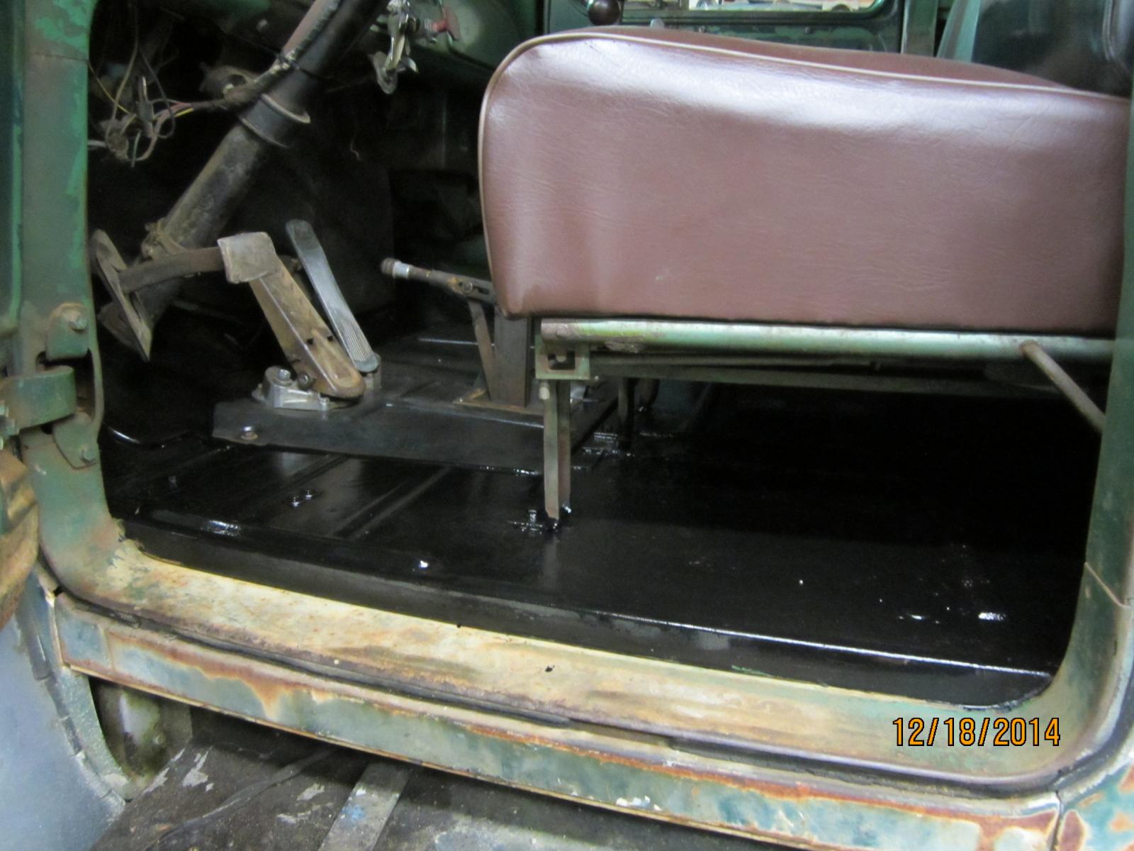

2. Remove left front wheel and address the power steering drag link.
3. Clean remaining floor boards and paint them black.

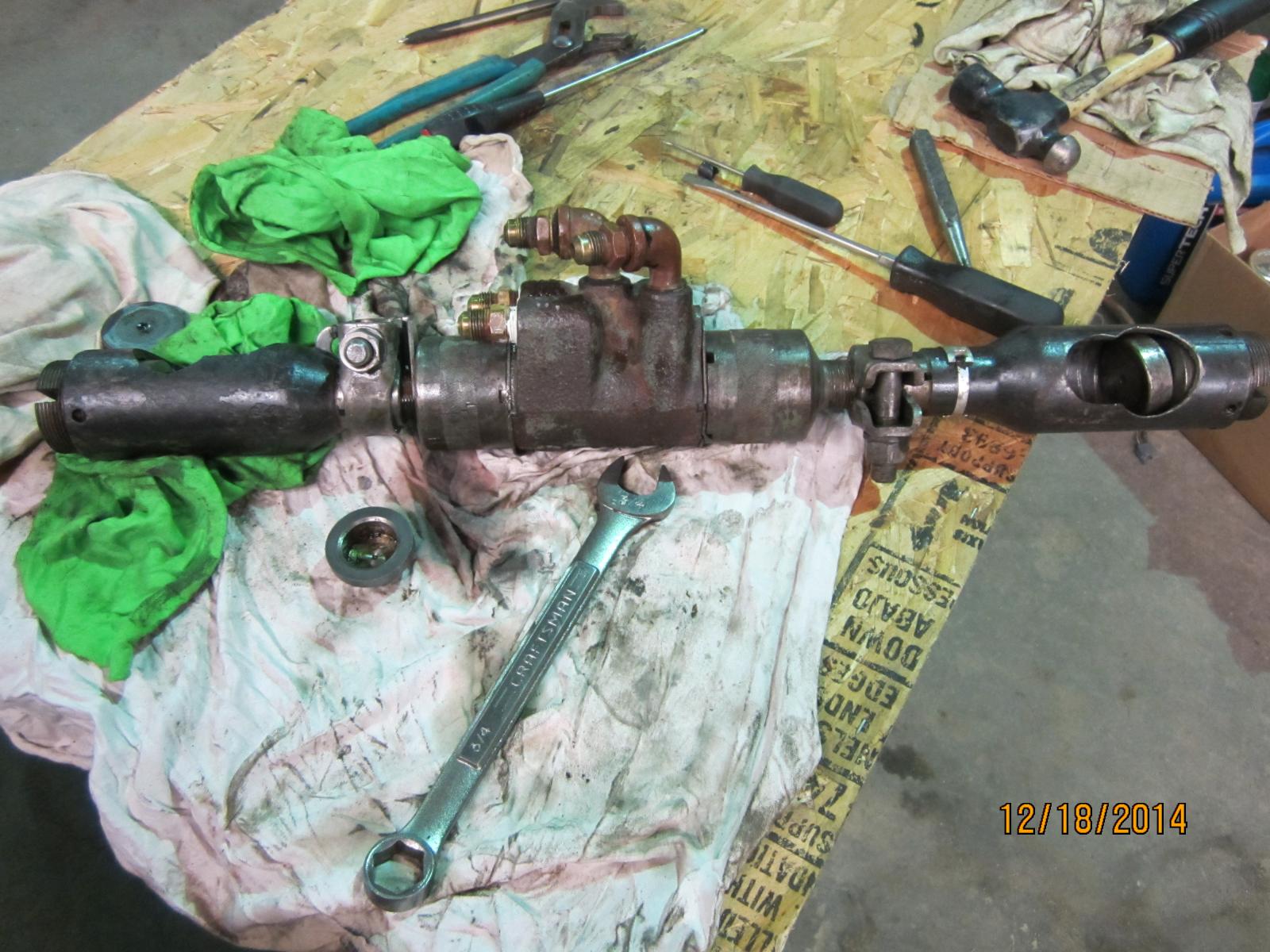

BTW, the piece of line that was in the drag link can be seen in the picture of the drag link. It's in between the tips of two screwdrivers.
