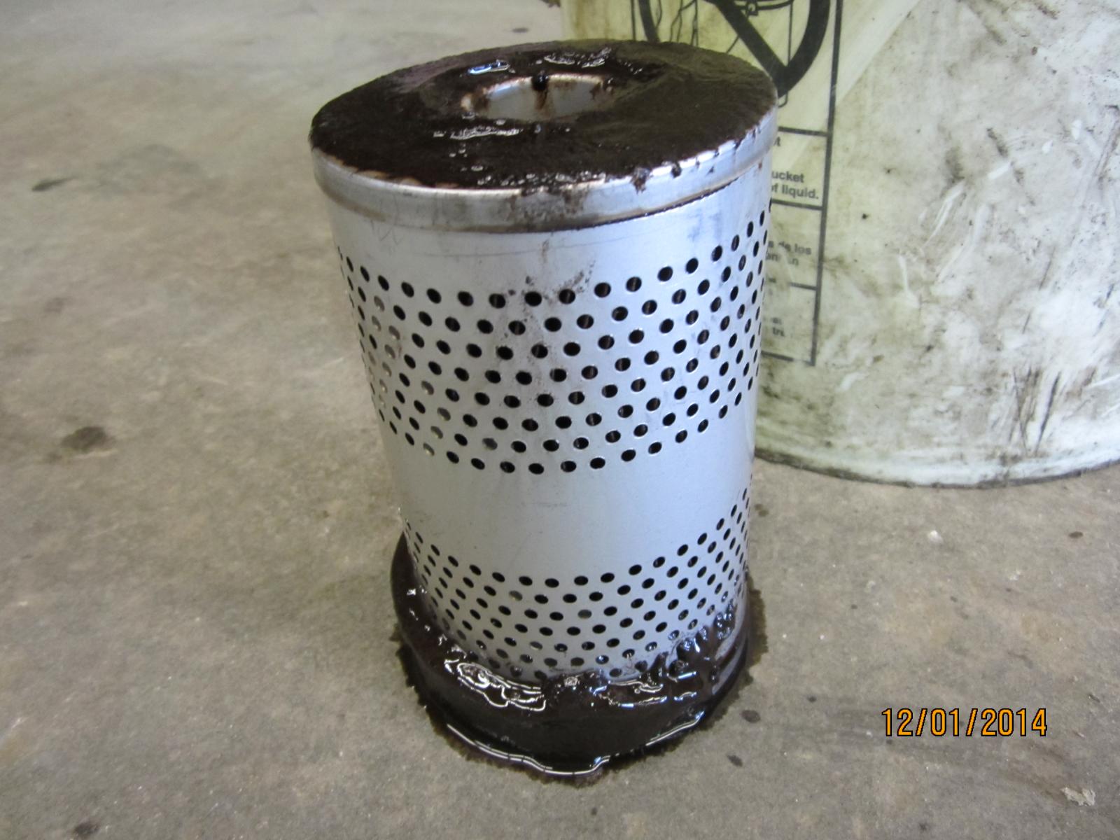

Still having an issue with air in the fuel lines. Not sure if the primary fuel filter (seal) is allowing air to be sucked in or it's just a matter of air still needing to get worked out. If it's the former, we'll have to bypass the primary, if it's the latter, it'll just take time. We've done so much on this truck thus far (in terms of servicing it), I'd like to have it running so we can enjoy driving it in the yard.
One thing did stand out to me today after we got it running again for 15 minutes or so: the throttle is more responsive than before. Given the sheer amount of sludge and muck in both the filters, it's not surprising that it snorts better now. The big surprise is that it even ran at all before.

After work I was going to bypass the primary fuel filter to see if the truck ran any better, but it ran perfectly fine so now I'm a happy camper!

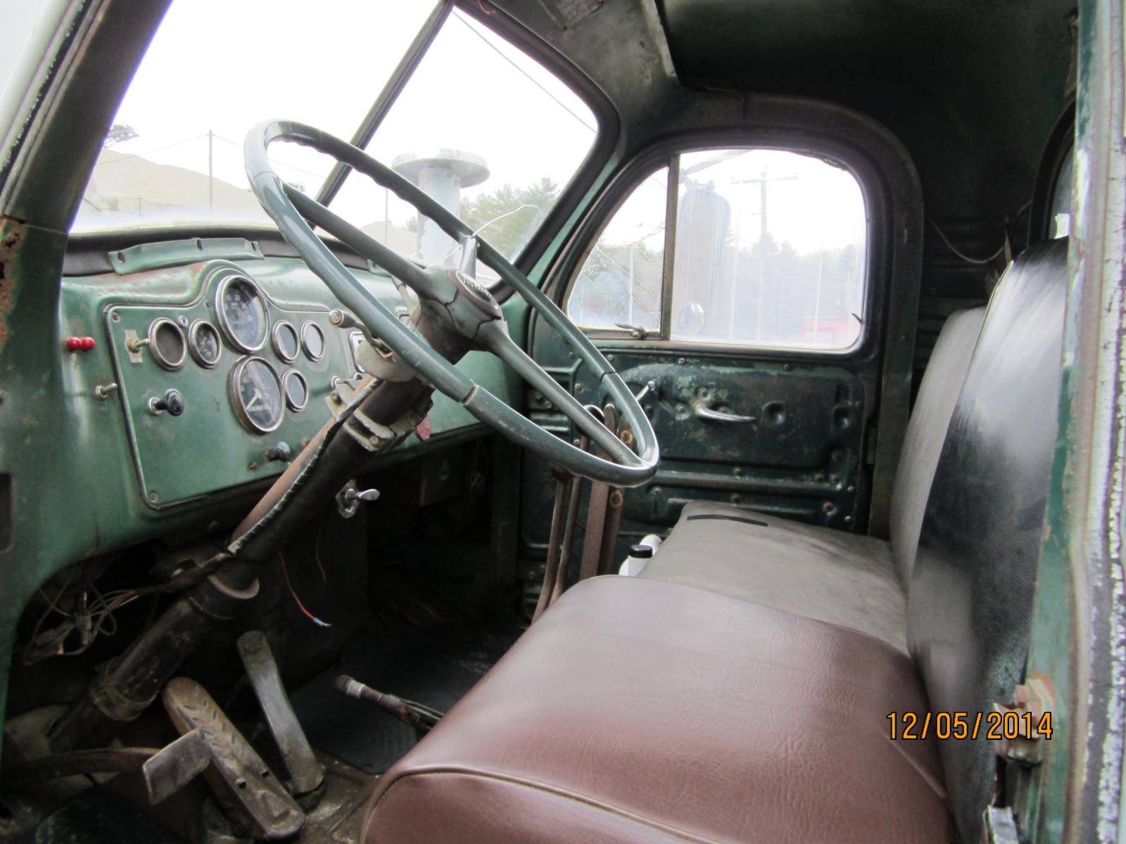

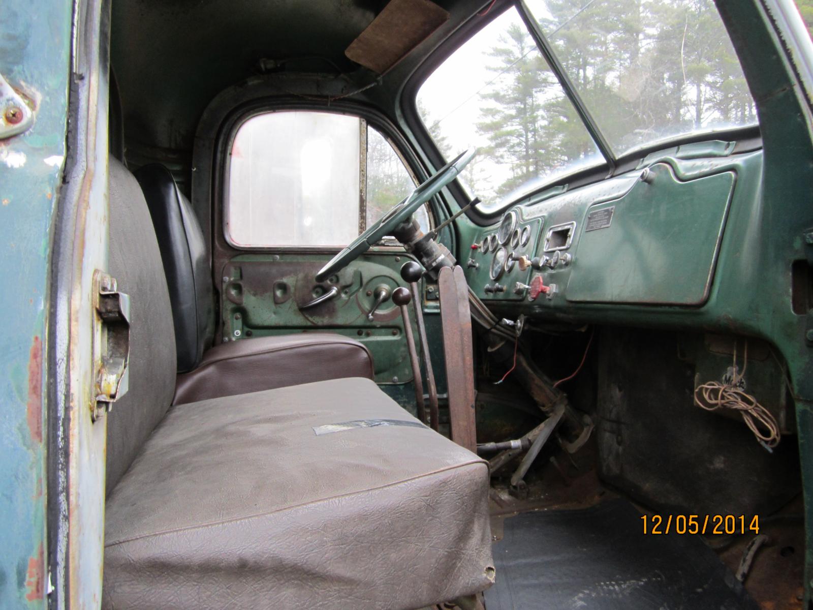

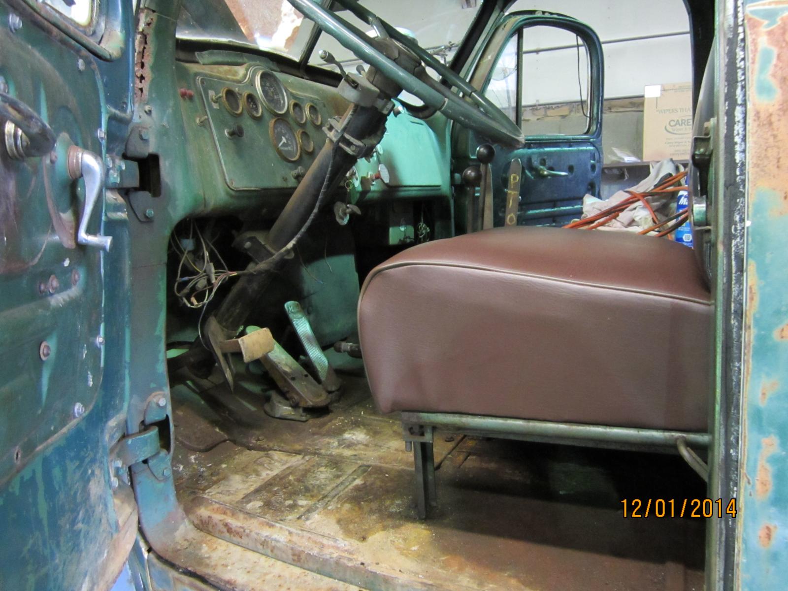

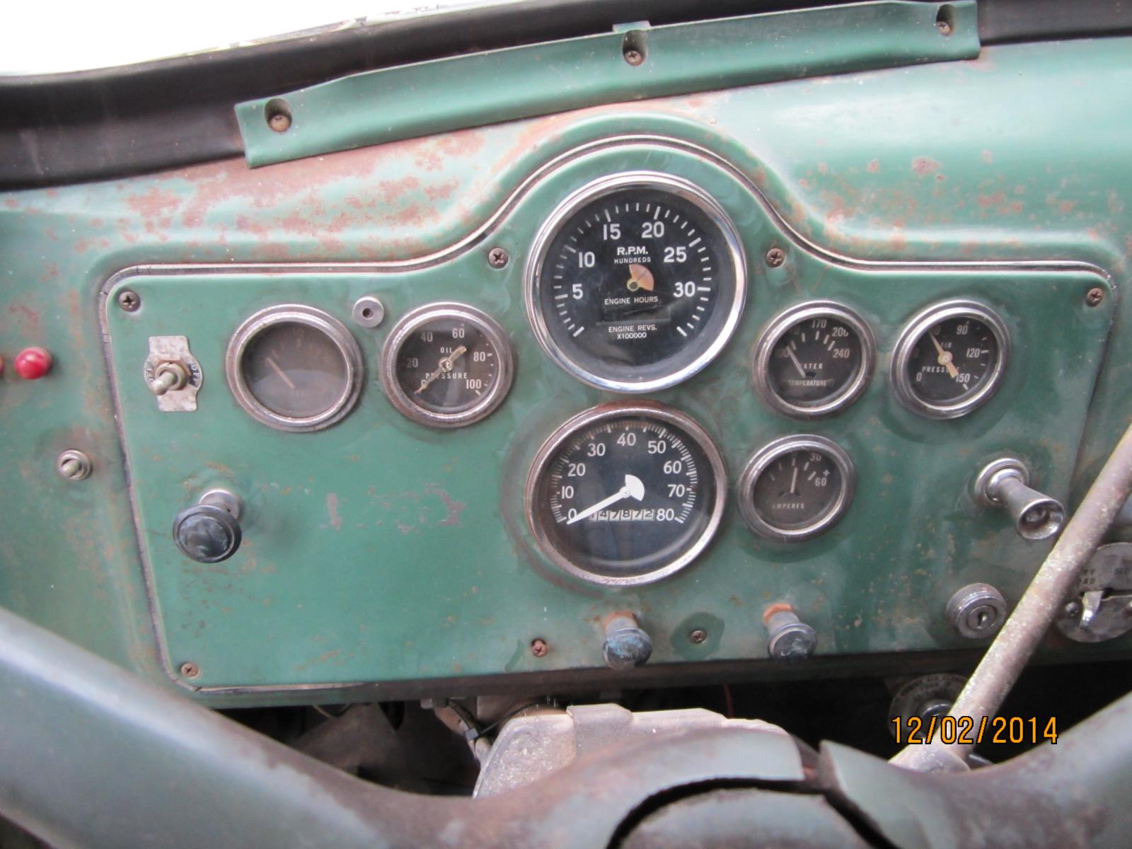

I used my time on the truck today to clean the interior of the cab some more. Here are a few pics. I'm in the process of uploading a few more videos of the truck to youtube, so those will be forthcoming shortly.

Yes, when I saw how much crap was in both filters, I ordered a second new filter and intend on swapping it out after a tank or two of fuel. Hopefully by then the fuel system will be clear. It's already a HUGE improvement over what it was before. At least now the two filters can do their job again.
You're doing a great job,keep it up.Doing all the mechanics first is the only way to go.That the first thing i do when i start a rest job on a old caterpillar tractor.Once you get it running just the way you want you can take your time on the cosmo of the truck.Love seeing your pictures.
Glad to see things are moving along and the care you're putting in to each step of the process. I second what Mike D. said about the mechanics. You're doing the safe, responsible things in the right order. You'll have so much more fun when you get it on the road knowing you're not an accident waiting to happen. Plus, EVERYBODY loves to see an old B61 go by. Start doing your left-thumb exercises now! :)
