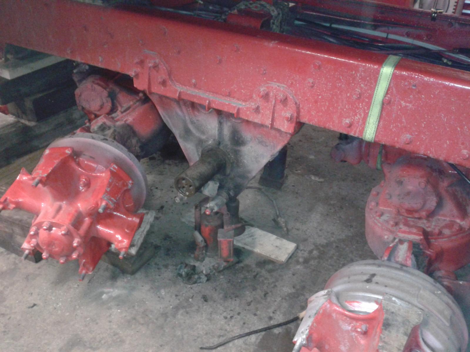

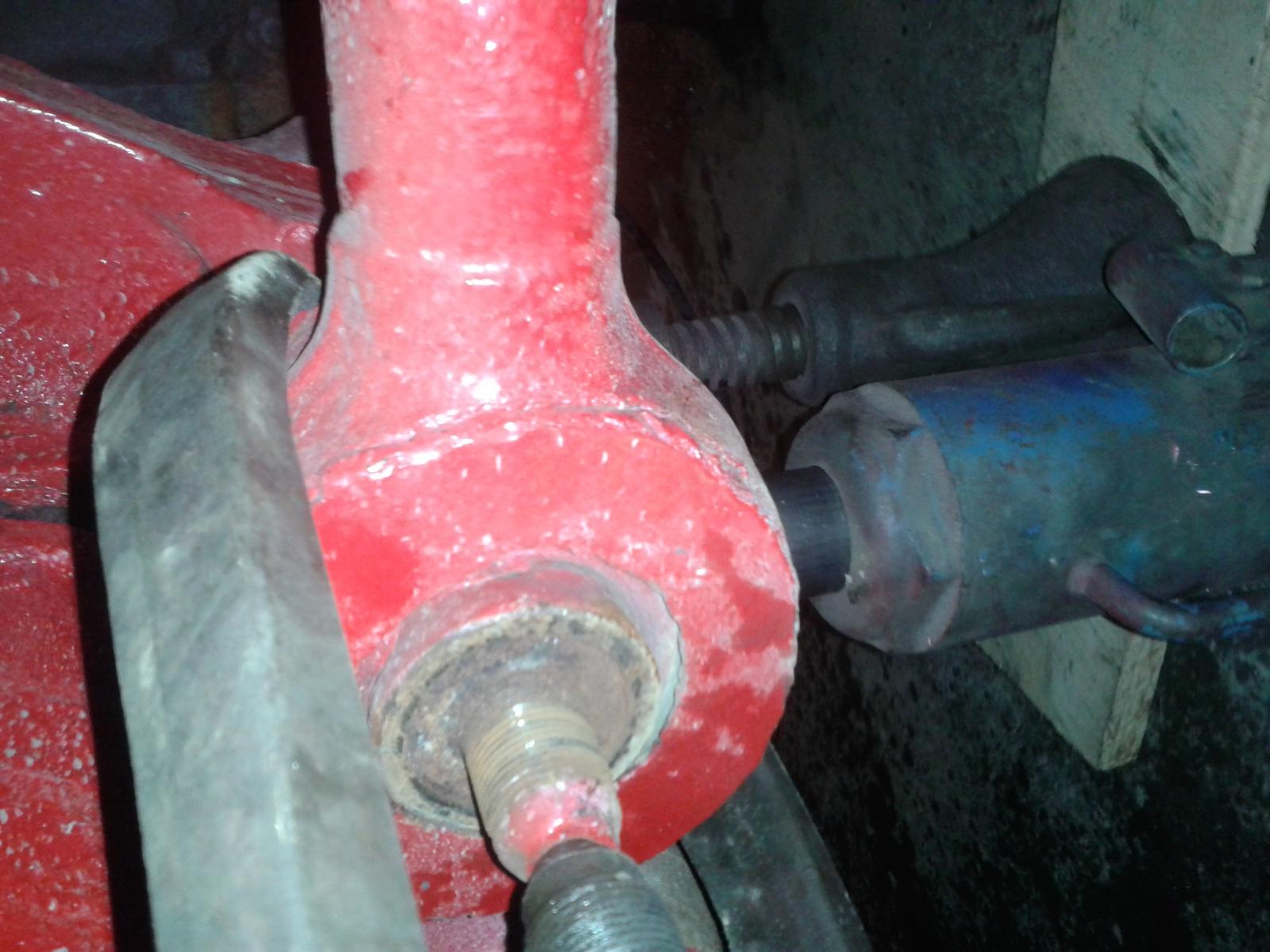

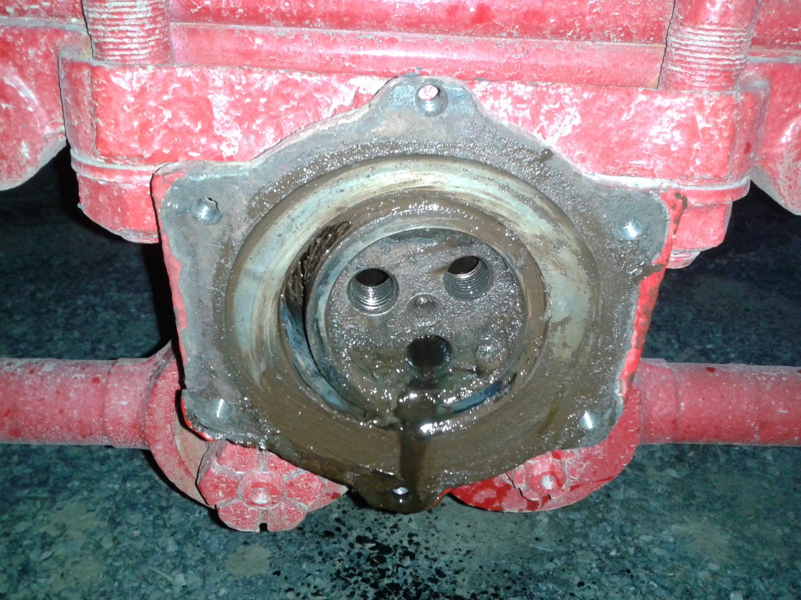

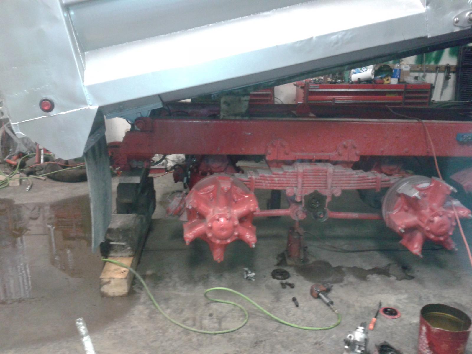

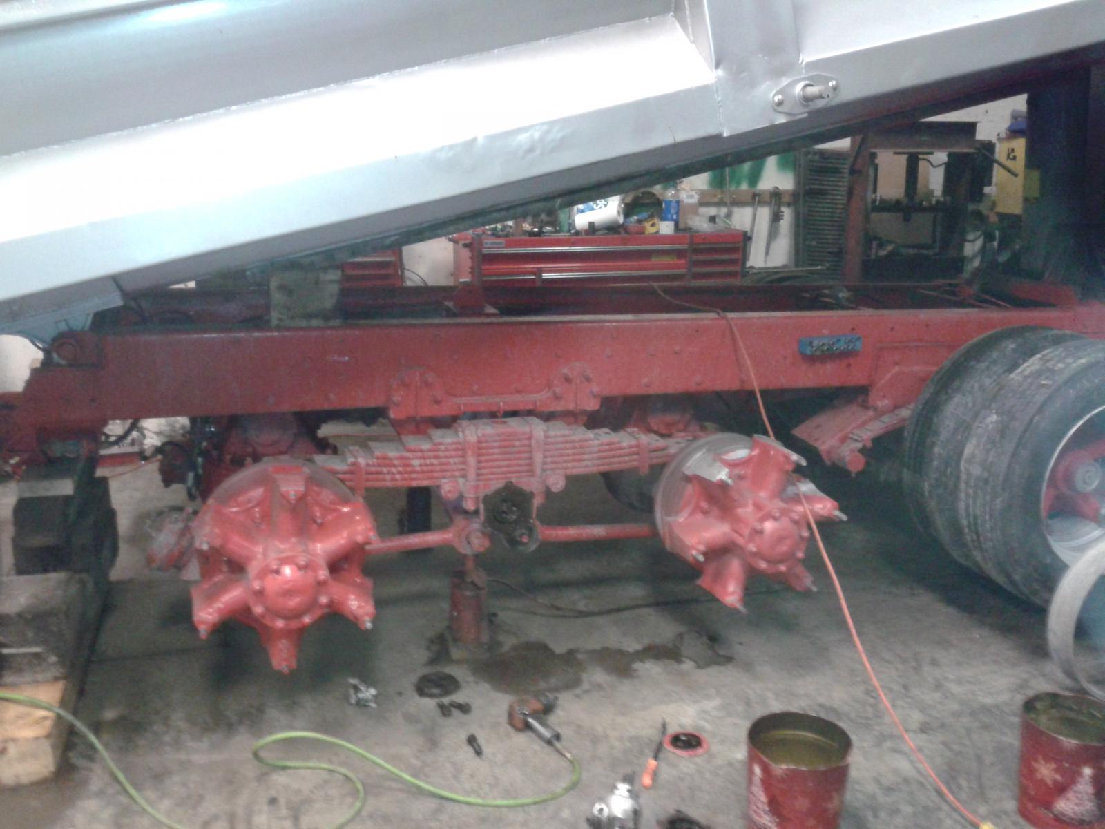

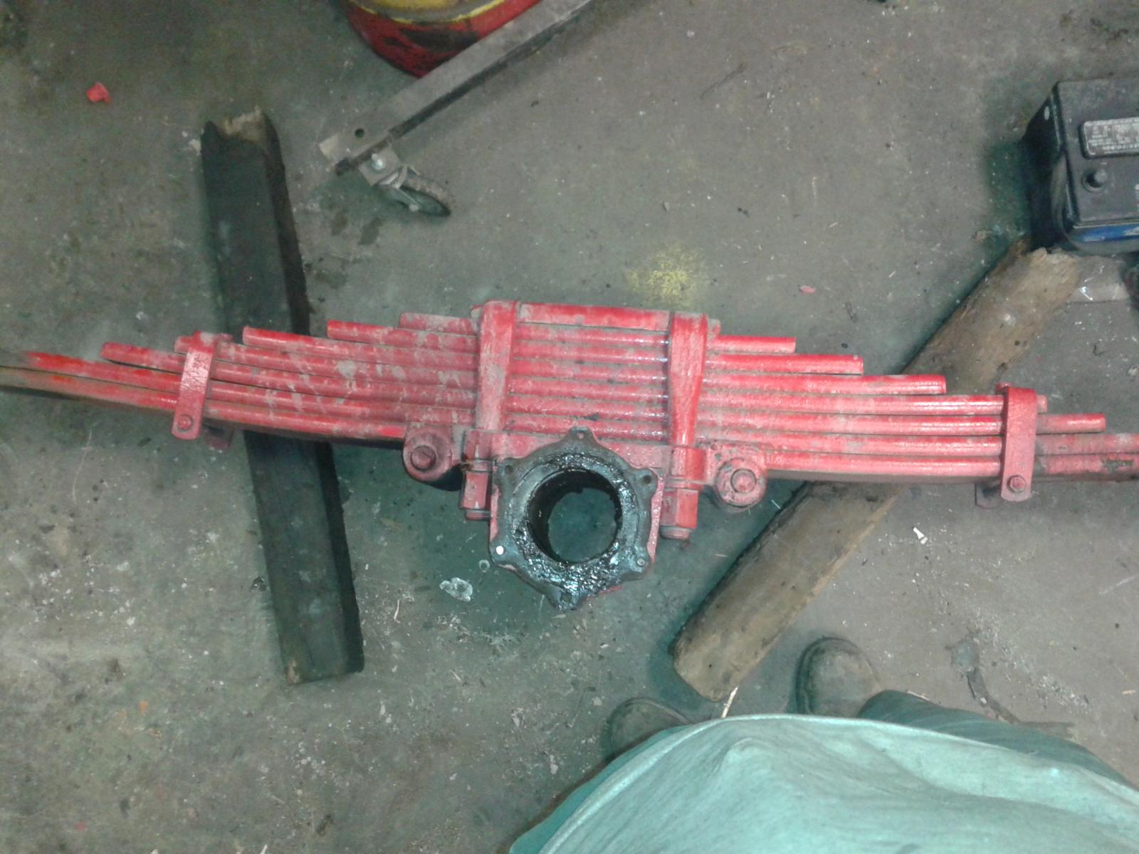

Tore into it today. My friend and i put in a full day,,,man this stuff is heavy. Tunion bearings... what trunion bearing. The main beam is shot. notice how you don't need to replace bushings you can just weld steel plate over them. Hope to have everything disassembled by the end of the weekend.post-2286-0-00894900-1420334695_thumb.jppost-2286-0-34271900-1420334772_thumb.jppost-2286-0-09624100-1420334805_thumb.jppost-2286-0-94308400-1420334846_thumb.jp
That trunion shaft still isn't out. I' am tempted to cut it out but i need to know that i can get a replacement first. I called Stengle bros. they can get me the bushings but they need part numbers look up the other stuff. How do you look up parts for a brockway? i think it is an AC6u suspension but how do i know exactly.
