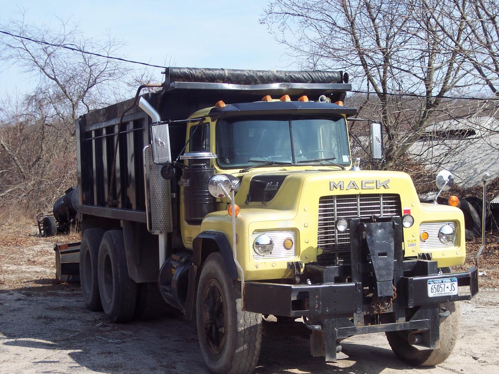

Hi guys. I work for a small town and been here about a year. The truck I'm plowing with this year is a 1990 RD688SX. From what I hear is that there is only 8 of these made, its a old NYC fire truck. Now it has a 10 yard sander in the dump body with a 10 ft. plow on the front and a 10 ft. wing plow. The problem is that it has no power, from a stop up hill I wait about 20 seconds for the boost to build enough to move and sometimes thats not enough. I just did a valve adjustment and all filters are changed. I would like to turn this up but the place I was going to bring the pump to wants $1600-$1800 and I don't have much money to spend. Also I'm worried about the automatic Allison thats in it. Is there something that I'm missing? Or is this just a 270HP engine? Thanks for any feedback!!

Sorry guys, its a old NYC truck. I'm not sure if its highway or sanitation or PW. It was a bright lime green when we got it and it had a plow on it. Anyways I dont see any turbo leaks and the turbine seems good. I don't seem to have any fuel restrictions, (return or feed). All cylinders are running about the same temperature. What I don't understand is why it takes so long for the boost to build, (15-30 seconds)? It's so bad that if I was loaded and came to a stop uphill, I may not be able to pull away! Sometimes I have to back up and get a running start.

Sorry guys! My pictures aren't showing up. The puff limiter on this is on the back about the throttle or govenor. I really cant find a small pecker anywhere! (I'm French!) I can't even find a relay valve on the intake. The air line to the puff limiter comes from the intake manifold direct. It seems like the vaceum from the manifold controls the puff limiter. Thanks again for all your help! Steve.
