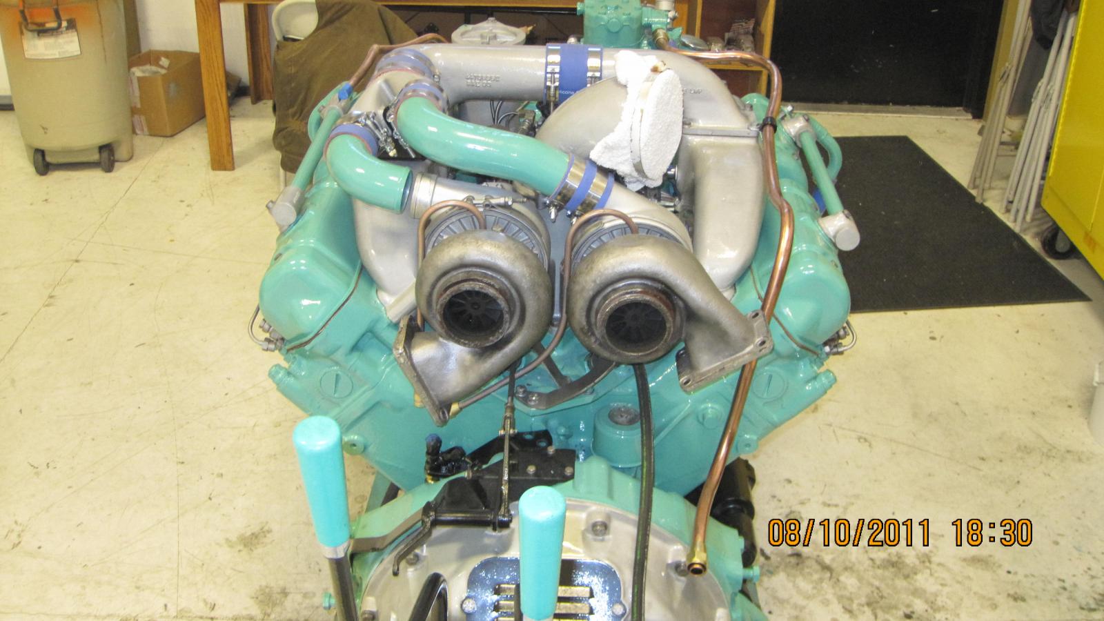

On 10/17/2014 at 10:25 AM, mackdaddy said:
I have 3 of the B755's all with the L cab. I have never seen a B7553 but there must of been a few. And yes they would have been a twin turbo. Most interesting to me is that they built the 864 which should have been considered an experimental engine, through 1972! Begs to ask why? and who for? Both the 865 and 866 were in production then! I attached a word doc on the production and years.

Just was looking for photos of the 864s and came upon this thread on BMT.
Would a B-755 with an ENDT864 carry a model number extending out to fourth digit being a 3 to denote a turbo charger.
I've never seen model numbers carried out to the fourth digit. Or if they ever made a B75 with a turbocharged 864 would it be a B759. As in F715 versus F719?
