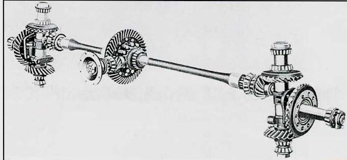

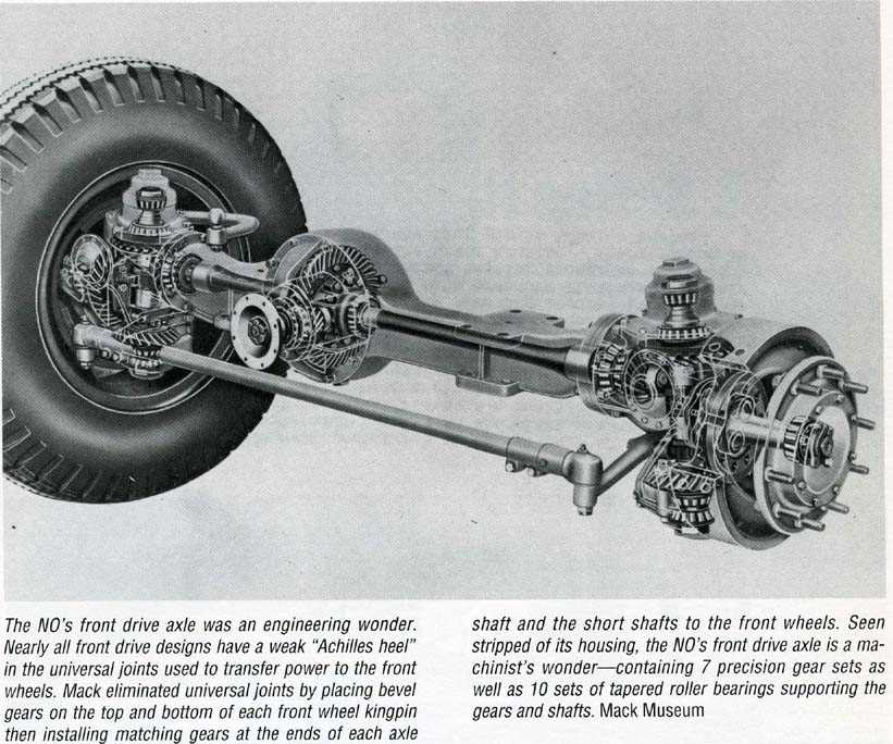

The MACK FA49 elevated front axle was used in most all military MACK chassis up to the 1960's at least probably to the 80's for military units. The Bevel gear drive is wear resistant and nearly unbreakable for use with limited repair or maintenance facilities
post-3242-0-22423900-1404321486_thumb.jp
post-3242-0-96162100-1404321547_thumb.jp
wear resistant and unbreakable,you can bet Volvo shit canned that design.
I'm a mechanical Engineer and that design is absolutely beautiful. I'd like to shake the hand of the guy who's head that came out of. It is inspired, based on simplicity and durability in design. There were no cheap a$$ worries about it costing an extra buck it was made to work and work well for a long time.
It must have been a pleasure to work out and see built.

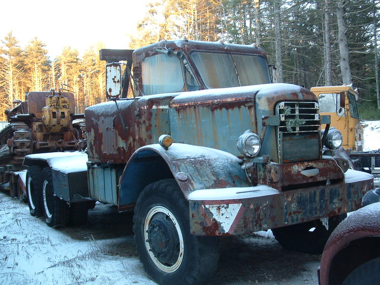

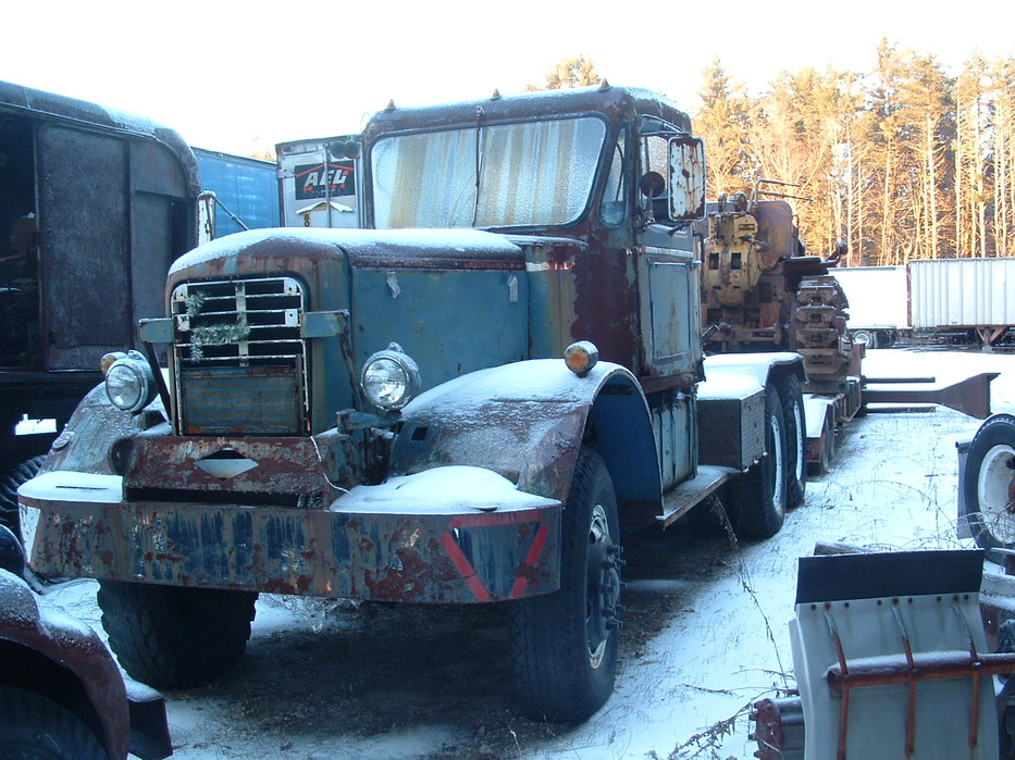

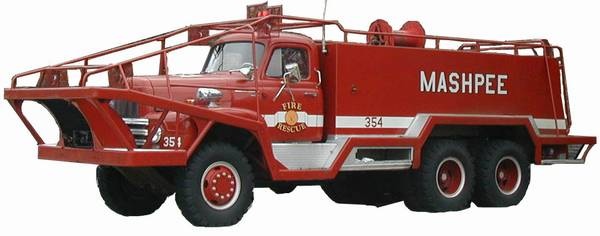

Here is a new 1956 doing what it was made for up Cape Cod way. Like us it is mostly scrub pine
