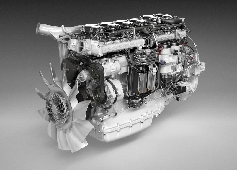

The new Scania engine model – DC13 147 – requires neither a variable geometry turbocharger nor an EGR cooler.

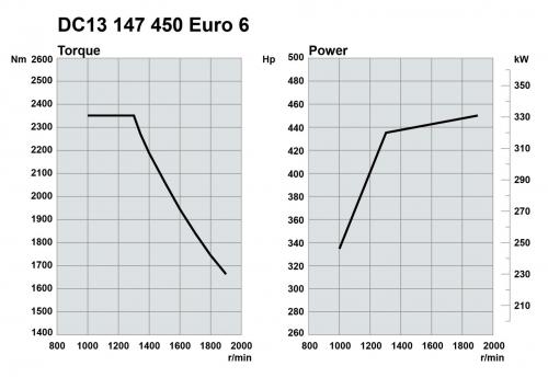

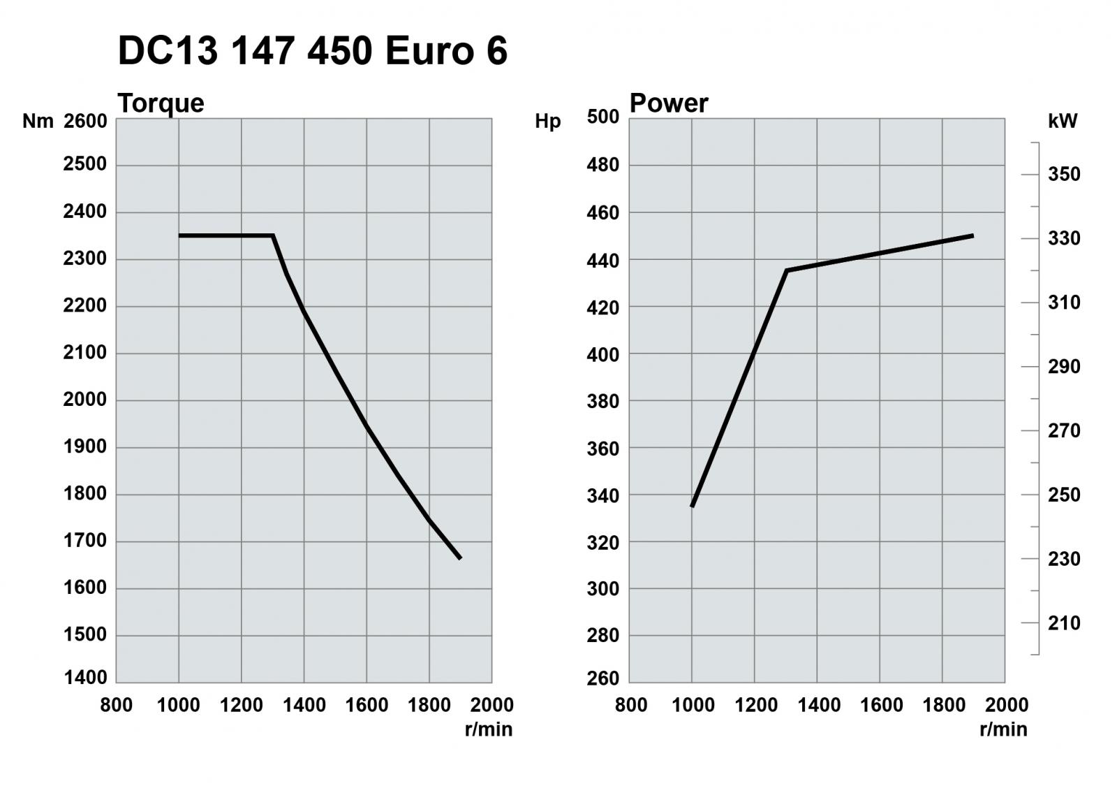

The new engine model has, just like its predecessor, a very impressive torque: maxi­mum torque is 2,350 Nm and is available right from 1,000 r/min, which assures very good driveability.

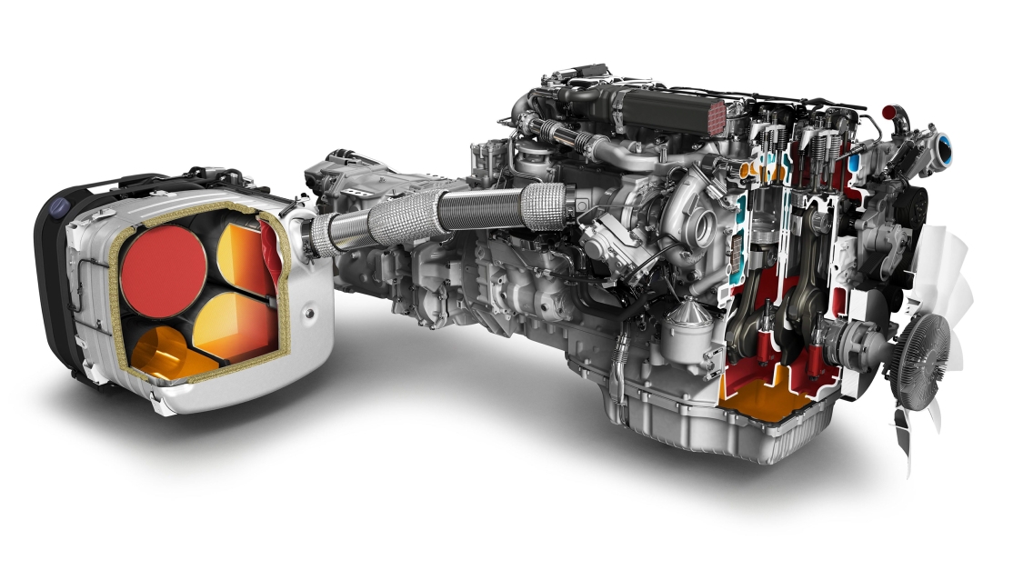

Scania’s new 450hp non-EGR powerplant meets Euro-6 (EPA2010) emissions levels using only SCR. As a result, the engine is inhaling 100 percent fresh air without any reduction in oxygen levels.
Unlike engines with EGR, no percentage of fresh air intake is reduced, displaced by recirculated levels of exhaust gases (typically ranging from 18 to 30 percent).
Without EGR (exhaust gas recirculation) piping, the “SCR only” powerplant realizes a weight savings of 88 pounds (40kg).
Scania’s pure SCR solution also allows the use of a fixed geometry turbocharger rather than a more complex variable geometry unit.

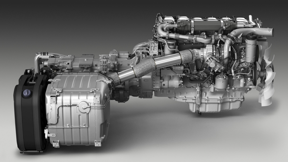

Exhaust aftertreatment remains the same, using a Tenneco-supplied module including an upstream NOx sensor, a diesel oxidation catalyst (DOC), a diesel particulate filter (DPF), AdBlue dosing module, two parallel selective catalytic reduction (SCR) catalysts with ammonium slip catalysts (ASC), and a downstream NOx sensor.
Note that muffler and aftertreatment are brilliantly integrated into one compact module for efficient chassis packaging.
