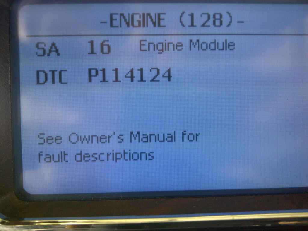

Still chasing a mystery engine code that nobody seems to know anything about.

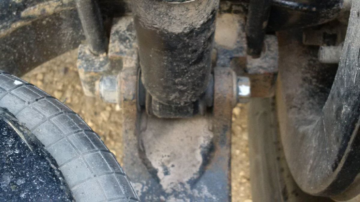

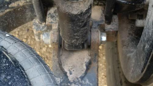

Another fault is the shock mounts. I recently went thru a CVIP level 1 and was given a warning that the shocks were loose. I pointed out to the officer that the brackets are made of 5/8" solid steel and it's impossible to draw it tight enough to keep the shock from moving. He gave me 7 days to repair it. All I could do was squeeze in a thin washer to take up the slack, but that only lasts a couple weeks and it wears thru the washer.
