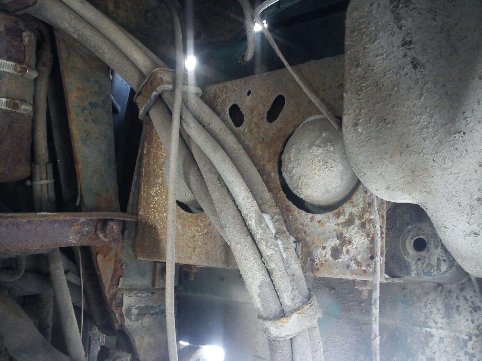

The semi-spere with the pin wich is on the cab might be fitted into the lower (chassis) part on my mind.
It comes in but doesn't lock there. I just not shure how it should be correct to work.
From the pics you posted I can see those two semi-spheres can couples and gets off when a cab is almost up.
If so what the way the lever in the cab is carried? Mine is just hangs in the rubber boot.

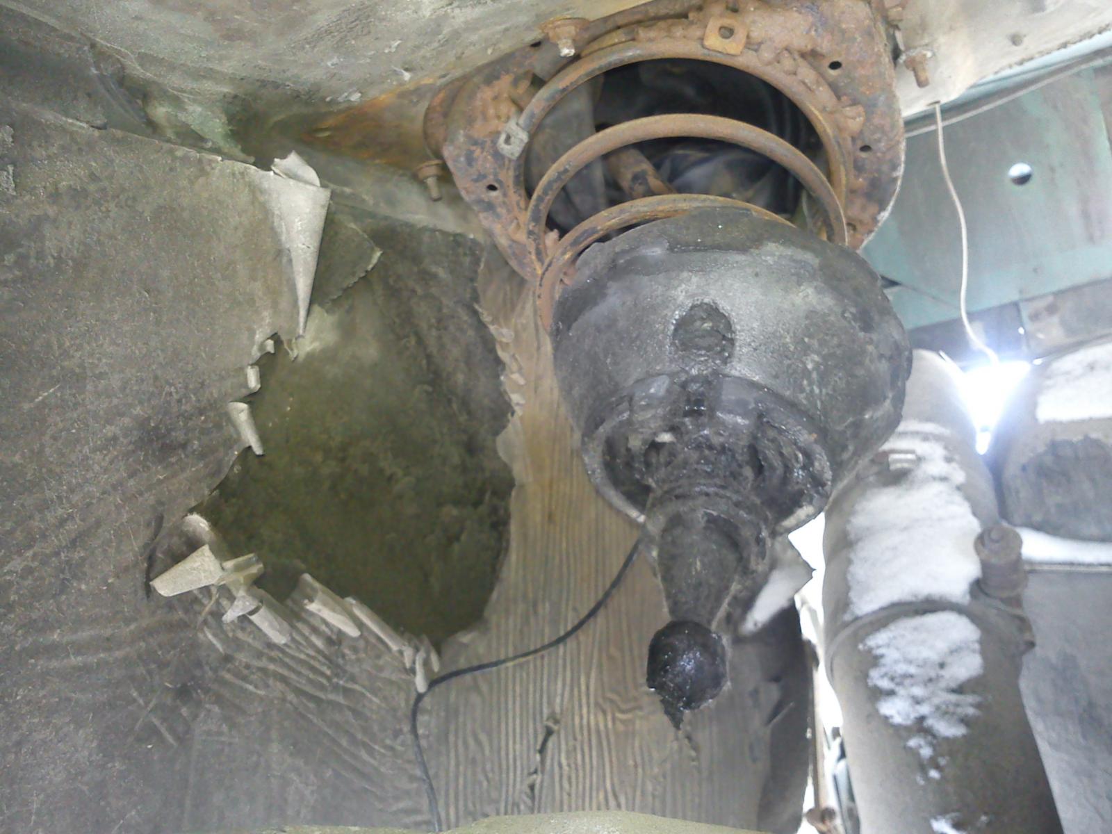

And it seemed to me that the airbags to support the cab are almost gone.
Still trying to figure out what it was layed on...

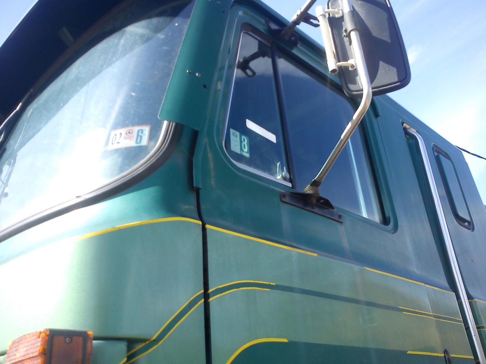

Good deal for you Vlad. The stickers on windshield are 25 is the weight class it is registered for in Pennsylvania. The 02 -6 is a pennsylvania Inspection Sticker,it tells which year and month safety inspection is due. The New Yok State HUT is Highway Use Tax permit for New York State alone.You had to file miles to New York State to pay additional tax. Several States have them they are called a third tier tax.A little side note of where I live there is a small town by name of Moscow,Pennsylvania. It is in the Northeast section of State. Joe D.

The "02-6" sticker also makes sence, the truck was imported in Russia in early 2003.

Looks like the RH cab air bag is GONE! Is the LH one there?

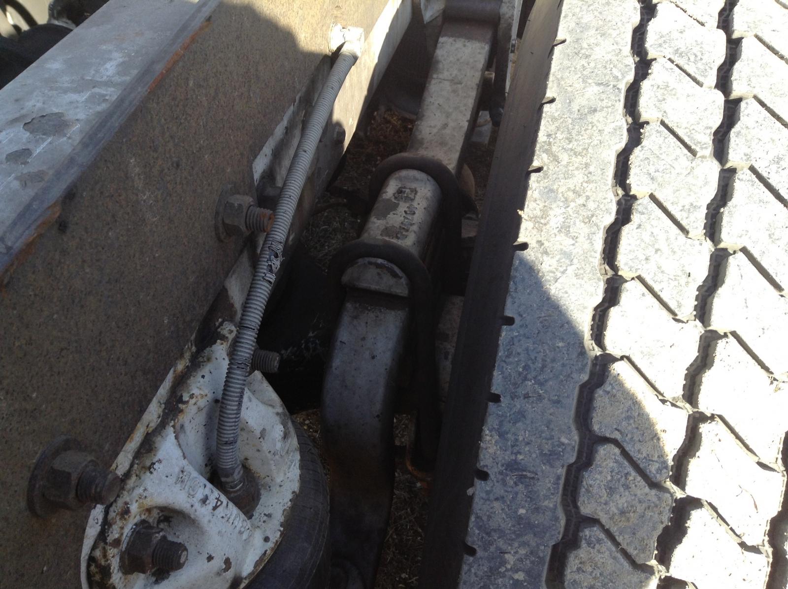

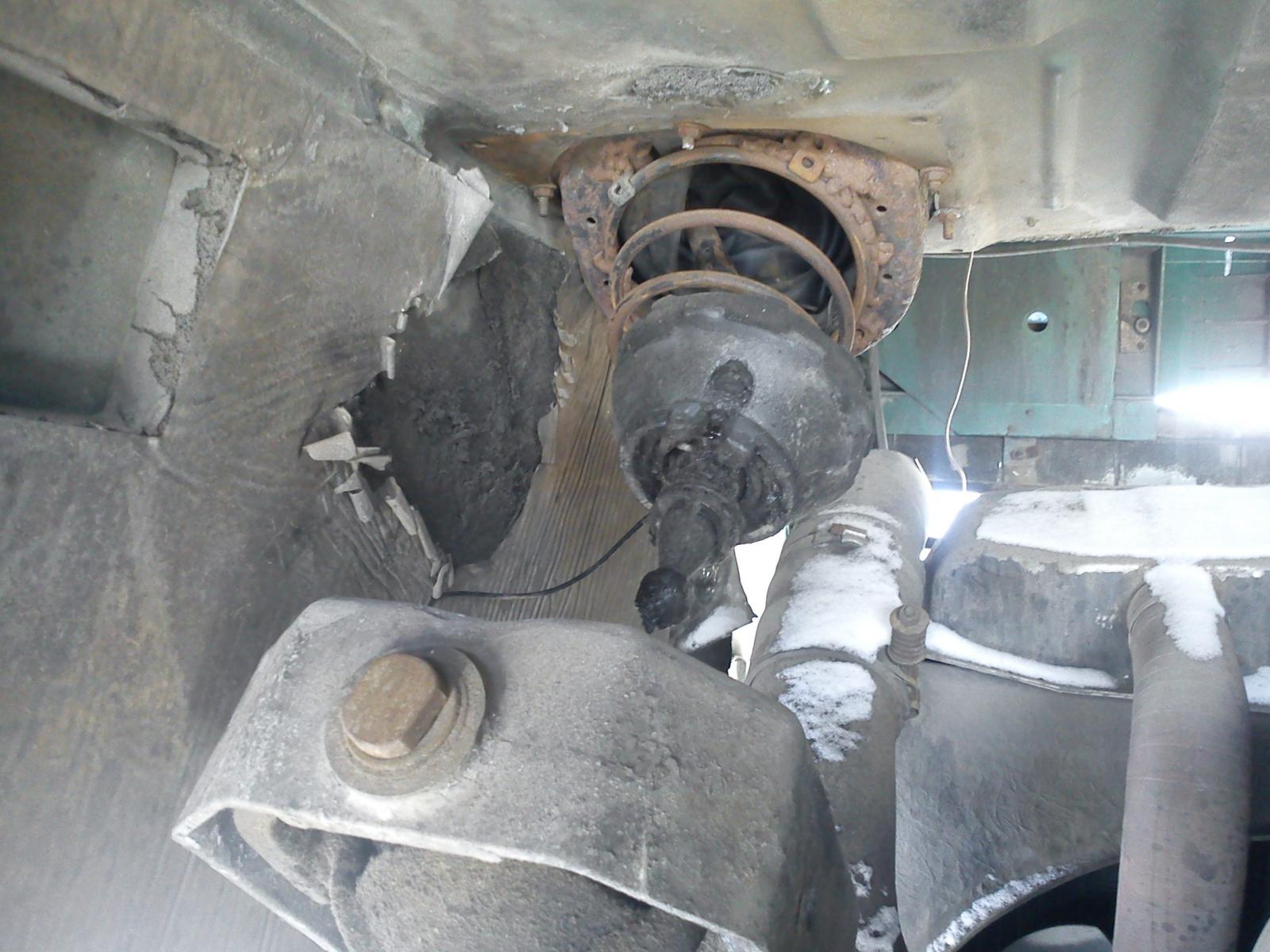

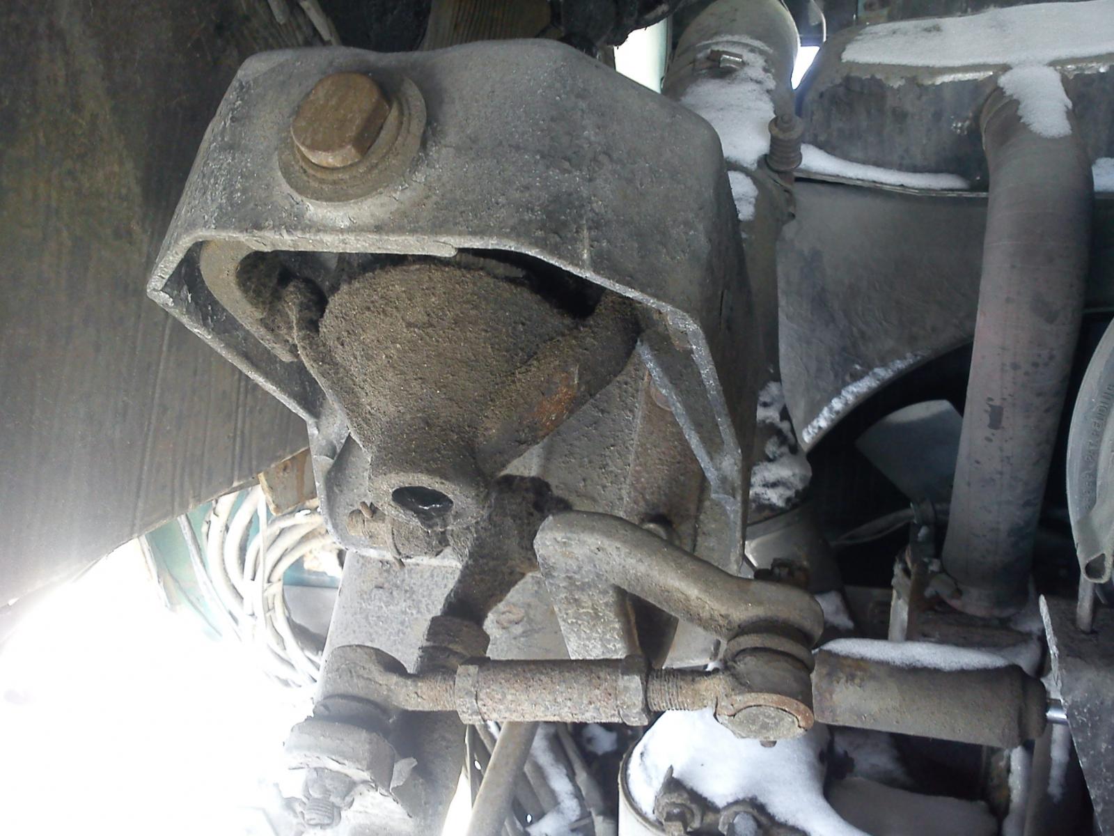

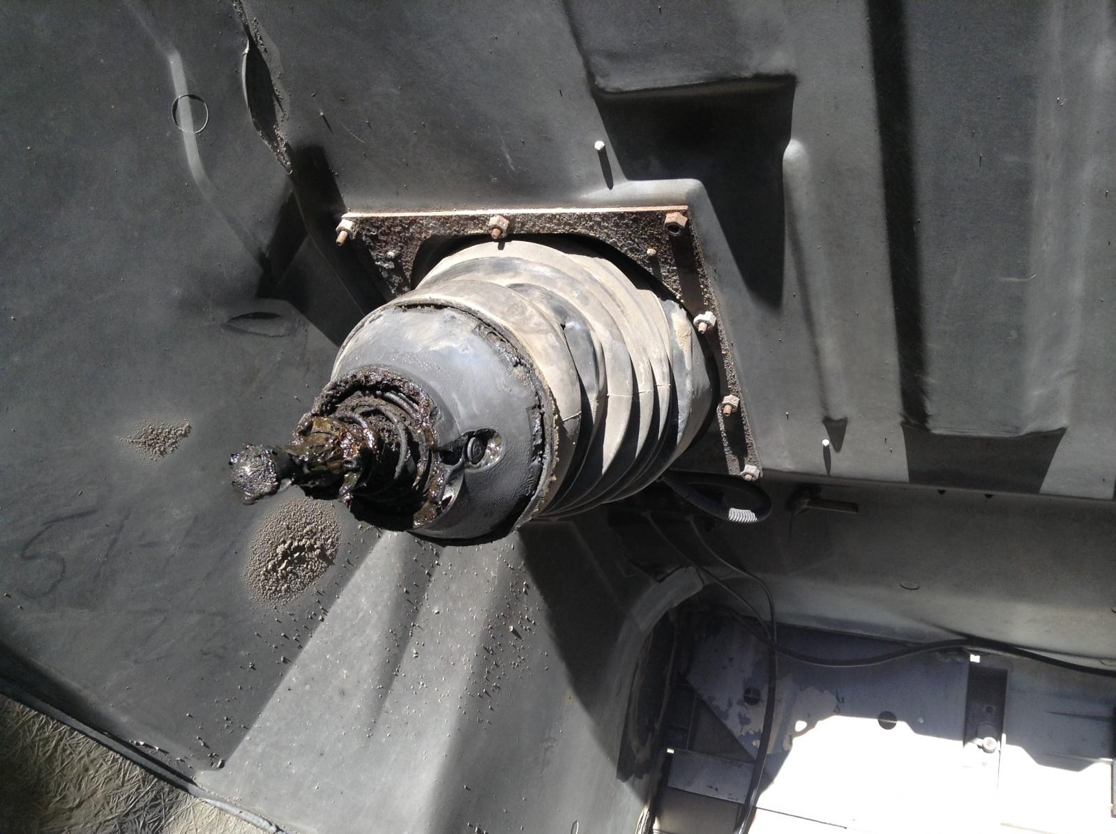

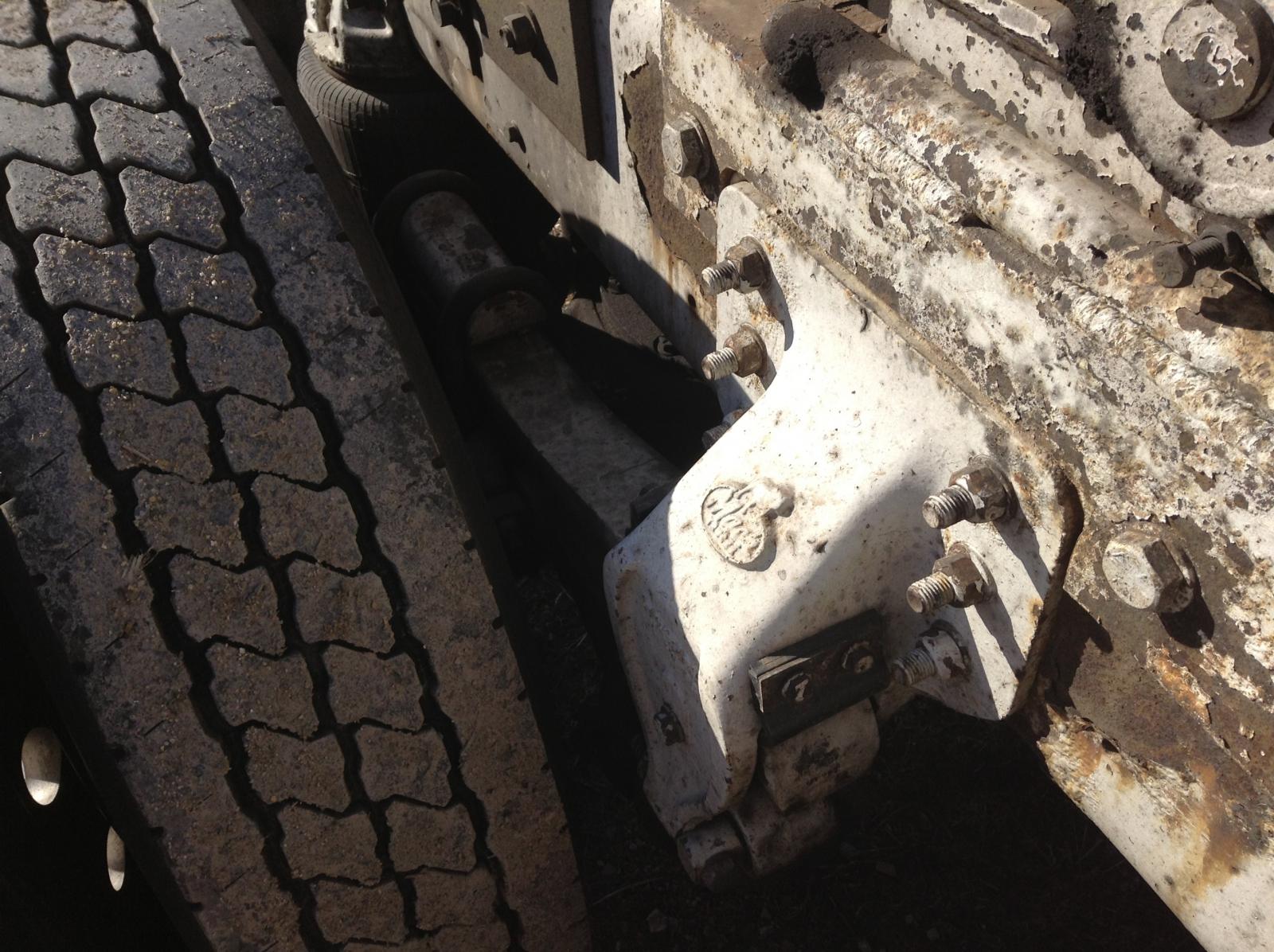

Hey Vlad. Just checked it out.from what it looks like it just the spring and the rubber boot holding the shifter. I didn't take it apart but looking at it I'd say its just floating around. Hope that made sense.
post-2708-0-15916300-1396817454_thumb.jp

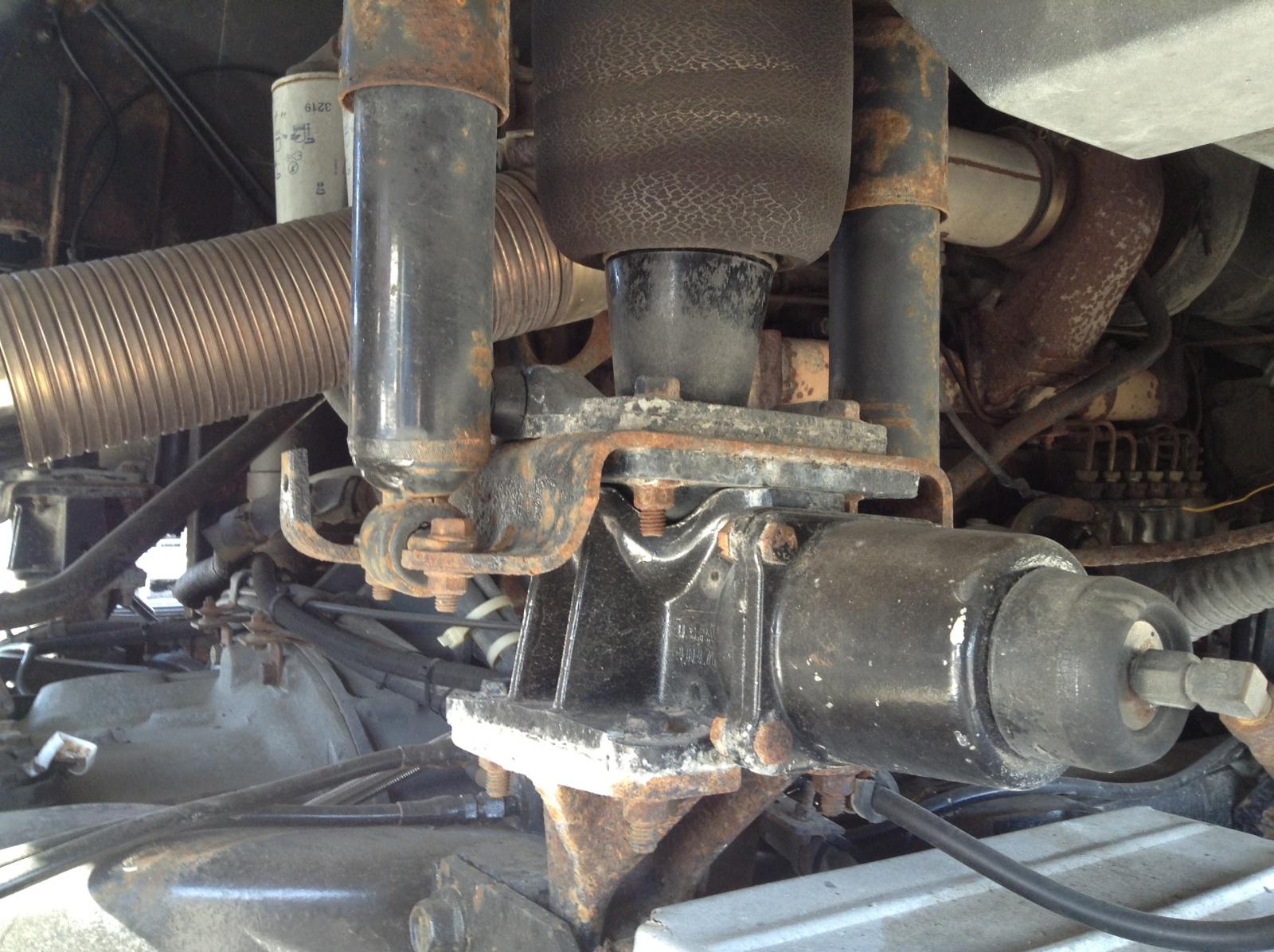

And the air ride for the cab.
post-2708-0-16671700-1396817527_thumb.jp
post-2708-0-97213700-1396817689_thumb.jp

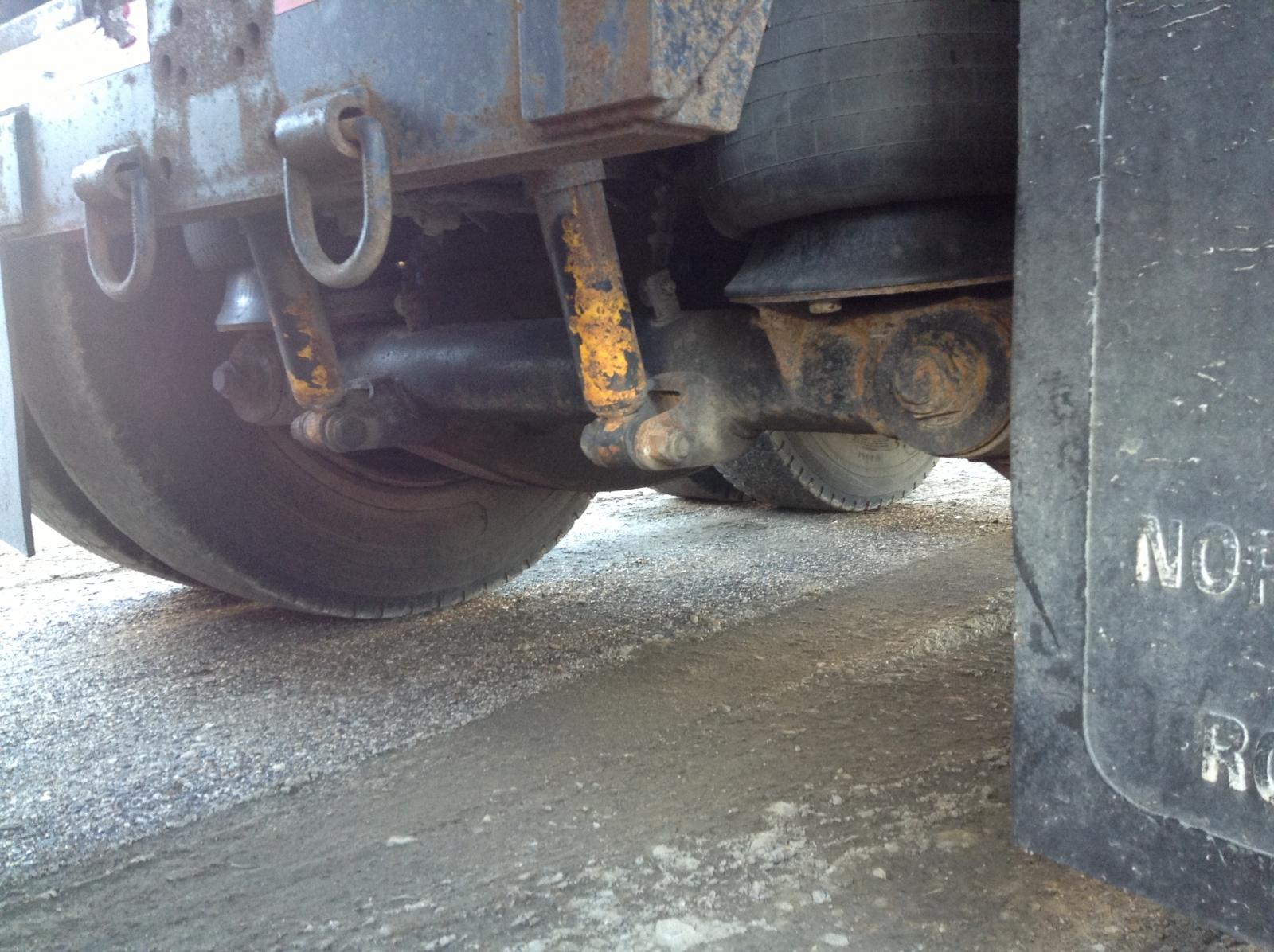

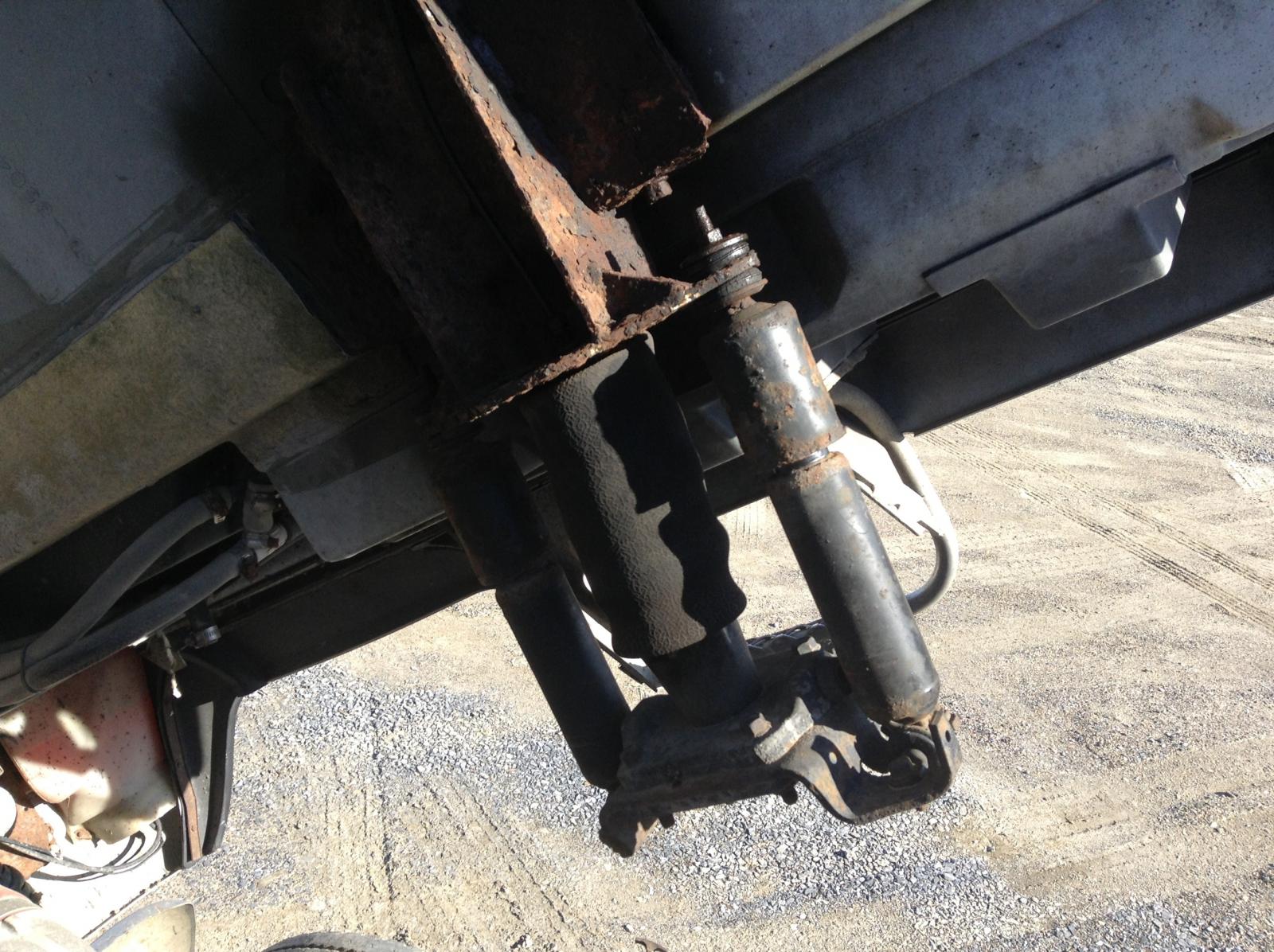

And this is what most neway airide looks like.
post-2708-0-53796300-1396817811_thumb.jp
post-2708-0-63835800-1396817868_thumb.jp
Then a round 1990 they started using Hendrickson.
post-2708-0-54691800-1396818009_thumb.jp
post-2708-0-83906400-1396818092_thumb.jp
Hope it helps.
Ray, it really helps. And all the posted above helped also.
I got the lever boot with the spring off and put the lever in its place with the cab down.
It shifted relatively well with the exception of some play because of wear in the joints.
I found out the spring was broken and the boot wasn't solid so I'm looking for them now.
The air ride of the cab needs air bags. Watts raited them for about $70 apiece and I'm going to catch them.

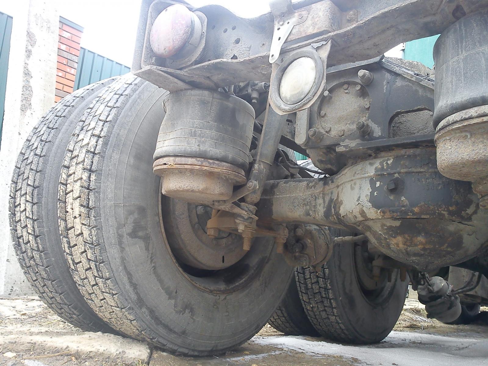

The Neway suspension you showed me out is almost the same I have in my R's.
Although the MH setup is definitely not the "classic" air ride and not "Hendricson".
There are some strange to me points in it and some issues.

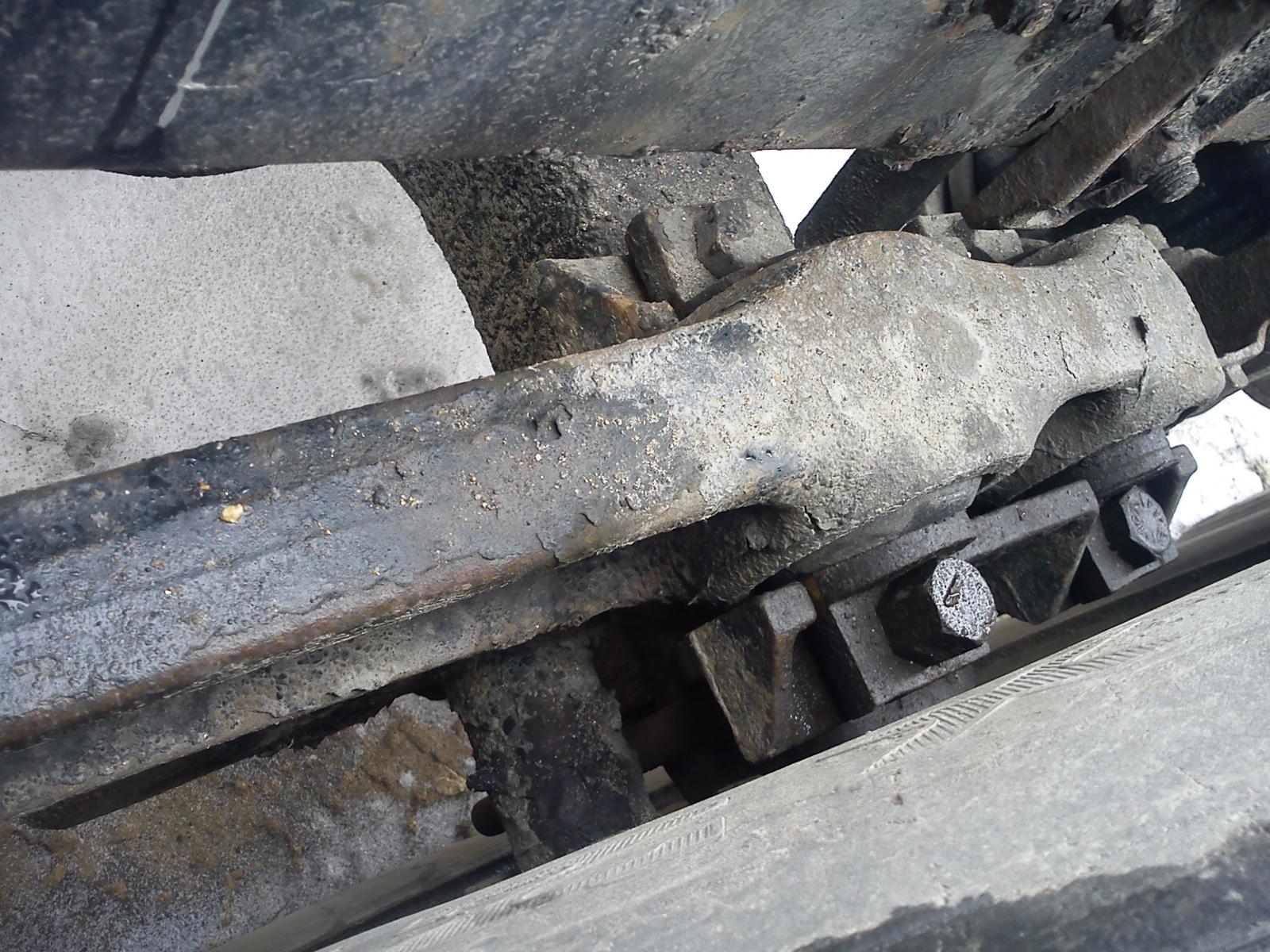

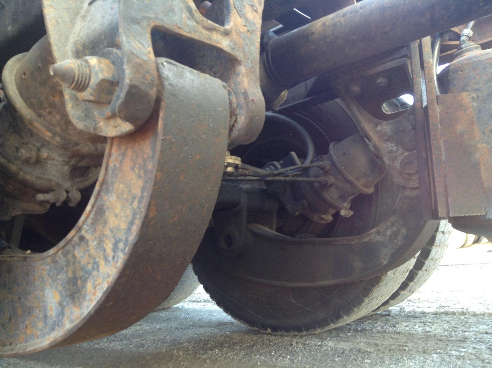

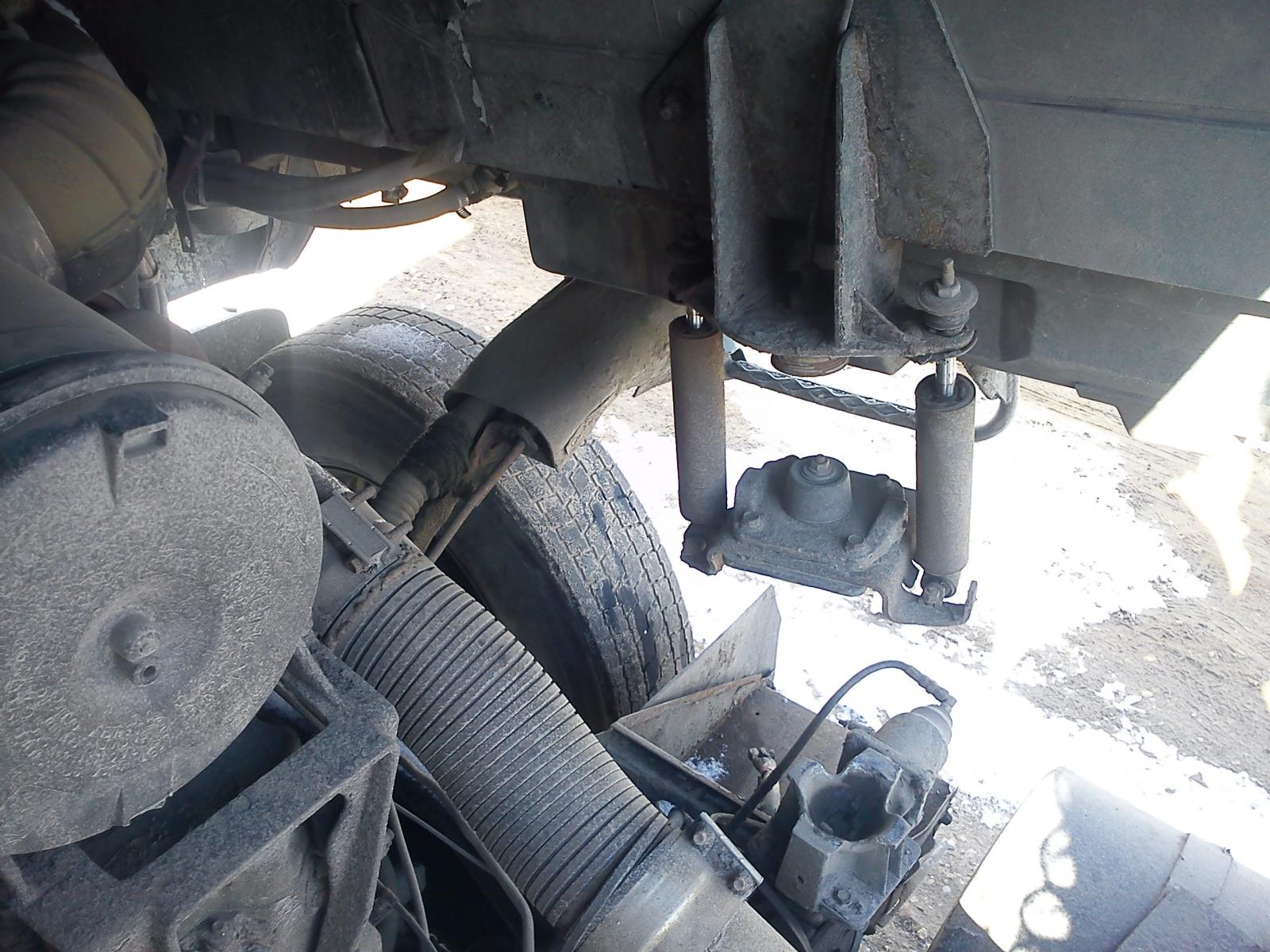

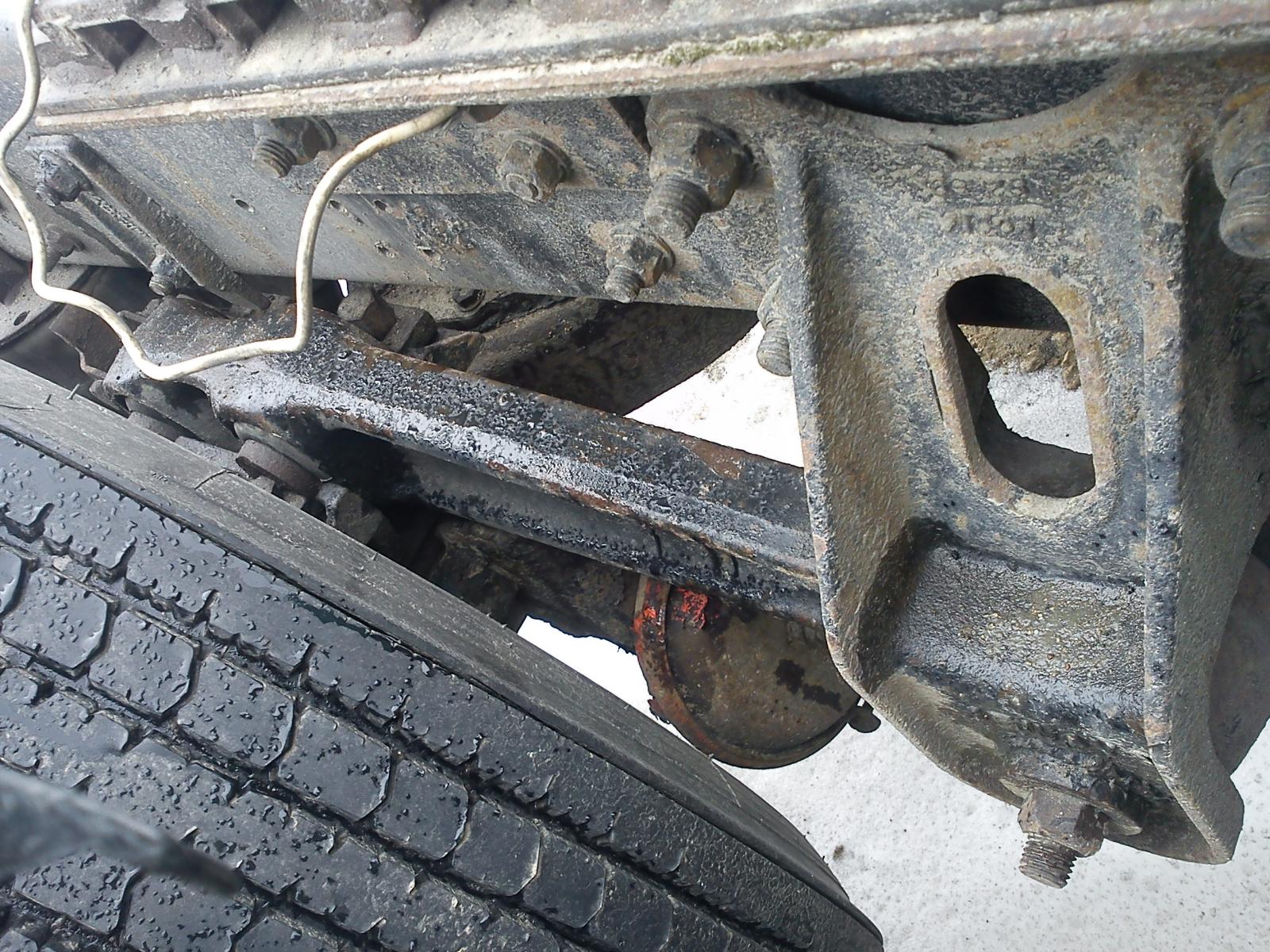

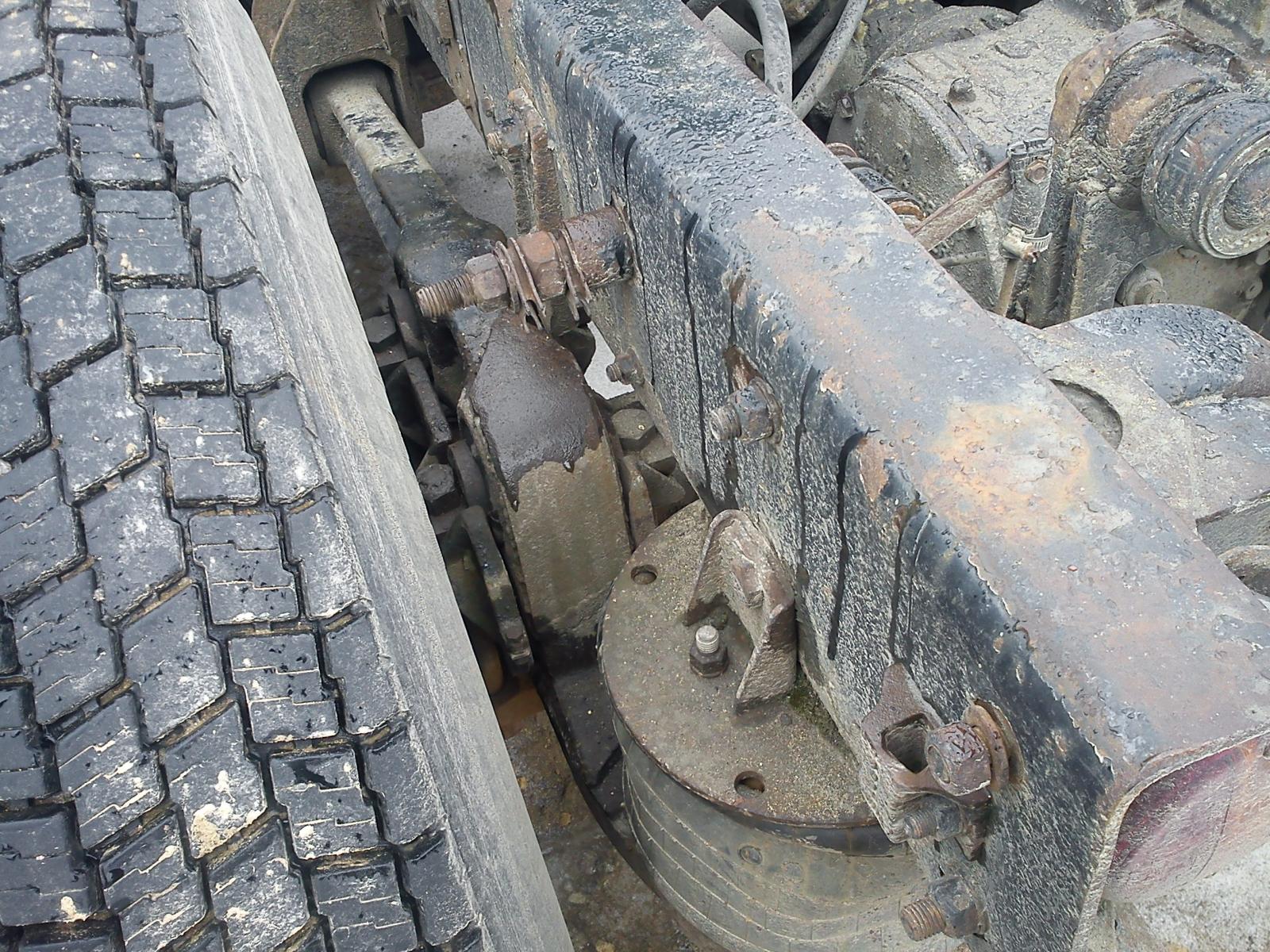

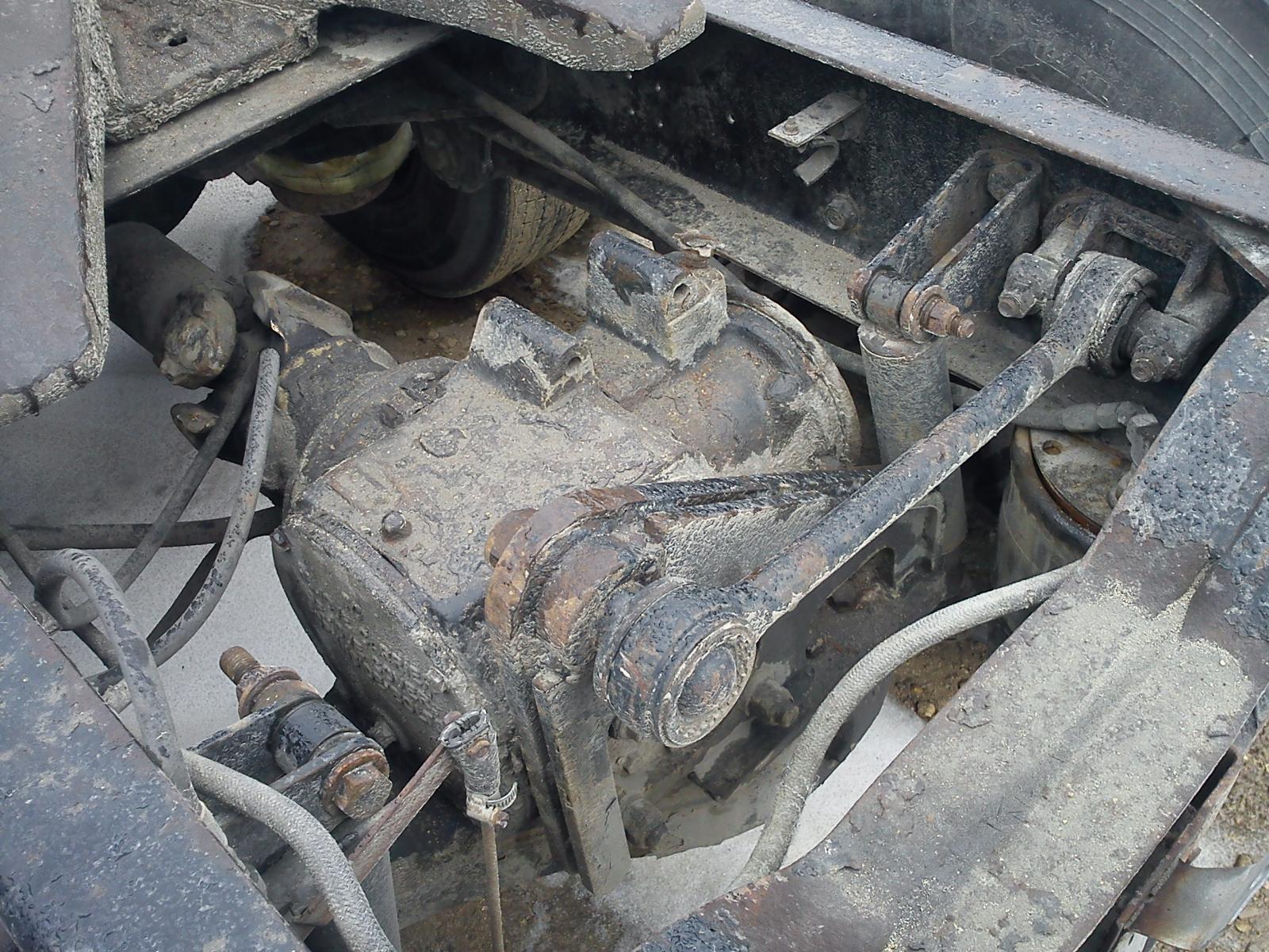

For example it looks like there were little steel ropes on the each side of the rear axles to the frame bolts for limiting up the suspension range.
I made some pics of it but it's difficult to figure out of what you see on them with the tires on.
Will try to make better ones and show out.
The stuff in rear looks this way.
