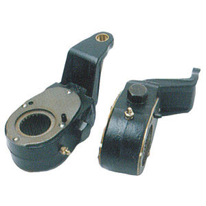

They all sell individually.
Since I cant look at it, my thoughts are you may want to replace everything.
The brake chambers might be able to be reused if they are long enough that you can cut off the old welded on yolk and add new ones with the jam nut, but chances are they will be to short and for the cost of that stuff may not be worth the effort.
They should look something like this one
Robert
"I reject your reality and substitute my own."
Yes, that is what I need. When the time comes I'll bring a set up with me and I can lay it out and match up the correct offset adjuster to work with new cans. Mine work well but are rusty and for not too much money it will be right and beyond question.
