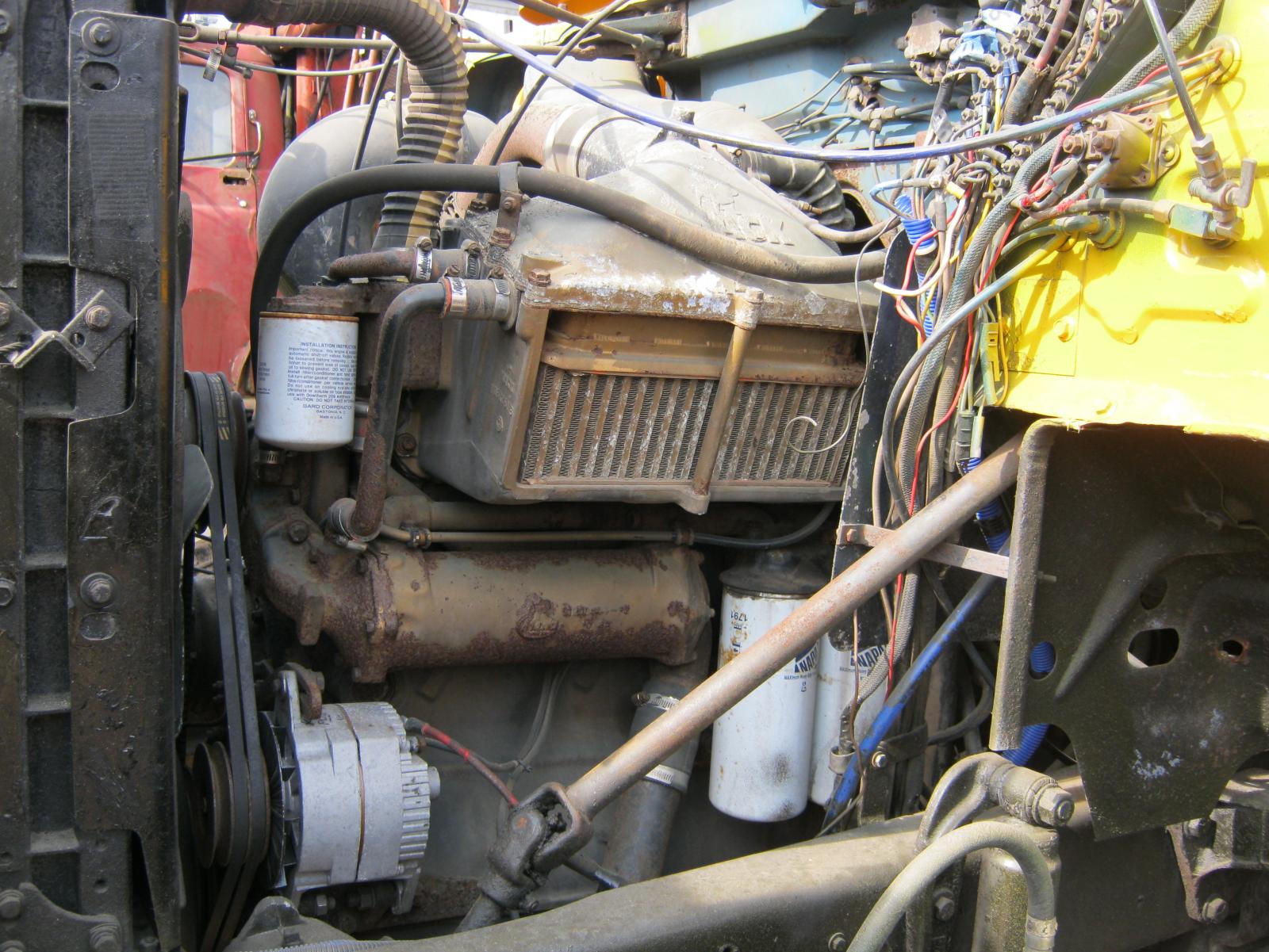

Oh boy im a U model nut. Nice U! Where are you from? And the truck is a U686, the 86 in the serial number means it had a 300 from the factory. So you may have the tip turbine missing.
I am from central Va but the truck is in NY
yeah, getting it here may be an issue, the boom is almost 13 feet tall
might have to ......I don't know, haven't thought that far yet
so by the photo above it looks like the tip turbine is a water to air cooler?
why do they call it that?
The tip turbine was an engine mounted charge air cooler. This U model has a chassis mounted cooler by the looks.

300-315 HP used water and air in the cooler. 285 HP used just air.
The system used "bleed" air from the turbo to power a small turbine fan in the system to force cool air through the heat exchanger.
sounds like a very unique system, and seems like it would be less efficient. I wonder why the hp rating is higher with it?

Tip turbines did have extra parts and weight compared to a chassis mount system but it was a means of cooling the intake charge and cooler air makes more HP. It was the technology of the day and now most things use the chassis mount set up.
