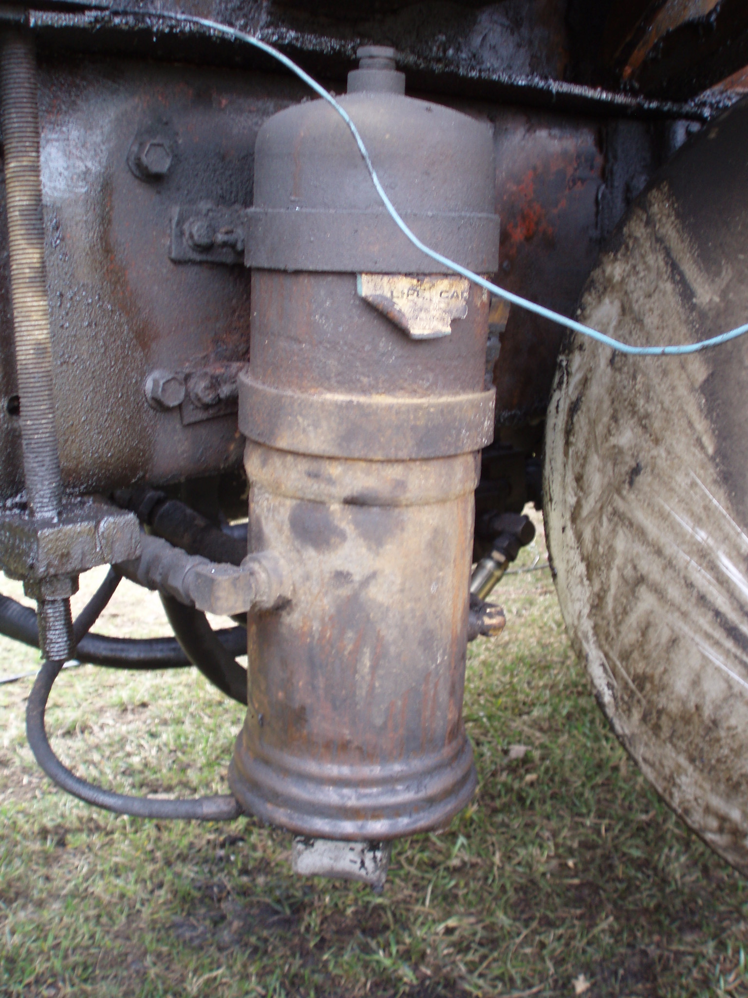

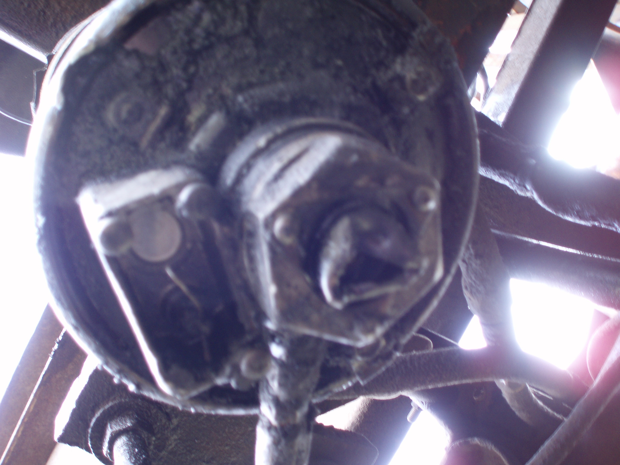

I don't know anything about it. Perhaps you can help me out. Here is a pic from the side and the bashed in underneath where the heater element must have been. What is the canister that yous suggest replacing? And how to figure out what model, in order to get correct parts?

That is a Bendix AD-2 dryer. Here is the service data book in PDF format from the Bexdix website:
http://www.bendixvrc.com/itemDisplay.asp?documentID=4453
It has all the information you need to service that dryer.
Another thing is I don't see the wires for the heater. Are there any wires near the dryer?
-Thad

I spent $94.00 rebuilding my AD-2 and that included heater, switch, element, and check valve. I removed the unit from the truck and it was easy to service.
That is badass - thanks. There are no wires near it - I have to figure out how to wire this thing...what are your thoughts?
I would say hunt around a little for the wires a little just in case they were cut back or wound up and taped into a ball. There might only be one wire as the dryer might have been grounded right to the frame. If you cant find em just run a line to your fuse block and protect it with a 10 amp fuse. Then just ground the dryer heater to the frame. But make sure its a good clean connection, no rusty bolts as this will impede the flow of current.

Thad, if you do that, anytime the temperature is below 32-35 degrees the heater will energize. The power wire only needs to be hot when the ignition key is in the "on" position. I know that is what you meant though. I make the same type of mistakes quite often!

The bottom of the dryer was all mashed in and no wires to be found. I sprung for a remanufactured canister. Just traded in the core.
Two questions: first, what was the consensus? One wire to the ingnition thru the fuse block and one ground to the frame? And second, some of you commented on oil being pushed on by the compressor. Can you elaborate? I mean, so the compressor is lubricated with engine oil, and some seals are bad or something and the oil is leaking into the air system? Also, how would one tell if this is happening? How serious a problem is this? And how is it fixed?
