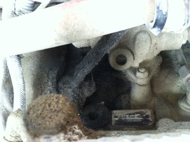

Non electric mack engine
That spring is in the valve on the bottom left in the last picture. It is below #1 injector line the valve that has a braided hose and a 1/4 plastic line going to it. I think it takes a 3/4 wrench and a 7/8 to remove it, be careful don't loose the ball and hat. WE take a #6 fitting and drill a 1/8 pipe thread in it and put a line and guage on it and put it where the line going into the pump for checking fuel pressure.
