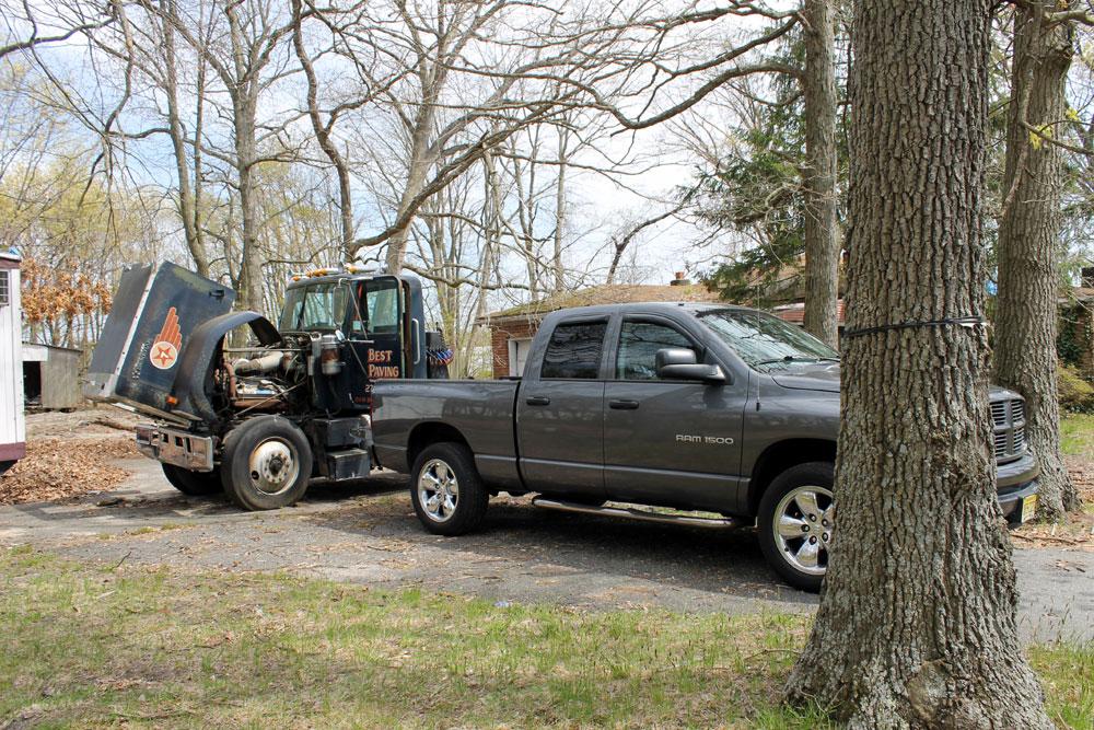

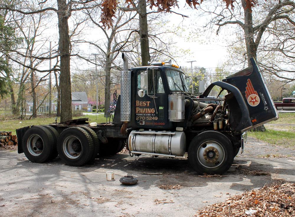

Well, I had a productive day. Got 4 new batteries from NAPA and a new ignition switch and installed them. Then set up my Canon and the GoPro in two different spots to capture the first fire up (or failure). SOB fired off immediately! Ran for about a minute then stalled. Oil pressure went to 20psi then when it was starting to drop RPMs before it stalled, it went to 10psi. Its got some leaking at the oil filter when it first fired off and something leaking from the drivers side of the engine. I think there is a fuel issue. After I let it sit for a couple minutes, it will run again for 30 seconds then stall again. I am going to get new filters tomorrow and install them. How long does it take for the air pressure to get to around 120? The gauge didn't seem to move much if any but I did hear air when I hit the parking brake release. Also there is a lever on the steering column that has air lines running to it with a warning label that states "Not for parking" - What the heck is that for? Brakes are locked up (not enough pressure yet) so I couldn't get it to roll. I tried to slide it into gear with it running and it was grinding. If I put it into gear, then press the clutch and fire it up then start to let the clutch out it does grab and want to go. What would prevent me from putting it into gear when its running first even with the clutch depressed?
