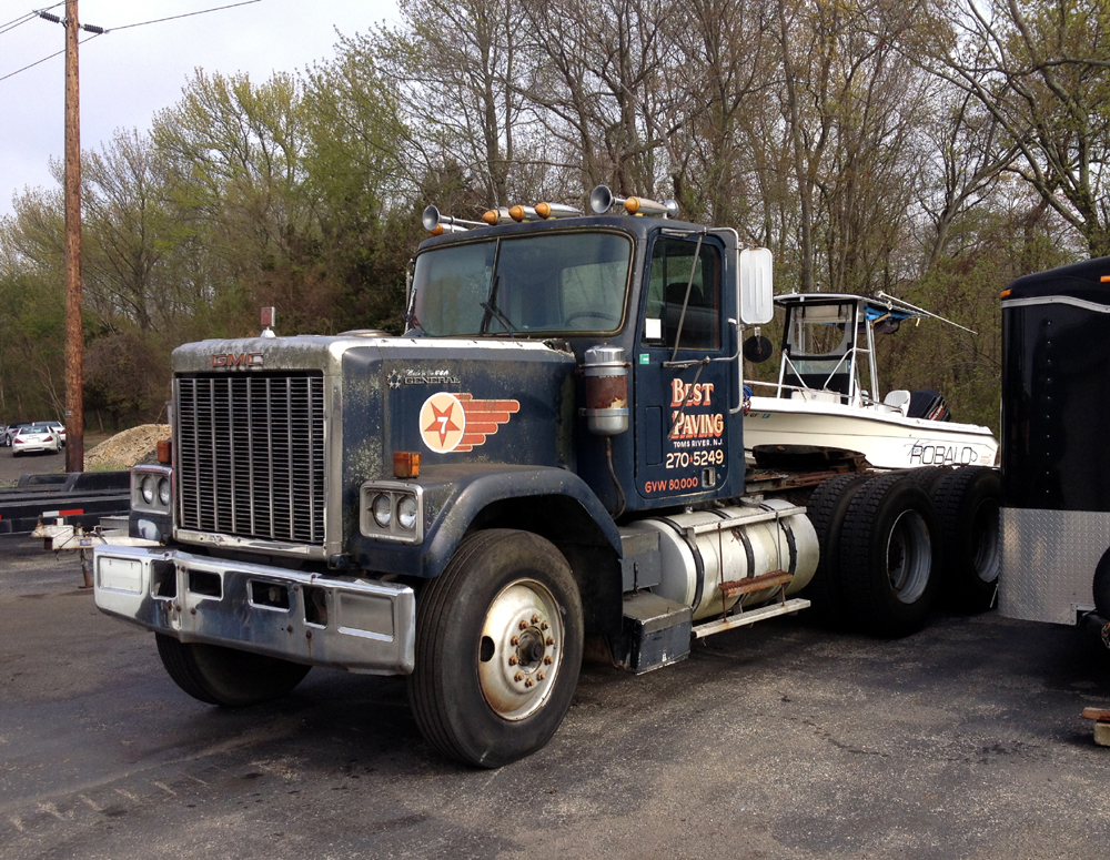

I contacted Paul White, a local mobile diesel tech who also has a restored B Model. He is going to come out on Monday and go over the truck with me. I would rather have a pro check it out so I know its fixed right. So it will cost be a few hundred bucks but its better money spent then to have it towed and then still might need him to come out. Money well spent in my opinion instead of risking driving it and something go wrong, especially with the brakes.

Thanks everyone for the advice so far. I have the guy coming on Monday so ill see what he is doing. I am completely new to large diesel trucks so I felt the best thing I can do is get someone who knows what they are doing. I'll play with it on Sunday by checking shut off valves and maybe dropping the fuel line into a can of fuel to see if that makes a difference but anything beyond that, I will be at a disadvantage.

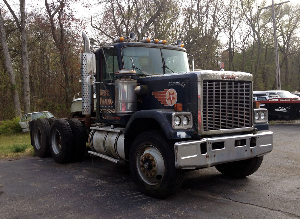

So I went by tonight to show the truck to wife up close and to a friend who wanted to see it. I tried to fire it up and it just cranked for a couple seconds. I waited the tried it again and it fired then stalled. I figured the fuel filters were empty from the last run the other day so I didn't want to push it. But I said let's try one more time. It fired up and then ran, and ran, and ran. It idled for at least 8 minutes. I revved it up a little to 1200 rpm then backed off. As soon as I did that it stalled. I fired it back up and it idled fine. At least i have progress.
I can hear an air leak at the foot valve so it didn't air up so the brakes are still full on. I tried to push the parking brake in but it kept popping out. I can hear air releasing when I do this though.
I was able to slide into gear this time. I made sure the clutch was ll the way down. Last time I guess I had another 1/2 inch to go. It doesn't want to move forward yet but I am close.
Tomorrow the mechanic is coming so I should have answers then.

You are making progress. The air brakes will not release until you build up minimum pressure until then it will keep "popping out". Don't quote me but I think it is 60-70 psi. A major air leak will definitely keep you from building pressure. Someone on here mentioned the air compressor governor, that could be stuck (governor regulates 90-120psi).
Did you have oil pressure?
Ken
I do have 20 psi of oil perssure at idle then it goes to 40+ when I throttle it. I know there is at least one air leak at the foot valve. I maybe able to cut the line back and install a new fitting. I'll post more after I am done with the mechanic.
