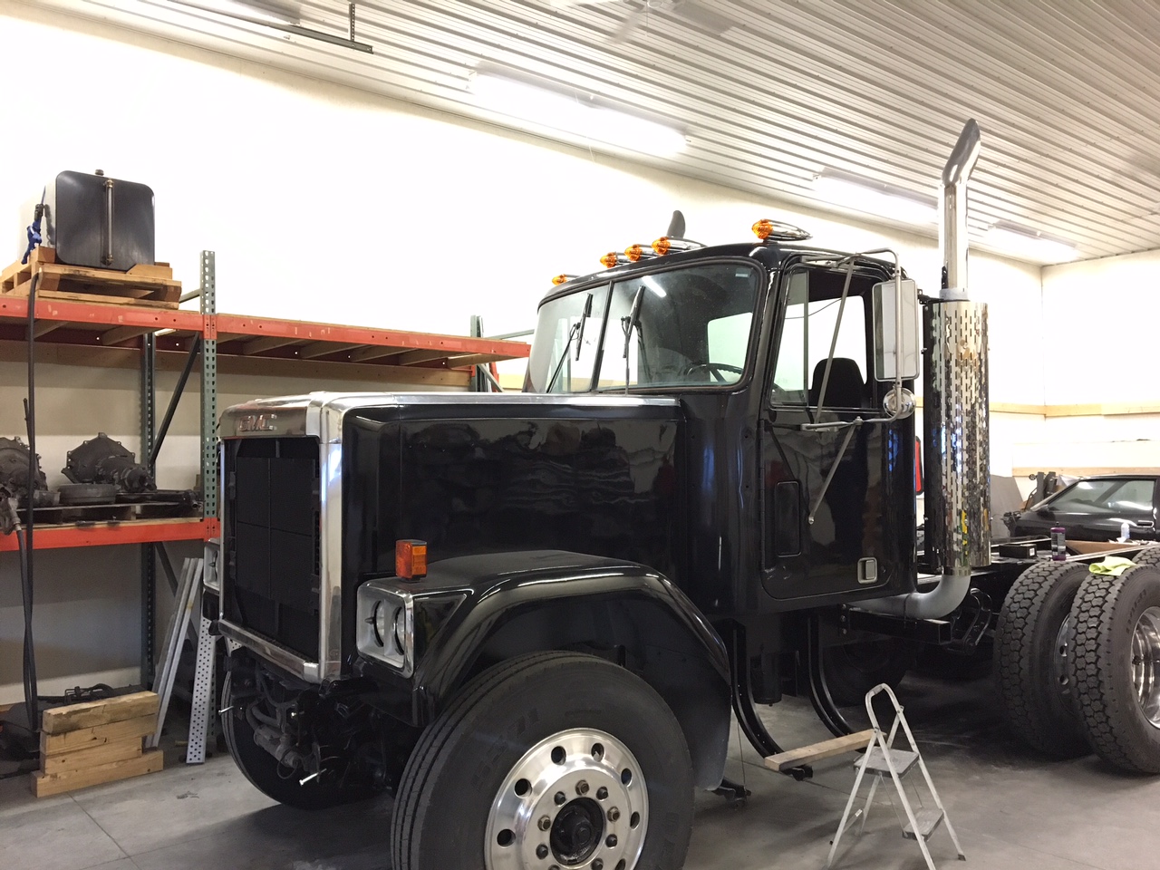

I have to say it again. I'm truly impressed and happy that you are the new caretaker of the General. I've been collecting some of your pictures and will do a new web update on my Save the General video series on YouTube next week. It will be two part. First when you bought it and some of the initial tear down shots, then a second video with the build up. When you are all done I'd love to come visit you in NY and do a full of finished video of the truck as well. And of course see it in person.

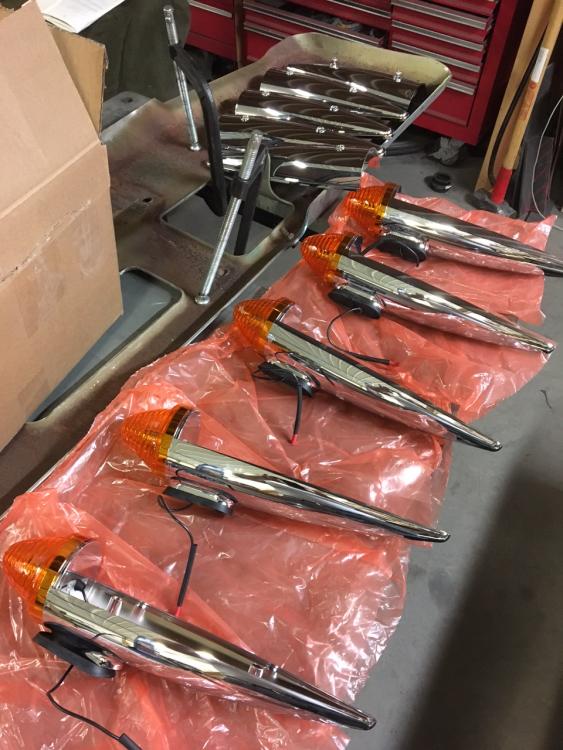

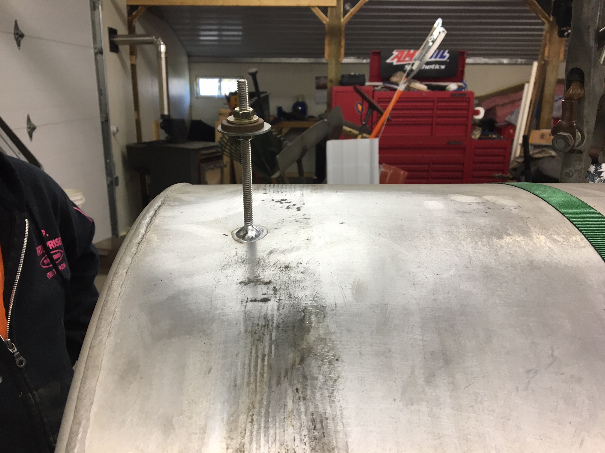

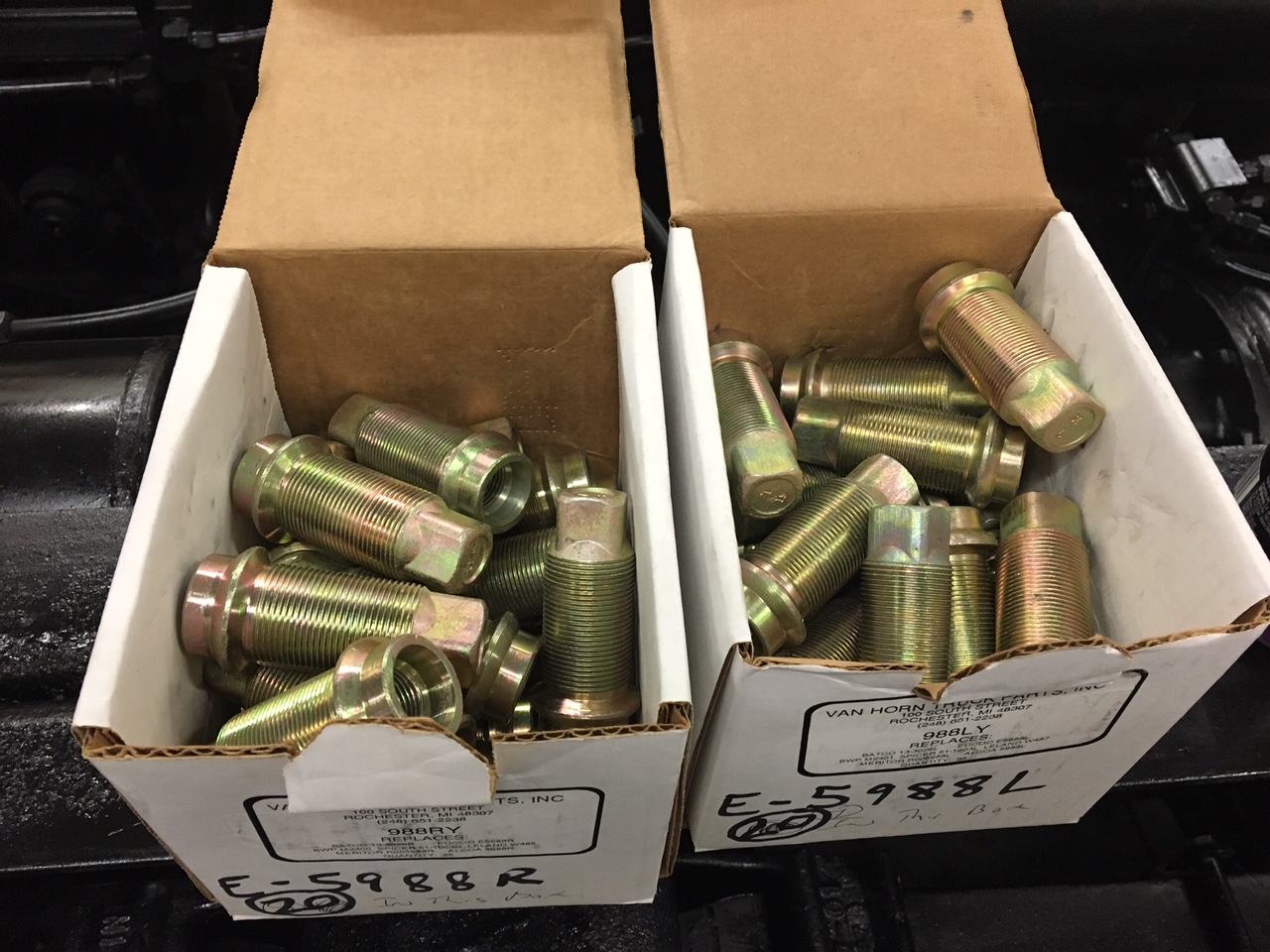

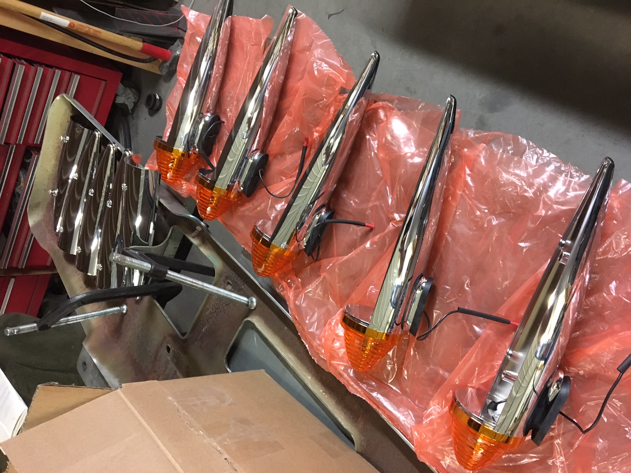

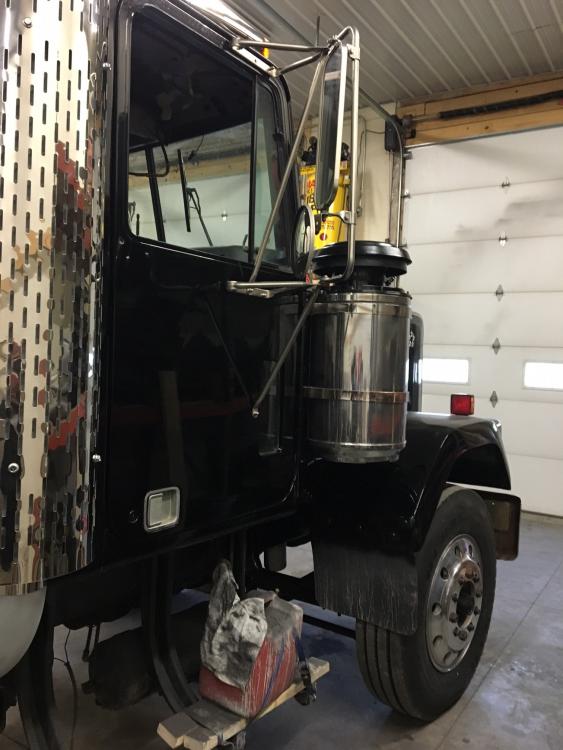

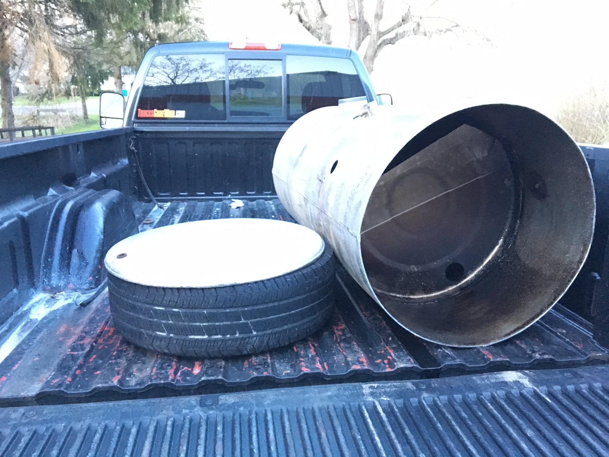

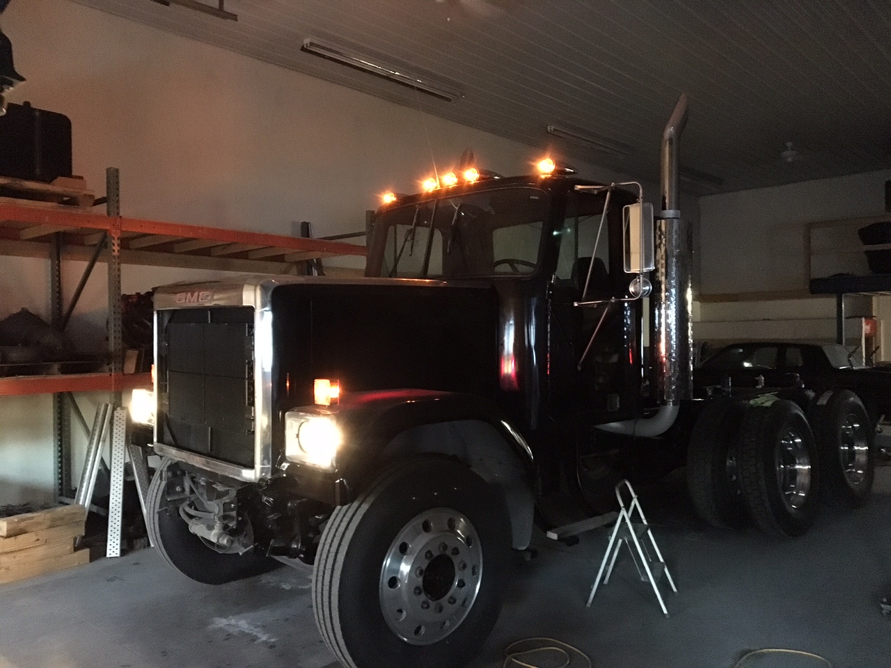

Been making some progress but not as much as I would have hoped.  I got the roof buffed and the new cab lights mounted and wired. Very happy with those.  The new inner lug nuts for rear showed up really fast in 3 days (more on that later) so i would recommend Van Horn truck parts to anybody. I also started to collect the aluminum bungs and vent that i will need to put in the driver side fuel tank to use as the hydraulic tank for the wet line kit in the future.  I'm mimmicking the fittings and sizes off of a friend's Peterbilt since his works so well and I will most likely be using his low-boy or dump trailer.

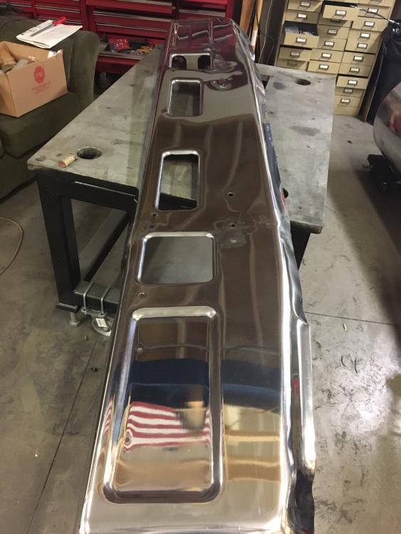

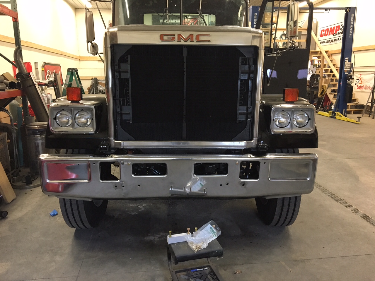

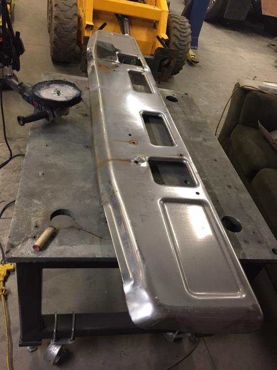

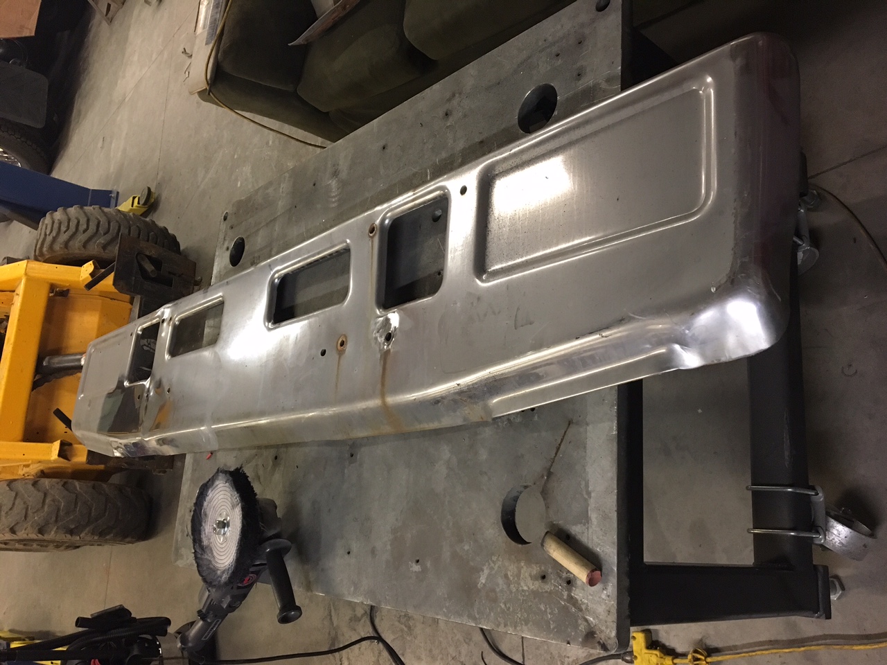

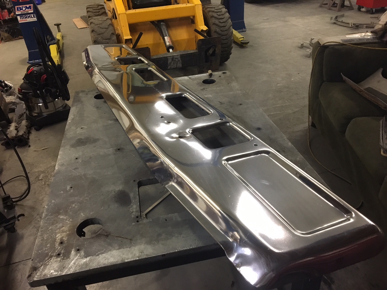

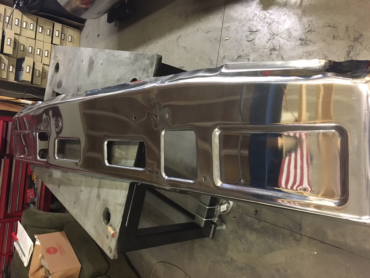

Next I decided to straighten and clean up the bumper.  The passenger side of the bumper was pretty tweaked and creased pretty good.  I would really like a new bumper, but thats not in the budget at the moment.  I spent a few hours with a sledge and a welder and my skid steer getting it somewhat presentable.  They i polished it quick with the same compound i used on the tanks.  For how dirty and stained it was I was happy with how it turned out, until i mounted it on the truck.  I cant believe I didnt notice it before, but the holes are not symmetrical or straight.  Now that that bumper is straight its very obvious that the whole thing is shifted to the passenger side 1.5 inches.  Its almost like somebody at some point bought a blank bumper then just blasted some holes in it without caring.  The fact that it is not centered bugs me more than the ripples in it from straightening it.

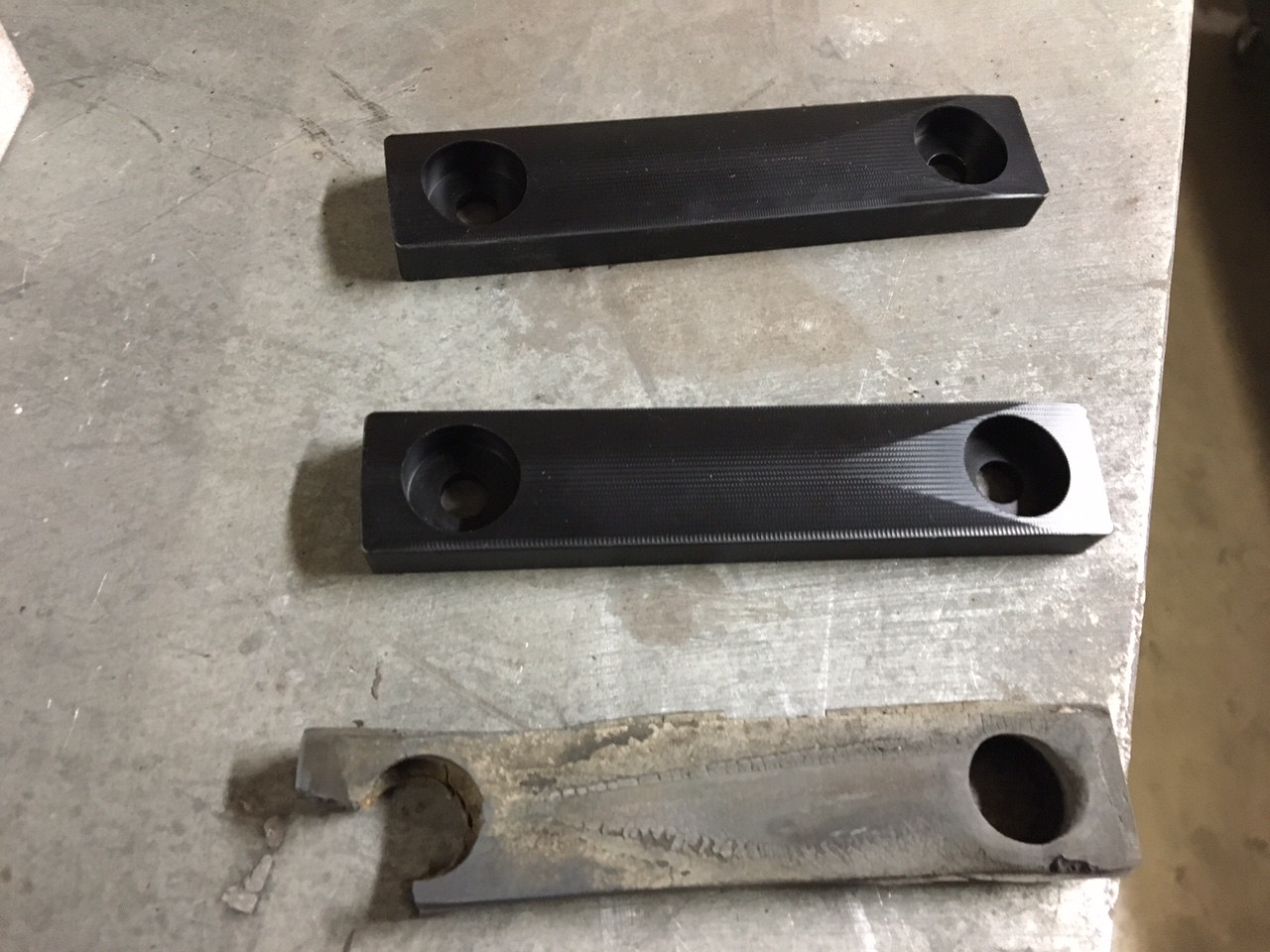

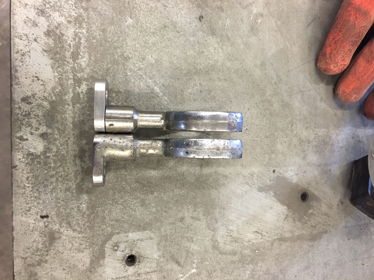

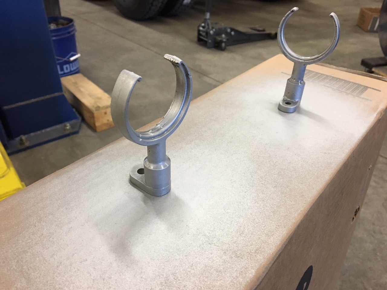

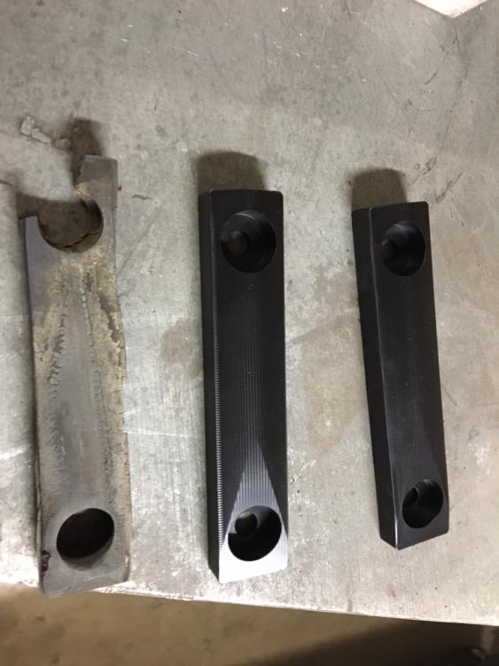

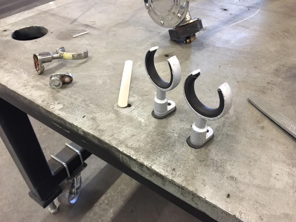

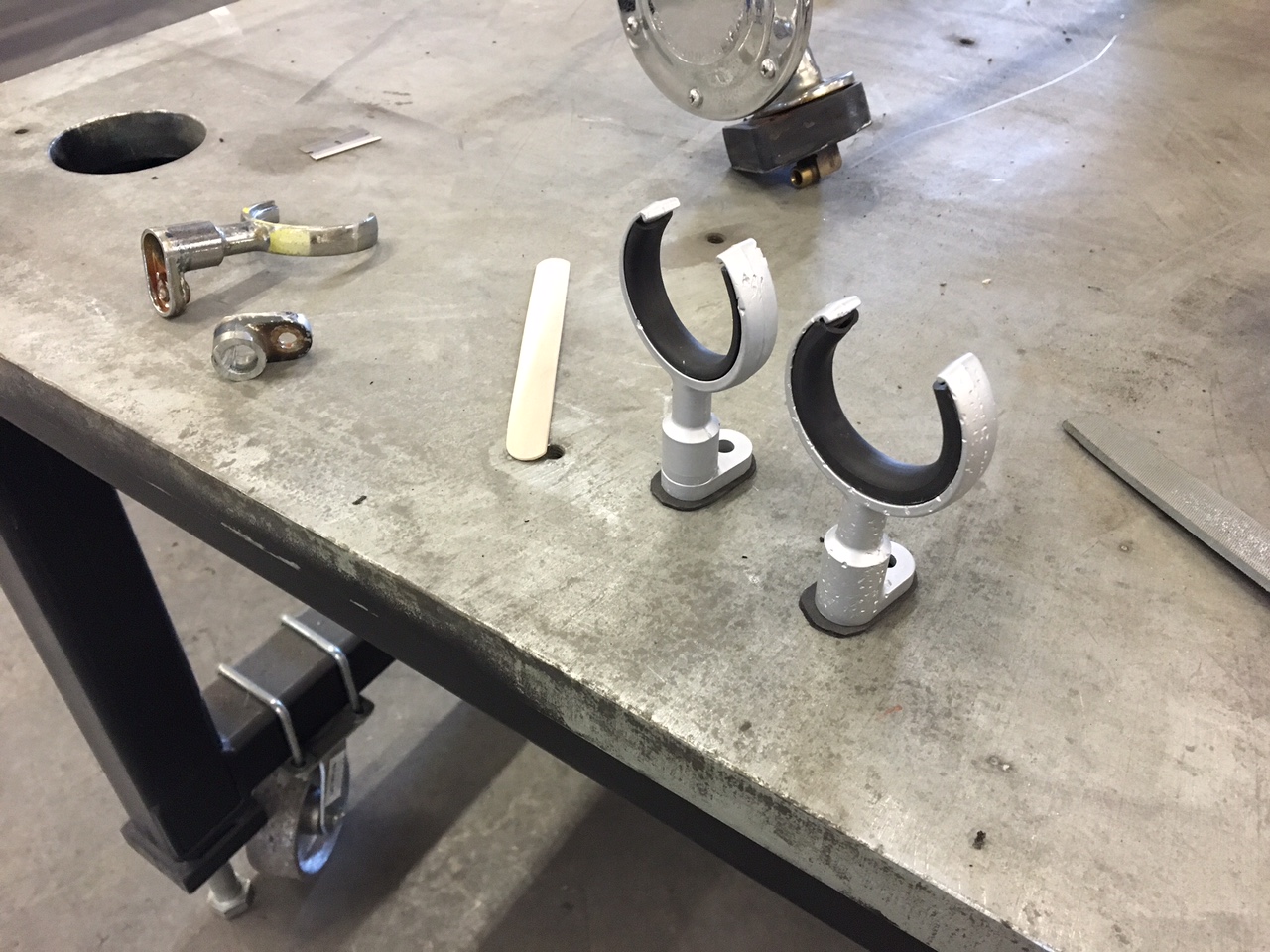

The sliders on the inside of the hood latches were all cracked and broken so I had  friend of mine make me up some Delrin replacements.  Very happy with those.

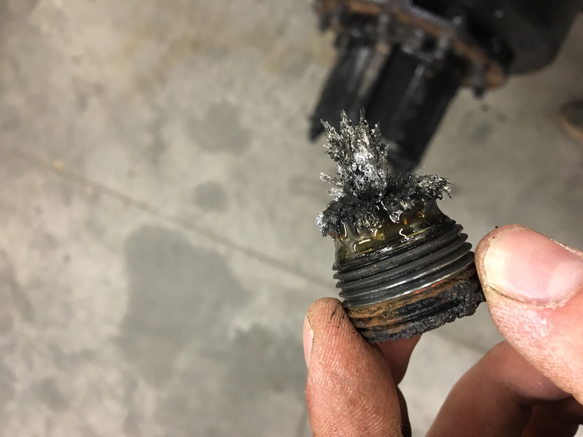

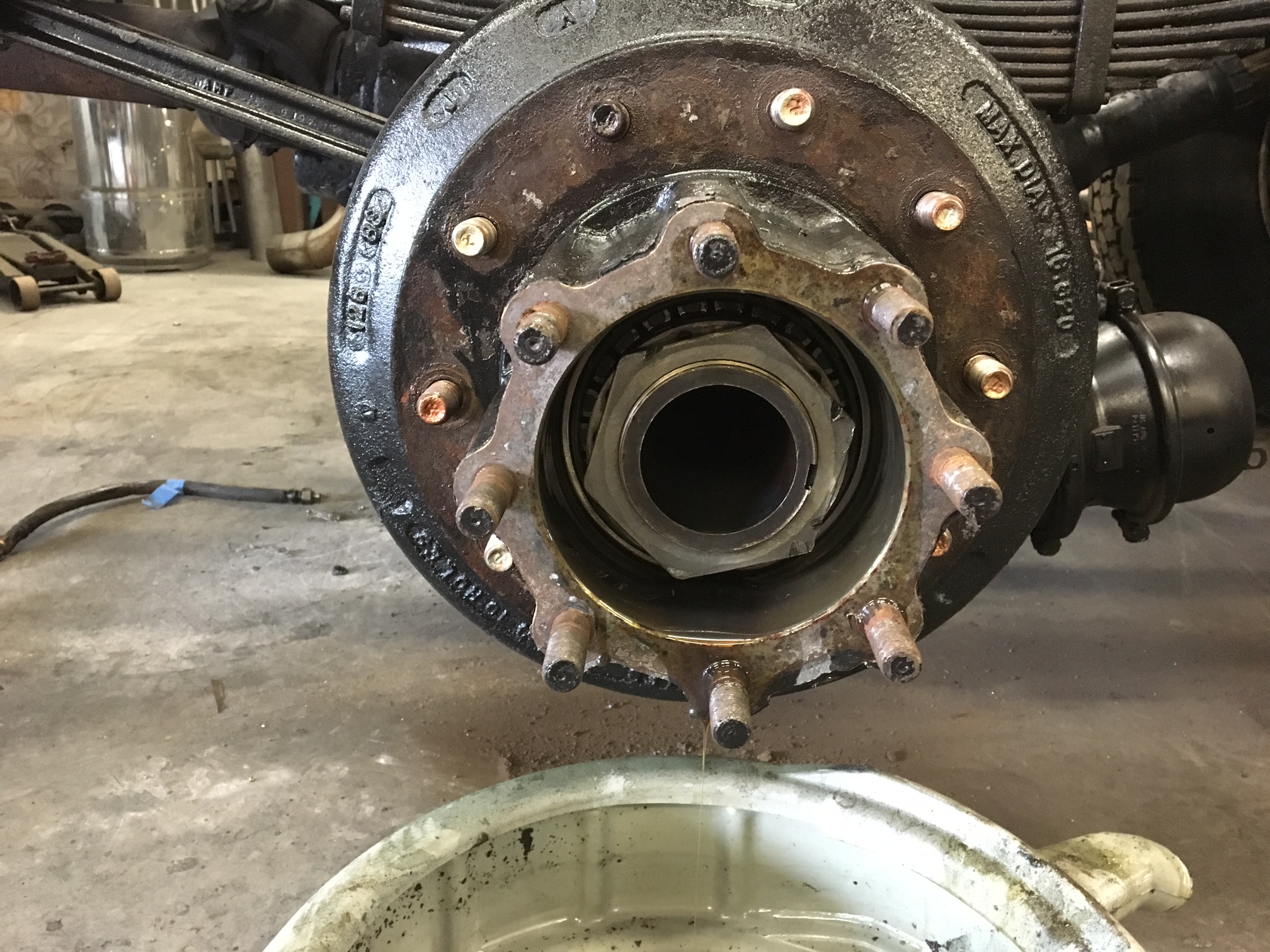

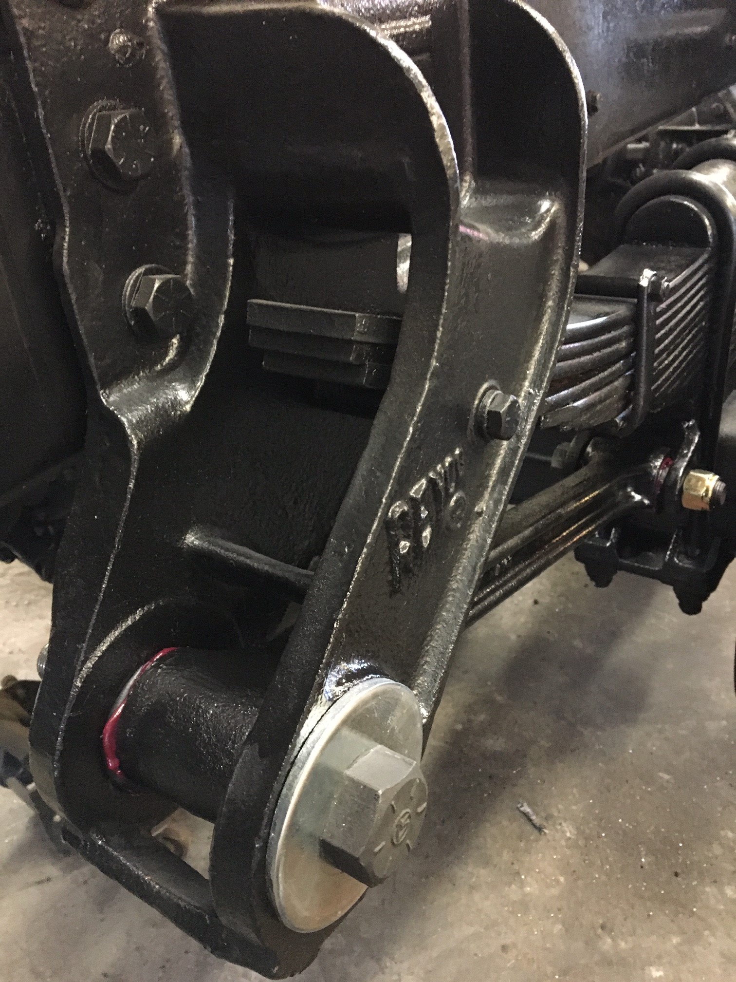

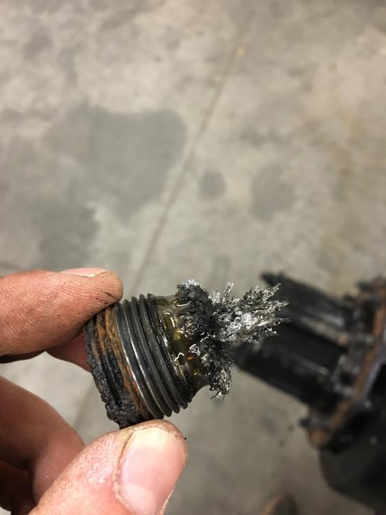

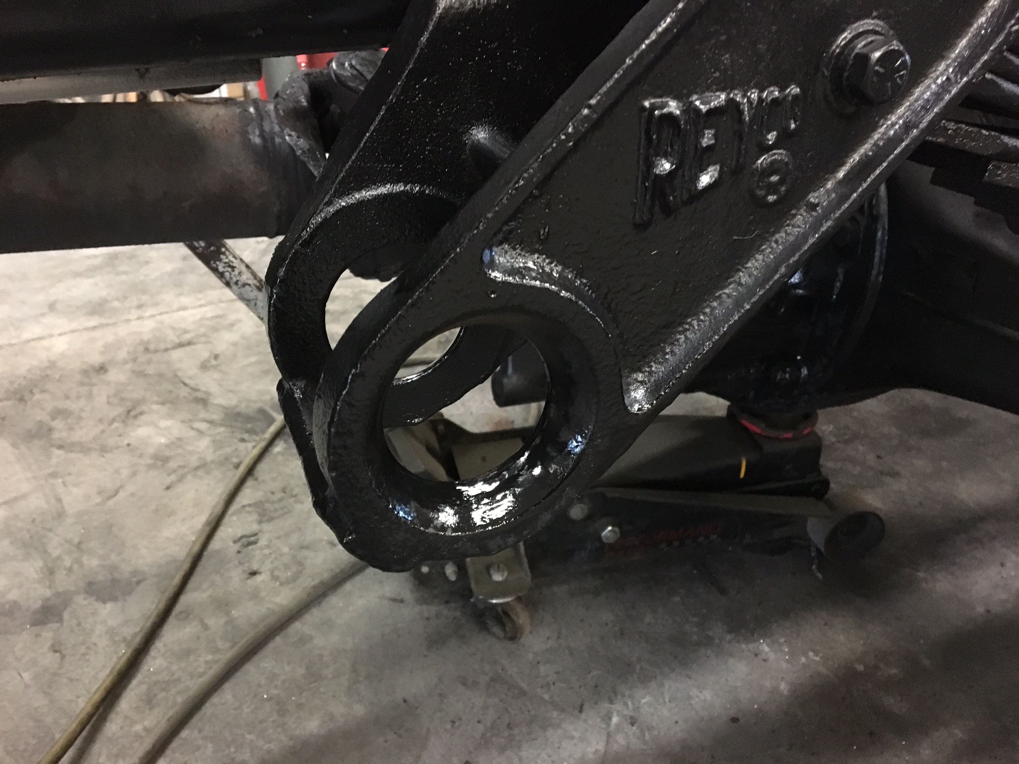

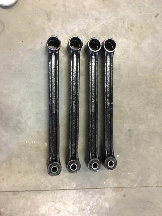

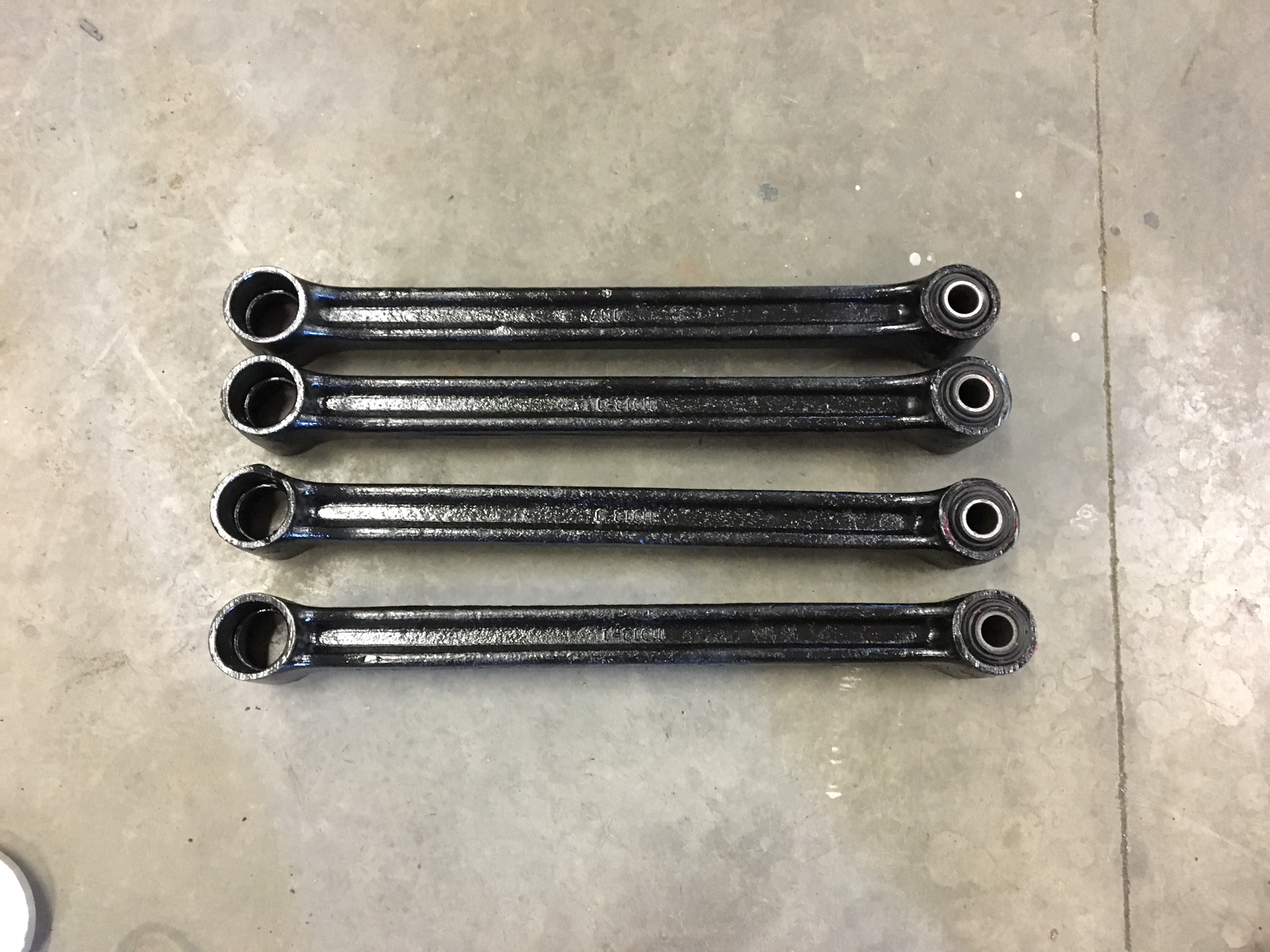

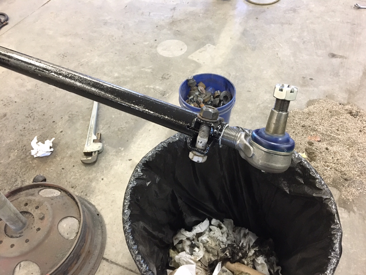

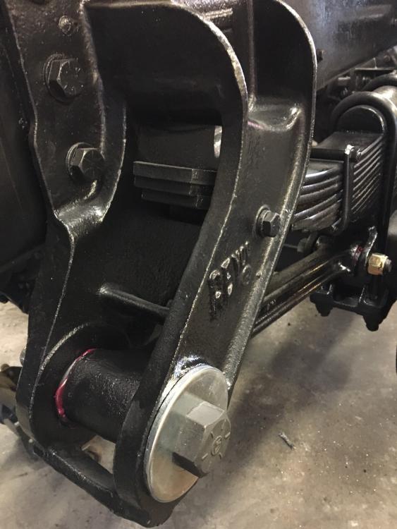

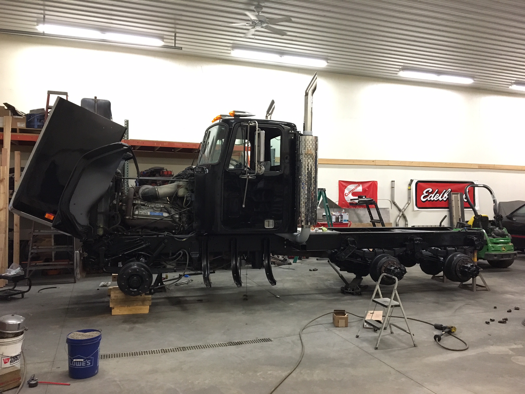

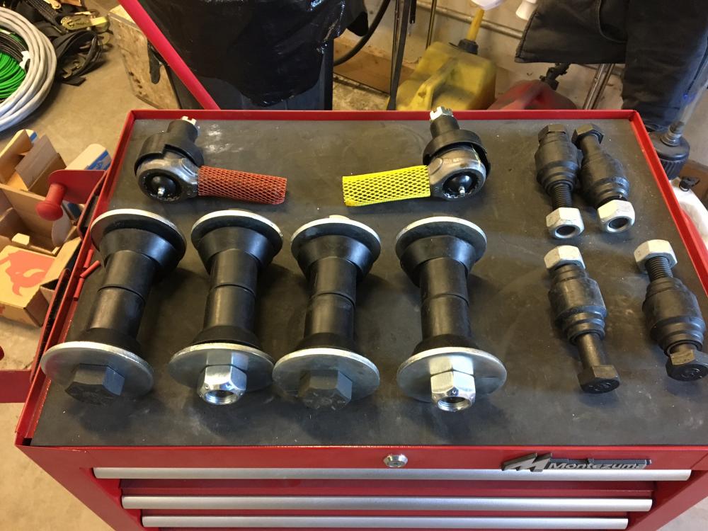

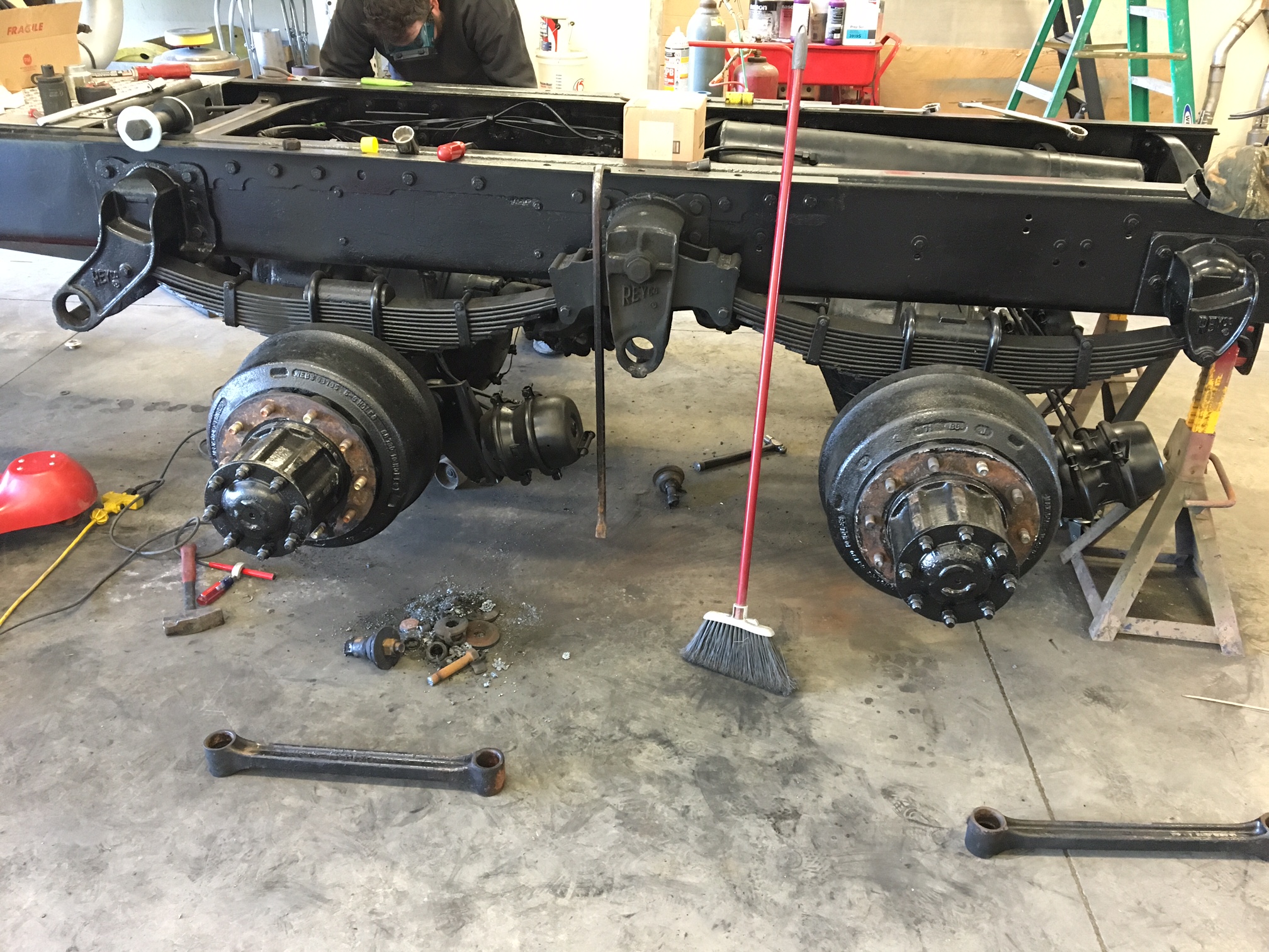

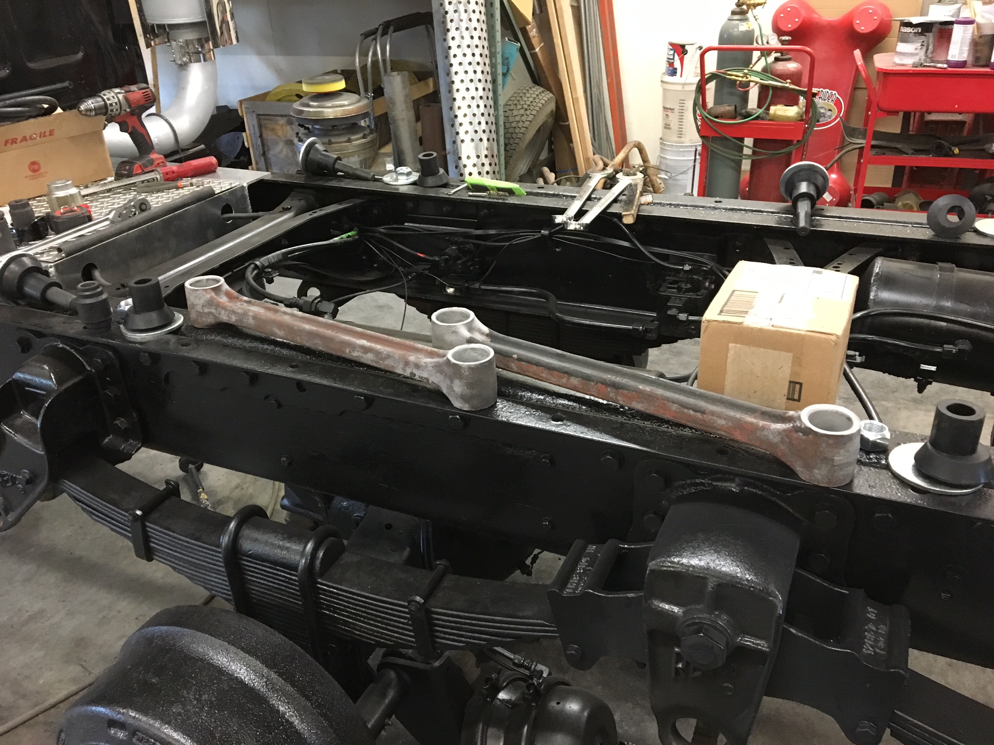

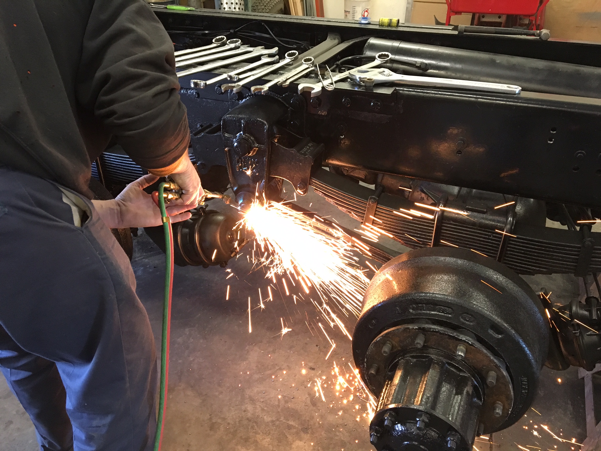

I decided to give up on the cosmetic work for a while and do some more important mechanical maintenance.  I put the truck up on blocks and removed all the wheels for easier access.  First step was draining the gear oil from both axles.  The rear axle was full of fluid but it was also full of metal.  At this point i just pulled all the plugs and diff temp sensor, clean those up and put a fresh 5 gallons of 80w90 in it.  Ill run it and see what happens.  The front axle had clean oil but only about 2 gallons in it.  Once again i pulled and cleaned all plugs and temp sensor and put a fresh 5 gallons in.  The rear most torque arm bushing on the driver side was pretty much missing.  I told myself in the beginning i would run it this year and adress it next winter.  OF course i coudnt deal with that so I decided to change it.  Upon investigating the other bushings, I figured I might as well change all of them.  The brakes are good, so once i address these bushings, there should be no reason to pull these wheels anytime soon.  So I enlisted a friends help because he has a lot more finess with a torch than I do so we torched out all 8 bushings/bolts and removed all 4 torque arms.  Sand blasted the arms, painted, and pressed new bushings in the axle end, then assembled the new eccentric bushings on the frame side.  I finished assembly yesterday morning so i figured I would grease all the brake components then start putting the wheels on with the new nuts.  My goal was to have all 8 drive tires on and torqued for good.  I put the two rear insides on. hand seated all the nuts, bottomed them lightly with my 1/2" impact then got the torque wrench out.  Started torqueing the drivers side to 400 ft/lbs. did 5 nuts then took all the threads off one stud.  F$%K. So then I started googling everything about dual alcoa setups.  Not a lot of hard facts out there but the numbers I came up with is that I should have 1.33" to 1.88" of stud standout off the drum face.  I have 1.125".  It looks like the only option now is to pull all the drums and change 40 studs unless im missing something again.  This has been been quite the learning experience.  On that note, anybody near Rochester have the tool to change the studs while the hub is still on the truck???
looking good to me
I wouldnt worry to much about that small amount of metal it could mean something or it could mean nothing at all you dont know it may have been there since new

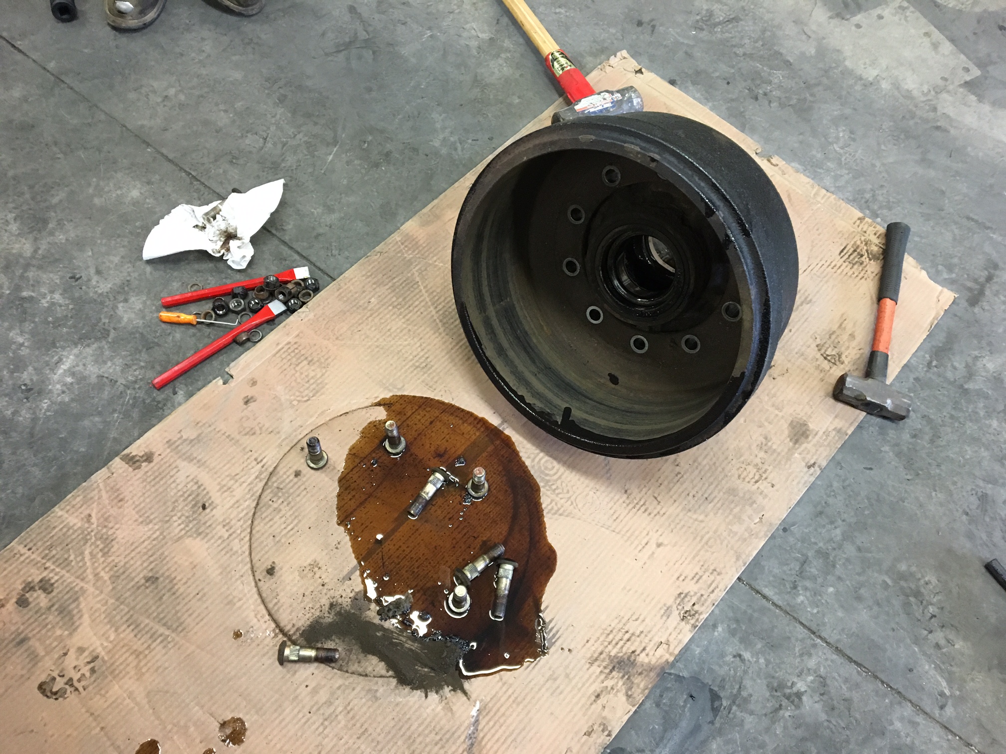

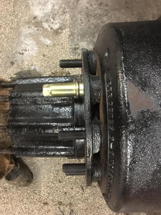

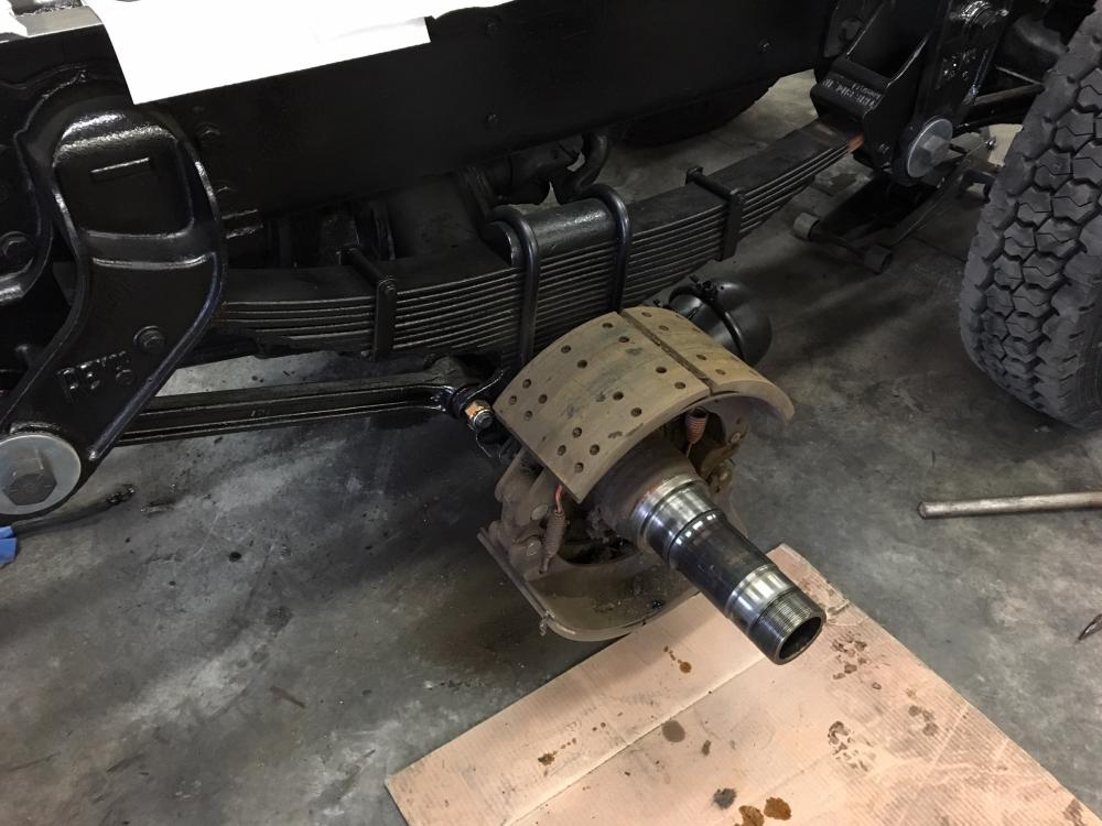

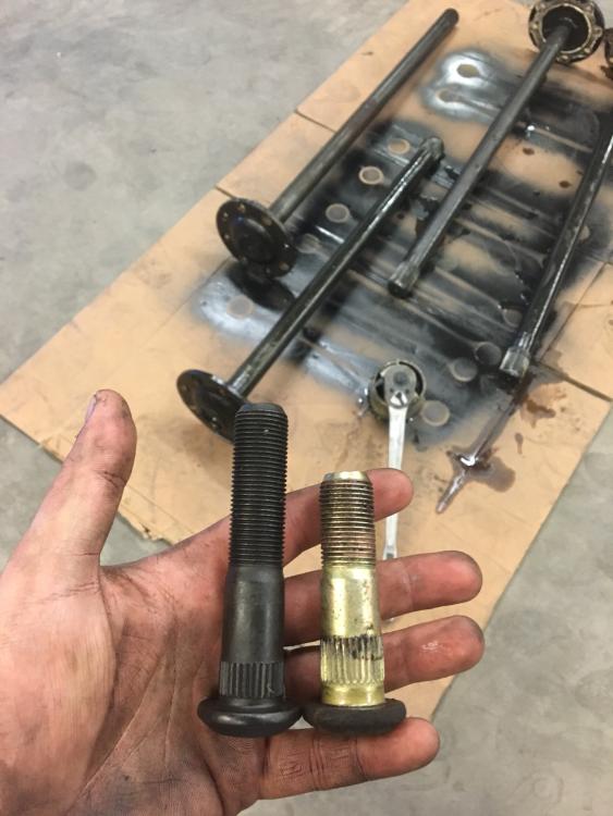

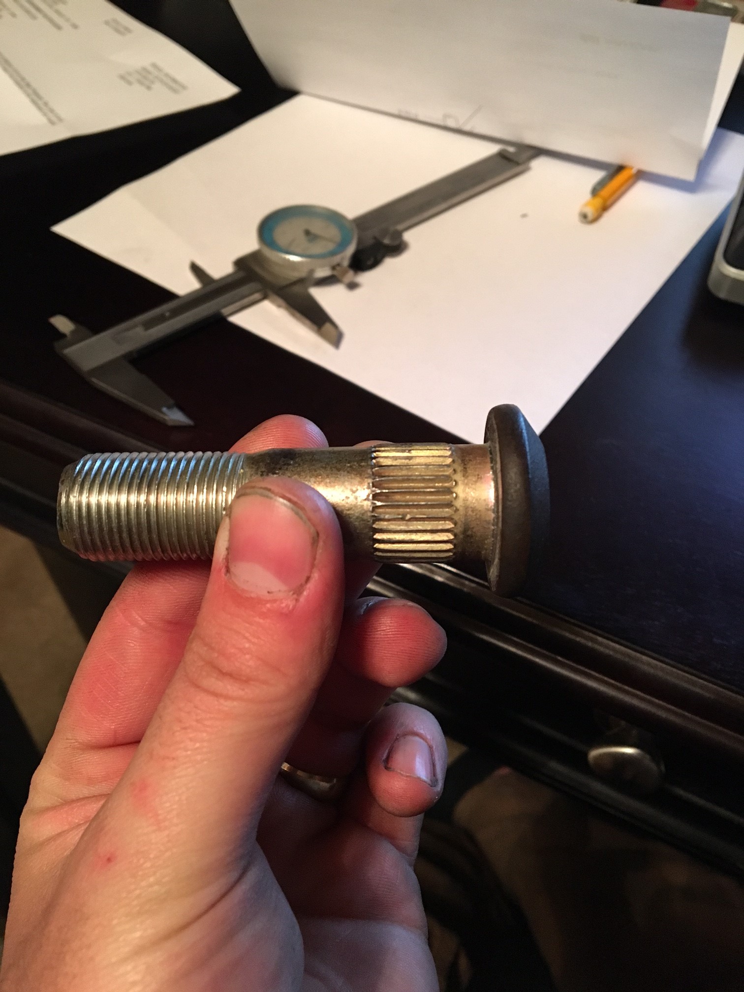

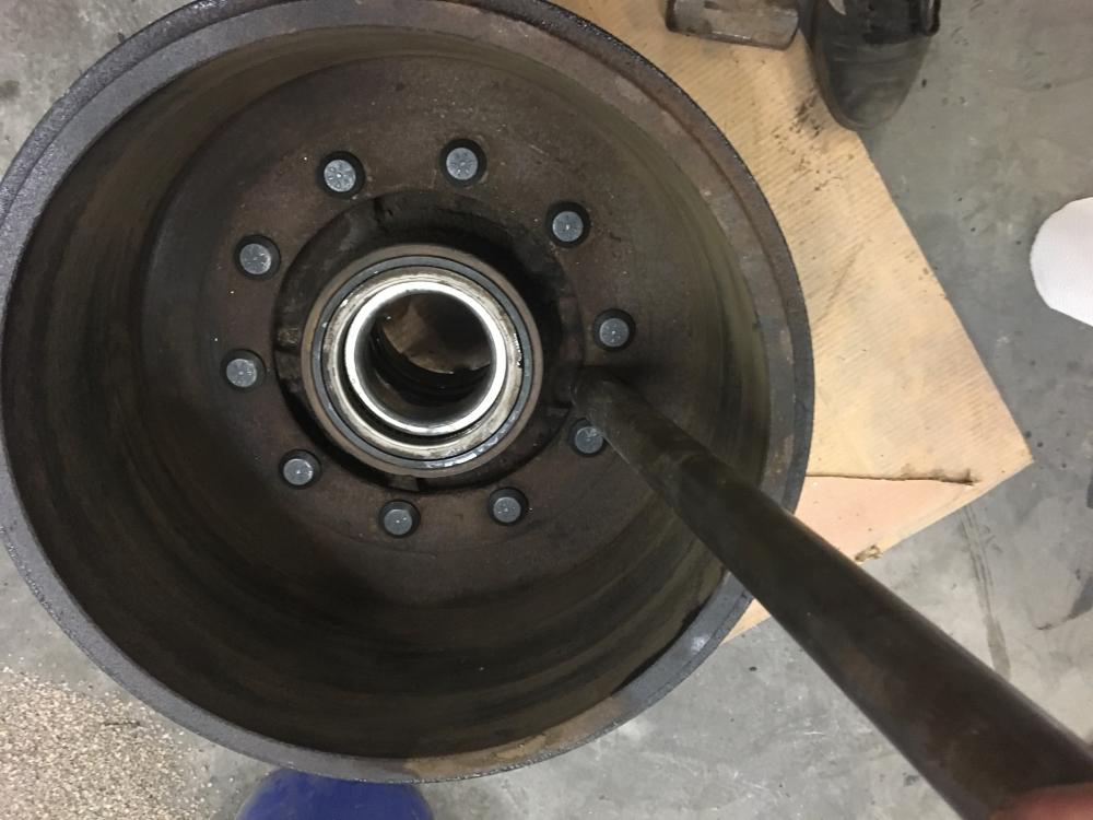

Well.....upon further investigation i realized that it wasnt just a simple knock the drum off kind of job, the drum was behind the hub with the stud pressed through.  I only took one drum off tonight because i didnt have much time, so i knocked those 10 studs out and am now trying to find the identical stud but with longer thread,  on the bright side, the brakes and bearings look mint.

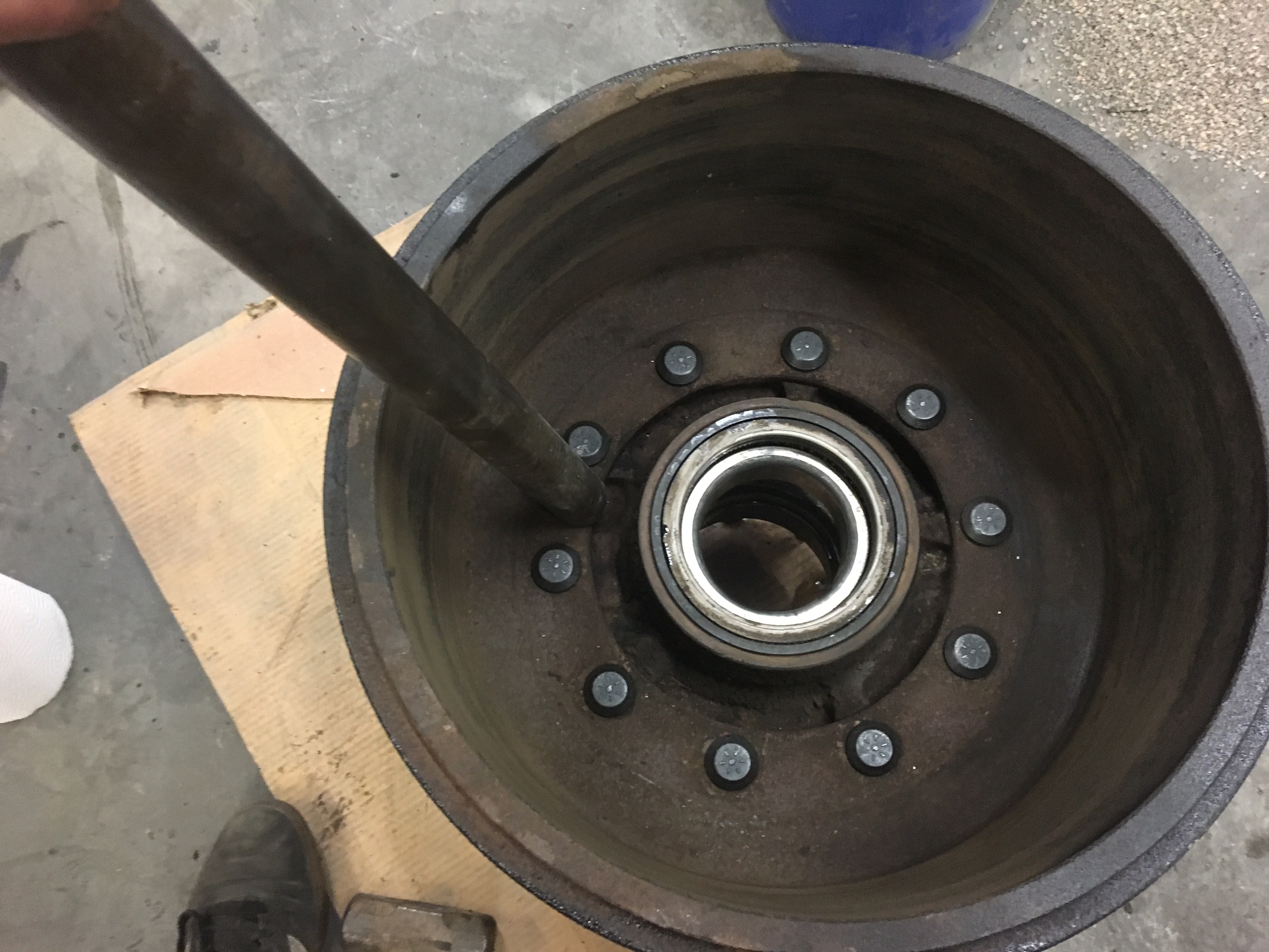

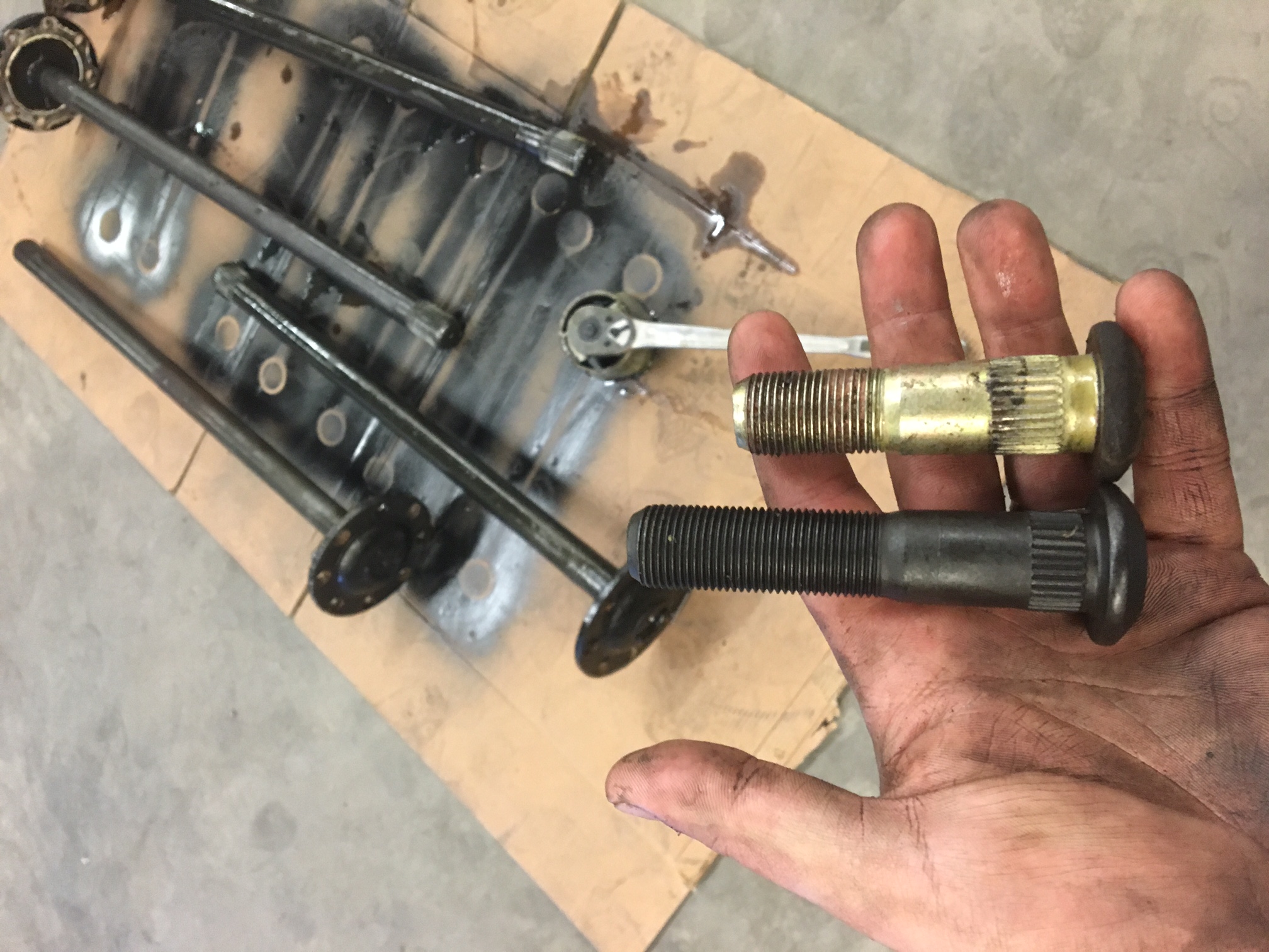

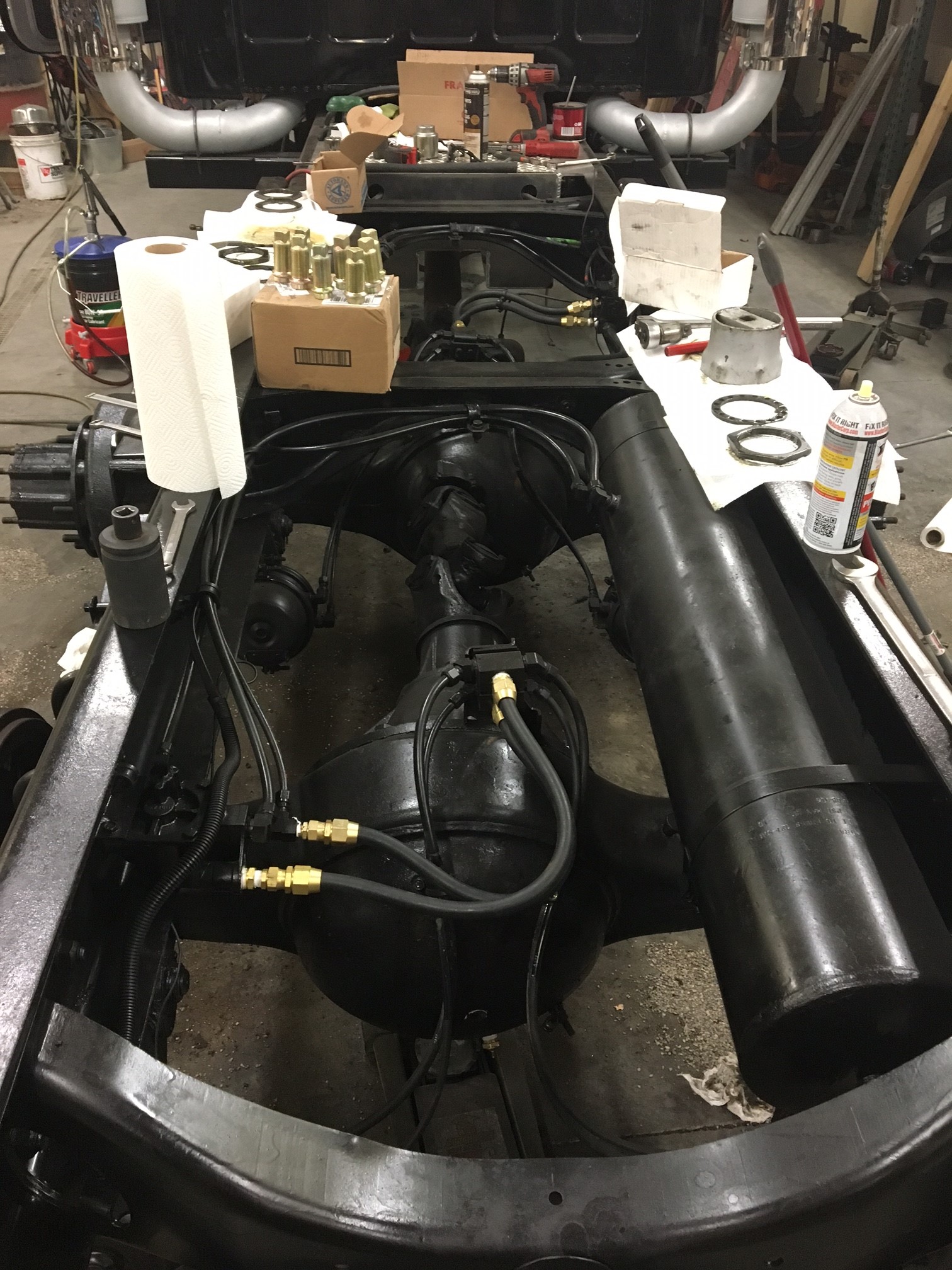

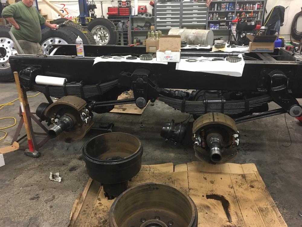

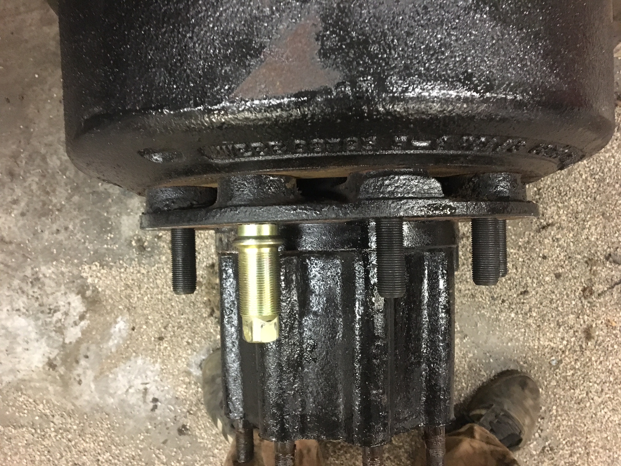

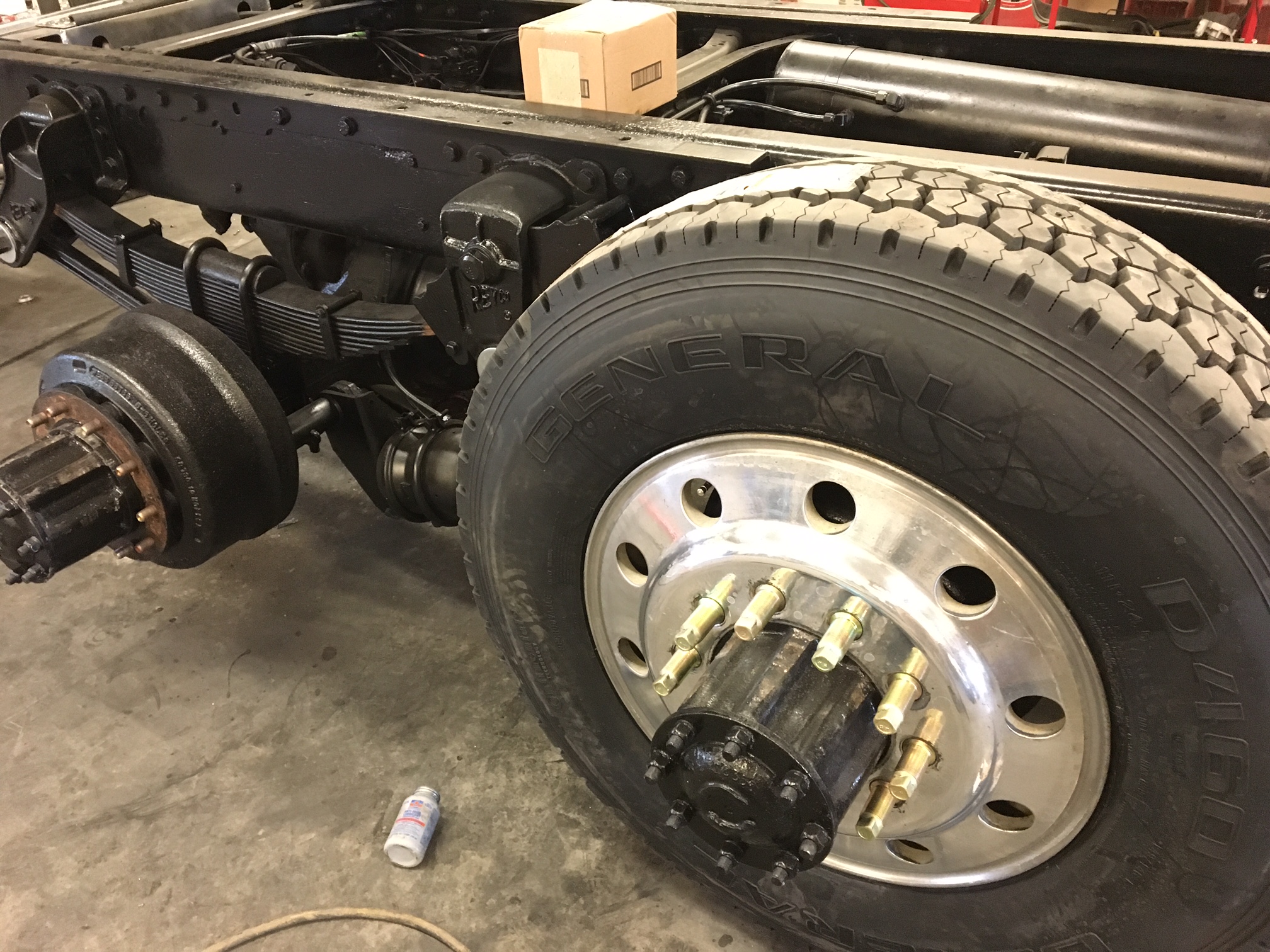

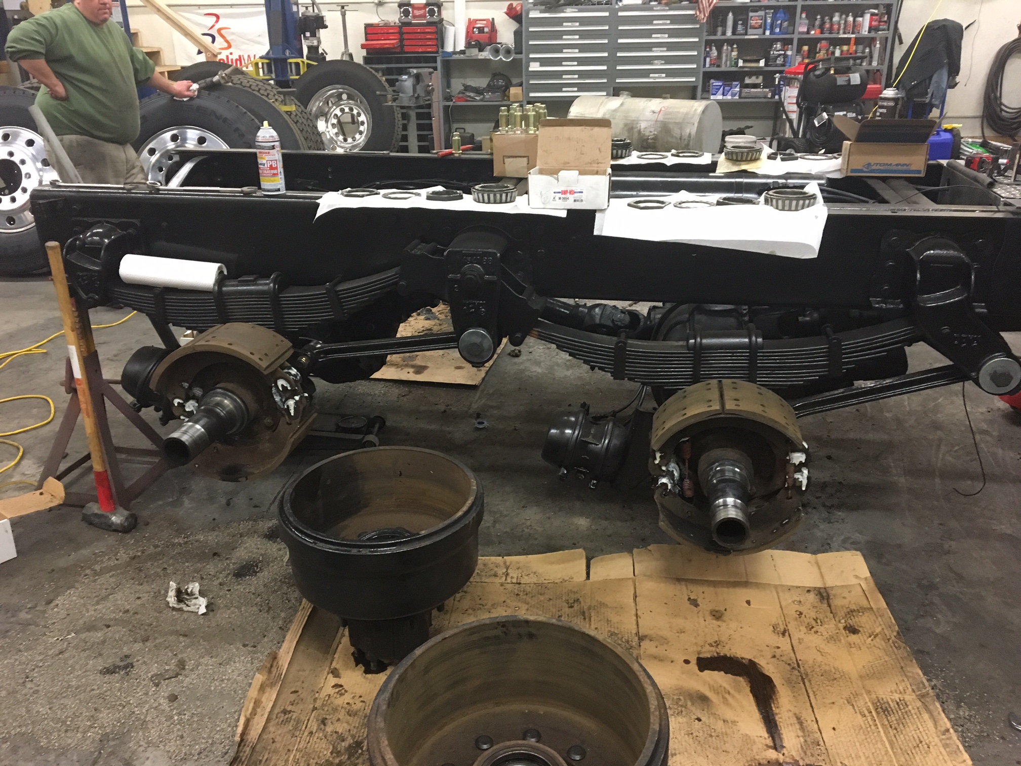

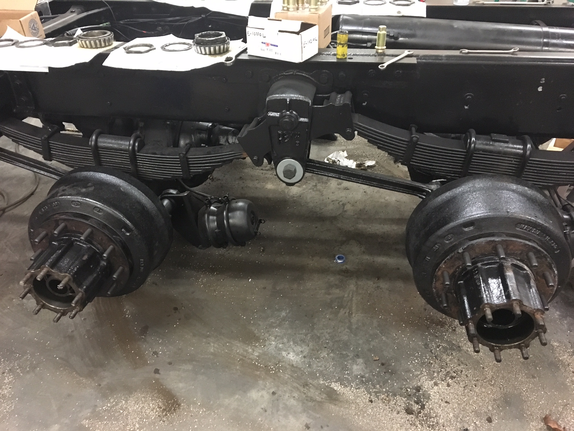

The studs were waiting for me after work, so i got busy and took the other three axles out and hubs apart.  drove the old studs out and pounded the new studs in.  I grabbed a piece of 1.5" diameter x 2 ft long piece of bar so i could pound on the head of the stud without being inside the drum.  I cleaned the brakes, lubed the pivots, and got all four drums back on and set the spindle nuts.  I took one lug nut and screwed it on all the way. plenty of thread engagement now.  Before i started this process on monday night I had to make the 4 airlines to go from the valve bodies on the frame rail to the junction blocks on top of the axles so i could charge the brakes and brake all the slack adjusters loose. i included a picture of old stud compared to the new stud.

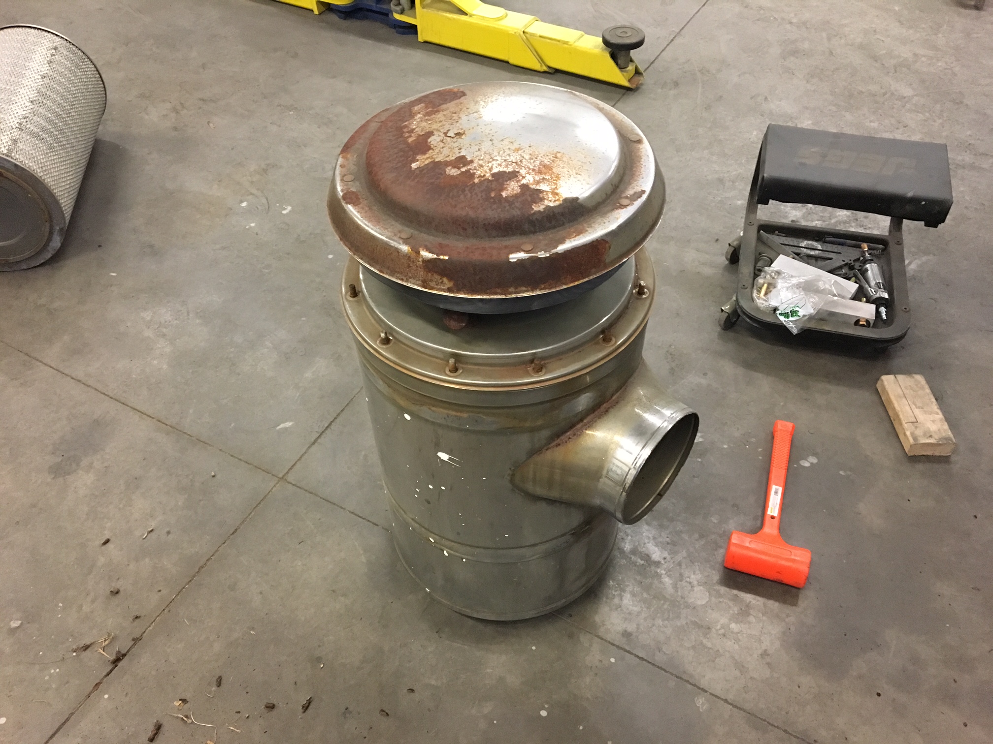

Probably to your advantage to pull the cap off. There looks like a good amount of mung in the tank. Probably would have caused a bit of grief down the road.   Paul

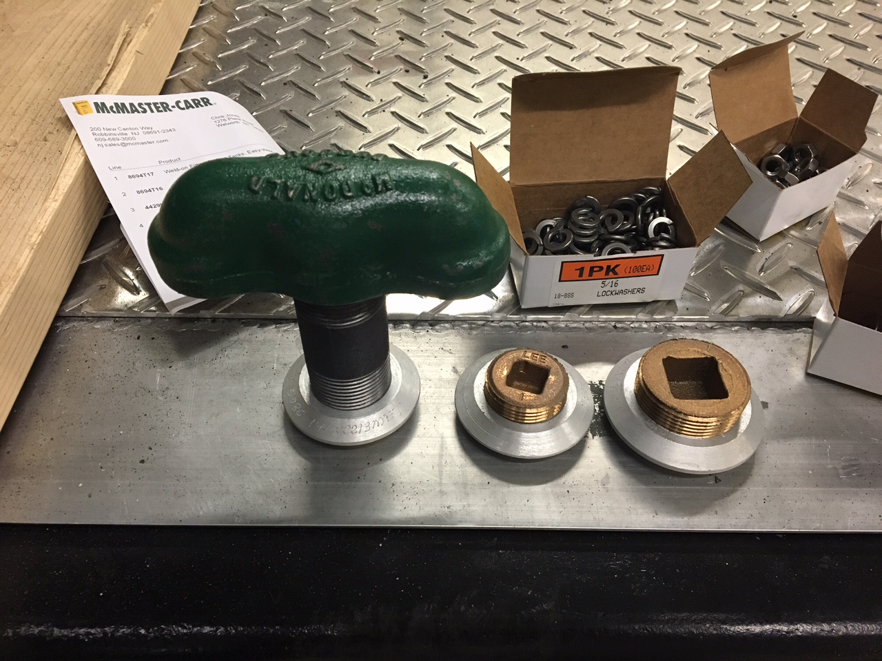

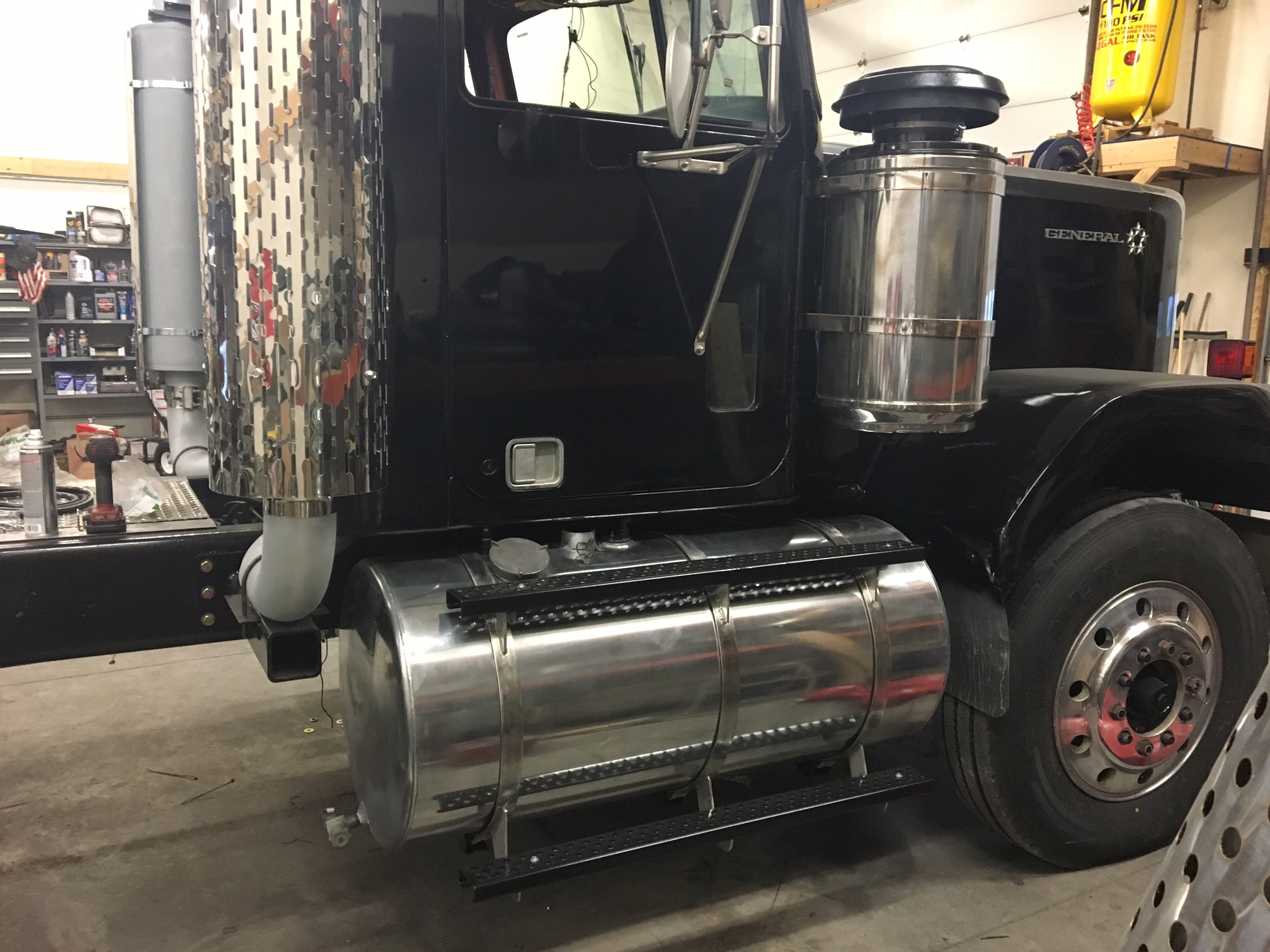

Where do you purchase the aluminum bungs for the tank hydraulic fittings? I am looking for the same thing to convert a fuel tank.
