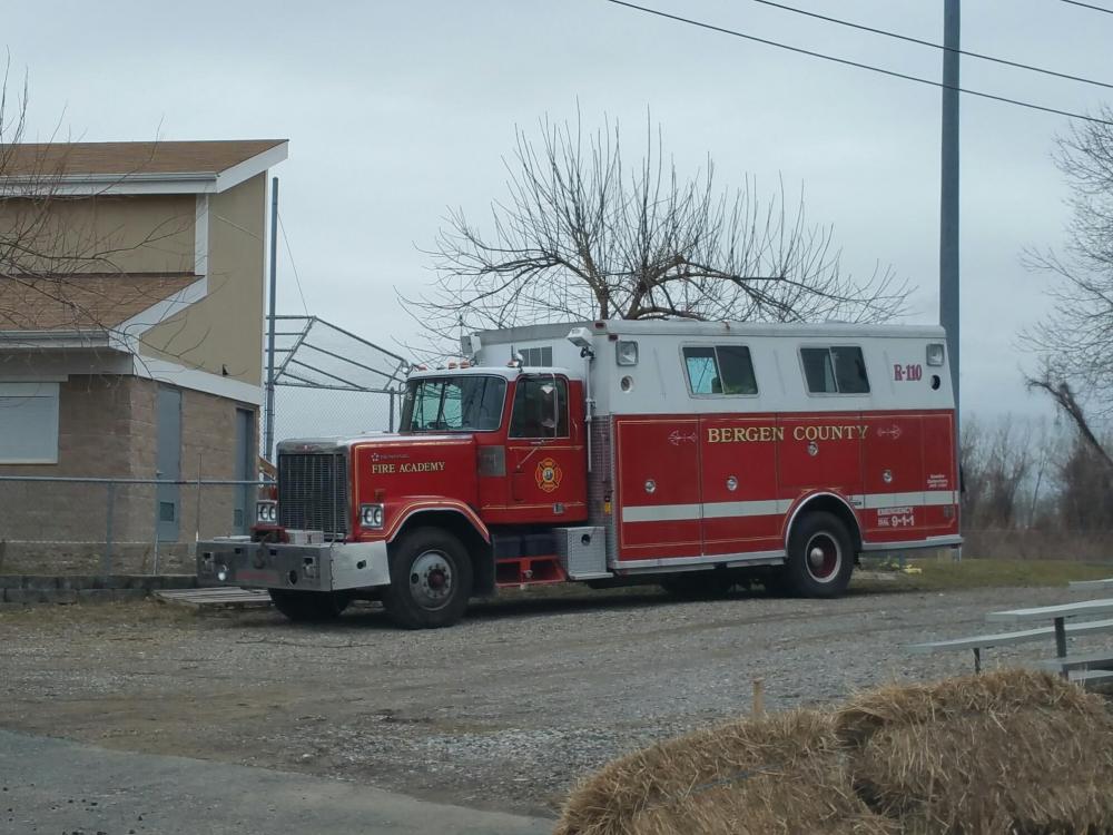

While we're talking about Generals...... This ex heavy rescue/squad is destined for work doing breast cancer awareness. Its going to end up pink I have a feeling.
Credit to original photographer.... Grabbed it off of EMTBravo.net
image.thumb.jpeg.c81aac7739220deb54876a5
Thats pretty cool. There will never be too many General pictures on this thread.
