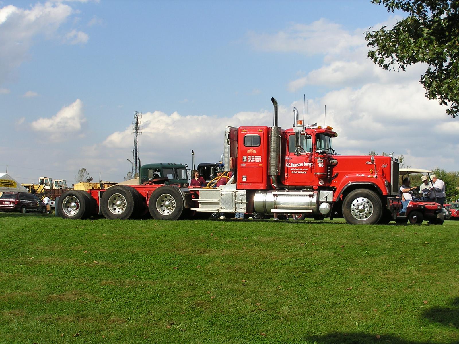

That red Superliner with the rear tag is something not many people do, I have pondered setting a tandem up to accept a pin on axle for a lowboy that way you can pin it on use it then when you dont need it just set it off and your back to a tandem and the shorter wheelbase. A steer tag in front of the drives is best but it means stretching the frame and makes the wheelbase longer so the truck gets a little harder to get into tight spots. From what your describing and the areas your working in if it was me I would go to a dealer that sells lowboy trailers and pin on axles and price a pin on and the work to add the brackets and wiring/air line connections. I think that would give you the maneuverability your looking for and the ability to haul more weight when needed. Remember whichever way you go once you have three rear axles you'll need the fifth wheel slider to be able to set over the center axle to distribute the weight right so it will probably need to be moved a few inches too. An added bonus to the pin on would be no real added weight when it was off the truck so you keep your payload, with a tag and a stretch you'll add about 2,000#or more to the truck.

He should really just do the traditional setup around our area with the steerable lift in the front of the tandems. The area VP is in sucks ass for getting around. I've seen the rear tag with steerable. The add on rear tag on Hudson's truck I've seen quite often here in my area with the Canadians coming up from the ports into NY state with heavy haul. I had some pics somewhere. There are a lot of companies from Quebec that have that and they have to stop in Hillburn to get cleared from the NY state troopers to go ahead. Sometimes they are there for a couple of days parked up.

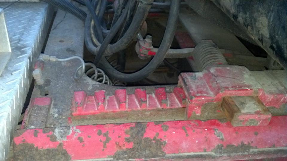

Pic 1 I am close but not as close as I can get. 19500 on the steer

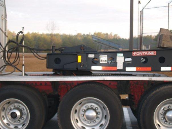

Pic 2 4 teeth showing. 20400 on steer with 110 pounds in tag axle

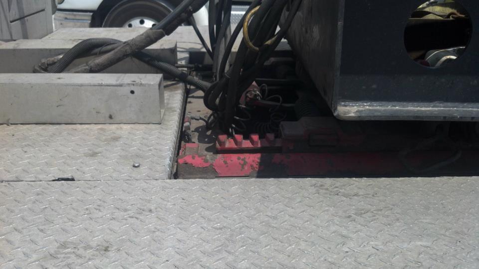

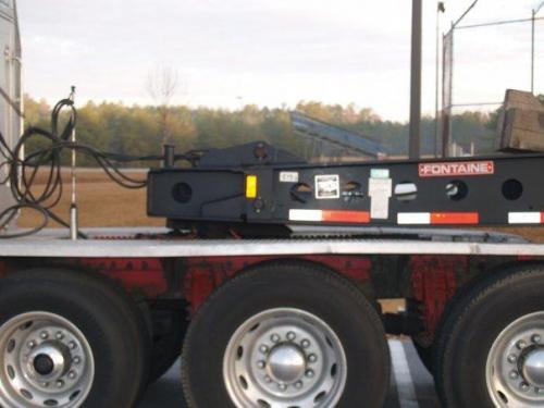

Pic 3 neck extentions work wonders. you get the reach and you can move 3 to 4k forward or backward just moving the kingpin and not sliding. Ditch the Rogers and get a Fontaine. Also there is 6' of slide there. I can move weight where I want and scale damn near what I want. 104k on the deck 20,60,80 on the money. Might want to relook into the config you have. Not saying you do not have enough truck or trailer but you do not have the bridge. Ergo you do not have enough truck or trailer. Move the kingpin forward think it is a couple grand to do. put it at the very front of the neck if it is not there. A few inches or a foot make a big difference.
if you are close on your drives now then adding a 4th is not going to help on the trailer as once you pin a 4th in place on the trailer it shoves 4 k forward. ergo you need the neck. It is a never ending battle just my 2 cents
