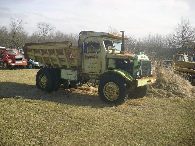

AHHH That would have been a 10UD, small cab, able to carry 10 ton or so.
Rick
I had no idea. It was very small by today's standards though, wish i'd known what a camera was back then.
I just did a google image search for Euclid trucks, and this looked most like what I remember. The one I drove had the stack coming through the hood- no muffler,just a straight pipe,about 2 feets tall.
Yep, that is all UD, little 10 toner.
