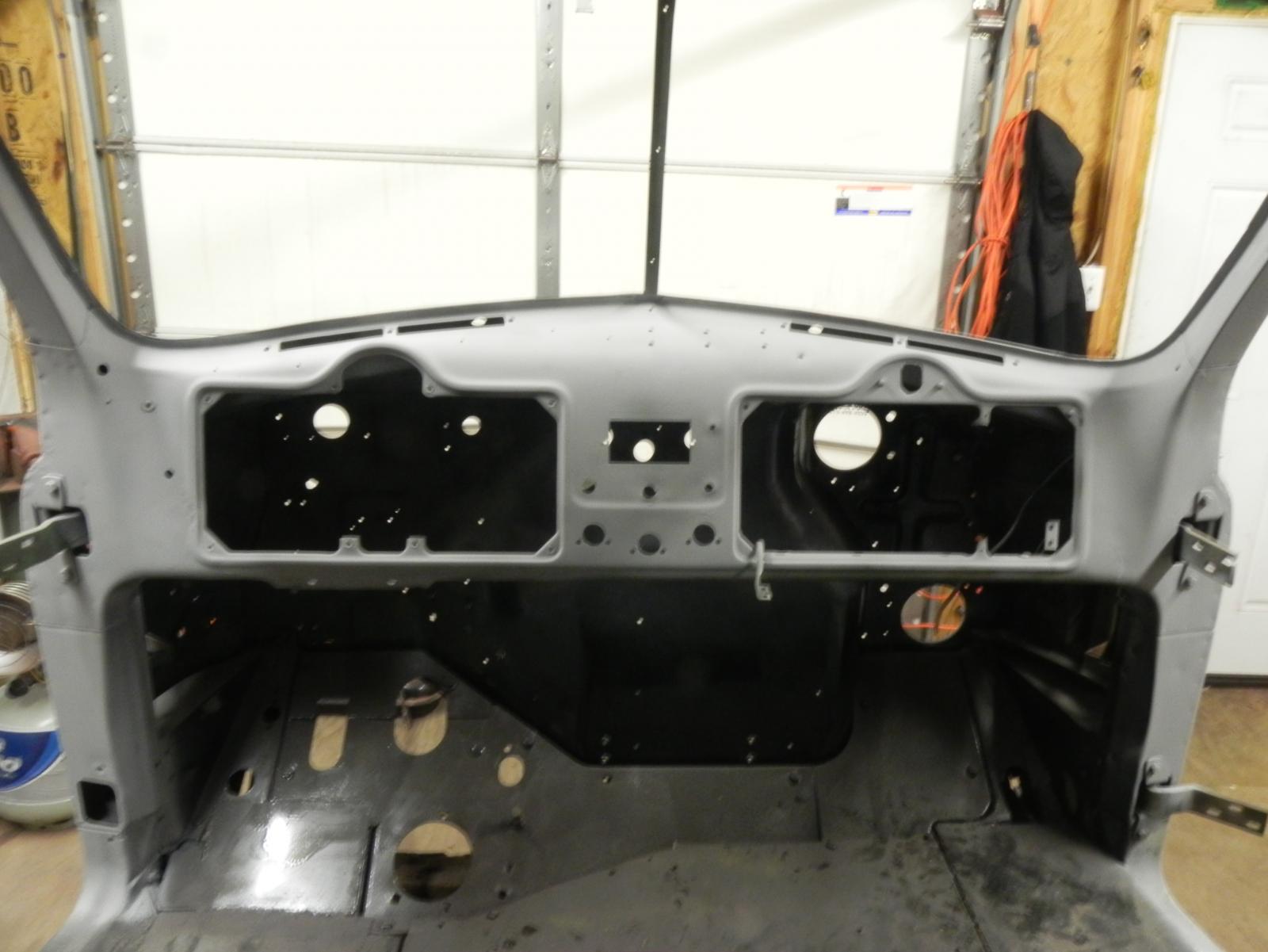

Wow, nice work. You take this extremely seriously. I'd love to go that far but funds and free time and the better half's patience wear thin. I have to post some progress pics myself but I don't plan to take it anywhere near that far. One question I have is what are the two large holes through the passenger side of the dash for and what is supposed to plug them up. I had two plastic coffee can lids silicone into them and I'm pretty sure that they are not Mack coffee can lids.

Those 2 holes are for different air cleaners setup.My 2 will be block off also.We had a piece of diamond plate alum.covering these 2 hole.I haven't decided what i am going to use.I never intended to take the truck this far,but you all know one thing leads to another.My truck was a road worthly as i drove it into the shop.Like i have said before this truck has been in the family since new and i don't think it has 300,000 miles on it.Hell it never went further than 60 miles from home until the early 80's.It was always kept in the garage at nights.

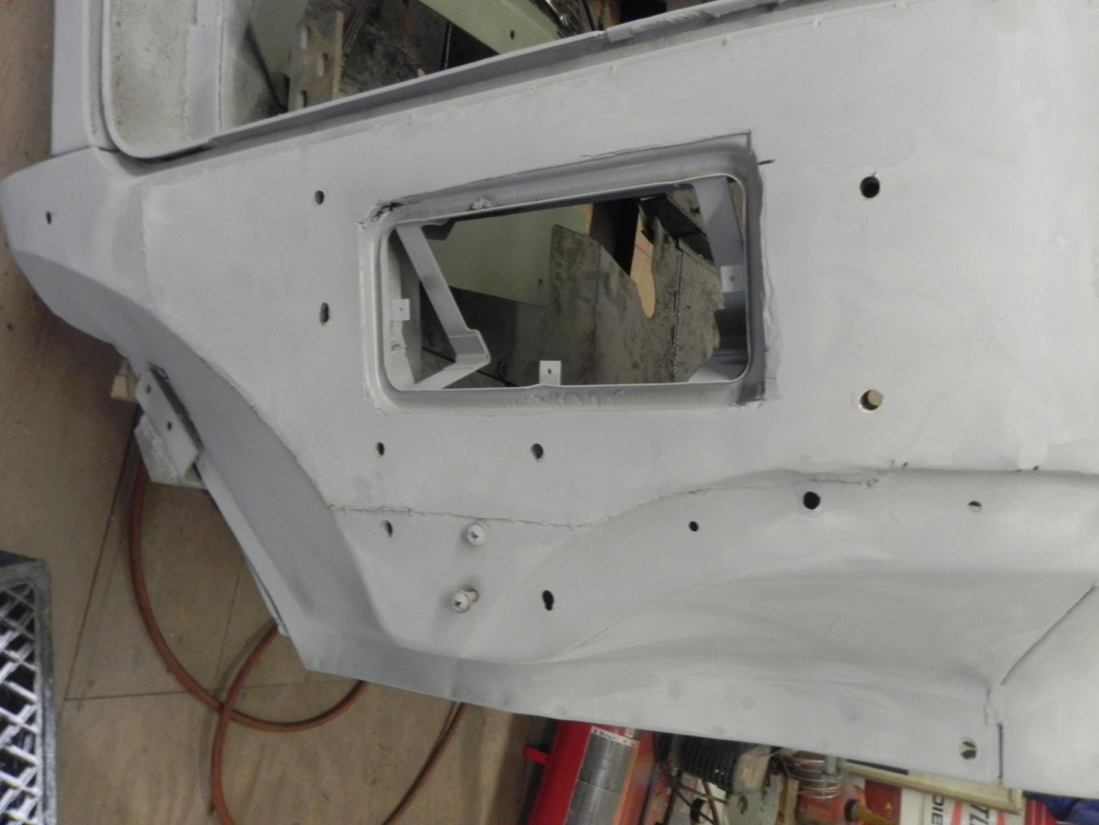

Did alittle more work on the cab.You are looking at the right side air vent that is under the aircleaner.Once I removed the aircleaner and the bracket that holds it to the cab I found that over the years moisture had gotten under the bracket and rotted some of the cab.If i had never taken the bracket off i wouldn't had seen it,good reason for taking the cab down as far as i did.I made a patch for it and then had to redrill the holes that hold the bracket to the cab and then cut out for the vent.
Well did alittle more on the old girl.The two grab handles that are on the cab I had to re drill them since the old on broke off.I'm thinking of what I will do next,would like to get the inside all done and ready for paint within the next two weeks.Will post pic. when I get something done that worth while.

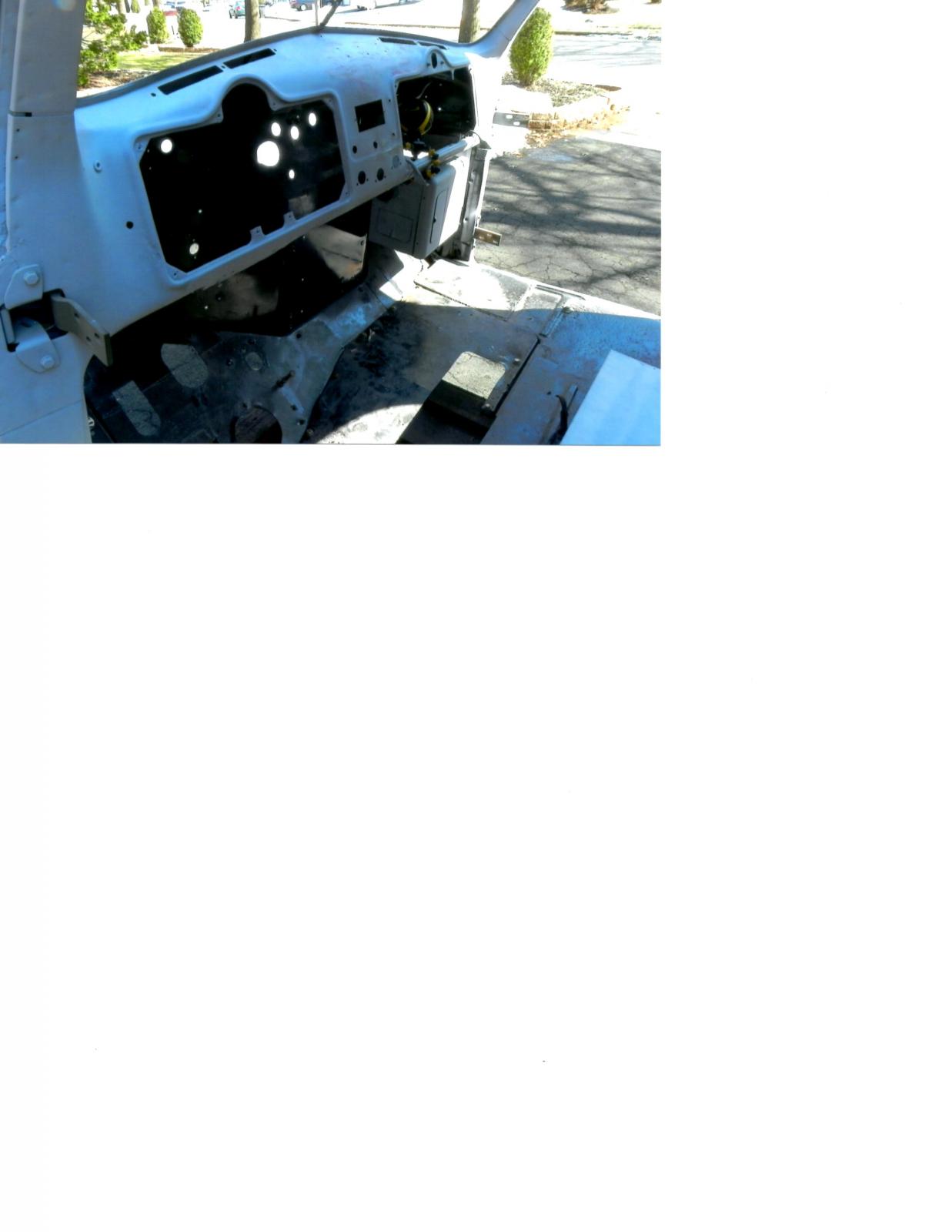

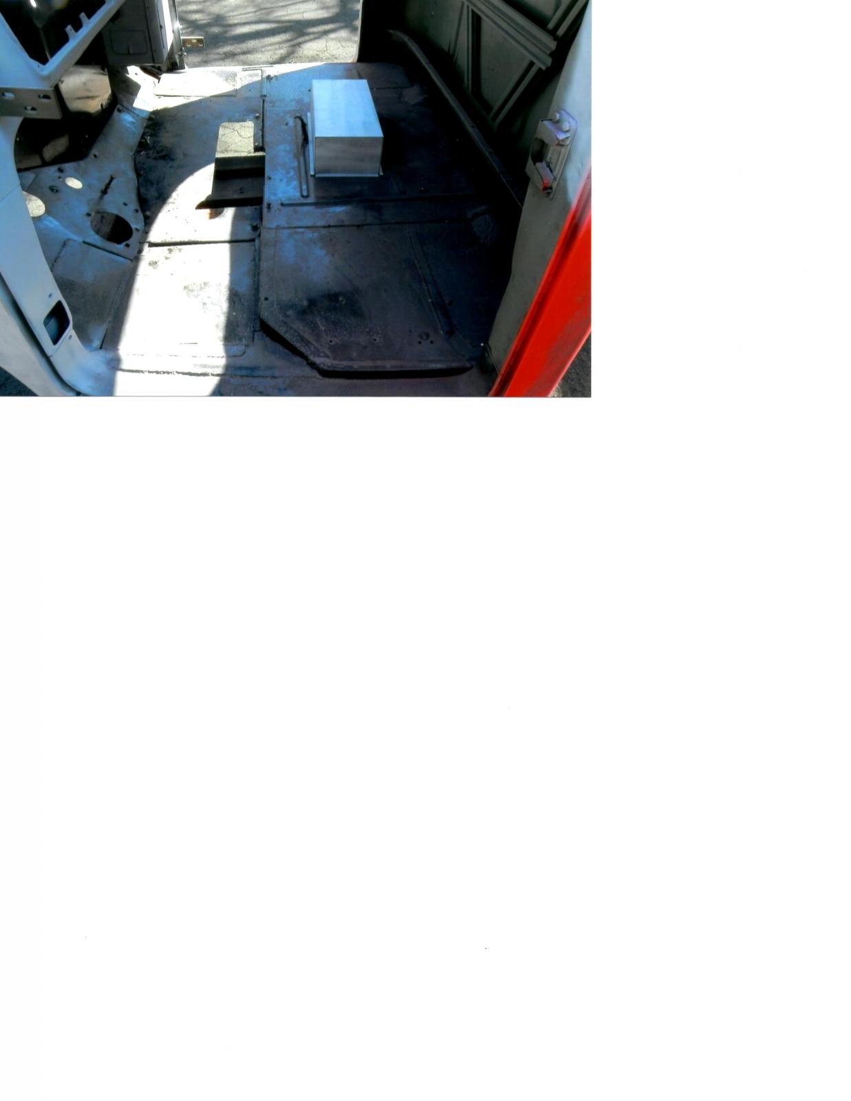

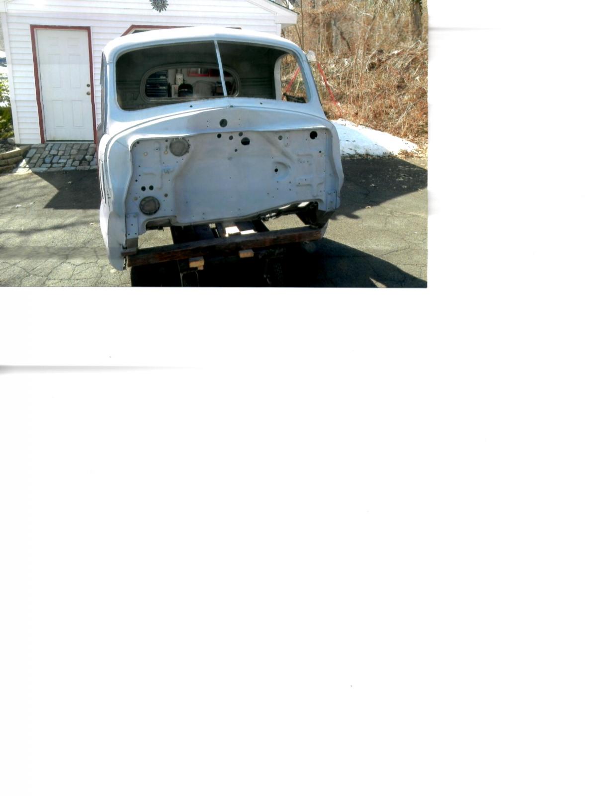

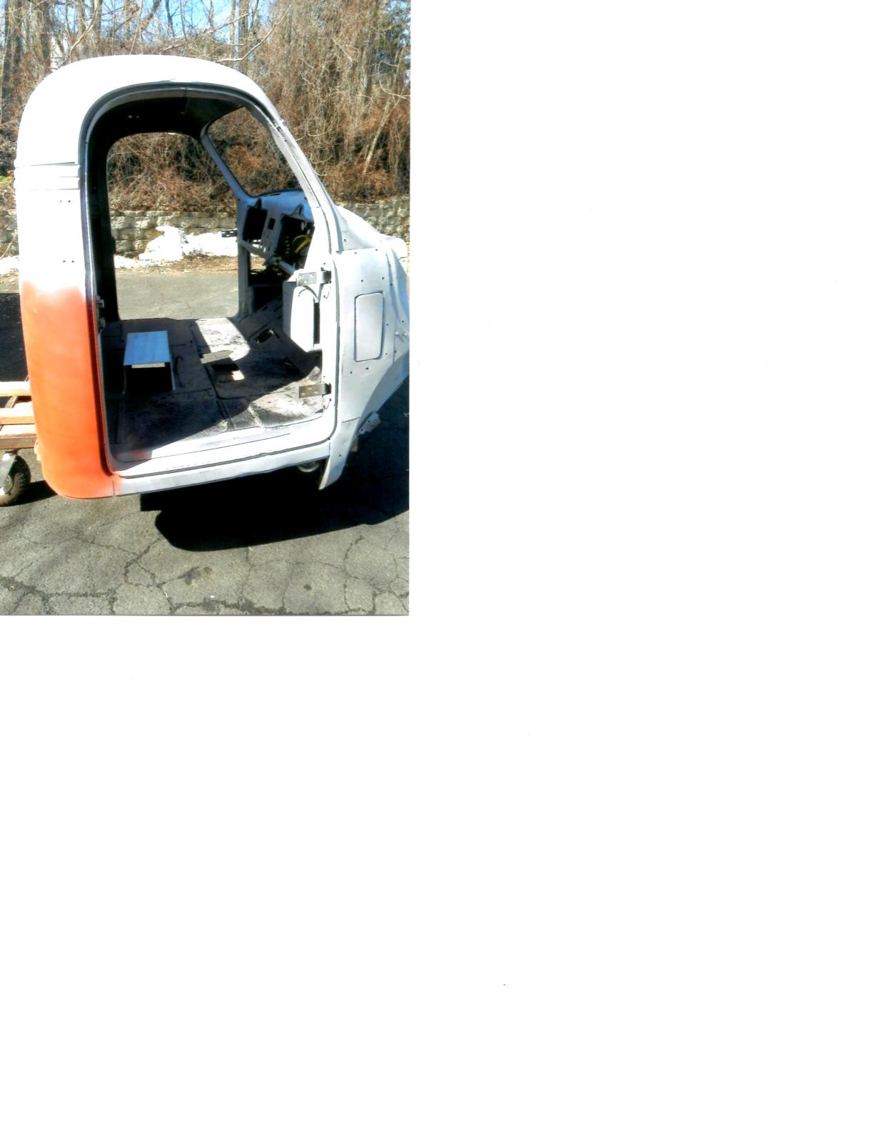

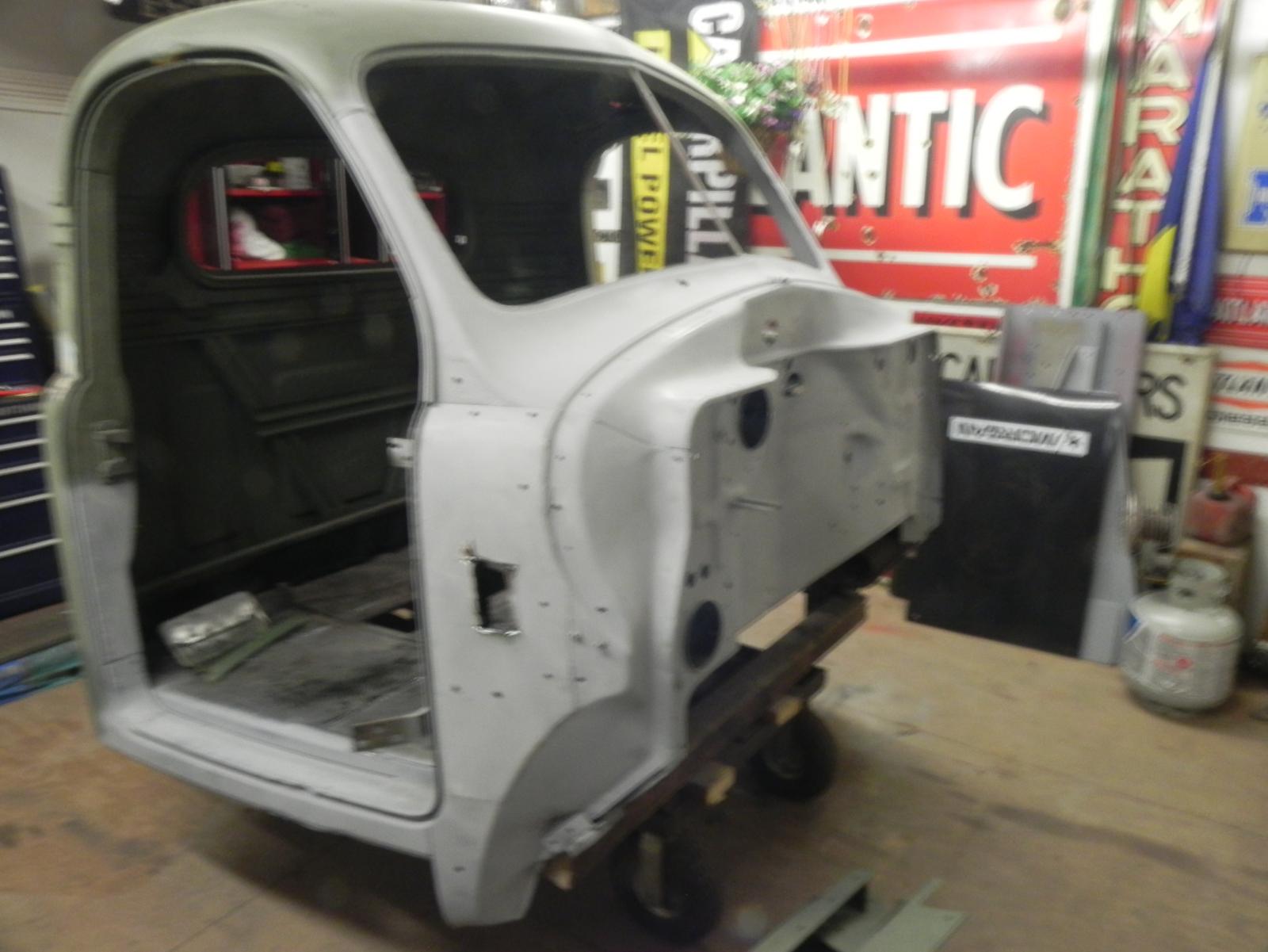

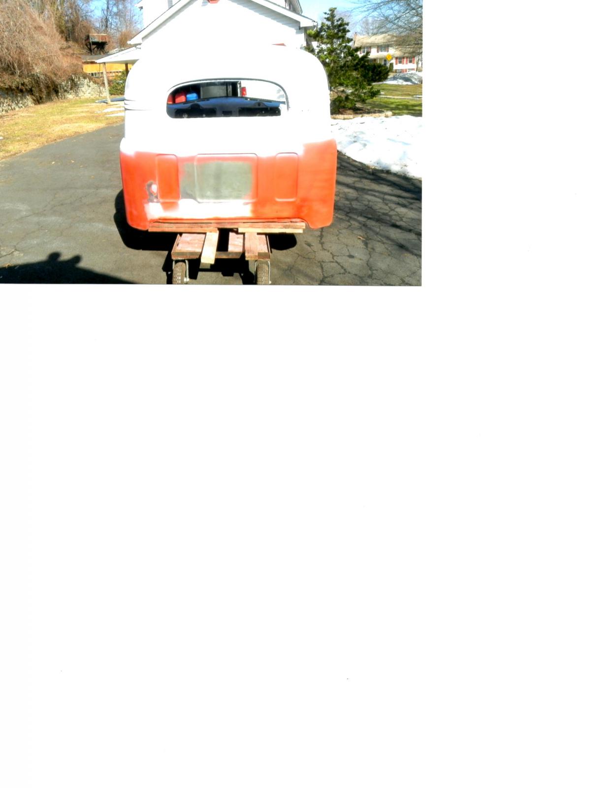

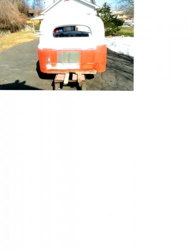

Still haven't been cleared by the doctor or the wife to do any heavy lifting,since the last surgery.Will be going back to the doc this Friday till then the wife has been watching me like a hawk.But I did managed to do somemore body work on the old girl.It just about ready for the paint booth.Besides having the wife watching me the weather has just plain sucks with all this snow and cold temp that we have been having to get any painting done.Hopefully the next 2 weeks will be better.Here are the latest pictures of the old girl.
