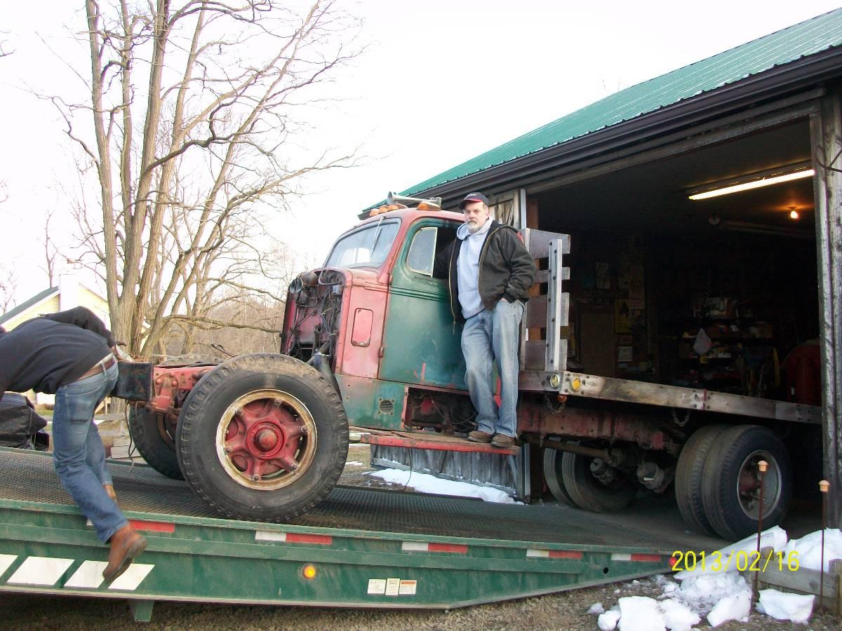

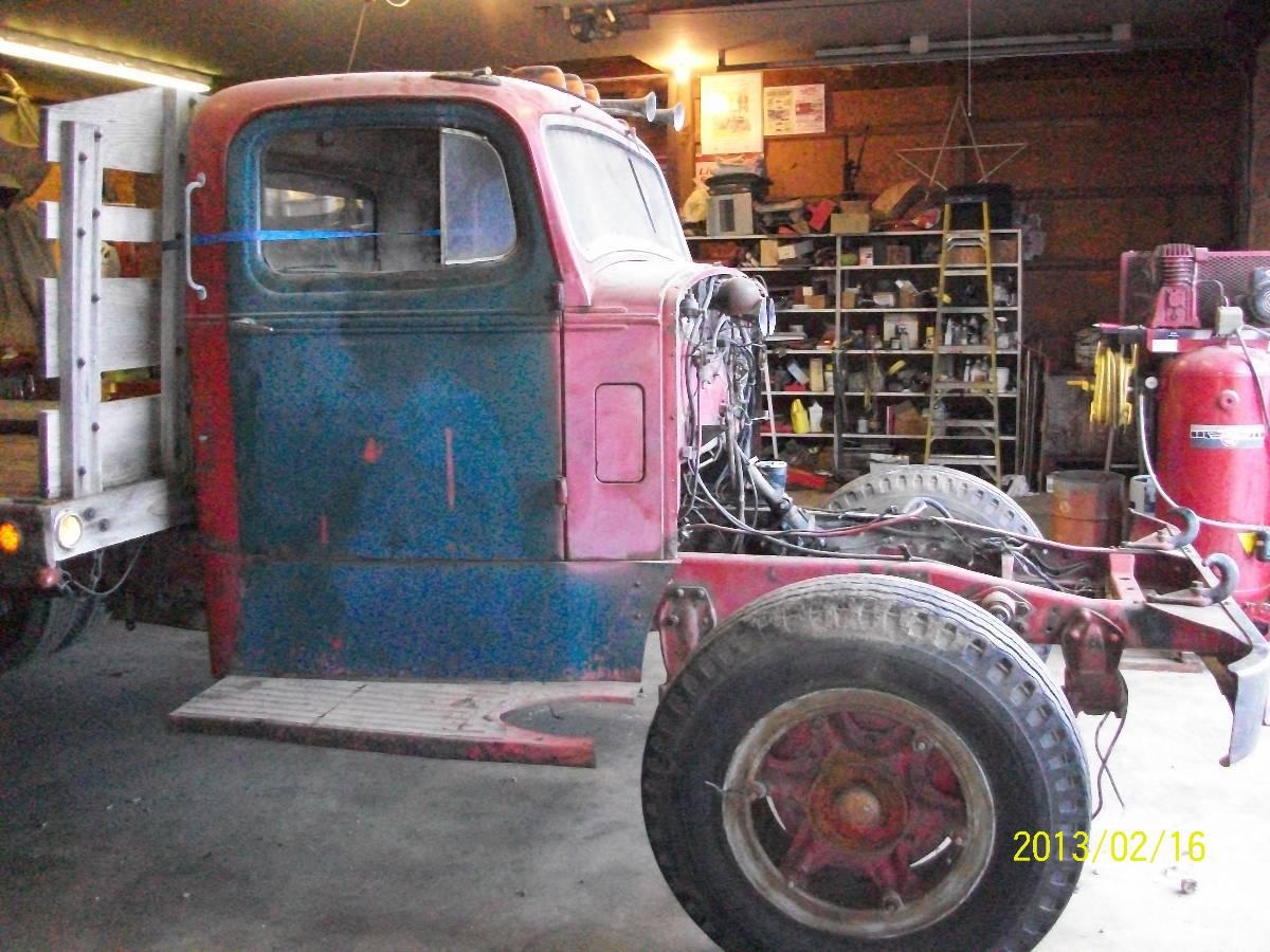

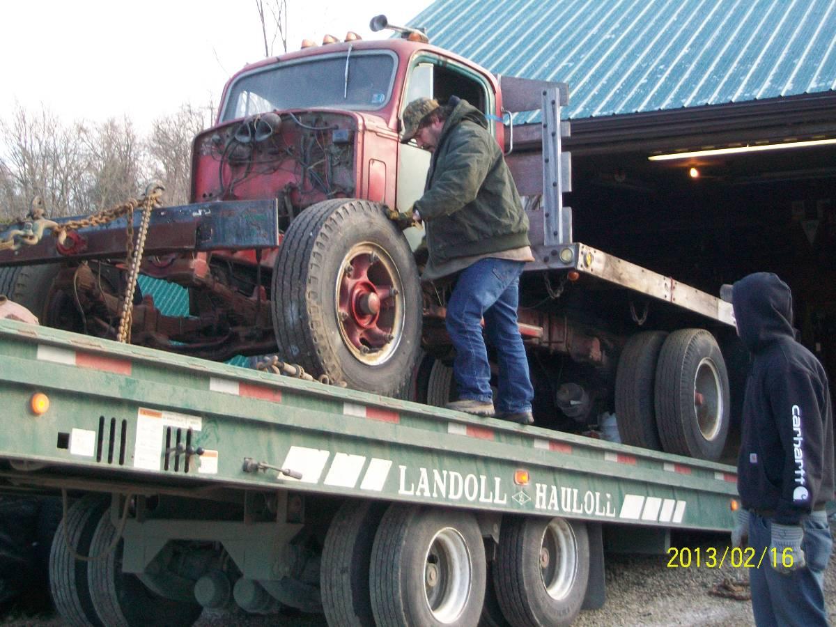

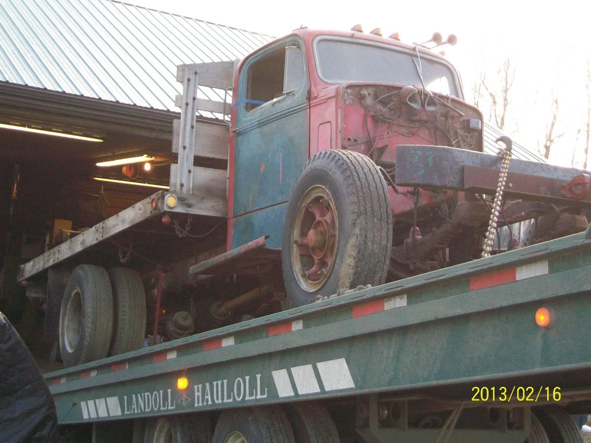

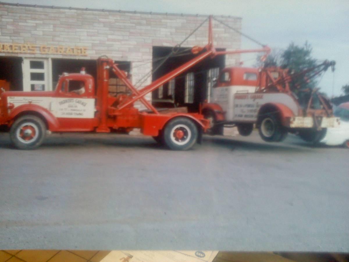

Here are some pictures of the trucks, First (4) are the A40X i purchased for the rebuid. Actually in very good shape, lots of sheet metal, hoods, doors etc. Fresh rebuild on engine and tranny. Lots of parts . Last is the 51 A40H i'm going to restore, This was taken after they built it back in the 60's. Let the fun begin.
Bp
Actually the flat bed owner was a friend of mine. He restored old construction equipment, and was going to haul a cat dozer he had restored. However he got sick and passed away before he could complete his restoration of the truck. Very sad.. My grandfather was a smart old guy, started our repair business in 1934. He designed and with my father and uncle built the wrecker body you see there. Yes it is picking it up off the ground, very impressive for the 1960's
