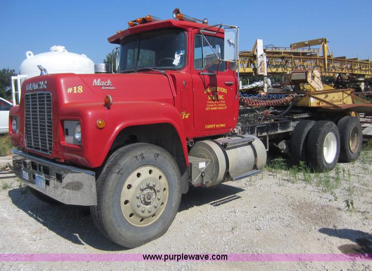

I don't  know , Kevin . I think this was has Western  tanks on it.     Al
On 3/16/2016 at 8:48 PM, PeterMack said:
On 4/30/2016 at 0:38 PM, ranchhopper said:
Yes sir,but it is an Allentown  R. The Roadway spec R's(eastern ) also used the same fuel  tank  set up.
The difference is mack western used a tank bracket that held the tank closer to the frame that's how they were able to use external steps. The truck I want to put a tank on has a long air tank on the drivers side and need to use the eastern style tank brackets that hold the tank further from the frame to hold the fuel tank away from the air tank so I need a 100 gallon tank with the step inset into the tank. You can use the western style tank on any R model as long as there isn't that long air tank on the drivers side because it hangs past the frame not allowing the western style fuel tank enough clearance to miss the air tank.

I don't know any of this to be correct it just from reading so I could easily be confused.     Didn't the western trucks have straight frame rails, where the eastern ones had rails that flared out in the front? Would there be different tank brackets to compensate for the flare of the frame so the tanks would be straight?

Aluminum frame rails were straight both my Hayward trucks have straight frames the superliner has an aluminum frame with a steel frame section slid into the front from the battery boxes forward.
you are correct that the westerns had straight rails nose to tail. not sure on the tank brackets but that makes sence as well as the eastern R model frames did flare out near the firewall
