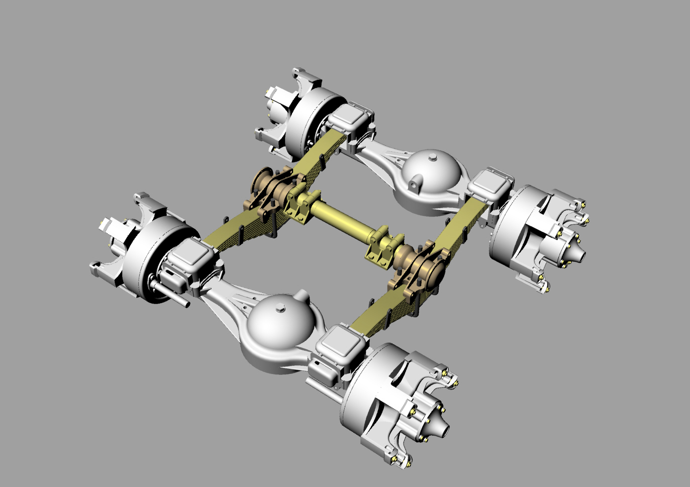

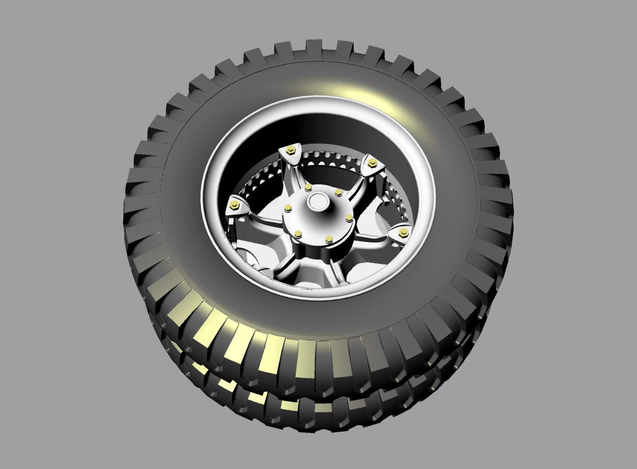

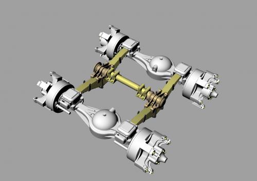

Modelling is not too popular on BMT, it's like a small "club in the club". I know AMT R is good detailed and far true than Italery RW. Although I want to keep myself on 1:24. There are some BMW cars on my shelf and Monogramm AC Bulldog started. So I don't want to mix. At least yet. Combining 1:24 with !:25 isn't too carefull way, sometimes it could give a strange look. I also made springs but of cooper sheet but with a big deal of labour having no laser or disc saw. They're perfect, were made for AC but a front pair at the moment only. Will post them if interesting. I may note, I'm attacing with a wide front. Having one more project of L model rear bogie that is actually army NR but close to be similar. I contacted professional maquette firm and put an order. For a bogie as a beginning. They're asking money of course and work now extremely slow. It's Russia. Everything they do is 3D drowing with next frezering from plastic. And resin copieing of course. The product seems to me impressive but too long in a time.
