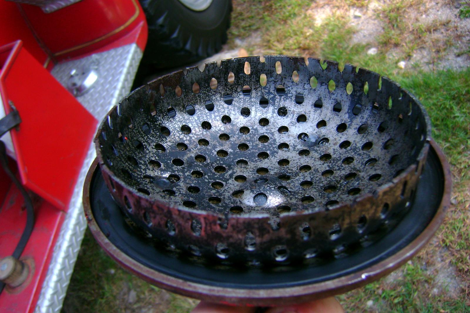

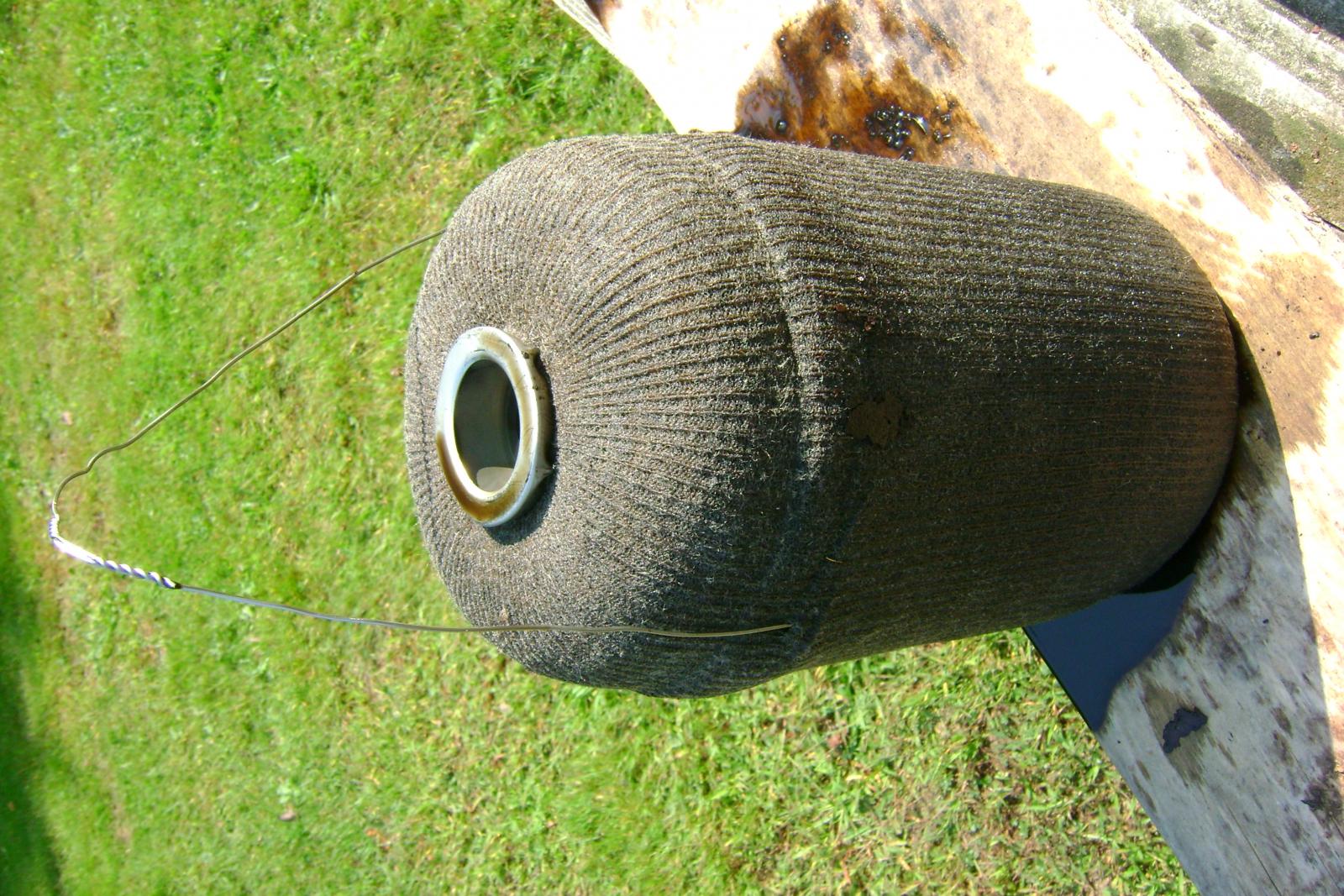

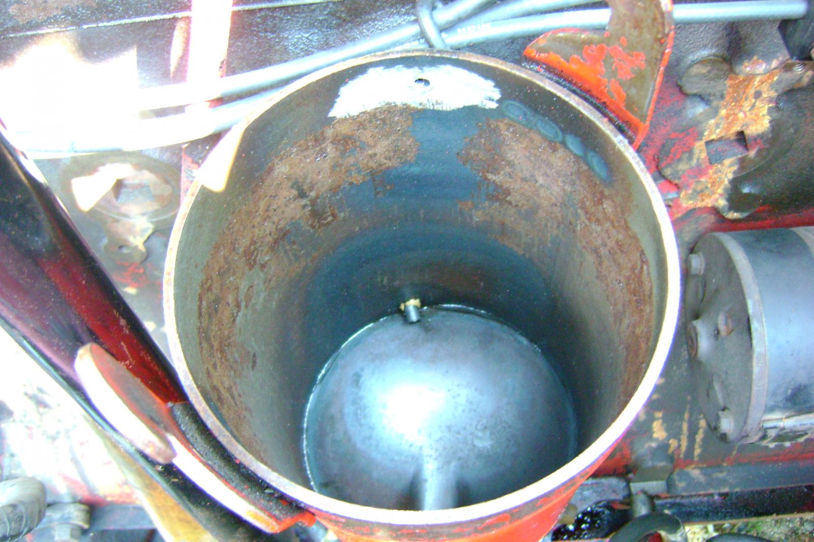

Hi, Went to Napa and got a 1503 filter the other day......finally got around to changing the oil today. It seems i must have a different style oil filter housing. The old filter measured 9 -1/2 x 5-7/8......i'll try to post some pictures of it......Thanks

The NAPA 1503 is a cartridge filter about 4" X 8".  The Baldwin DF 408 is a sock filter measuring about 5.75" X 10".
