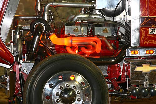

is there any truth to the tell that the last E-9's were slightly over 1000 cubes?
I used to have the p/n for oversized liners/pistons they add a few cubes over the 1000 mark I cant remember what the actual displacement was now Ill try to find the info. I know the Killer Mack and Buckeye Bulldog are over 1000, way over I was told. not to mention quad turboed and nitrous and water injected, you know for fuel economy.
