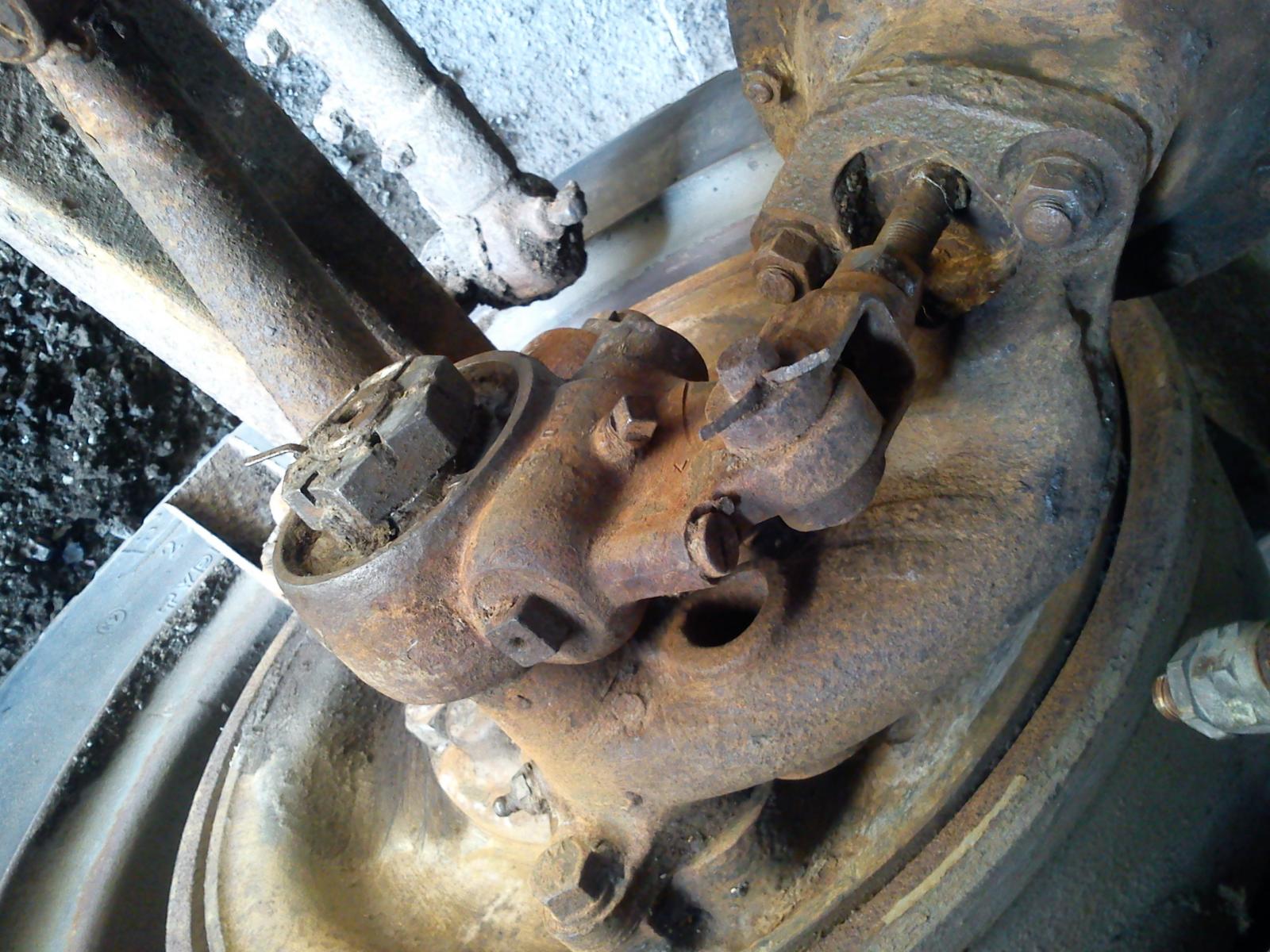

Sounds like what it looks like. The other post, above, mentioned a fairly small bolt on a Mack-specific adjuster. But, as I said there, this hex is HUGE. It is almost as large as the shaft itself. Any way I can identify what we have here by looking? The adjuster collar/bolt looks exactly like the others I've seen, except for the lack of a snap-ring.
Old fashion ajusters look so.
The only fixing nut is at the end of the shaft.
But this one is of 1945.
Vlad
Actually, what I saw doesn' look anything like that. I'll check when I get home this evening; I MAY have a picture that shows one of the adjusters. I took several in that area, so MAYBE I got lucky and caught a glimpse of one!

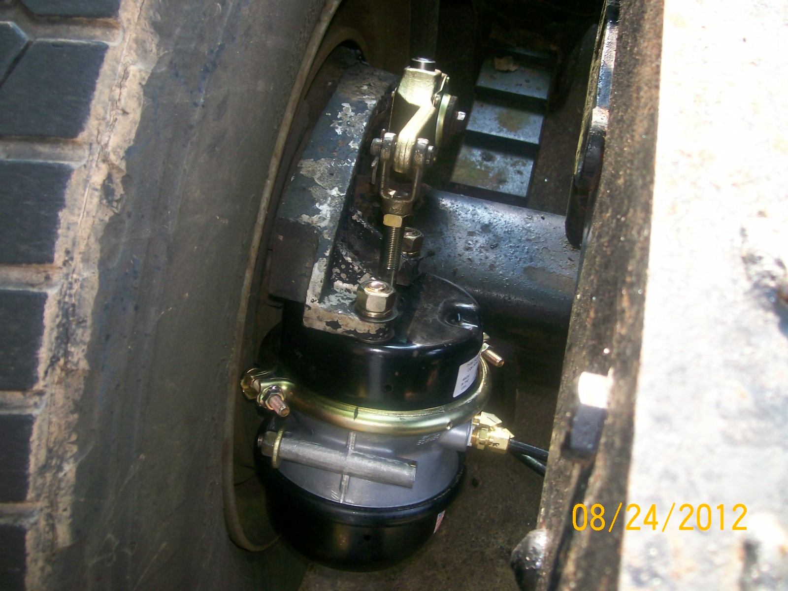

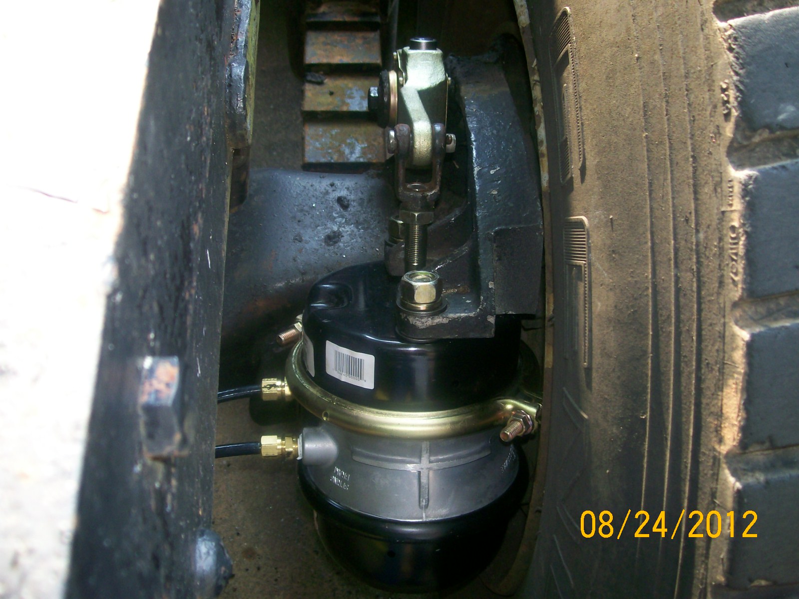

I took one slack adjuster loose to see what was in there. The center bolt and washer do indeed hold a more-or-less standard adjuster in place.
The cam shaft is 1-1/2" X 10 splines, which is fairly standard. The adjuster length is 7", and is offset about 5/8".
The Bendix numbers I found in the book are 279946N and 279947N. These look right. Now, all I have to do is find some "in-stock" somewhere!
I found a mail-order outfit that can get these. So, I ordered 2 left and 2 right pieces. Should be here in a couple of weeks.

Wow! I forgot to look! They were smaller than I originally thought. Seems like the heads may have only been about 3/4"-7/8". And, with the bolt out, I cold easily slide the adjuster on the shaft. That's how I got a decent measurement on the shaft; by pulling the adjuster out and measuring the shaft "behind" it.

Looks like a new one !
Ron
Thanks, Ron.
Stops like a new one, too! And, leaks a lot less!
