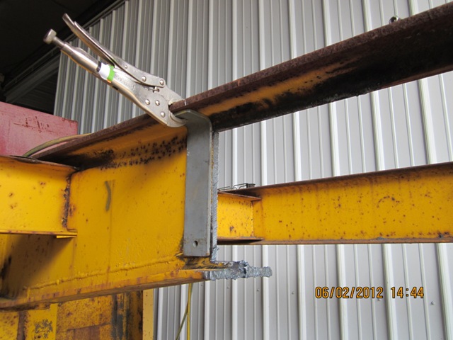

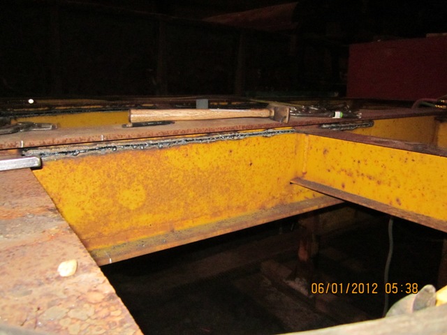

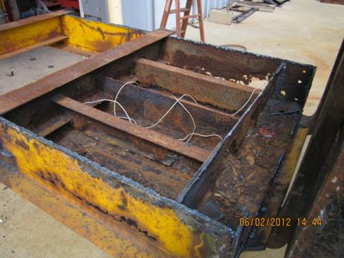

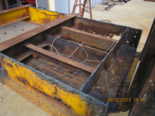

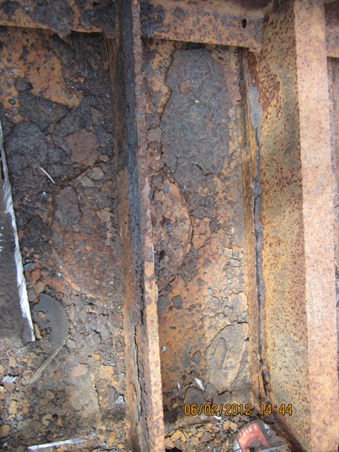

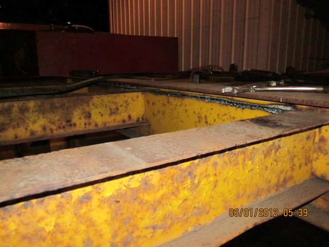

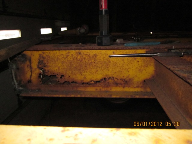

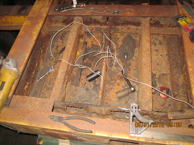

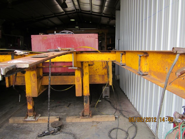

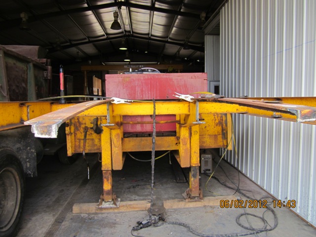

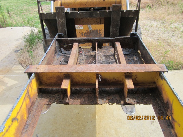

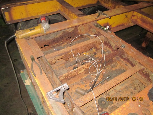

Getting a little done on the neck today. Had a lot of rust in the beams and crossmembers thanks to nearly six inches of mud residing under the wood deck in the boxed areas and fifth wheel plate.
Here are some initial photos of what I'm working with and initial cut(s):
post-78-0-55154500-1338693616_thumb.jpgpost-78-0-74058000-1338693619_thumb.jpgpost-78-0-16639100-1338693623_thumb.jpgpost-78-0-57484200-1338693627_thumb.jpgpost-78-0-82431000-1338693631_thumb.jpg

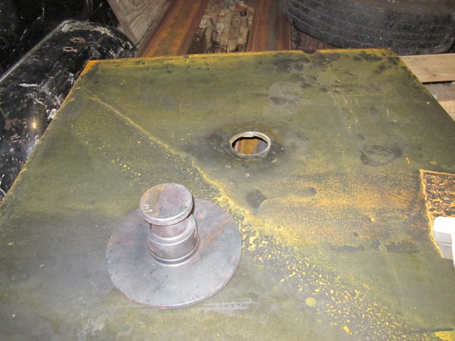

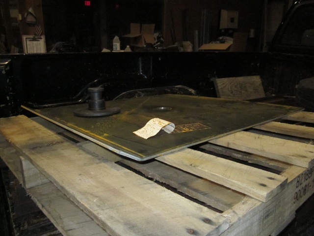

New fifth wheel plate I had sheared, bent, and bored for an 18" pin setting allowing an 84 inch swing clearance. Also new king pin to be welded in:

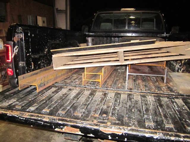

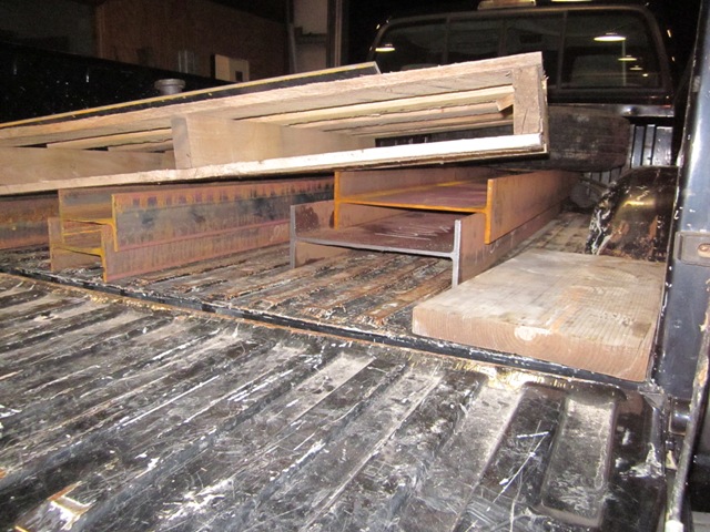

New steel beams for the main frame, and forward three crossmembers. I'm sectioning in 78" of new main frame beams,post-78-0-60620000-1338693703_thumb.jpgpost-78-0-72809100-1338693708_thumb.jpg

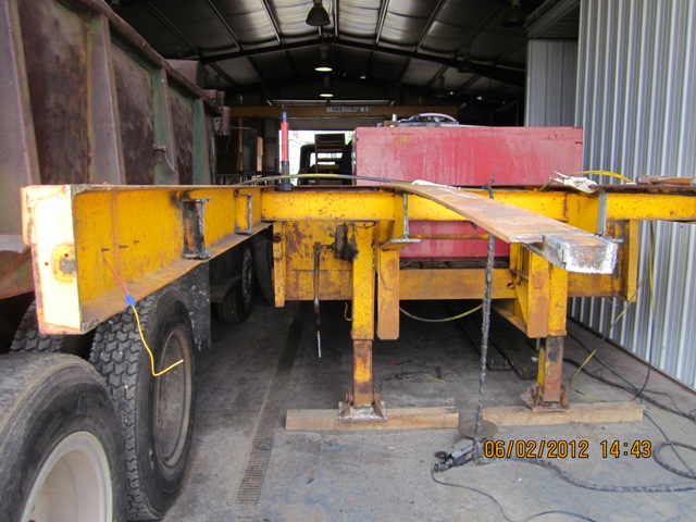

Shots with the pin box and main beams removed. Notice the "dogleg" in the lower main beam. This moves the "shear plane" from the welding to more than one spot:
post-78-0-55513100-1338693790_thumb.jpgpost-78-0-22227900-1338693795_thumb.jpgpost-78-0-50422200-1338693799_thumb.jpgpost-78-0-35253700-1338693803_thumb.jpg
And the pin box and most of the main beams remnants. It WAS a mess but should be sound when finished. The closing piece of channel across the front of the trailer is not shown and I need to modify it for tapers at both ends. Tomorrow I finish grind for fitment and possibly have most "jigged" into position for final install.

If you've never replaced a kingpin just note that it only gets welded on the top flange not on the shank.
HI there and thanks. I've never done one myself but had asked that question when I purchased the replacement. That pin fits through the holes with about .030 clearance and they did a good job making the plate.
