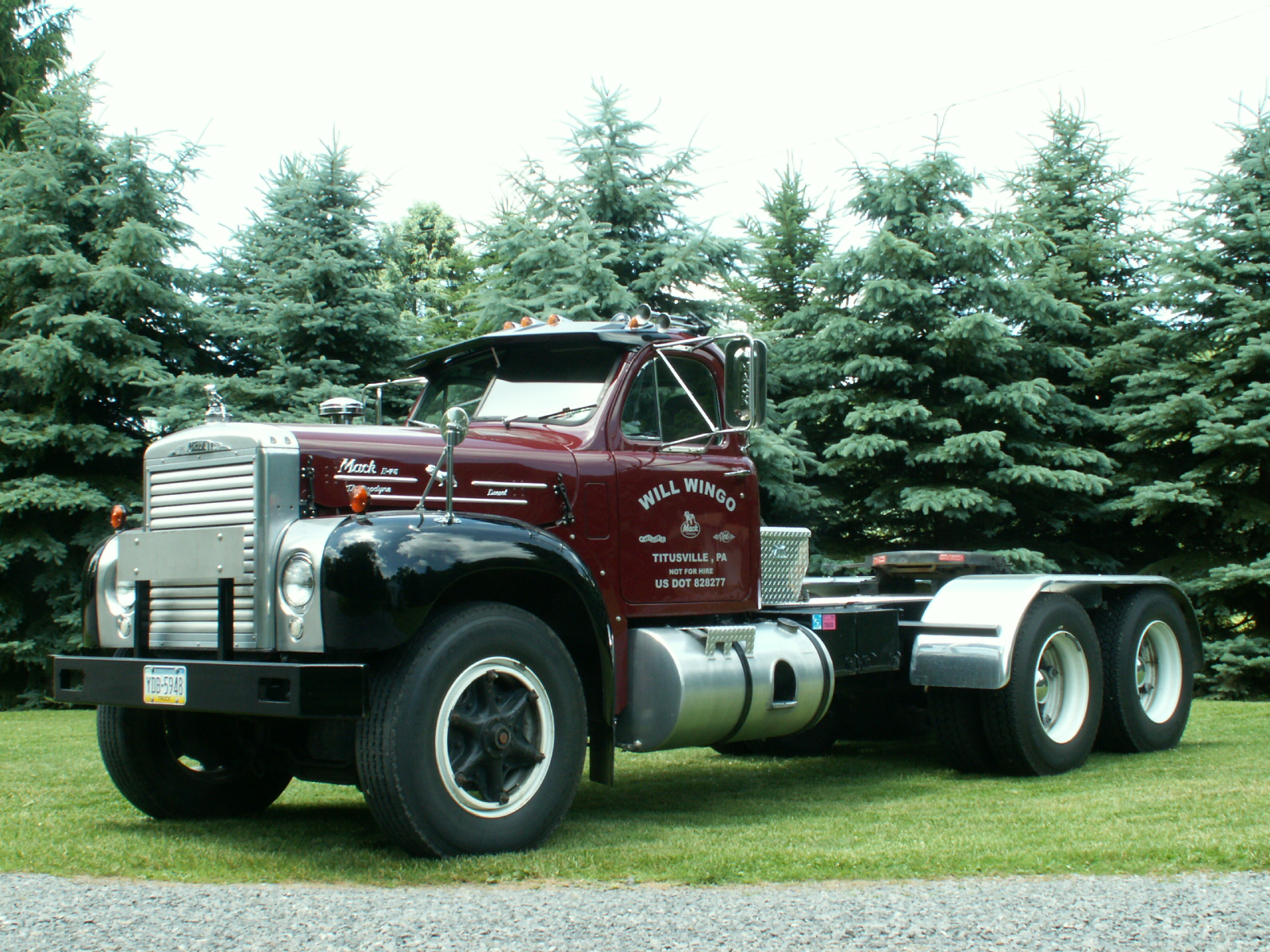

Nice tractor. The cast radiator is something you don't see too often. I thought the B-73 and B-75 were Cummins powered?
The B73's were Cummins powered. The B75's were Mack powered by an inline engine. The B755's were Mack V8 powered.

Looks like someone kept the inside looking good. Maybe some 320 grit on the body and repaint with same color to get the shine back and she would be ready for anything ya wanted to do. Glad you saved another Mack.
mike
Hell no just take a buffer and rubbing compound to that baby.....It'll come back trust me.

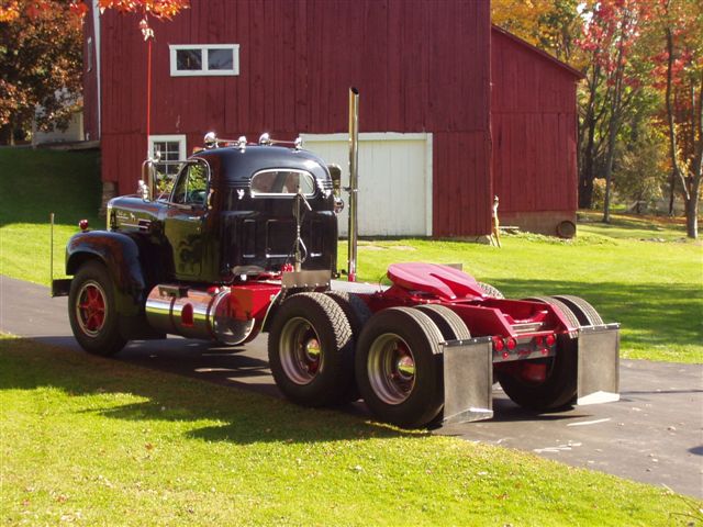

One thing to take into concideration on the number of single axle b75 is, quite a few of them were equiped with a tag axle making them look like a tandem, I have noticed a lot them in old pictures that had tag axles installed for over the road work. I have a single axle b733, and remaints of a b79. the 733 is a cummins powered with a turbo and the b79 should have a v8 cummins engine, the v8 before the 555 and 903. I am not for sure the cid of the original engine but it is long gone. the first two years of production of the b7x's production the trucks have the smaller b61 style radiator grille also something to look for,

I have had trucks with the triple nickle 555, but I have never seen the older V-8. I wonder what model that was?
The engine is referred to as a 350 cummins v8, I have seen a few pictures of these but, most are not turbocharged, they were made to pull doubles on the new york thru-way, backed with a quadraplex. all 10 were made for the same company Mcbride in new york state.
