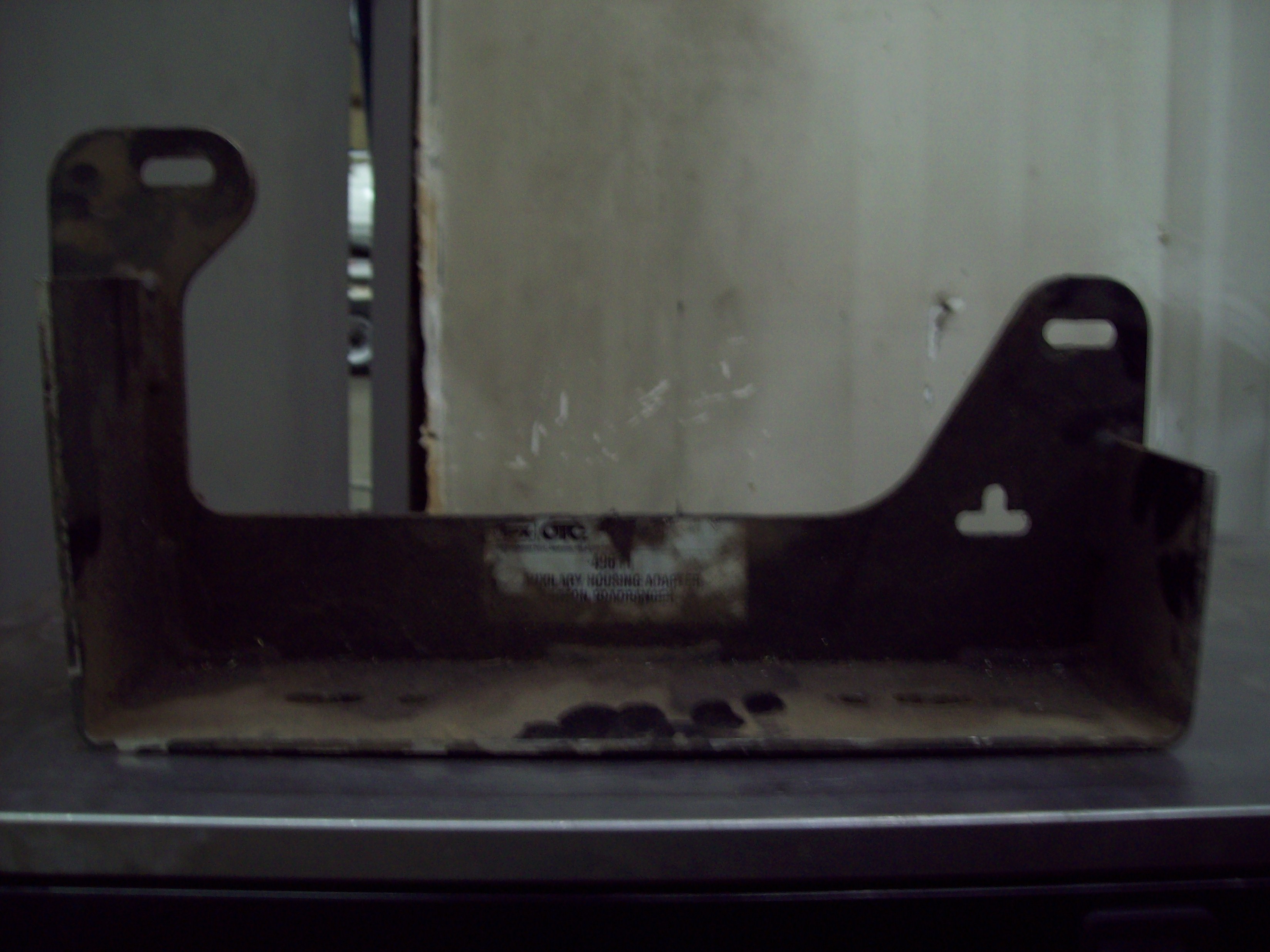

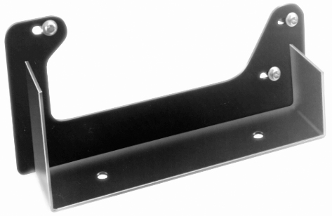

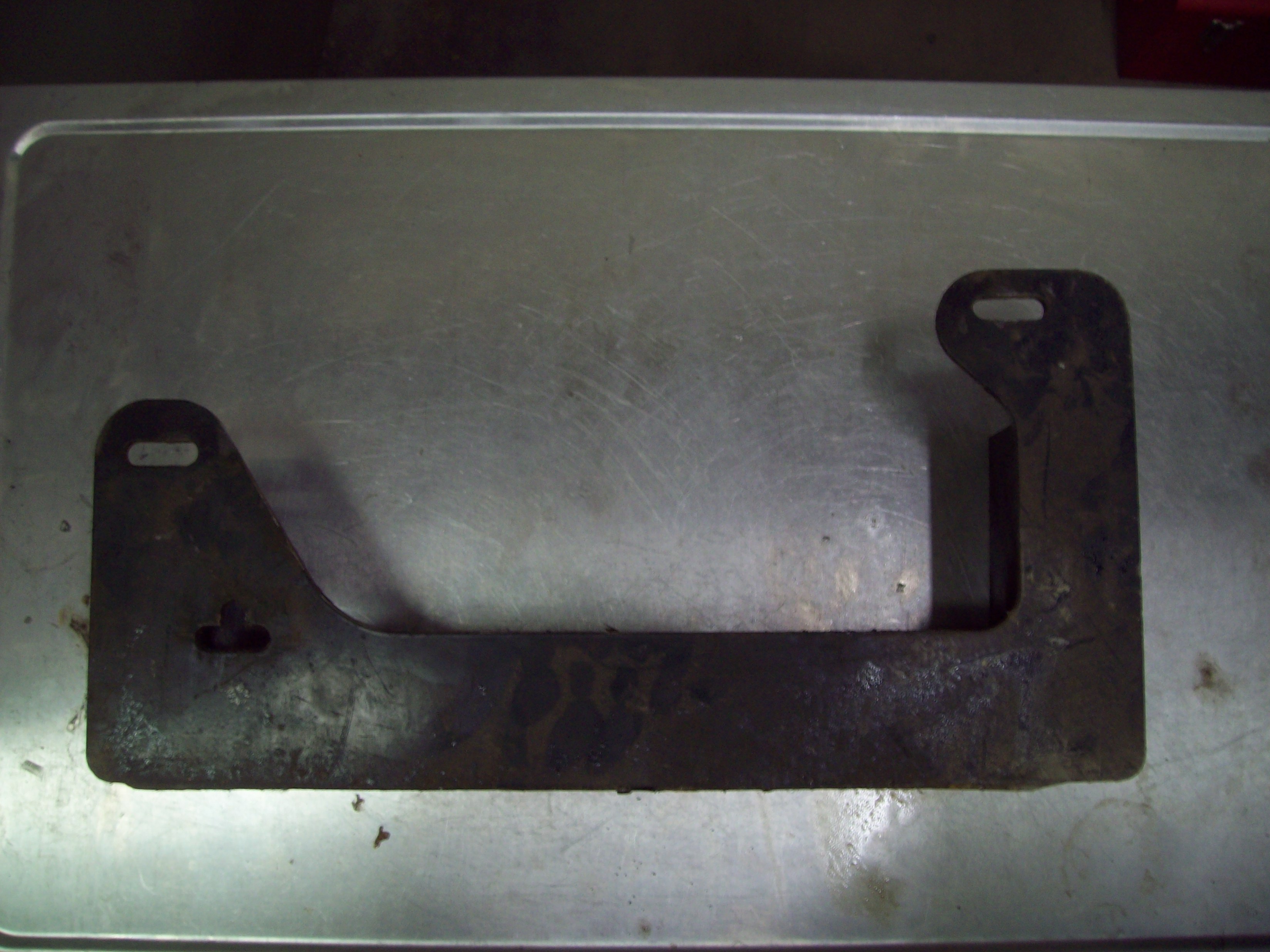

Rob, here's a picture of the adapter from OTC's website. The part number for it is 49611. I'll see if I can get some pictures and dimensions of the one at work.
post-6084-0-11203200-1307921324_thumb.jp
I remember seeing that part in the book that came with the jack. Thought about it really but didn't ever see myself trying to repair one of these things so went no further that the needed adapters for the Mack transmission. The white plate came with the jack and has never been used. I just grabbed it and threw it on the floor next to the jack. My shop built one is here someplace.

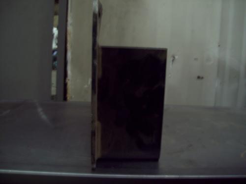

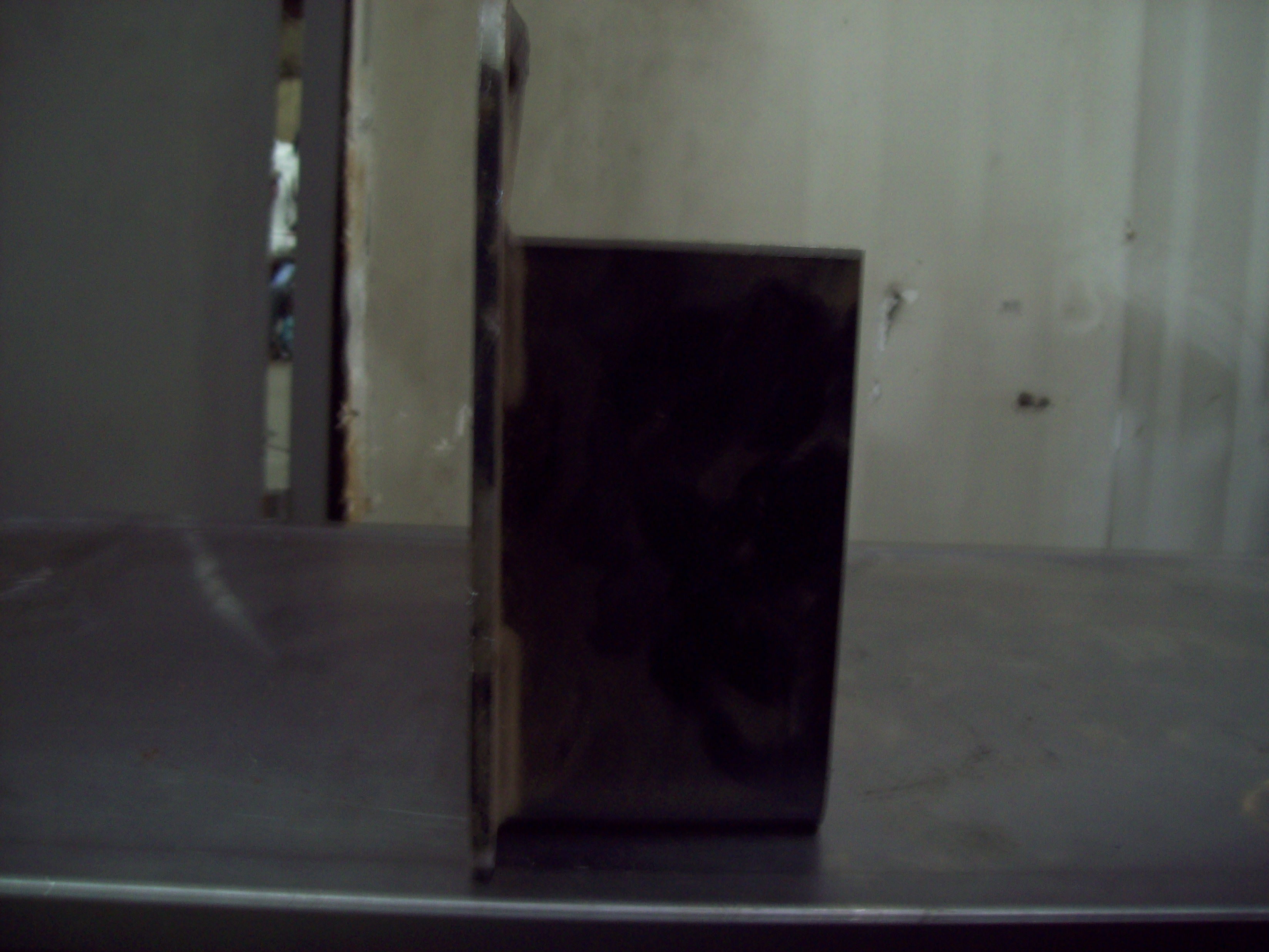

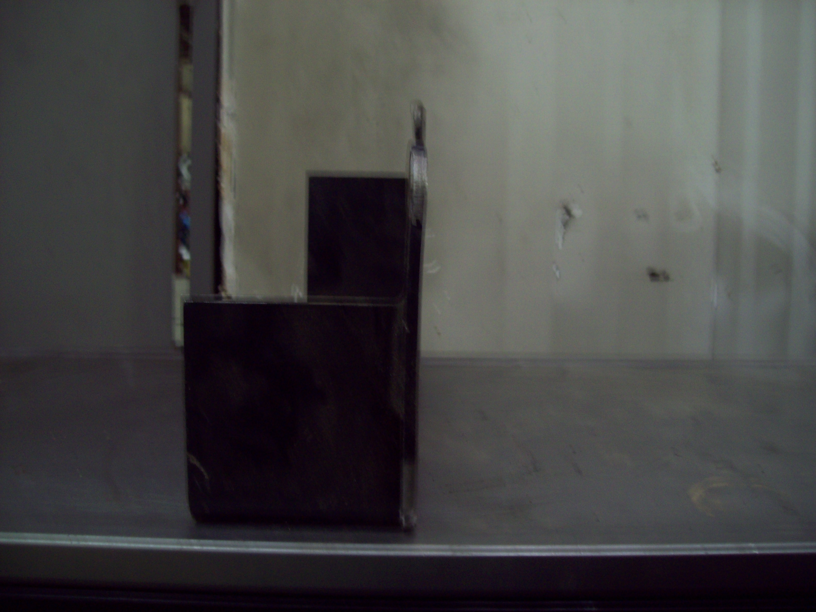

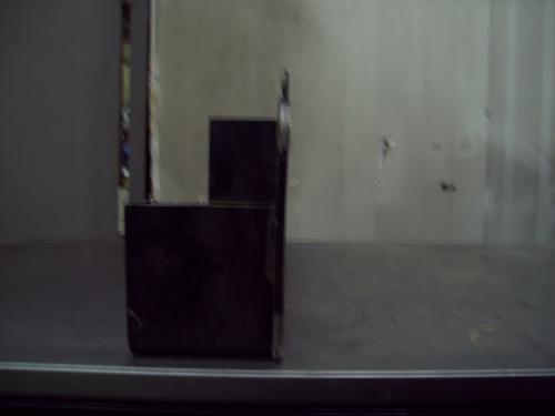

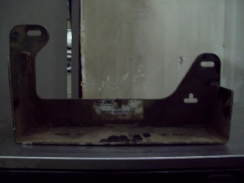

Here are some pictures of the adapter
post-6084-0-68551600-1308018297_thumb.jp
post-6084-0-21096900-1308018327_thumb.jp
post-6084-0-45658100-1308018353_thumb.jp
post-6084-0-62037500-1308018400_thumb.jp
These are all fairly rough measurements. The adapter attaches to the case at one of the upper holes for the countershaft cover and two holes on the lower countershaft cover. In order to keep from bending over the ear on the adapter you need to use spacers approx. 1/2" thick between it and the transmission case along with bolts that are 1/2" to 3/4" longer than the bolts for the countershaft cover.
The adapter measures 19" overall width. The piece of channel that attaches to the jack is 16 13/16" in width.
The longer side of the adapter at the mounting ear is 9 3/8", the channel on this side is 7". The shorter side of the adapter at the upper mounting ear is 7", the channel on this side is 4 1/4".
The slotted holes are 1 1/2" wide and approx. 7/16" diameter.
The hole on the longer side is centered at 3/4" from the top of the adapter and 2 1/4" from the edge. The upper hole on the short side is centered at 1 1/8" from the edge and 1" from the top. The clover leaf hole is centered in the horizontal at 2 3/4" from the bottom and 2 5/8 from the edge.
The mounting provision for attaching to the jack is the same as the adapter for the Mack transmission

Thanks a lot for the photos. When I get this trans out I'll stand it up on the nose and make a template and go from there. Thinking this adapter will only be used for a single purpose, I'll probably weld the needed spacers to the vertical arms as to lessen loose parts to round up for use. I'm assuming the covers for the countershafts are removed to bolt this adapter to?
