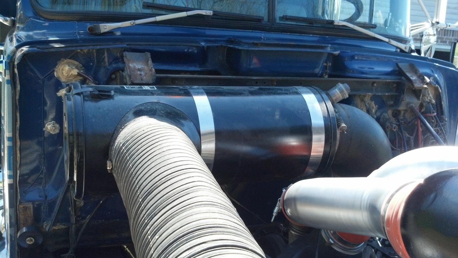

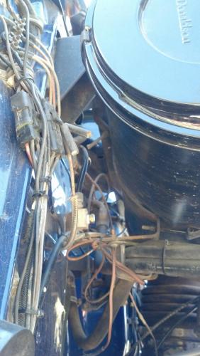

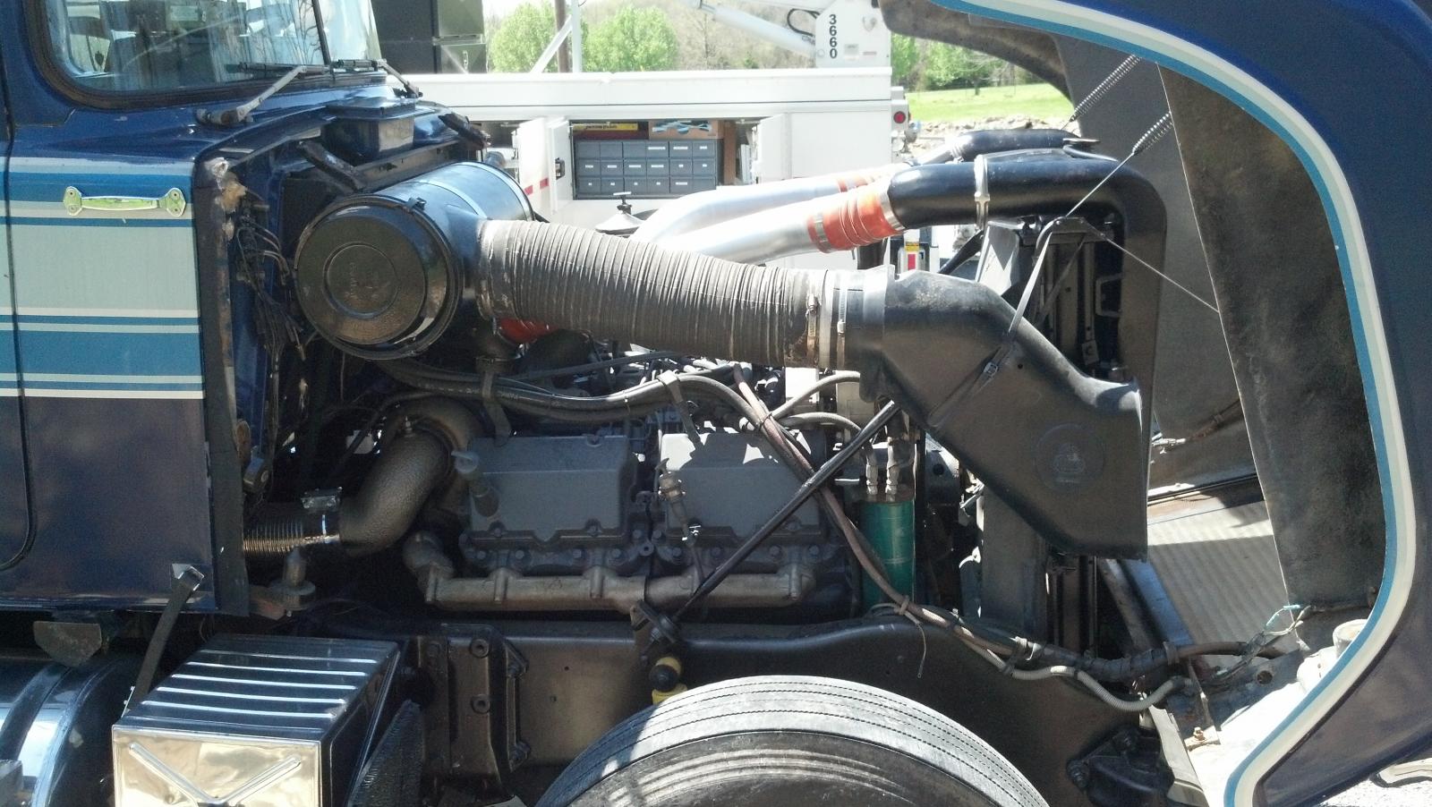

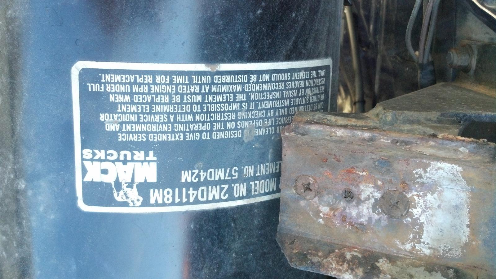

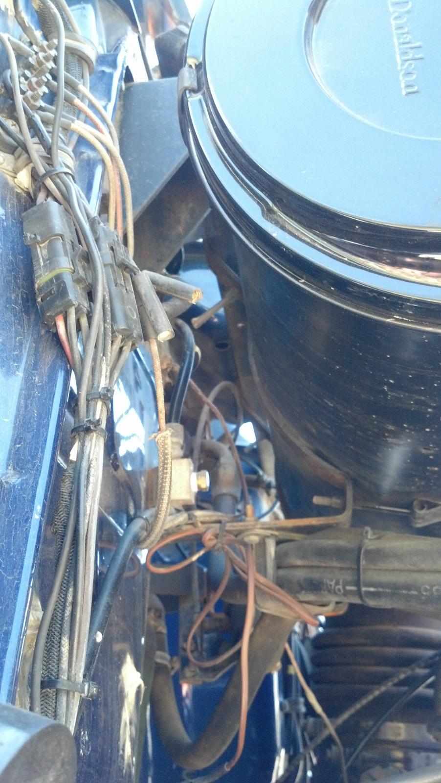

Pics, its a V8 truck not a Cummins but it might help.

Real thing photos of the air cleaner and especially its mounting would be greatly appreciated!!!

Ryan - thanks a lot for the photos, it's a great help! I just can't get enough reference, now I know I got the bracket about right. as for the mirors, the actual mirrors are made using self adhesive chrome foil, I think it can be bought at furniture stores and advertising companies should also be able to get it. I bought the mirror heads (with the bulldog) from an American comany called A.I.T.M. - American Industrial Truck Models, they have a lot of grat stuff for somebody building a model of a Mack, or a Brockway, it's like their specialty. They are cast in white metal and can be polished to a really bright finish, so that's what I did. Only the small round mirrors were painted with alclad on their backs. The brackets are soldered and made from silver-coated copper wire, electronics stores sell this stuff, at least here in Poland, they are used for high frequency hardware, winding coils and stuff like that.
