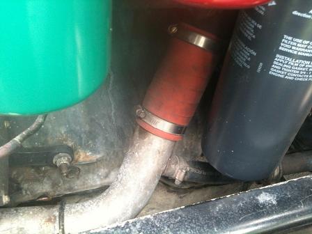

One odd thing I noticed, When the waterpump let go I replaced the pump along with a new Fleetguard water filter. Not soon after the swap I started having issues. When I pulled out the oil cooler filter I saw little grains of the element that's inside of the water filter in the screen. Normally they shouldn't escape the filter and get into the coolant. At least I've never seen that before on any engine's cooling system I've worked on. After replacing the double tank with the single tank, I also replaced the water filter again as a safe guard along with new coolant. Now I'm wondering if a defective water filter was the cause of my problems to begin with. I tried filling up the filter I took off the engine with water along side a brand new water filter and it seems to fill up slower then the new filter, I filled the middle and it don't go down and fill the outer passage of the filter as fast as the new one so it's making me suspect that it was building pressure due to the blockage inside the filter. :unsure:
Bad filters are very uncommon so I'm just curious if I won the unlucky lotto in this situation. Anyone ever experience a defective filter before?

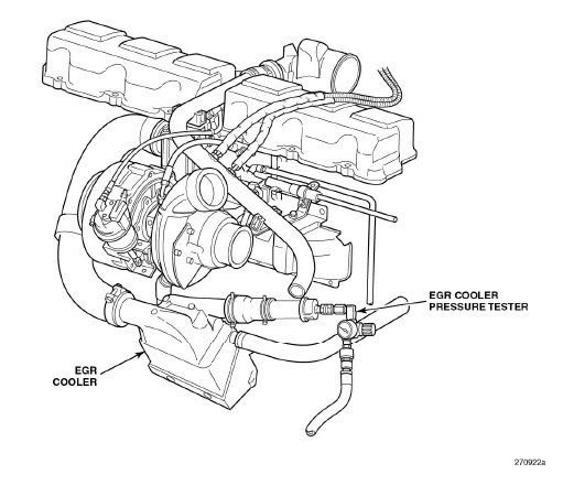

I don't have a copy of the bulletin, but here are the instructions from it.
Pressure test the EGR cooler as follows:
Operate the vehicle until normal operating temperature is obtained.
The engine must be at operating temperature to perform this test. If the engine is not at operating temperature, results of this test will be inconclusive.
Return to the service facility, shut the engine off and apply the parking brakes.
Open the hood and then remove the top halves of both the upper and lower clamps that secure the mass flow tube to the engine.
Disconnect the mass flow tube coupling hose from the EGR cooler, and move the tube out of the way. If the EGR cooler utilizes the flange adapter hose connection, remove the V-band clamp from the adapter to disconnect the mass flow tube from the cooler.
Remove the cap from the surge tank.
Install the EGR cooler test fixture to the cooler.
Fully close the test fixture air regulator before connecting shop air.
post-6084-0-62078000-1304646930_thumb.jp
Connect shop air to the regulator fitting, and then slowly open the regulator until a maximum of 20 psi (as indicated on the pressure gauge) is applied.
DO NOT apply more than 20 psi to the EGR cooler.
With air pressure applied to the EGR cooler, observe the coolant surge tank. If the EGR cooler is leaking internally, a gurgling sound will be heard coming from the surge tank, and coolant will eventually be pushed out through the surge tank filler neck as the coolant aerates. Replace the EGR cooler if the results of this test indicate that the EGR cooler is leaking internally.
If the pushing coolant complaint cannot be resolved after performing the investigation outlined above, the cause may be combustion leakage past the head gasket and/or fire rings. Diagnostic procedures to determine combustion leakage are outlined in service bulletin SB213042. Combustion leakage, however, is the least likely cause of pushing coolant.

Thank you sir. I knew there had to be some sort of tool to perform this. Im also glad to hear that the head gasket is the least likely issue for this problem.
The EGR cooler has been confirmed cracked internally. Its good that its not a head gasket, but sucks that it costs $1500! Even the Mack parts dealer was shocked at the cost of these things. I tried to see if he could work out a lower price since we been dealing with them for almost 35 years now and he said that price is the best he can do. I'll have the part on Monday and installed some point during the week. The Mack service manager said that they are releasing a updated computer tune in the very near future that's supposed to prevent this from happening again. He has a tractor with the same exact problems in his shop this very moment and they are waiting for the update to try out on it. I didn't get all the details, but they told us to bring the tractor by when its available. Ill be sure to find out what exactly it does to prevent this problem.
