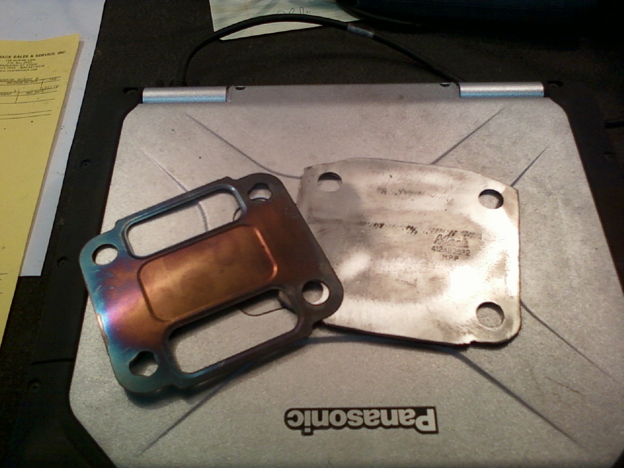

Your EGR block off plate is ready if you want to try it.
i was thinkin, if i carried the plate and plugs for coolant, if the egr cooler cracks while im out west i could bypass and make it in.
im thinking worst case senareo, tow 5 grand,egr cooler 3 grand, mas flow tube 13 hunert, then it taking 3 weeks to get the parts and get it done. then limping back to mackpro for completion.
i don't want no valva peckerheads in reno messin with my mack.
Toughbook not included but will let it go for 4K and thats with our lovely Mack Preimum Tech Tool/VCADS installed and you know how good that is!

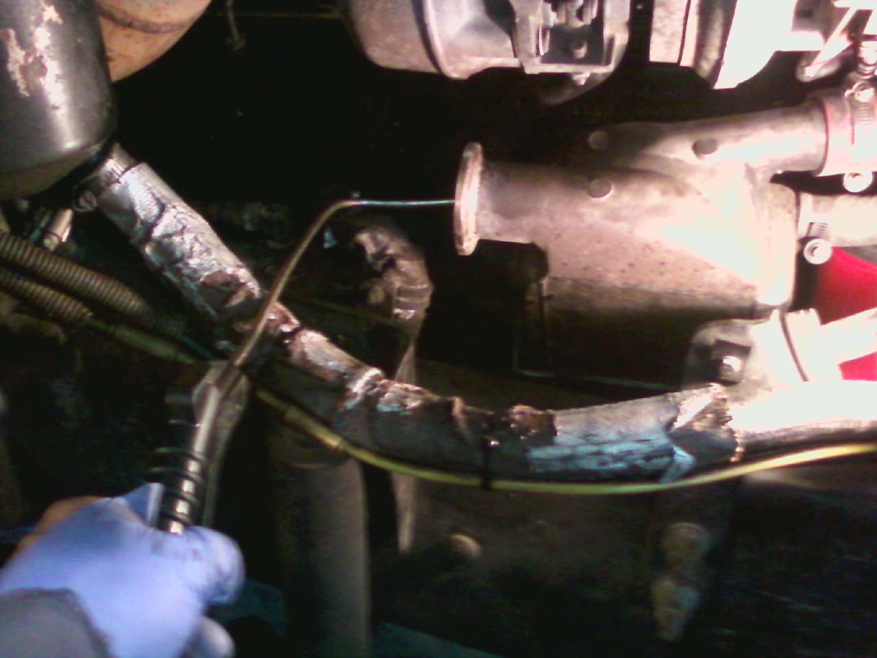

if you pull the in and the out tubes on the egr cooler, ou can blow it out with compressed air.

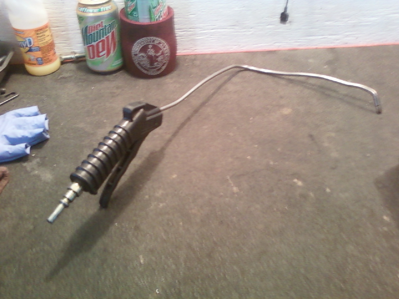

maybe mackpro will post a pic of his blow gun????????
might be from idleing so much, mine looked like ten gallons of soot came out of the cooler, it acts like new truck now.

Bigen saw how easy (but dirty) it is to blow out a EGR cooler on a ASET engine. Mack recommends to remove the cooler and fill it up with mineral sprits overnight and then steam clean it out. But I have had good luck with blowing them out with a long tipped blowgun. Park the truck out side and remove the "Hot pipe" coming from the EGR valve going to the EGR cooler. Them pull back the EGr cooler to Mass flow hose and blow back and forth with the blowgun. I angle the tip down as to blow down through the cores (its built like a radiator)
