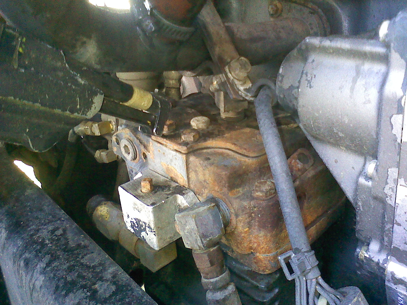

I appreciate the info. That seems like a cheap enough fix it shouldn't break the bank. Just need some denatured alcohol, I think I drank all mine, unless Tennessee whiskey will work, and a kit. First I'm hoping someone on here can look at my Vin and tell what compressor I have. Vin # 1M1AA18Y7TW061901
Making threats to it did no good!
That is a "Midland" compressor. It is easy to service and the unloader rebuild kit comes with instructions. There will be a tag affixed to the compressor that will identify which unit it actually is.

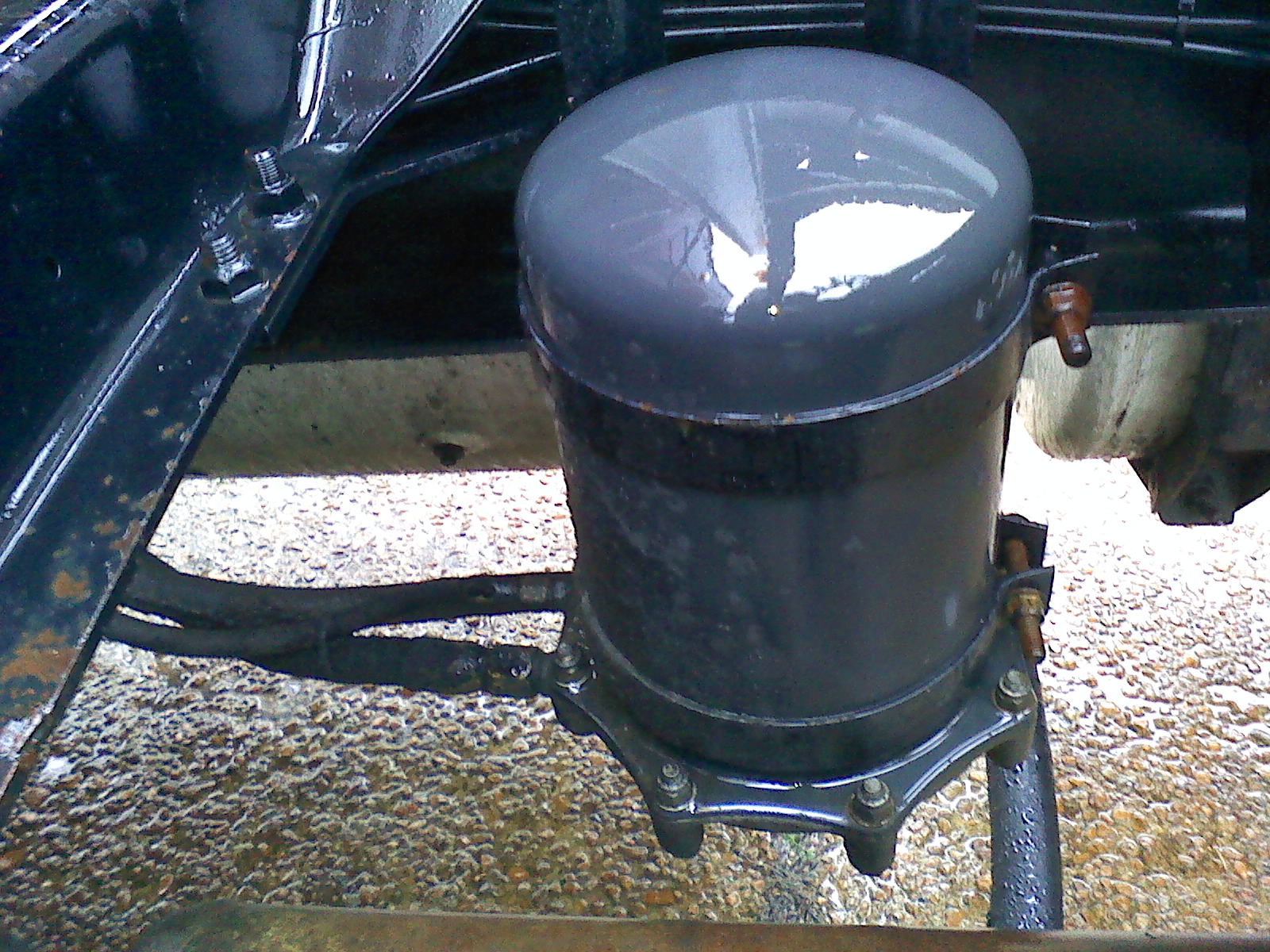

I replaced the air governor and it seemed to have fixed part of the problem, the compressor starts recovering around 90PSI. Now it is to slow on building pressure. I'm thinking its the air dryer, I'm almost certain it hasn't been serviced in many years. I've had the truck for alomost 4 years now and I sure haven't. Would this cause it to build slow? Didn't know exactly how they work or if they could clog up. Here's a pic of mine if anyone can tell me which one it looks like or anything helpful is always appreciated!

Looks like a Bendix AD-9 to me. If the purge valve is not sealing in the bottom of the unit the air system will be slow to build and bleed off when the engine is shut down.

Yep, AD-9. I've heard/read stories of counterfeit desiccant cartridges being made with cat litter and such which will plug up almost immediately and cause the system not to build air. Something to watch out for when purchasing parts.

I always ran AD-4 series on my trucks if they had dryers. Never had problems with any of them but they were serviced with OEM Bendix kits yearly. I found this much less expensive than being broke down someplace. I have two trucks with AD-2 series and they work well also but are a bit expensive to work on. I installed new heaters yearly also.

Thanks for the info and identification. I fixed every possible leak I could find but if it sits for a while it loses pressure. So are there rebuild kits for these? Would I be better off replacing it with a differnt model/kind?
Rebuild kits are readily available. You can rebuild the assembly for about $60.00 or so and it takes about an hour. Another cause of system bleeding down could be the check valve, or valves installed into the wet tank inlet. If these don't seal the system pressure will discharge throught the compressor valves that are not designed to seal and hold back pressure.
No need to replace this unit unless the main housing is corroded. You can buy the complete rebuilt baseplate assembly and basically everything would be new.
