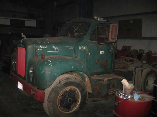

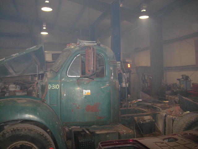

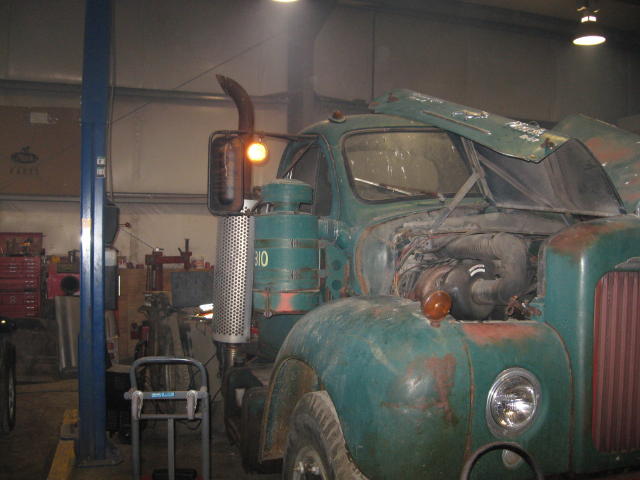

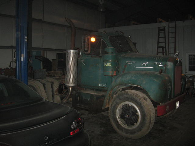

Well, she's in for the winter. I gave the electrical system a good "once over" and did not see anything wrong other than being old. After installing a battery it's discovered every single light in this thing works as it should! I ain't never seen that before, even when they were much newer!!
I'm gonna pick up a couple group 31 series batteries and see if she'll fire off but first need to replace the equalizing line between the fuel tanks as it is busted/rotten in two. Both tanks are completely empty.
Rob

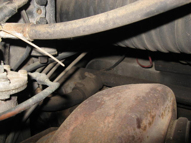

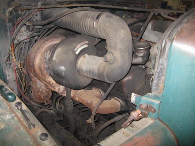

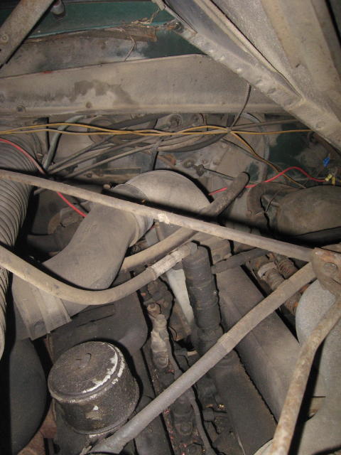

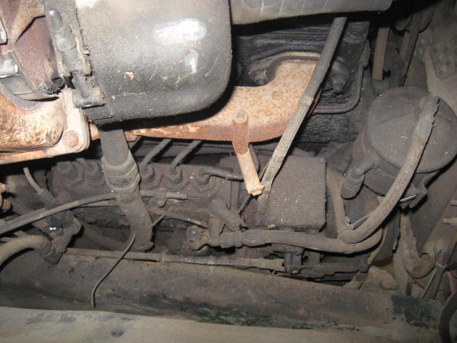

Didn't realize but each tank has a shutoff valve on it under the caked on dirt and grease. I shut the tank valve off on the driver's side, dumped five gallons of fuel into it and started working the hand primer. To my surprise, the pumped right up to a nice hard resistance. I've not picked batteries up yet so won't attempt to start until tomorrow at the earliest. You have to remove the fender access panel to even see the injection pump on the engine and like Glenn said the fender would probably have to come off to even entertain changing the air compressor. I've never seen an engine so tightly crammed into a heavy truck like this.

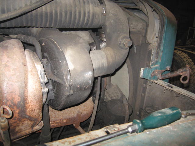

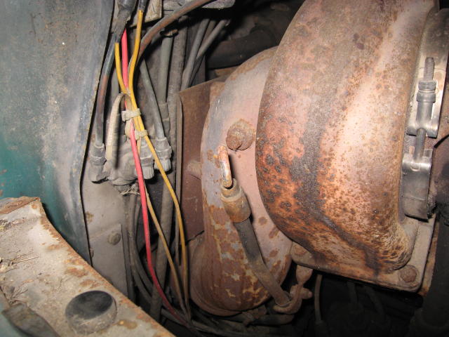

Get a look at the clearance to the cab behind the turbocharger. There are also no rubber insolators, (bushings) left on the passenger side of the truck for the transmission to frame mounts. The bolts can be shaken by hand as the rubber has fallen away. That is why there is a little wear on the turbin housing of the turbocharger from rubbing on the fender closing panel.

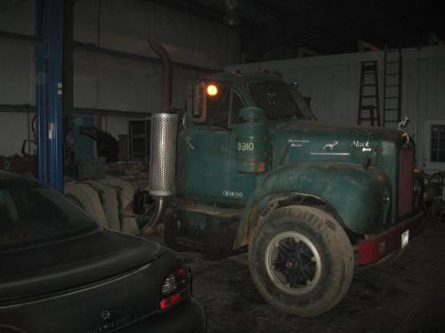

Well curiosity got the best of me tonight so I went and "robbed" the batteries out of my "yella dog" out back for a try to start. No such luck before cranking them down. I had started "yella dog" early in the afternoon and had cranked quite some time because it is cold out and the truck wasn't plugged in. Being a generator system and not run above idle, the batteries did not recharge.
The B-67 does crank over and smells like stale diesel out the pipe. I think it will run once the batteries are up enough to spin the engine with any kind of speed. I did stick them, and the electrolyte is down to 1.15@ 45 degrees so they are basically flat. The truck has an alternator, is negative ground, and has a 40MT starter installed. I didn't know any of this when the truck was given to me, just that the series/parallel switch had been done away with. What is a shame is that the battery cables are #2 and that is not heavy enough. I will replace them with #4/0 and be done with it. These batteries are known, and tested good last week but I've started that yellow truck several times and not allowing it to replenish.
Knowing that this truck has the hydraulic governor setup on it I'm assuming that the full flow oil filter would have to fill itself before the engine can make oil pressure, then move the fuel rack inside the injection pump to start. So far I can't get the engine to make any oil pressure on the gauge so really didn't plan for it to start but I'm getting anxious......
I looked at the rear axle carriers and the front one is stamped 5.77 ratio, the rear is stamped 6.34. Something is not right here but I can understand the truck running 65mph with 5.77's in the rear but not 6.34's. My 64 B-61 has 6.34 rears, double over quadraplex, and will only run 57mph on the governor at 2150. I'm assuming the original carrier went bad and was ratioed with 5.77's but not sure. This truck has a nine speed overgear.
I did get both doors freed up tonight and can now open and close them easily. Need to work on the windows next. None are broken, or cracked and work, but are very stiff. Need to replace the driver's door handle as the square rod that operates the mechanisim, (latch) is twisted as I can see it. I even pulled the heater switch on the heater motor runs!!
The truck is not but I'm getting cranked!!

I'm pretty sure the rear carrier is a reman unit from many years ago that probably had a sticker denoting the ratio installed, and has fallen off/deteriorated. Both housings have been in the truck for many years and have equal amounts of grime on them. There is no ways to declutch, or shift one drive axle in or out at will with this setup as it is standard Mack camelback and drive axles all the way.
I'd lay odd on the 5.77 ratio being correct due to the former owners speaking of the road speed it will run.
Hope to make some black smoke with it tonight.
Rob

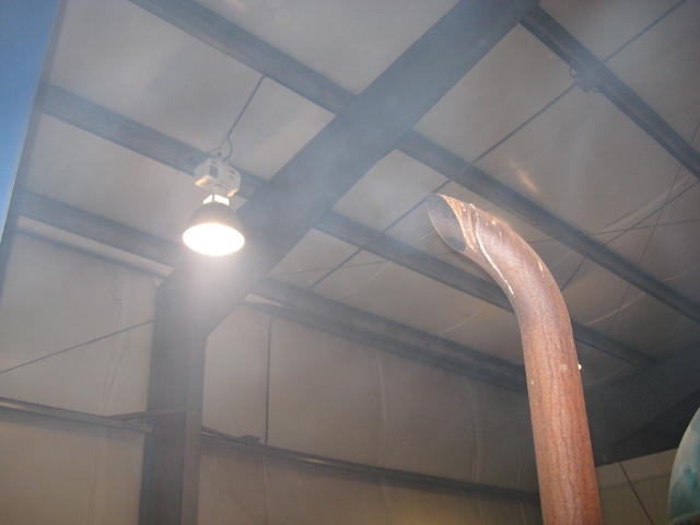

Prefilled the oil filter with about a gallon of 30wt. oil and she cranked for about 30-40 seconds, then roared to life. Took a while for the hydraulic governor to stabilize smoothing near 650 rpm idle speed. Truck is not making air at this time and that can be another chapter. I'm going to drain all the fluids, change/clean all filters and replenish. Oil pressure gauge sure fooled me as it is not connected so I was nervous at first. To ensure I had oil pressure I loosened the plug at the top of the oil filter and was going to slightly unscrew it until I had engine oil get past the threads, but to my surprise when the engine is running, I couldn't move the plug by hand. Shut the engine down and it's a two finger operation. I surmise it has good pressure......
I've got a couple of minor wrecks to repair so this will need to go on the back burner for a few days. Just too damned hard to leave something new alone sometimes.........
