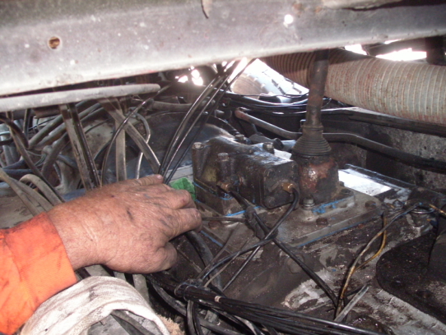

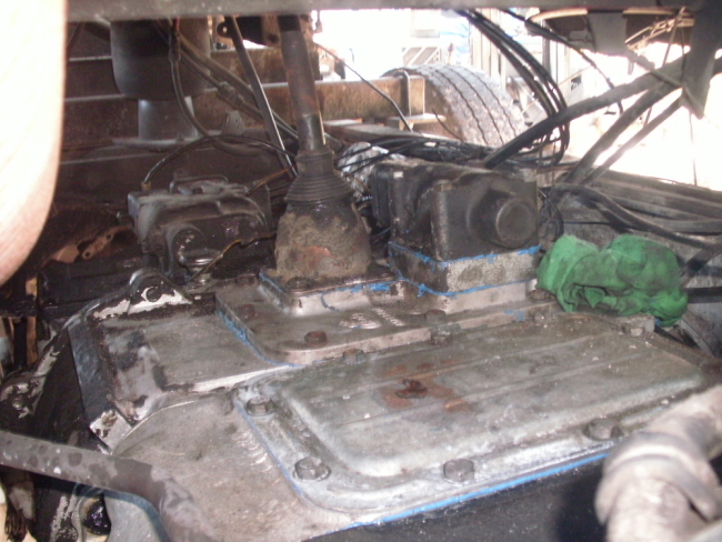

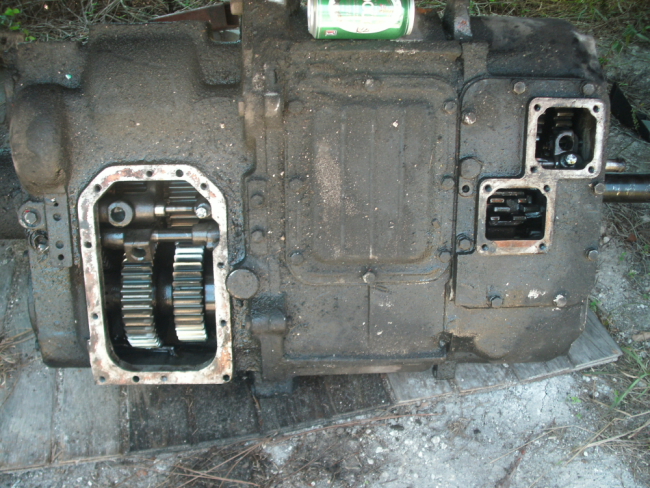

  5. 1st pic is old tranny 2nd pic is new tranny in truck and ssthird is new tranny in truck so far it seems all air shifters working as i aired up the truck and tried it out Buddy

  8. the shifter is a remote air valve with 4 positions i believe if that is what you are talking about' Buddy
  9. that low low air cyclinder is right next to the shift tower for the stick

  18. I am replacing a 1070b 12 speed cause the damn thing broke. A while ago i bought this superliner that had a 12 speed and the 2 low hole speeds would not work. After some research and investigation I realized the lock out had broke in half. Though i tried to retrieve the broken parts all i got out was a couple small chunks. Getting back to when i bought this truck the tranny locked up because it was in 2 gears at once. I was able to pop off the shift tower and line the slides up and go on my merry way. After thinking about it i am sure one of the chuncks was the culprit and then finally fell to the bottom. Then after a while reverse was becoming a problem engaging and the nuetral for the pto was a problem. Then the other day I put a little strain on the drive train and snap goes the tranny. No reverse no pto no nuttin. Towed it to the shop and decieded to find a good take out with a garrentee and found one for a $1000.00 could not pass it up. I will pick it up tomorrow and do the swap. I am praying to the MACK gods that i am getting a good tranny. We split it and everything looks good
  19. Great site. already saved me alot of time and money! Thanks to the members that offer their mack wisdom, experience, and willingness to share it.I remember as a kid driving B models and R models then i purchsed a dm800 steel nose 6 speed 237. man i look back now and think now those were some primitive trucks. We drove them with no heat no a/c no radio(you could not hear one if ya had it any...
