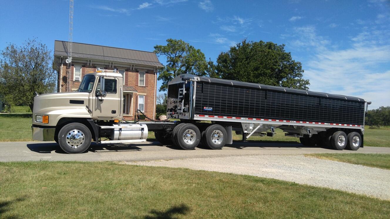

  13. Just got this 2003 CH613 this summer. It was an old Recycling Center (a local business) truck that the dealer fixed up and painted for me. It's the first truck I've had as I've always hauled my grain with gravity wagons. Pretty nice and a lot faster now!
