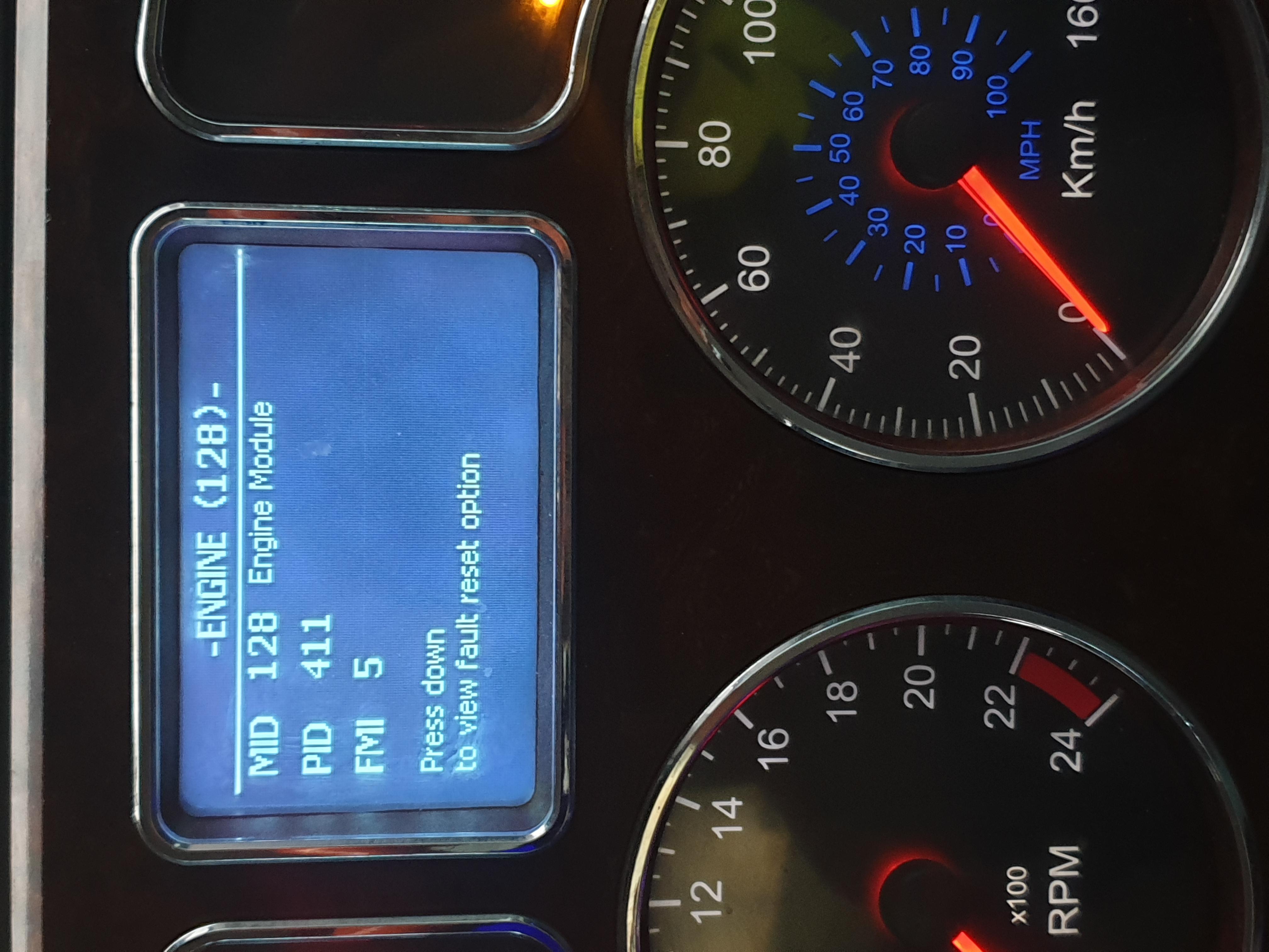

  4. Keep getting this code popping up. Replaced water pump manifold and forgot the loom for the egr preassure sensor on drivers side unplugged. Realised when it was in major de-rate. Plugged it back and still get the de-rate unless I clear the code off a few times. But the code comes back, Mil light stays off and engine is in a minor de-rate instead 😑. Any ideas?
