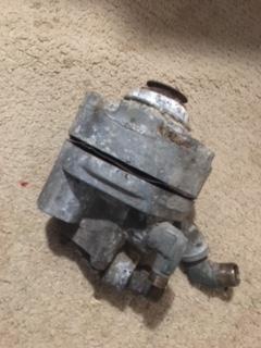

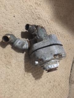

  14. RBH
    53 A54
    Thanks. I have attached photos of the valve here removed. Its a Bendix Westinghouse and has a number on it of 230870.
  15. I recently bought a 53 Mack A54. The treadle valve will need replaced. This truck has front brakes so I was wondering if anyone here knows where and what valve I will need to replace the original with? I would like to keep it original as possible.
