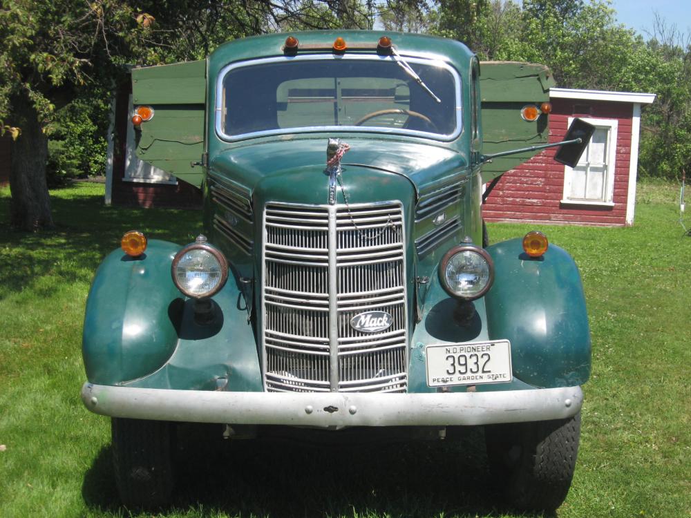

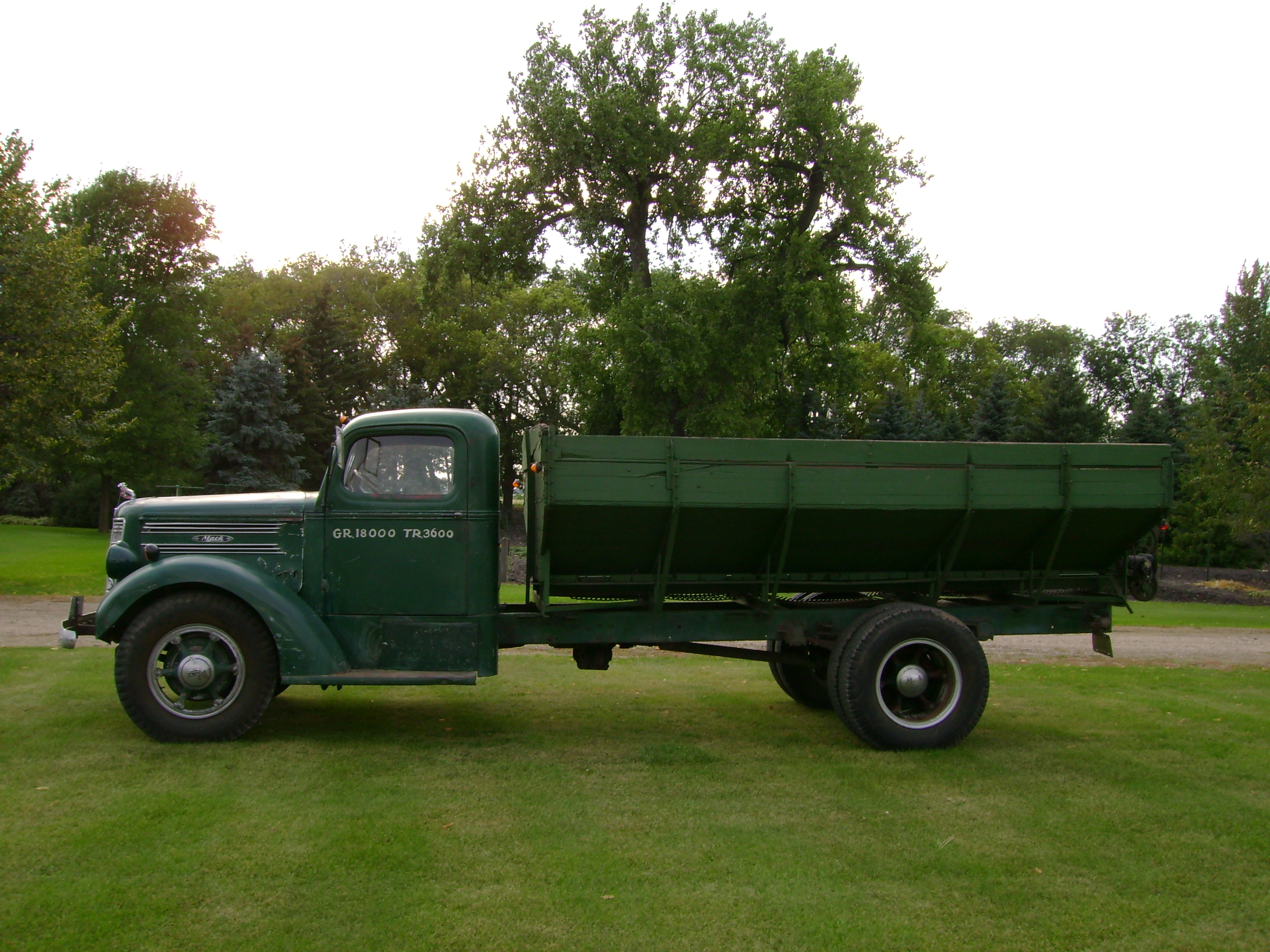

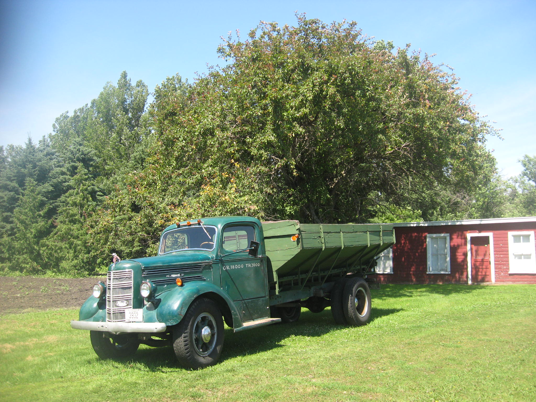

  3. We have a 1947 Mack EE we plan to donate to a local machinery museum. We would like to have an idea of its value first, but data is hard to find. The truck is in good working condition and has about 31,400 actual miles on it. Our neighbor bought it new and we are the second owners. It has some dents very little rust. We just had the brakes redone and the carb rebuilt. It is all original except it has a Watson auxiliary transmission. It has been shedded for most if it’s life. Tires have good tread but are about 45 years old. The box is for hauling potatoes and is era correct. Any input on what it is worth would be appreciated.
