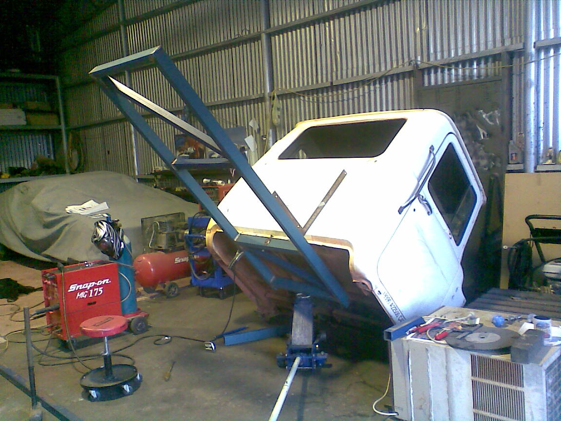

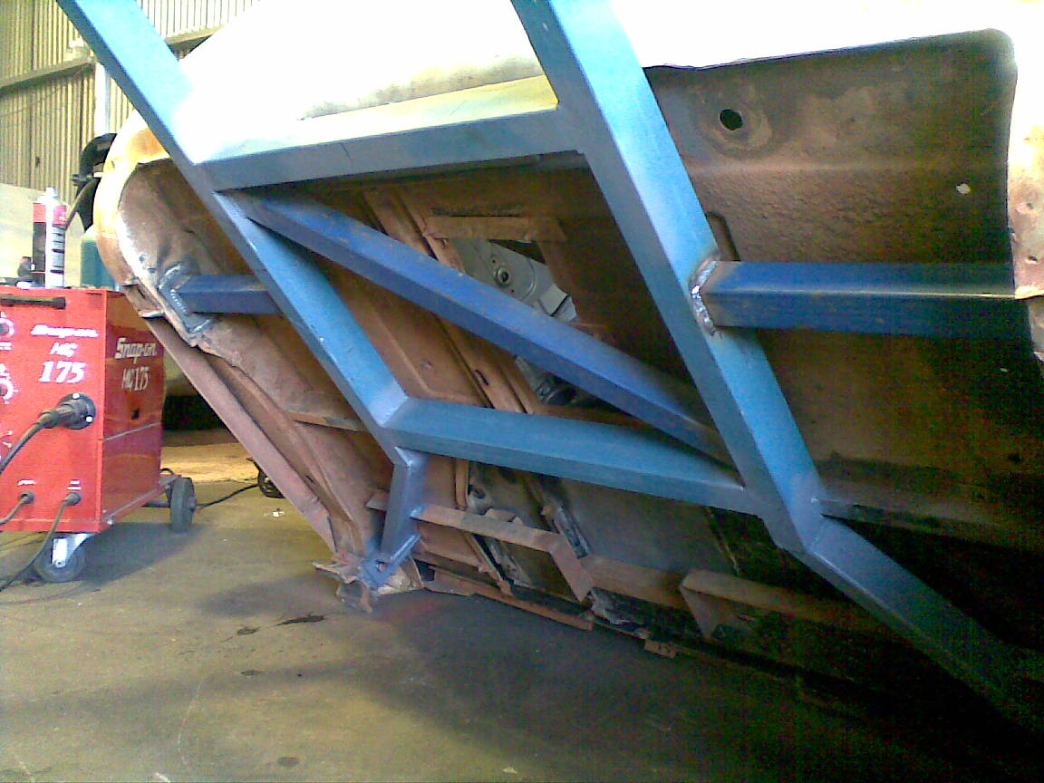

Started on subframe :)
Looks plent stiff enough to do the job. The angular placement of the brace concerns me as far as interferance/clearance issues. Although a bit more work, I would have probably used gussets in each of the four corner leaving the center of the space open. I'm certain you evaluated that in your design stages.
Is that a bit of rust in the floor sill on the driver's side, (right) that needs repaired?
Hell of a weldment you've got going there mate. Should work real well for you.
Rob
Rob
Hello, no rust in cab at all, it has many holes in floor. the old gear lever location is in front of centre triangle, but i am putting another floor in so it will have origonal floor, then bracing, then second floor and fill inside 2 floor sections with spray foam.
there is nothing up there with interferance issues to worry about, but if something should be an issue i have a gas axe! :)
can wait a couple of days on gear lever, will do rest of floor tomorrow. thankyou.
regards Grant
