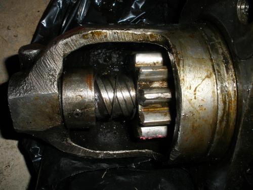

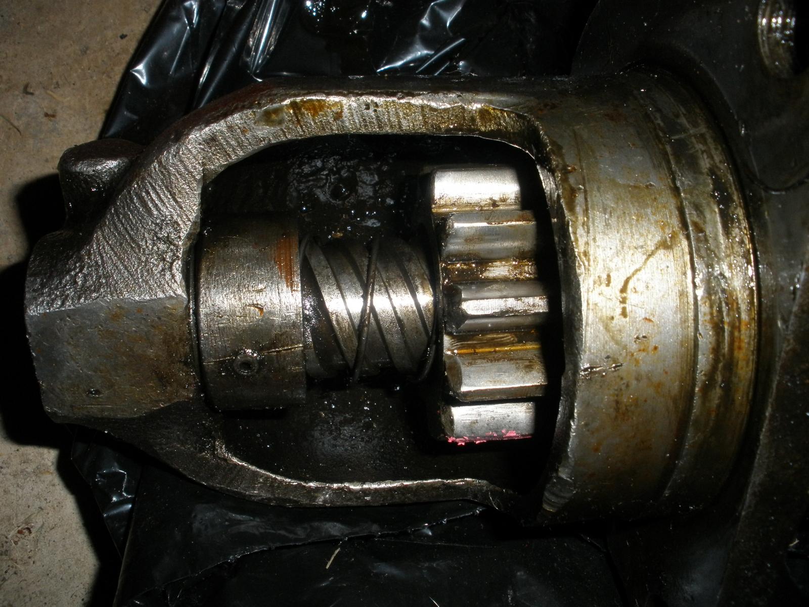

not trying to highjack but I am in need of some starter info too, the guy I bought my truck from had put a 12 volt starter on it but he said he had some problems and it ended up being the starter gear and he said he changed it, when I got the truck it would catch and then kick out or just spin like it needed to be shimed. I took it loose and seen it was not pulled up tight so I fixed the bolts and it caught about 95% of the time the fist time. I then started the restoration and pulled the tanks, on Thursday I put working fuel tank on and primed the engine up and it would catch and kick right back out or bind up, I pulled the starter and checked it on the bench and it spun fine but the nose bushing is cracked so thats it appears the armature may be bent. The starter looks like it had the mounting adapter made so I amsure that it was someting that was out togeather and not purchused.
Instead of jacking around with this one I have will the AC Delco starter mount up and what about the starter gear drive match in the fly wheel, I have a B61T with END engine. Also what is the number of teeth for the starter gear?

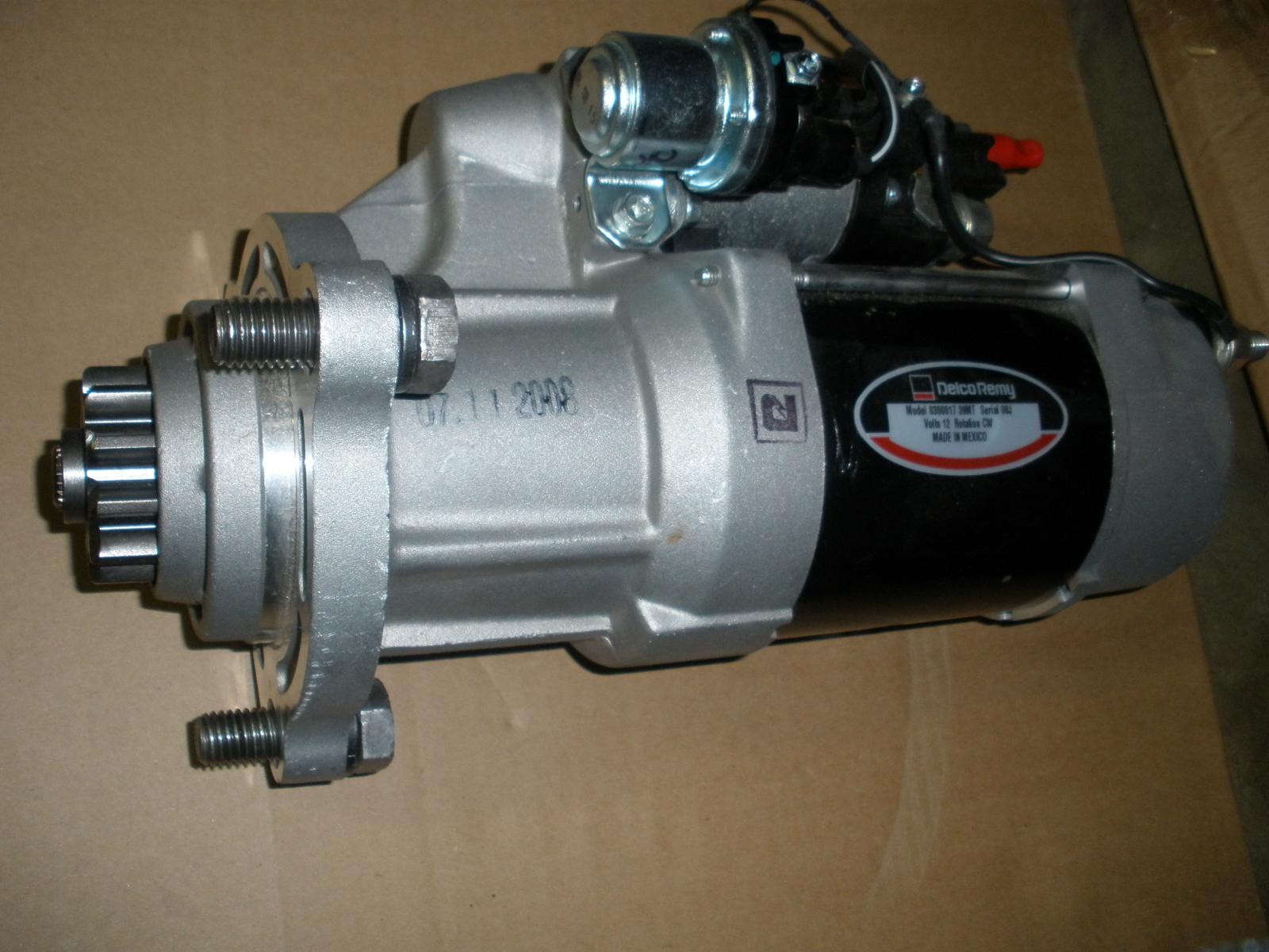

Hey all, I been jacking around with the starter got it ID as a MT42, it had abad bushing and I think the solinoid needs replaced as it is cracked and I think that is part of the reason for the kick out. Got the 5 dollar bushing installed bench tested and it worked fine, installed and started acting finunny and spinning, started dragging, put the booster charger on and still dragging obviously need more power, so I went and redid all the connections still did not work right would spin, kickin then out again,when I was at the starter shop they thought it was fine except for the nose cone bushing.
Is the MT42 the right starter or is part of the problem is it is the wrong dimensiosn to engage properly??? I found the MT39 on line and locally but if all I need is asolinoid that would be aheck of alot cheaper, I just want to get the truck started so I can finish putting it back together.

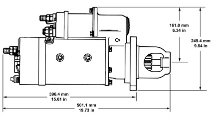

SPECIFICATION:
VOLTS: 12
ROTATION: CW
DEGREES: 52°
NUMBER OF TEETH: 11
MODEL TYPE: DELCO 42MT
APPLICATION: Medium & Heavy Duty Trucks & Industrial Equipment 1986-98.

i put a 42MT starter on my B613 with a 711 and its worked fine for 4 years now. i had to take the back loose with the allen screws and index it different so the solonoid on top cleaned everything but it works find. my truck has the later bellhousin like a 237 with the starter on top on the driver side which is a real pain in the ass ina B model. had to screw around to get the starter to cleaner the throttle linkage and the hoses for the big 750 lubrifiner and the steering column. if you have the older bellhousin with the starter underneith it shouldnt be a problem. the 42 mt will work but you might have to index it differently. most people are using the 39mt i believe.
