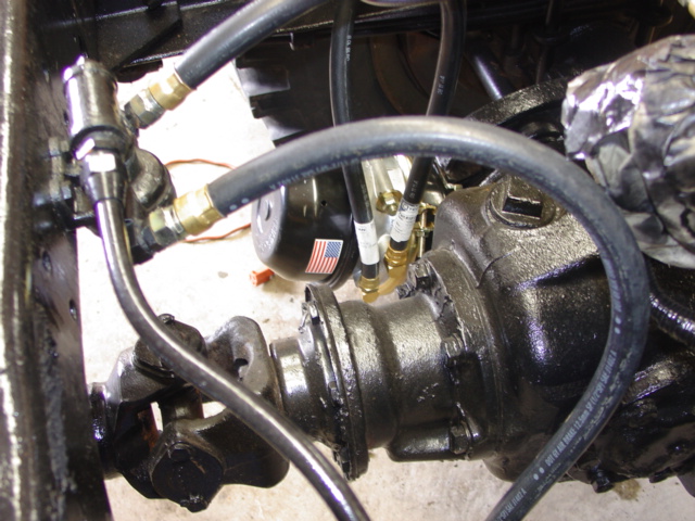

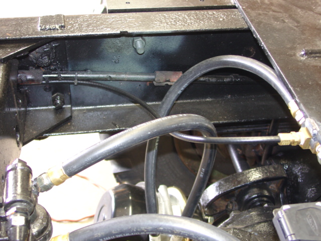

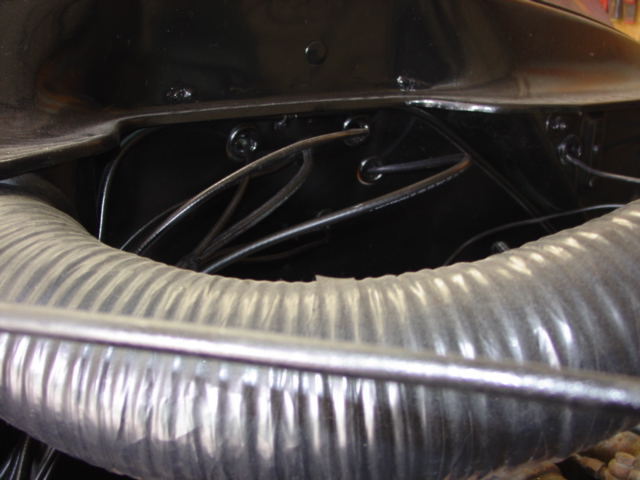

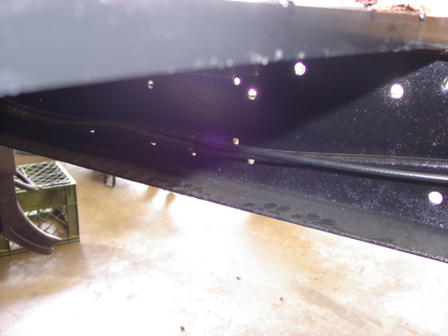

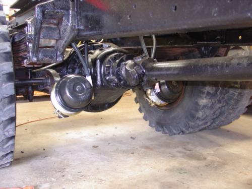

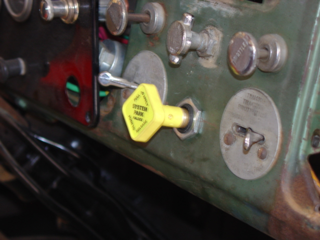

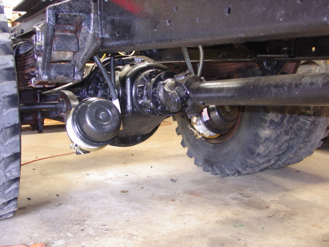

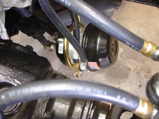

Alright got all the parts
2 30/30 Brake Chambers $58.47 ea (Short Stroke)
2 30” Rubber Brake Hose $10.61 ea
2 32” Rubber Brake Hose $10.86 ea
20 ft 3/8 Air line $1.14 per ft
1 Push Pull Valve with knob new $33.61
Miscellaneous fittings, plugs and tees $21.35
Time about 1.5 hours, probably could have done in about an hour but had to heat the old mounting nuts on the left side chamber.
1. Remove existing chambers and hoses
2. Measure length of old chamber push rods from chamber back to center of yoke, cut new rods to length. (remove yoke leave jam nut on rod and turn until it is close to chamber, this way you can chase the threads if you get a burr after you make the cut)
3. Thread on yoke and adjust to proper length
4. Mount new chambers (watch orientation to keep hose fittings to the inside)
5. Put pins in yoke to slack adjusters, (depending on your brake adjustment may have to adjust slack adjusters)

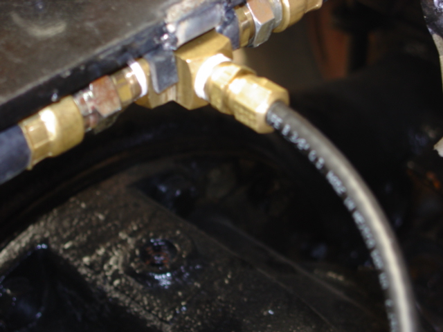

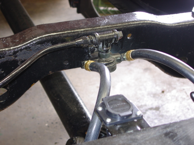

6. Mount tee fitting for Spring Brake Hoses ( I made a simple bracket to hold the Tee Fitting and welded to the bottom of my hitch plate, keep centered, as not to interfere with drive shaft and/or hoses may not reach)
7. Run air line to cab area to where you will mount your push/pull valve ( I ran mine along the existing copper lines and zipped tied, make sure to keep it away from anything that spins or gets hot)
8. Mark location for valve and mount valve. (the valve will be marked and depending on your valve will require a supply air and the delivery air line to the Spring Brakes, my valve required 1 plug, the back port on my valve is left open for discharge/vent it is not marked)
9. Select air supply line to tee into. (must have a constant air supply at all times, I tee'd in my air pressure gage to this line so I now have Air Pressure Gage and Spring Brake Valve on the same supply line)
10. (Chock wheels) connect all fittings and check for leaks, tighten as required or repair. (check for proper brake adjustment and movement)
Now you are Done, pictures to come see
If I had a tandem I would do the same except instead of using a tee I would buy a R6 or R12 valve for ease of connecting the 4 hoses for the Spring Brakes.

I know this is a little late because you have the job all done and it looks great.
I do have one suggestion, if you notice when you set the spring brakes they might seem to set a little slow
this is because the air has to exhaust all the way up through the push-pull valve under the dash before they will set.
If you replace the tee fitting on the emergency side with a Bendix QR-1 quick release valve or equivalent the parking brakes will set much quicker
and you won't hear so much air leaking out from under the dash when you set them.
Just a suggestion, this is the way i used to plumb them up.
Ron
yup, i agree. this is the way i plumbed mine up. only difference is i used a quick release valve with a check valve in it so if you have you foot hard on the brake pedal, i dont think the spring brakes will apply. least this is the way the guy at the counter explained it.

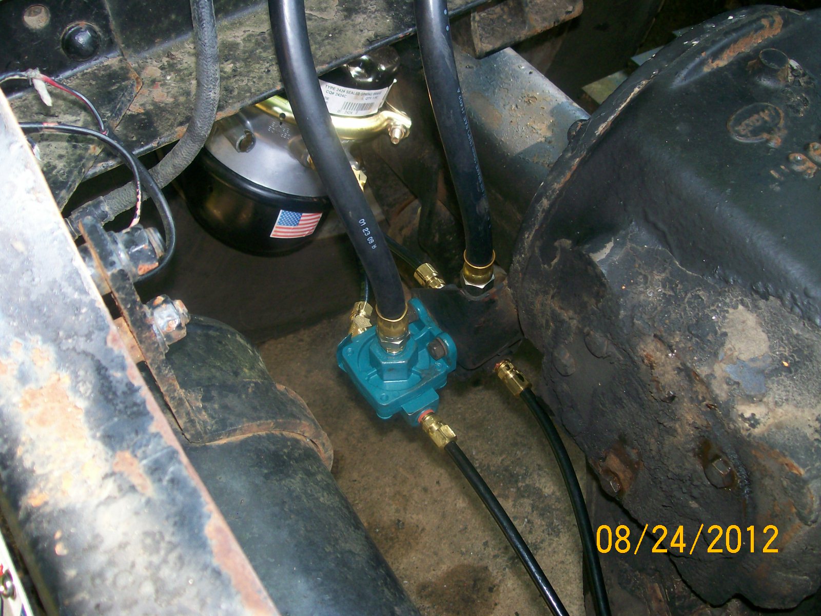

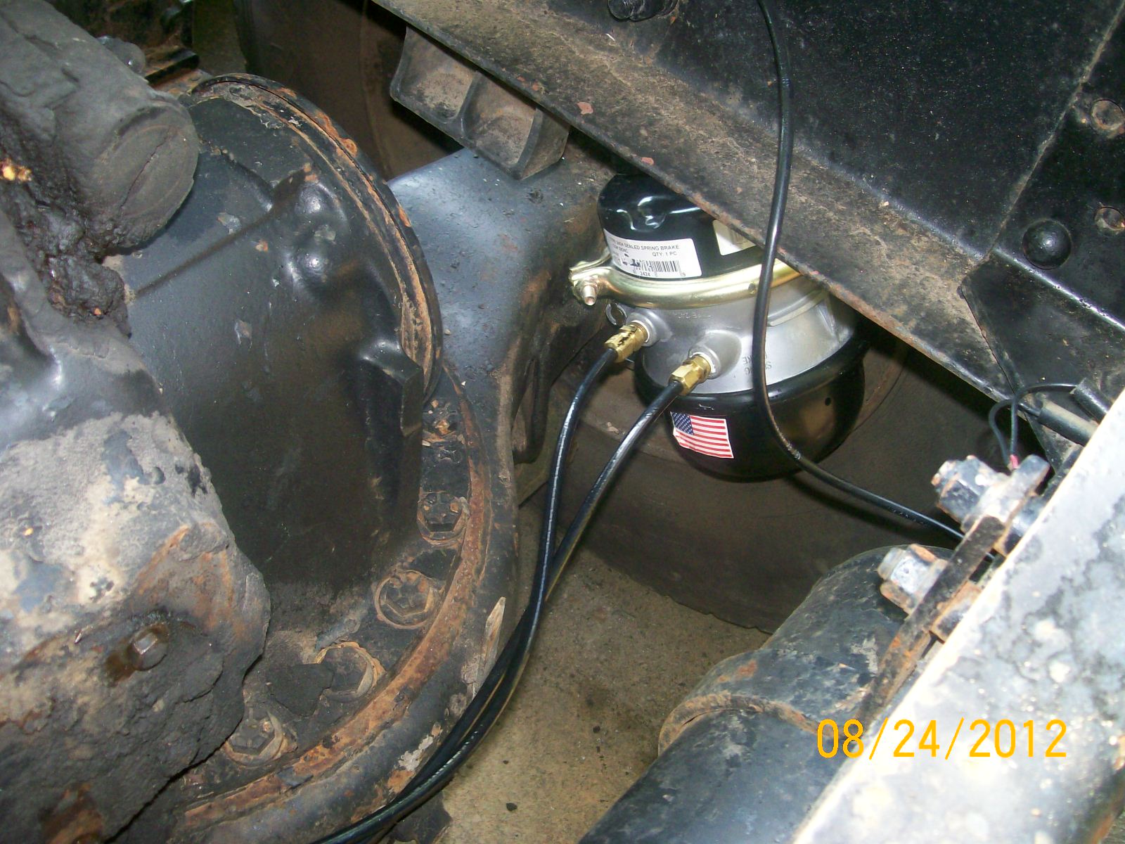

I just did some similar work on my R600, which originally had DD3 chambers. Looks like we may have used the same brand of chambers. Looks like the ones from Ranger Brake in Tennessee. I got mine from CarQuest. Talked to the son of the founder of the company. Pretty cool little family business. They made components for other brake folks for years, and then started selling their own. They still sell to the other guys from time to time, And, I liked the price!
post-11199-0-54277400-1345935499_thumb.j

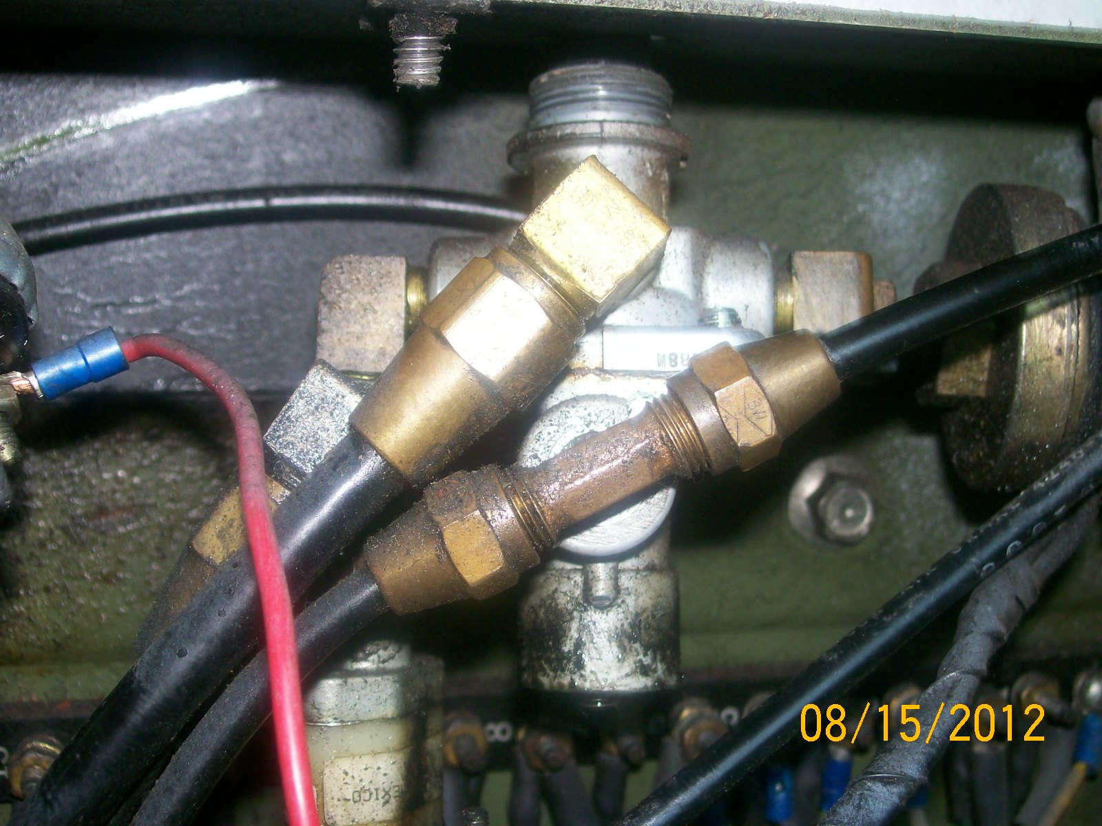

I didn't notice how you handled the anti-compounding function (sorry). My truck had a PP-2 control valve instead of a PP-1. This valve has built-in anti-compounding capability, via a line tee'd off the service brake line. It is the one attached to the lower part of the valve. Of course, you may have handled this a dozen different way. If so, sorry for the distraction.
post-11199-0-66140100-1345935710_thumb.j
I used a Haldex-Midland-remanufactured Bendix QR-1 as a quick release valve, as well as a convenient place to tee the lines.
