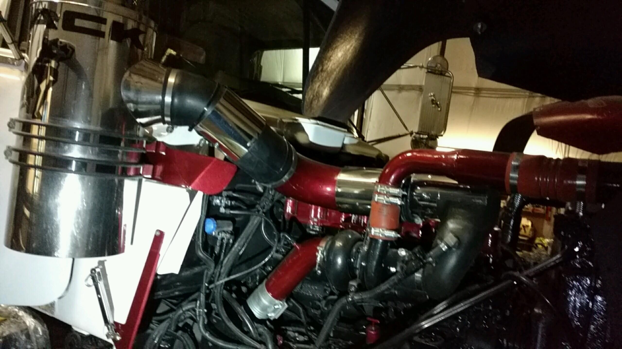

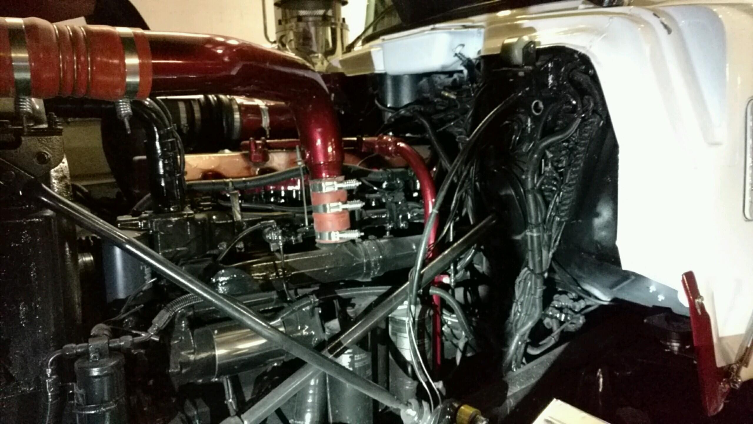

Have 1985 R688ST with a e6 300 and a T2090 trans, also has 4.64 reas. Has fuel turned up and pulls excellent at 1600 rpm, no complaints there . But my issue now is I can't get this truck to go more than 65 mph?? Any thoughts, ideas, or anything that may help me squeeze another 5 mph out of this thing now. Thank you
