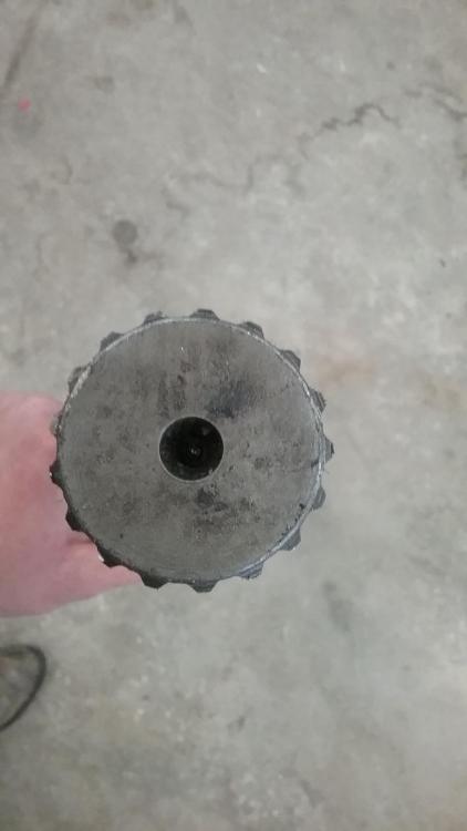

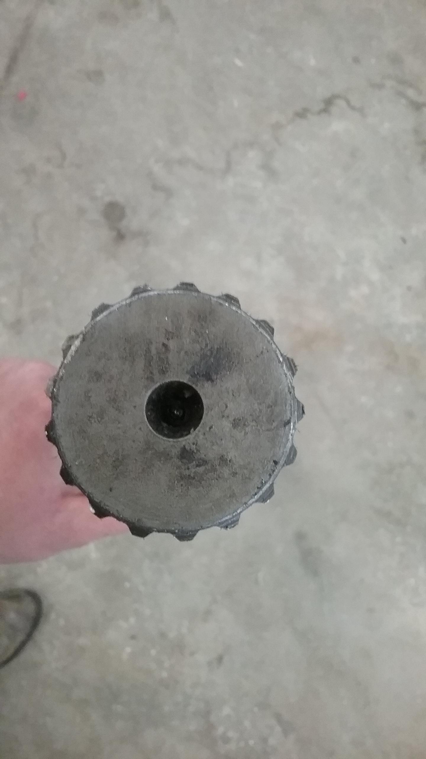

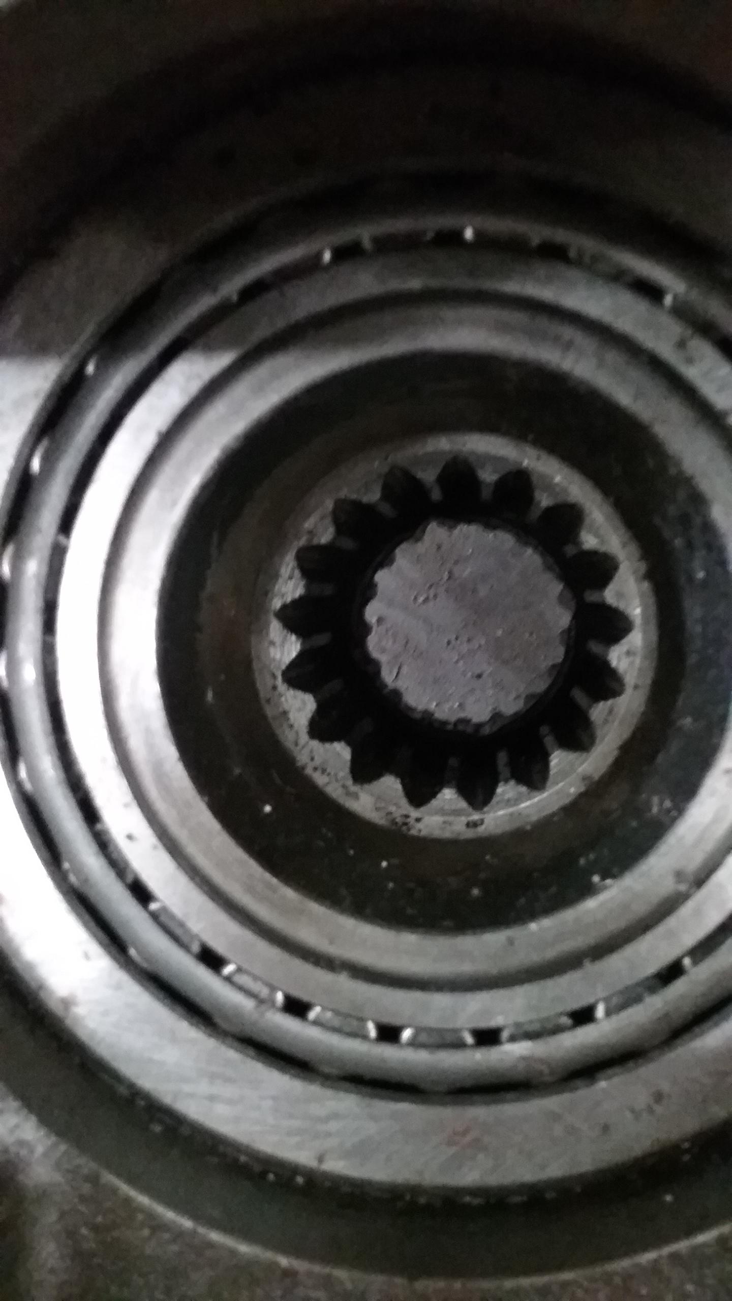

Axle spline compatibility

Did you compare the length of the axle-shafts? Both of them could be a 17 tooth splines BUT the axle-housings between '69 & 86 could be different and have different length shafts (the spindles could have changed and as a reason axle shafts could be different). Also there were some changes made in spider in the differential over years, not sure if this could be one of the reasons. Can you also tell me if you have regular differential on '86 CRD93 carrier and switched to a a'69 CRD93 carrier which had a Inter-Wheel Power Divider (limited slip differential?) (There could be a spacer in IWPD that might be causing your problem.)
