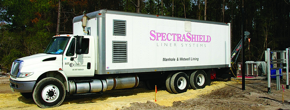

The below pic is what the end setup should look like roughly. I know this pic is on dirt, but really 98% of the work is on city streets.

Do you have the body to install on a cab & chassis? Or do you modify an existing body? Seems like that wheelbase/body combo on tandem rears should be readily available. The setup in your picture would GVW around 58,000lb. So most would have at least 350hp.
I run NYC a lot and many city delivery trucks are set up this way. Check out big city dealers to find this type of truck, new or used.

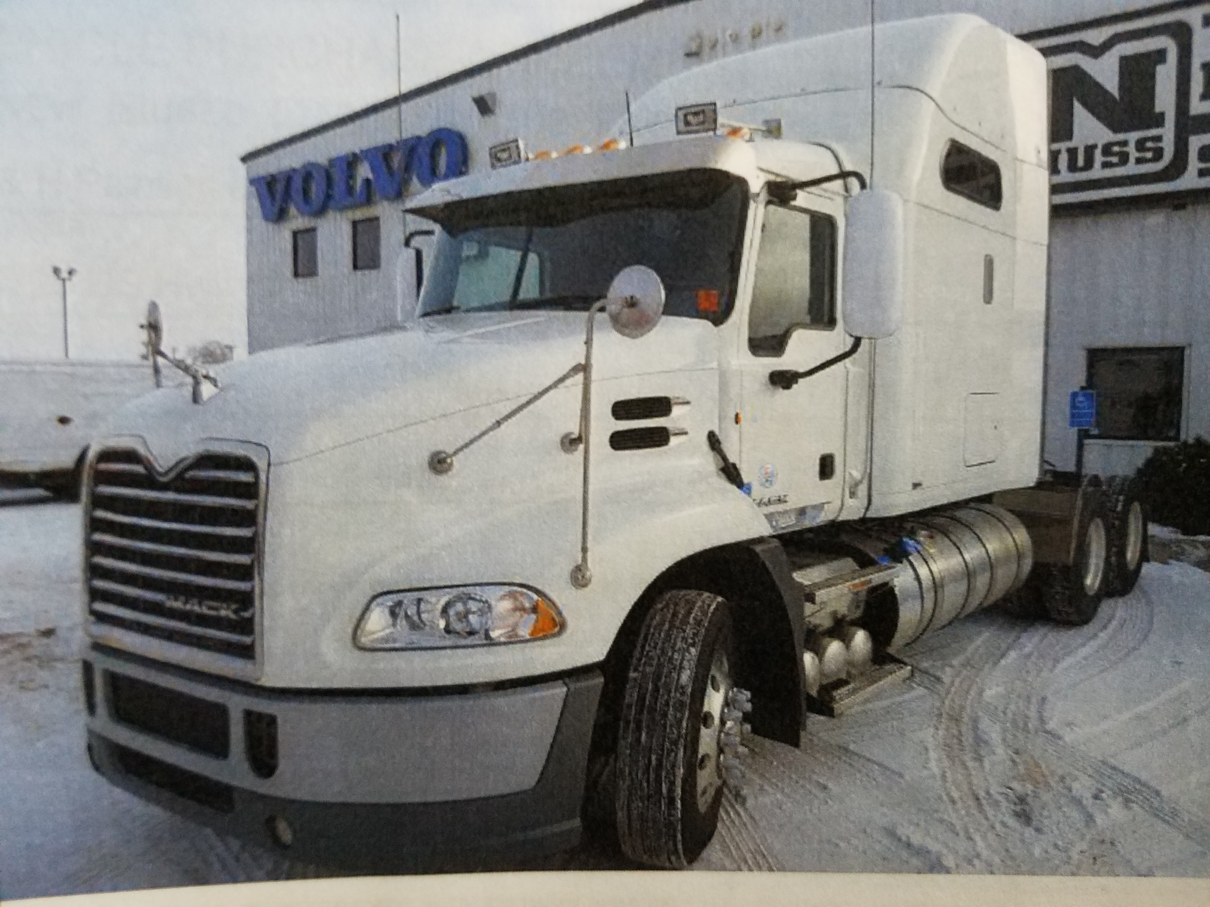

1485395359889-119841662.jpgWell just signed the agreement on a 2013 cxu613.
450,000 miles
M Drive
Mp8 445hp
$42,000
Plan is to daycab it, stretch frame from 221" to 270" roughly. Install 24' van body with small crane, stairs, toolbox and vise on remaining 2' of Frame. Will be used for vocational work lining manholes. Heavy duty Industrial painting. This is my first truck. Very nice shape cosmetically inside and out. How did I do? Didn't really get any wiggle on price, but very nice and patient salesman who's spent at least 12 hours so far teaching me about trucks and answering noob questions.
